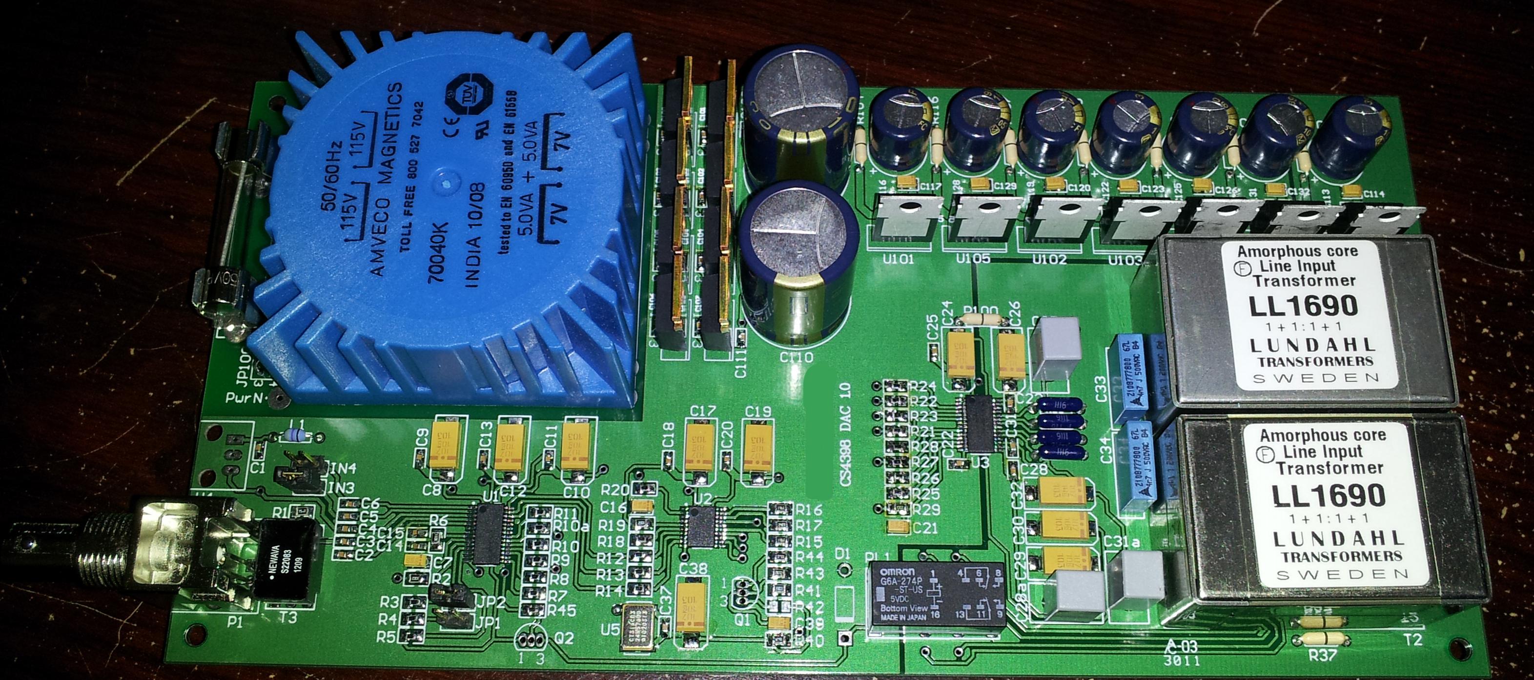

Here is the one I built. It's all on one PCB and is all surface mount except the power supply stuff. I think the regulators could have also been SMT to save a little space as well. This DAC was designed by a friend of mine out east. All the SMT soldering was done by myself and all the parts are easily available off the shelf.

Lovely bit of work. The CS4398 is the chip I use on a Cirrus Logic demo board from 2000. You can run cap couples off the V+ left and right and the sound is very detailed, but slightly cool in the mid. I would think using the +- voltage outs on the DAC with the Lundahl will be warmer, and bring the balance of bass mid and treble in line and also filter out any noise.
Thanks! It wasn't too difficult a build as I've done a lot of SMT work in the past. I think you are correct about the effect the transformers give. It is a lovely sounding DAC. There are only three in existance and he doesn't want to sell boards or deal with other people wanting to build them...

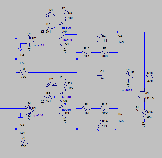

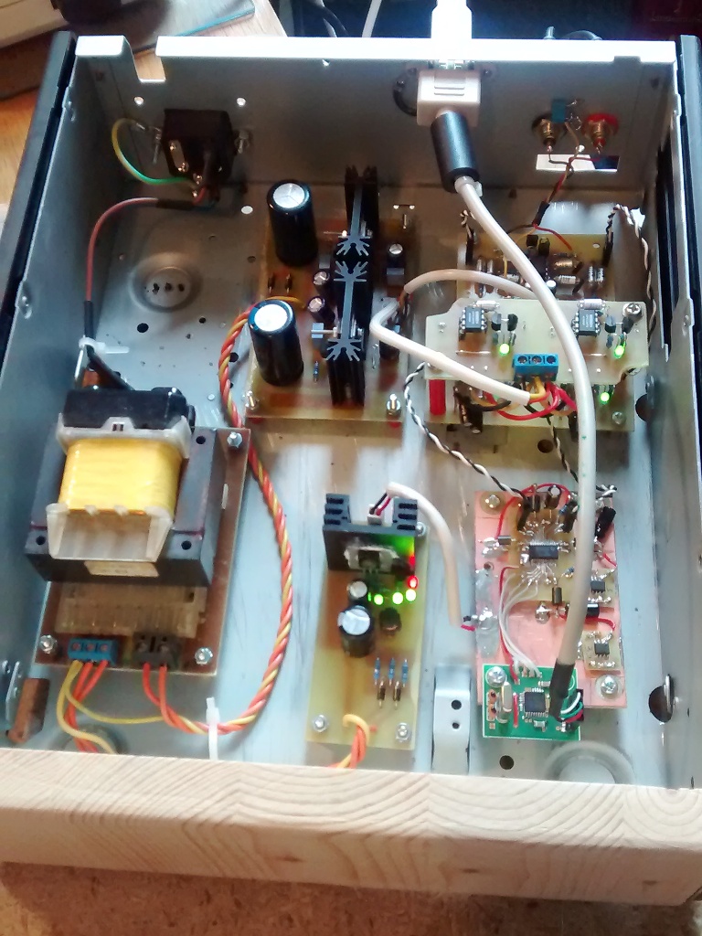

This particular pcm1798 certainly won't beat a buffalo 😀 The good thing about it however was that I was able to build it by using only parts already in my drawers (and etching a few boards).
It's a dumb pcm2707 followed by a pcm1798. Power supplies are cap multipliers followed by regs for both analog (lm7812/7912) and digital supplies (reg101). The only original thing about it are the small class A buffers to assist the opamps in the I/V (the lower currents of the pcm1798 are here a blessing). From what I remember, it was suggested by jcx but I see it's been done here too so the inspiration could have come from either.
I'm still hesitating on how best link the earthed case and the circuit common. I need to test it for noise with either a simple gnd link or a groundloop breaker.
