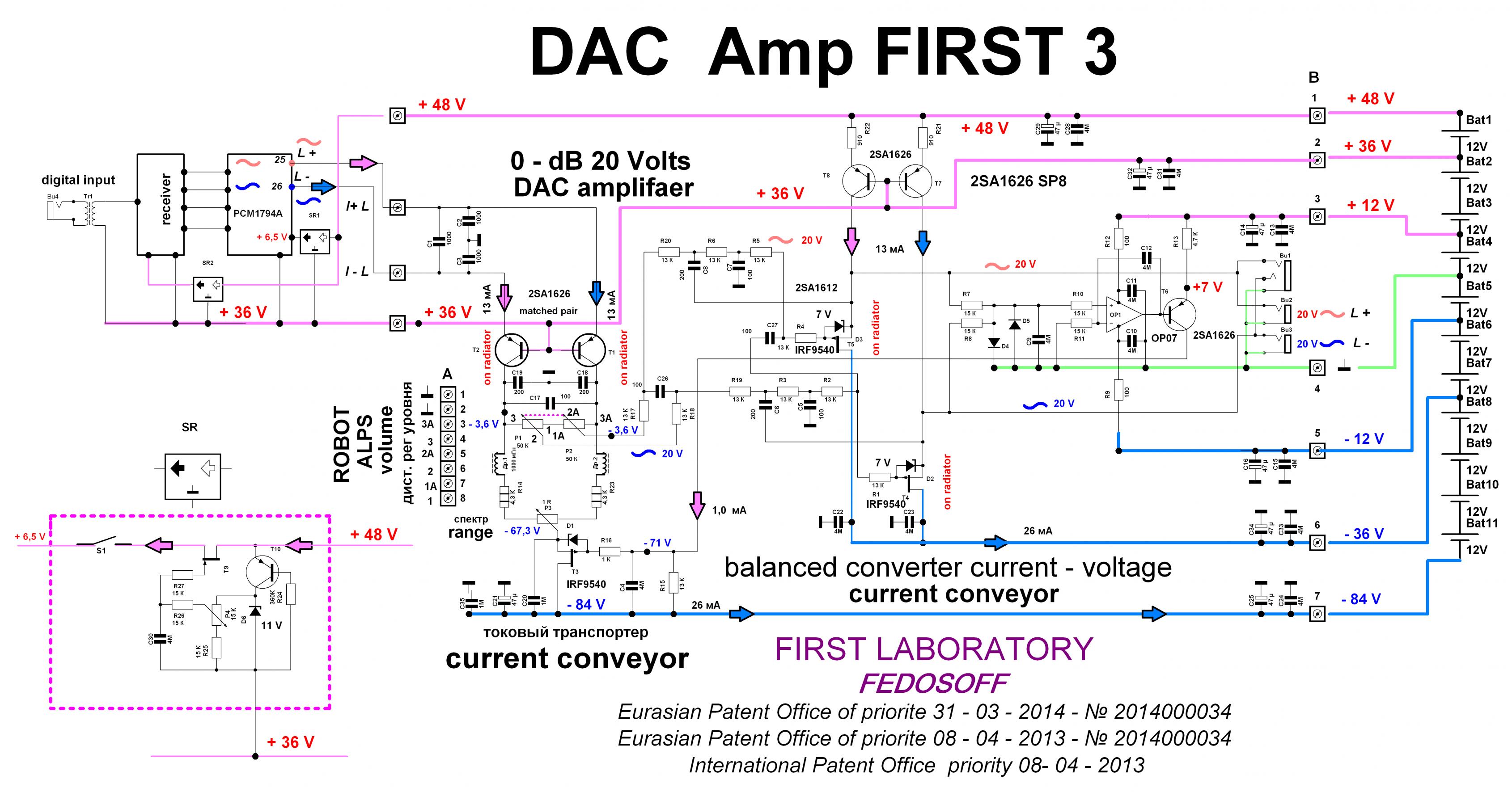

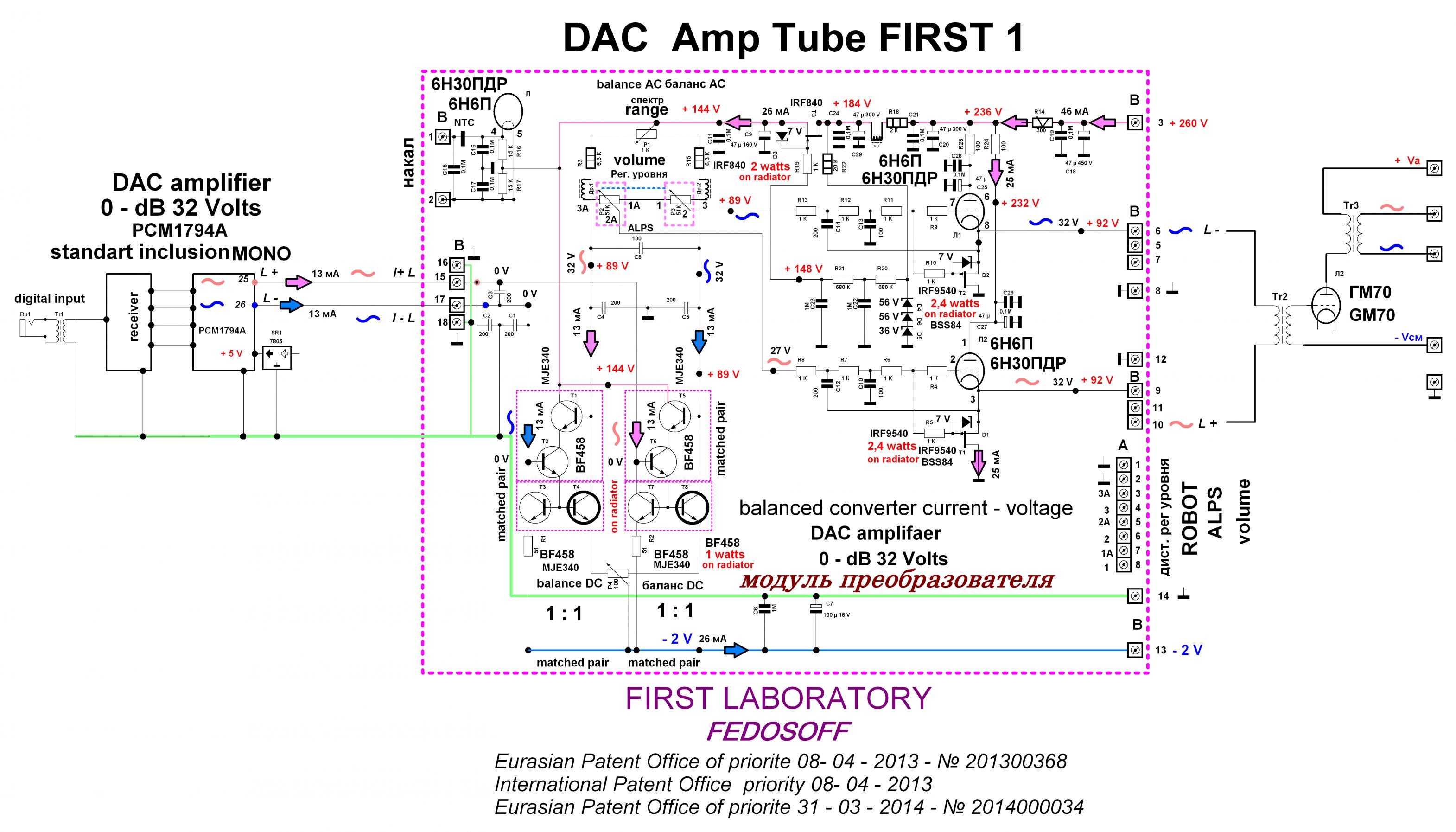

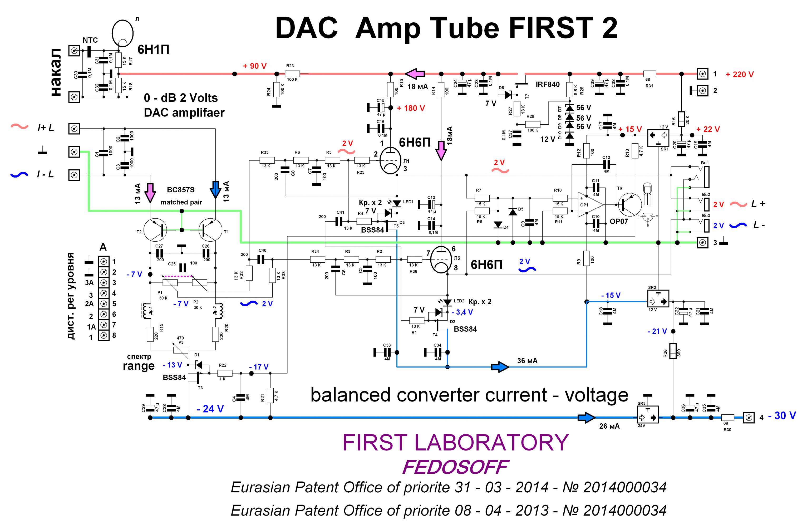

The converter current - voltage linearly operates from 0 Hz - 20 kHz. Modulators PCM1794A loaded at low output impedance emiternyh transitions. Harmonic distortion is almost equal distortions PCM1794A. Analog filter. Converter - current conveyor is unmatched in sound. This international application is published. See this link:Transformer i/v conversion is a useful option and may be the best sound for many.The transformer may be synergistic with one DAC chip for a pleasing sound, but for another it may be a cap or cap and resistor or resistor ladder arrangement. This can be a useful way to rebalance the sound if it has too much top end. The suck it and see approach keeps us all trying out options, that may not even seem the best, and then surprise us how good it is. Lampizator very much seems to me to follow this route. The measurements do not tell us enough.
RU2014000255 SINGLE-ENDED AMPLIFIER WITH DIGITAL INPUT, AND DIGITAL-TO-ANALOG CONVERTER AND VOLTAGE FOLLOWER FOR SAID AMPLIFIER

The converter current - voltage linearly operates from 0 Hz - 20 kHz. Modulators PCM1794A loaded on the low output impedance of transistor emiternyh transitions. When the output current 13 mA PCM1794A modulators operate at 2 ohms load resistance. Harmonic distortion at the output of the current conveyor, almost equal distortions PCM1794A. Filtrtsiya high frequency noise of analog filter. The use of batteries can eliminate the noise power and obtain a large dynamic range. Converter - current conveyor is unmatched in sound. This international application is published. See this link: RU2014000255 SINGLE-ENDED AMPLIFIER WITH DIGITAL INPUT, AND DIGITAL-TO-ANALOG CONVERTER AND VOLTAGE FOLLOWER FOR SAID AMPLIFIERThe transformer will by its very nature will alter what comes out. They all seem to sound different. Some prefer a 50% Ni core instead of amorphous iron or 80% nickel.

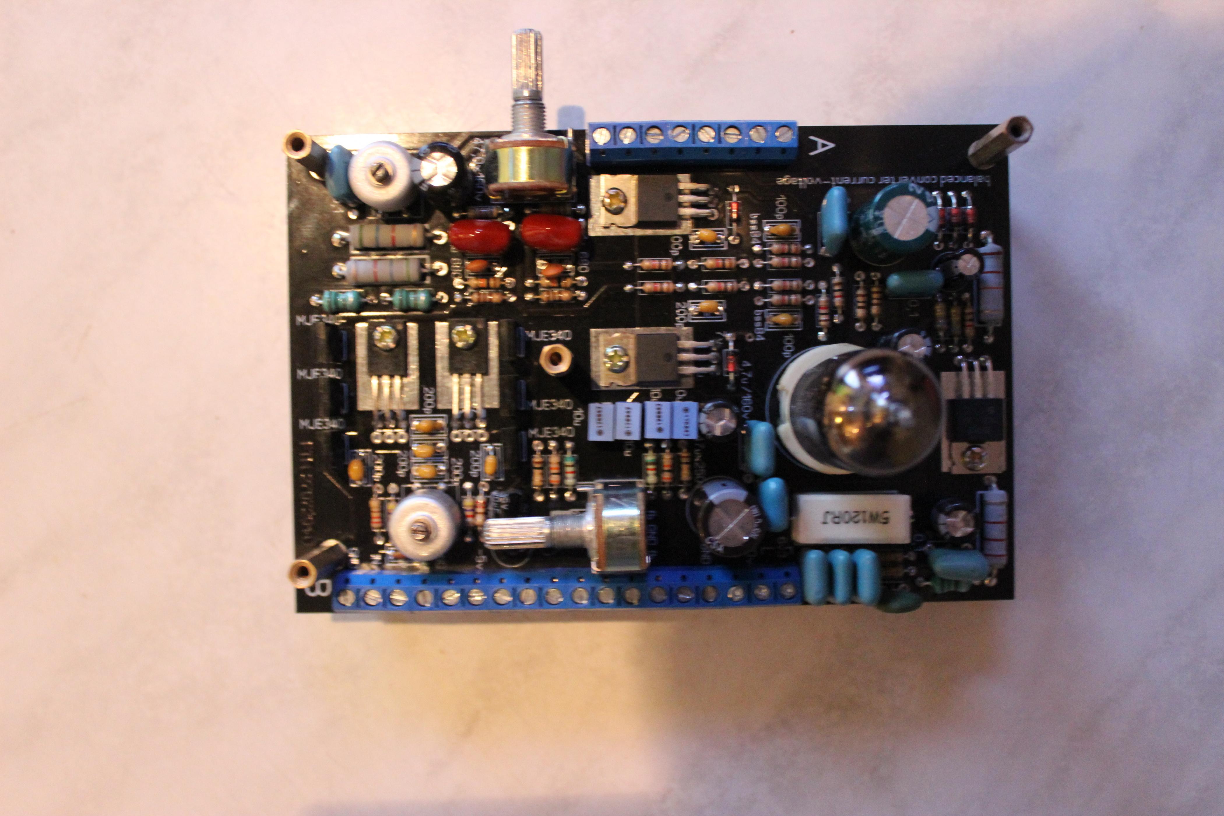

- Current conveyor creates the shortest path in the world and opens a new era in super high end devices. The output signal of a current conveyor is fed to a powerful single-cycle repeater or a voltage follower. Here is a video where you can hear the sound of the current conveyor battery-powered. ??????????? ???????????? ???????????. ?????2 - YouTube
This will need batteries faster than the circuit. Interesting.The converter current - voltage linearly operates from 0 Hz - 20 kHz. Modulators PCM1794A loaded on the low output impedance of transistor emiternyh transitions. When the output current 13 mA PCM1794A modulators operate at 2 ohms load resistance. Harmonic distortion at the output of the current conveyor, almost equal distortions PCM1794A. Filtrtsiya high frequency noise of analog filter. The use of batteries can eliminate the noise power and obtain a large dynamic range. Converter - current conveyor is unmatched in sound. This international application is published. See this link: RU2014000255 SINGLE-ENDED AMPLIFIER WITH DIGITAL INPUT, AND DIGITAL-TO-ANALOG CONVERTER AND VOLTAGE FOLLOWER FOR SAID AMPLIFIER

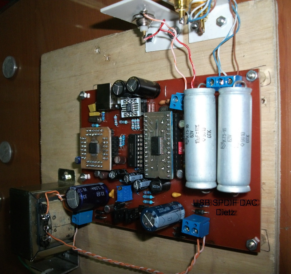

Here is my DAC, based on a CS4398 with CS8416+CM102s kit from ebay ( transformer + empty PCB and components ).
I didn´t build the kit 1:1 but made some changes:
- improved Capacitor values for the power supply ( purchased high quality Capacitors from Panasonic, low ESR )
- purchased 2,5% tolerance Wima FKP2 for the output buffer
- inserted a LME49720 instead of the supplied NE5532
- used better quality RCA connectors ( but since these were not suitable for print layouts, I had to somehow connect them 😀 )
I only used some of the supplied components like eg. the terminals, rectifiers, 1% precision resistors etc. and only upgraded the values on the board where necessary.
In order to make sure that I do the right thing, I also checked the datasheets of the regulators. It´s no use if you try to eg. insert a 10000000000µF cap instead of a 10µF input capacitor for the 3,3V and 5V voltage regulators.
My device has no audible hum and I like the sound. I don´t have the equipment though to perform a advanced analyze of the circuit itself, check the THD etc.
Here are some pictures 😉
