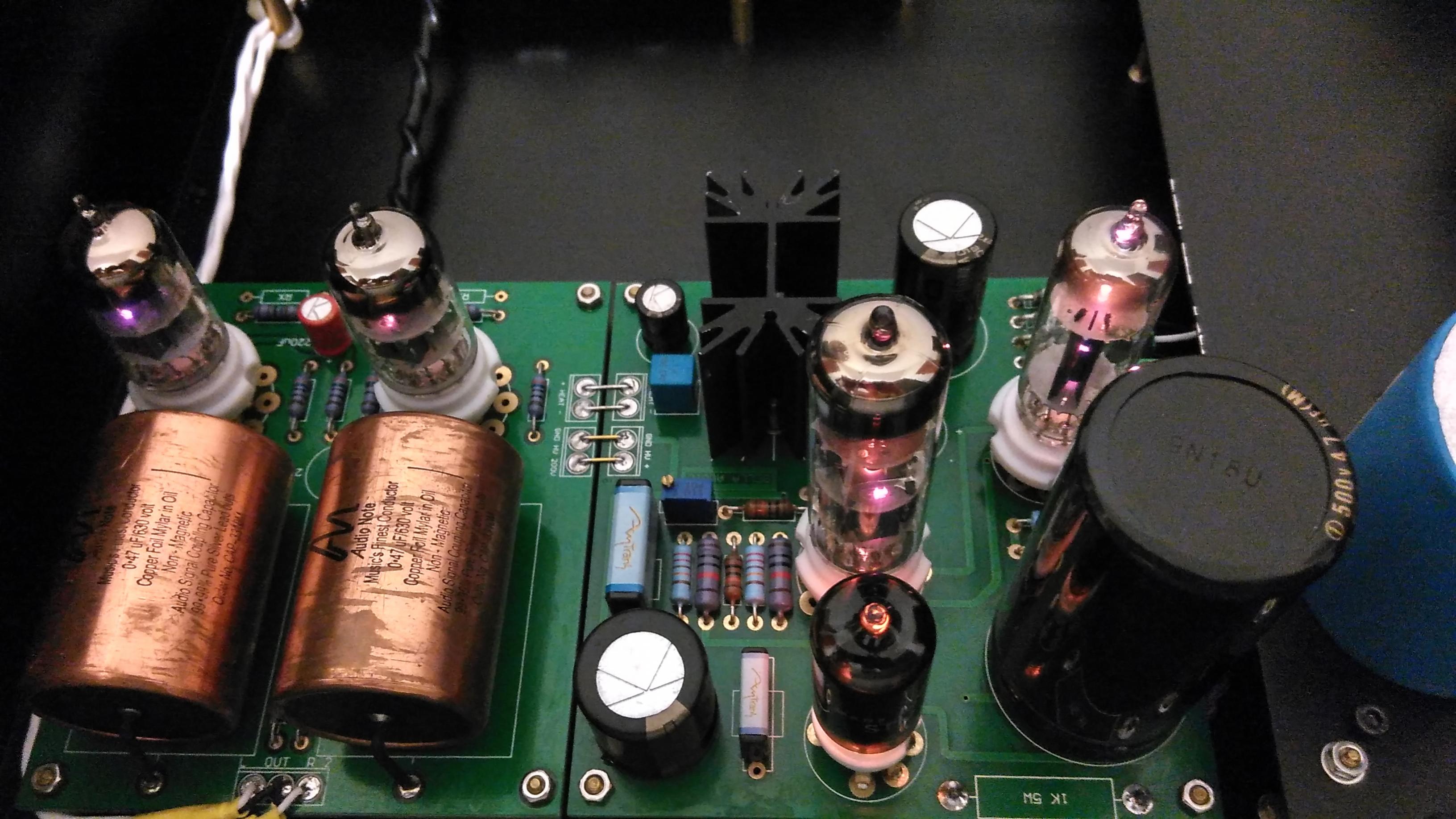

finally finished my dac, it's a long journey. collecting parts for more than 1yr, testing different chassis, alot of drilling and sanding, but finally got it completed. Additional 4mm alum plate on the bottom is used to make an easy access to all parts entirely.
AD1865 with SRPP gainstage, pcb made by bella-audio.com. Today is the first time i put the power on, check digital and analog voltage before plug in chips / tube, then connect with qls qa350 and tadaaa, signal locking led turn on, it's time to connect output. Using creative T20 as testing, it's working for the first time running
Got to love gas regulator tubes 🙂 Where i can find any info/prices for the HV power supply board?

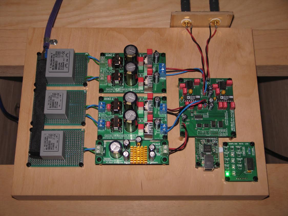

This is the DIYINHK AD1862 DAC kit with PSU boards.
The kit is very simple to build. I changed 4 alu elcos to tantal regarding the AD1862 datasheet. The dac is plug and play with my macs, and very comfy.
The sound is incredible, really.

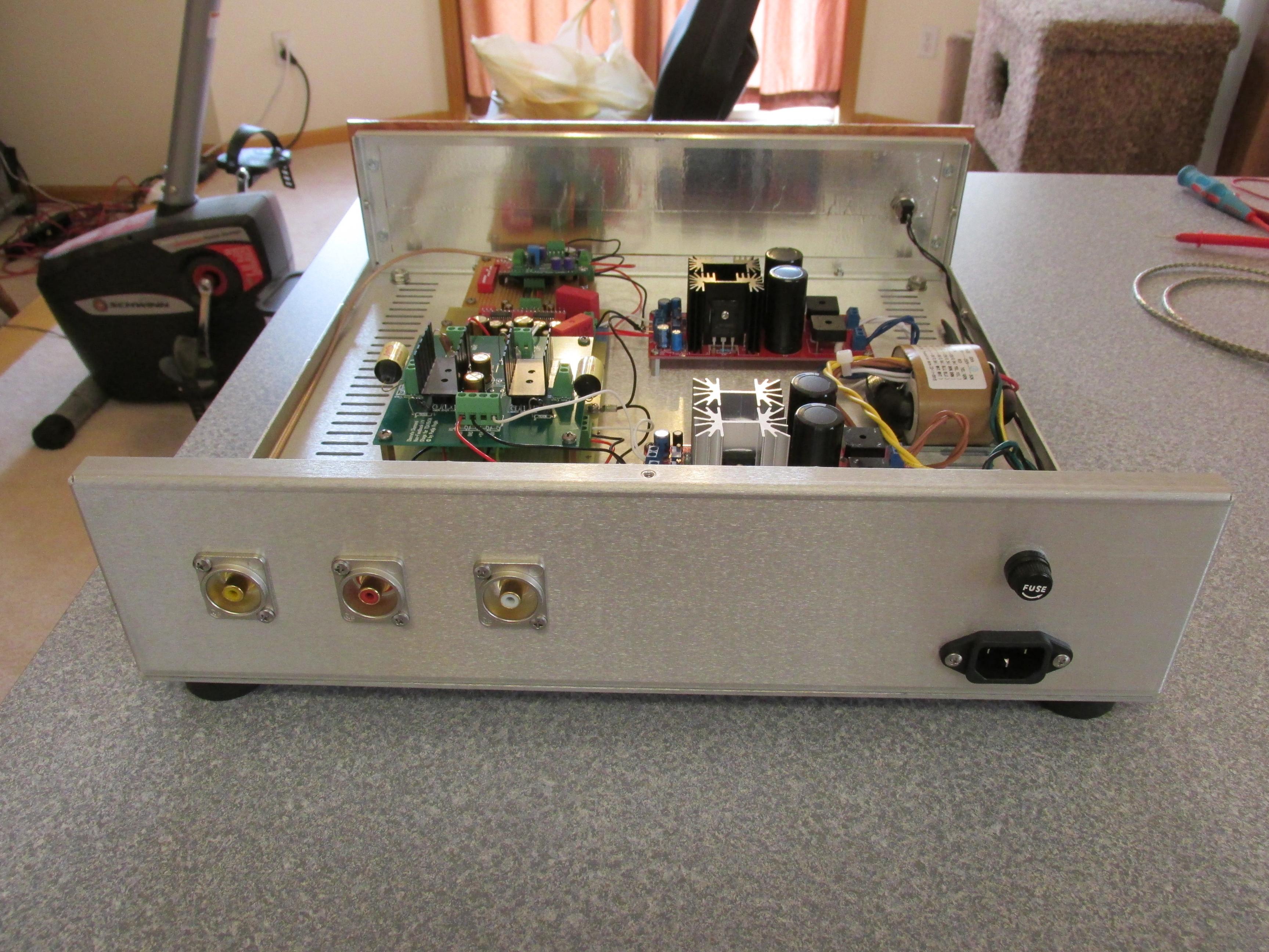

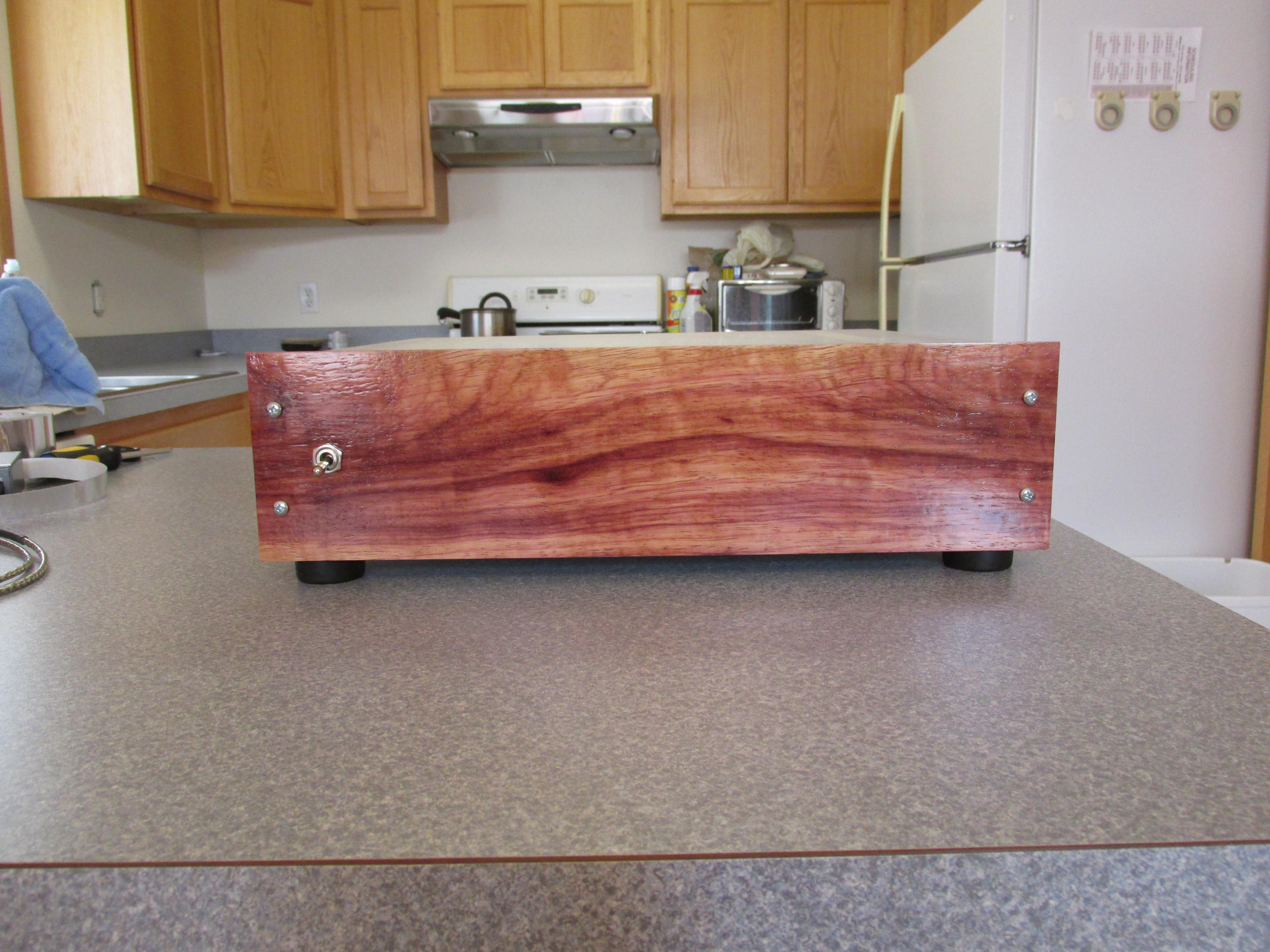

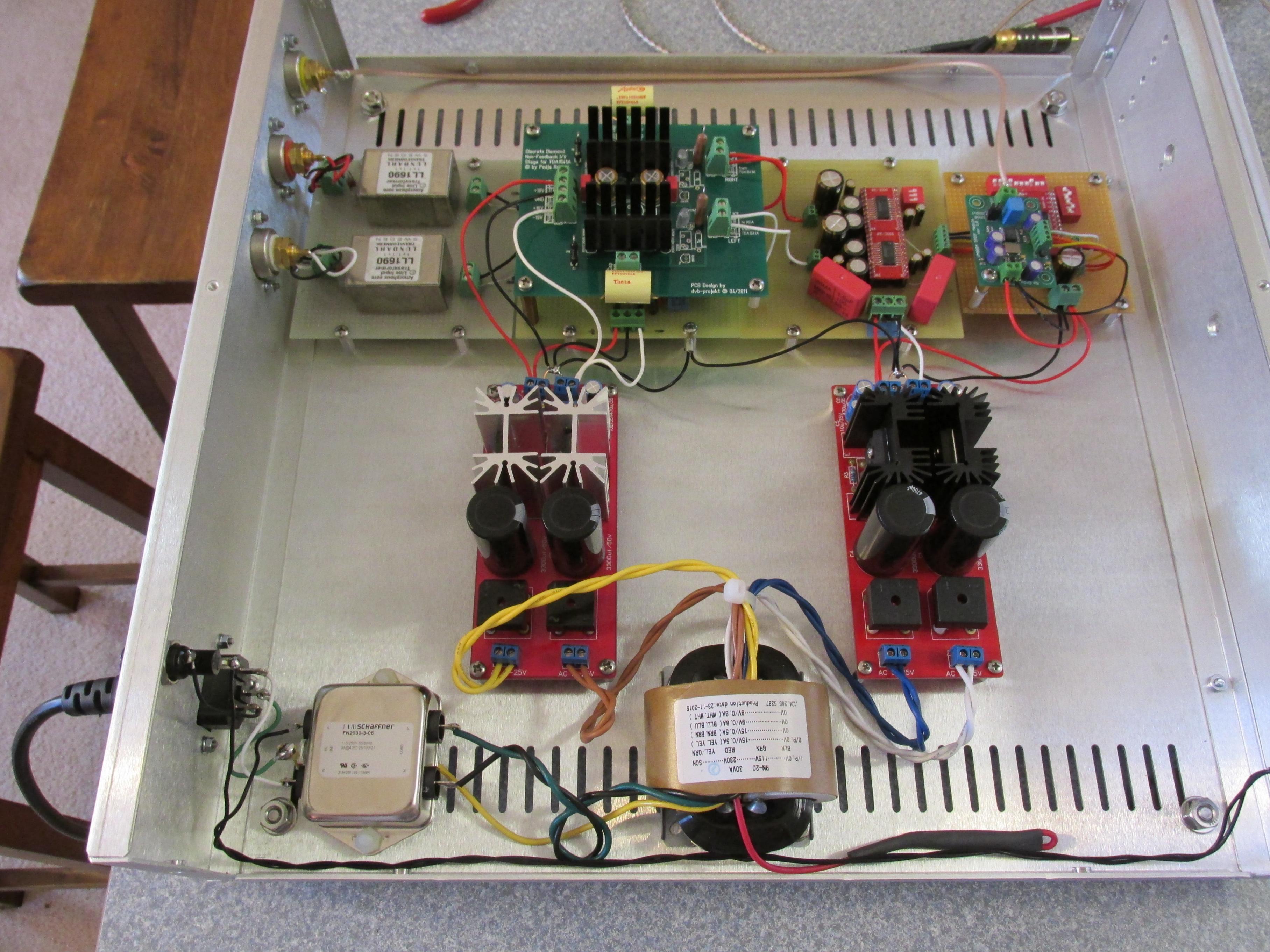

Just sharing my recent build. I am using a Tekdevices WM8804 input receiver. I used the PCM1704 evaluation board schematic for the DF1704 and PCM1704 sections. I/V is a modified Pedja Rogic Discrete Diamond No Feedback stage. Omitted 2 mA current sources, changed I/V resistor to 2.5K Ohm and 470 pF Polystyrene capacitor. The OPA627 stage runs at a gain of 2 and operates as a voltage buffer for the DDNF I/V. Filter is passive based on Lundahl LL1690 line transformers wired as 2:1 step down. Build is outlined somewhat at the AD844 thread. Faceplate is African Paduk.
