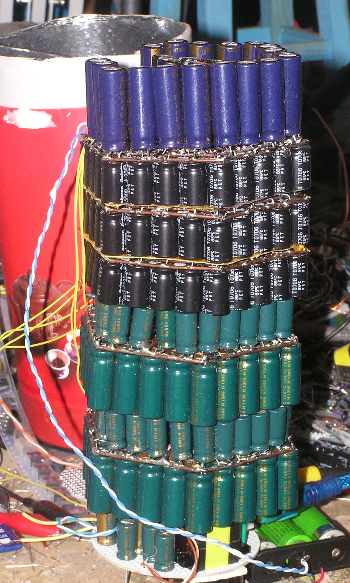

My latest DAC build is here - based on using hundreds of capacitors to implement passive shunts on the supplies. The DACs are TDA1387 (6 in a stack), passive I/V, Chebyshev LC filtering then the analog stages are AD815s, one per channel. There are hand-wound ferrite cored transformers in the base doing SE-unbal conversion. Battery power comes from 3 NiMH AA cells giving over 10hrs of listening.

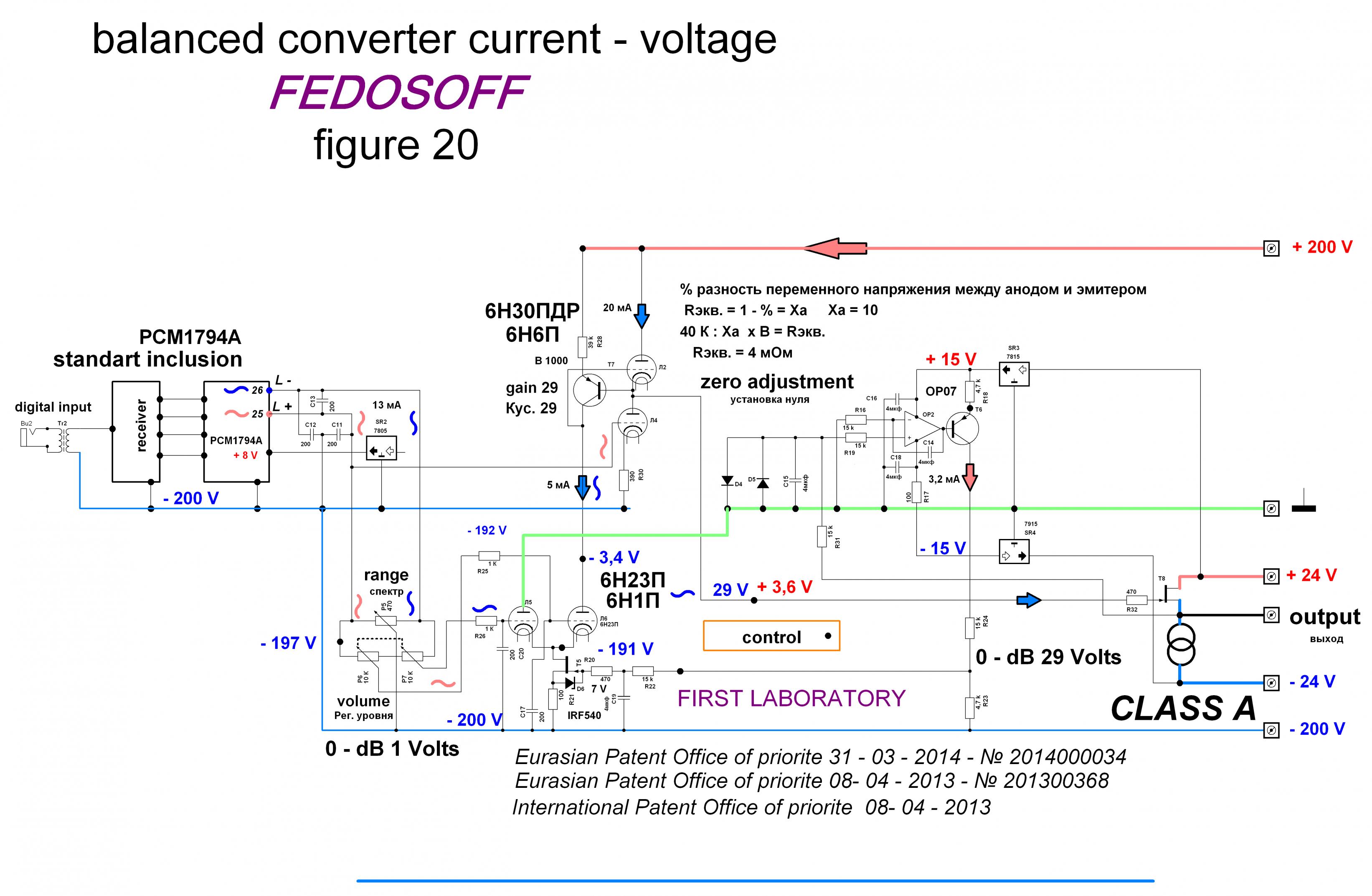

Do You used in this compare, similar analogue tube output to this picture?
If I see properly, that power supply transformer is from LINN (it's linn logo?). Greetengs!

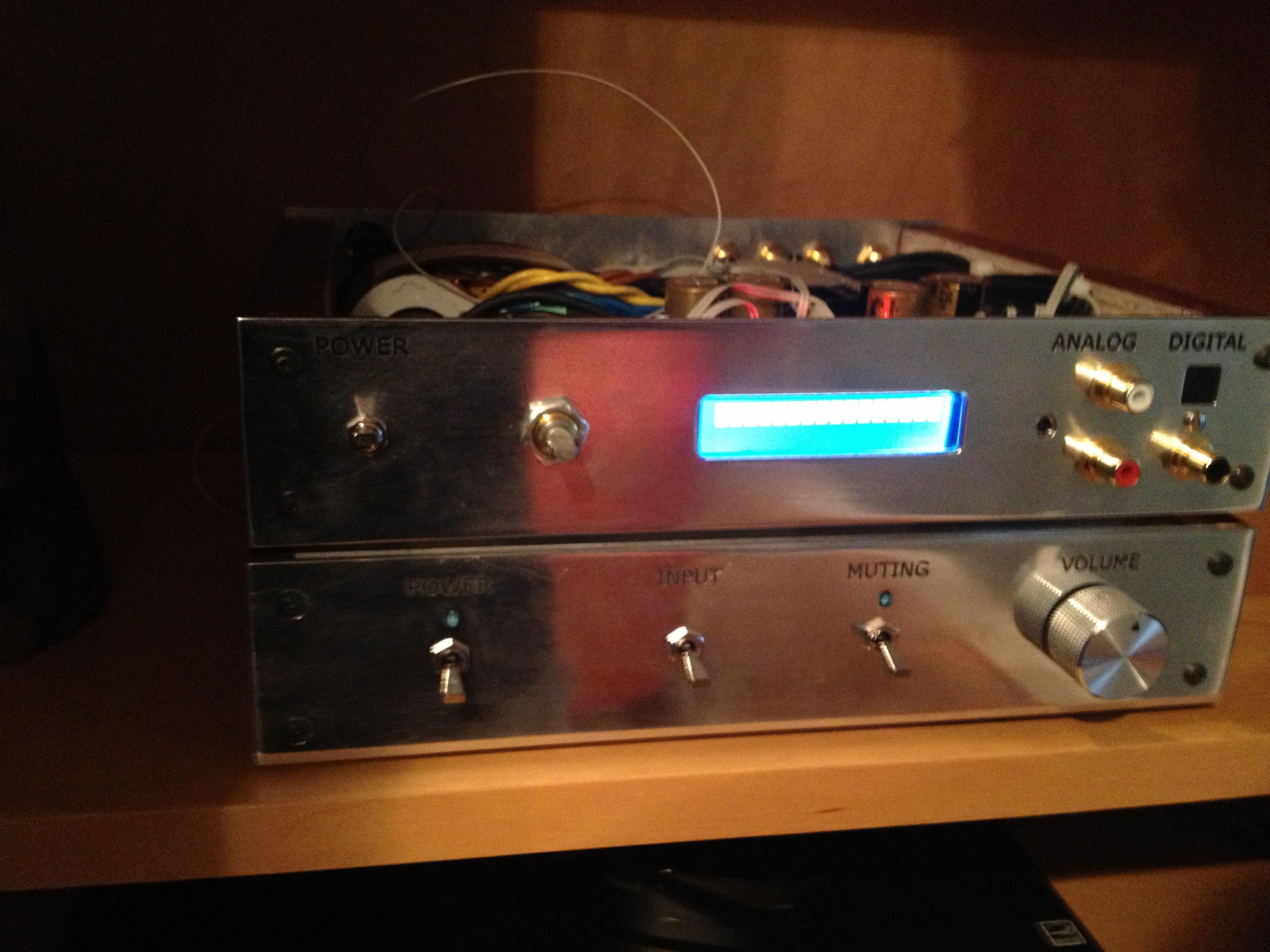

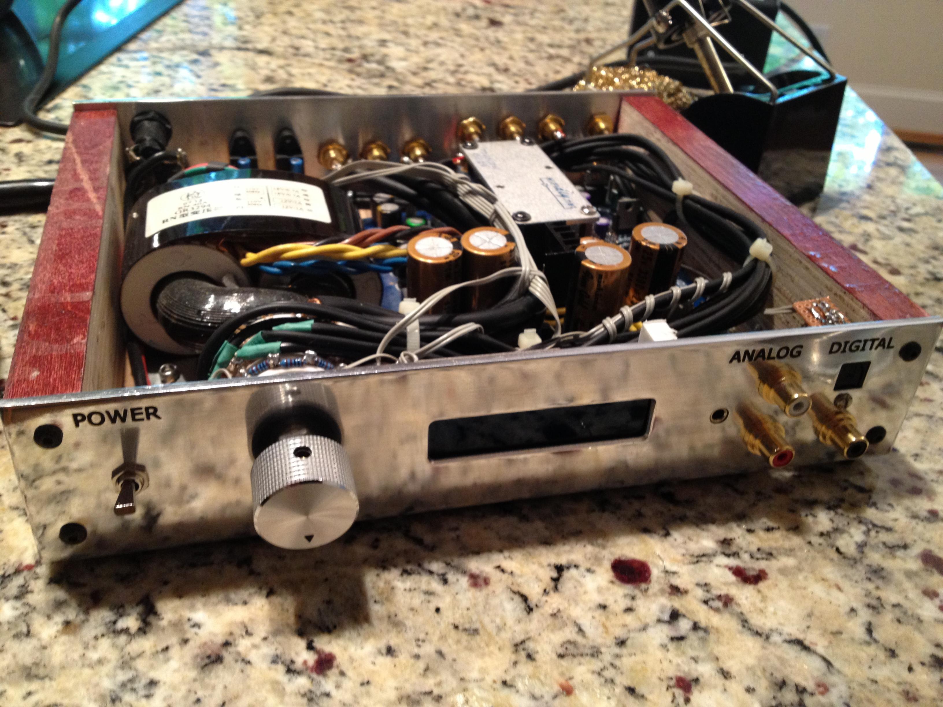

A line pre-amp with built in DAC I made. still need to cut a top and program the micro-controller. has 3 coax and 2 fiber digital inputs (as well as 3 analog inputs) on the rear and one of each on the front. made the entire thing including the panels from scratch.
Hello colleagues. From experience, it is desirable to apply the tube stage better options.Do You used in this compare, similar analogue tube output to this picture?

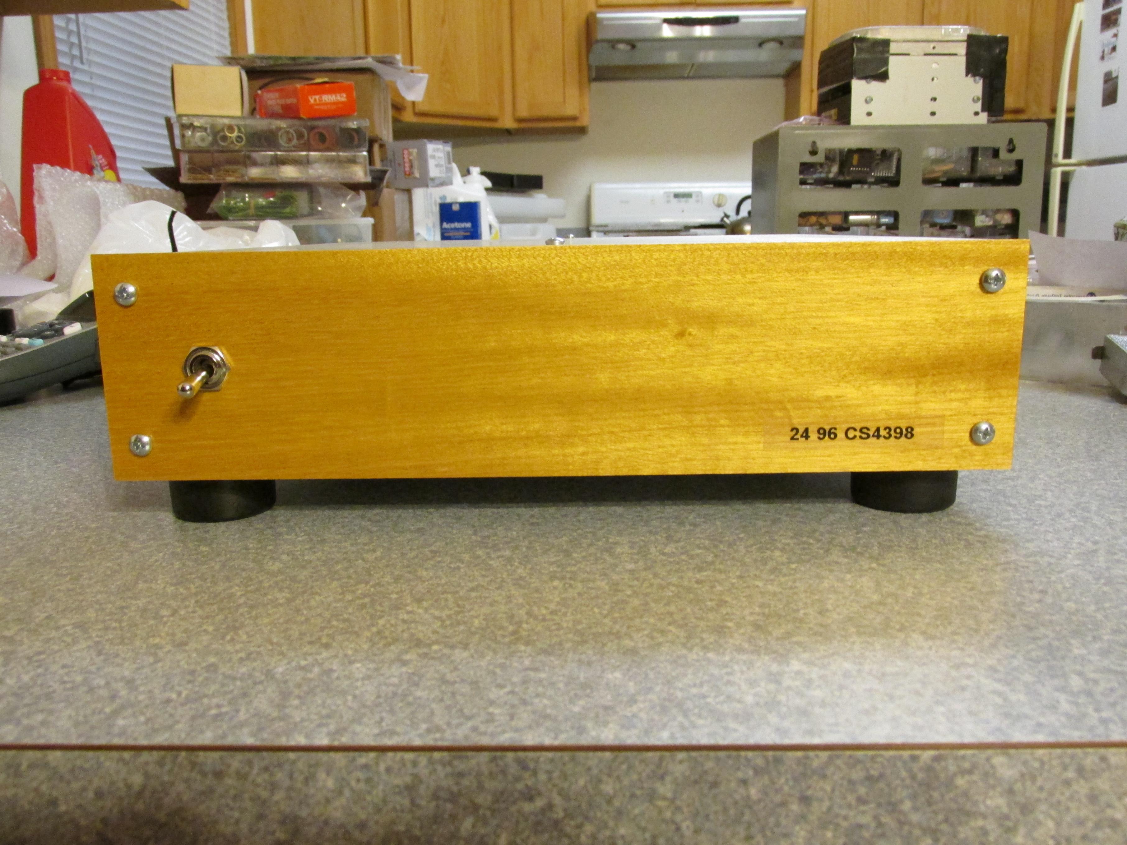

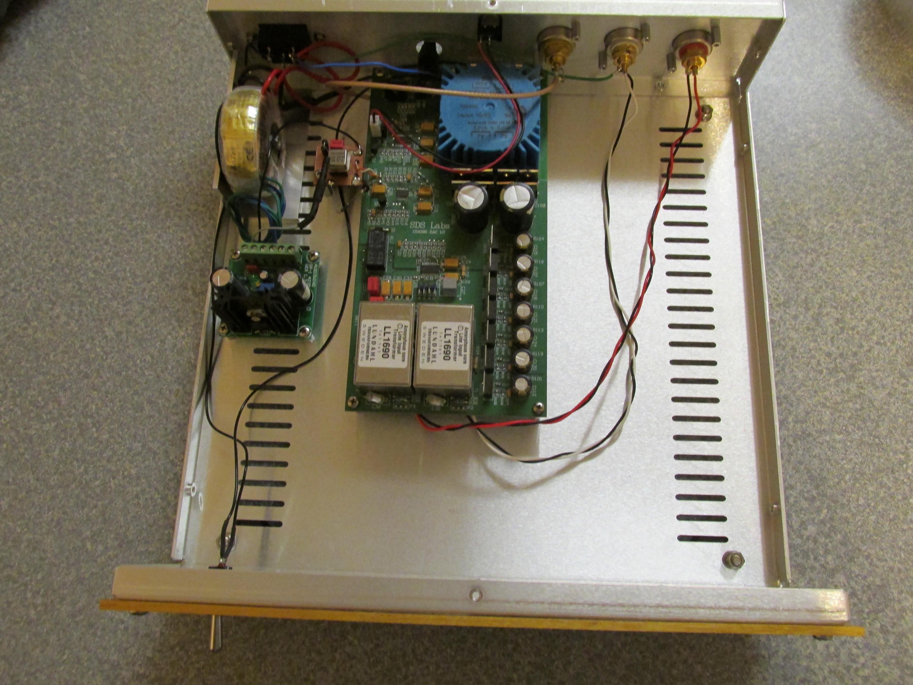

Finally getting around to finishing some older projects. This one is a Sheldon Stokes 4398 DAC. Uses 8416 to sample rate convertor and outputs 192 KHz to a CS4398. Works well enough for my streaming and Bluray DTS -Master audio via Toslink. Lundahl transformer based filter for the output. Not on the same level as my 1541 based DAC's however it has it's place. I did install a Tent oscillator module and a dedicated clock power supply. The wood front is a piece of Brazilian Yellow heart with a simple finish. I have a Maple faceplate in the works when my wood working friend finds time.

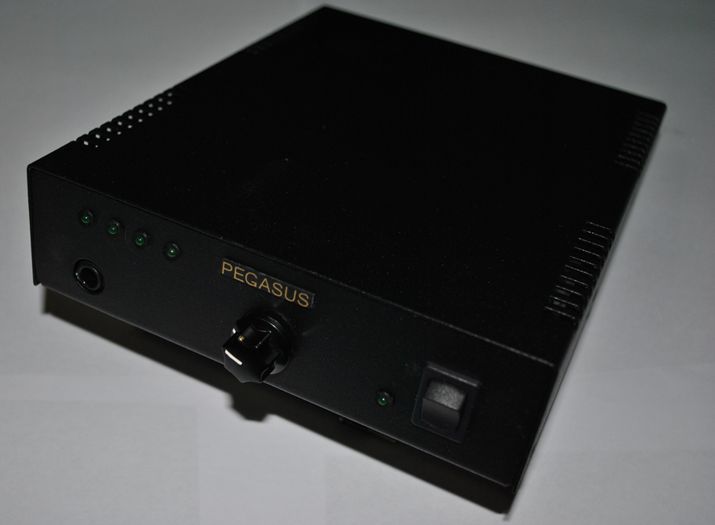

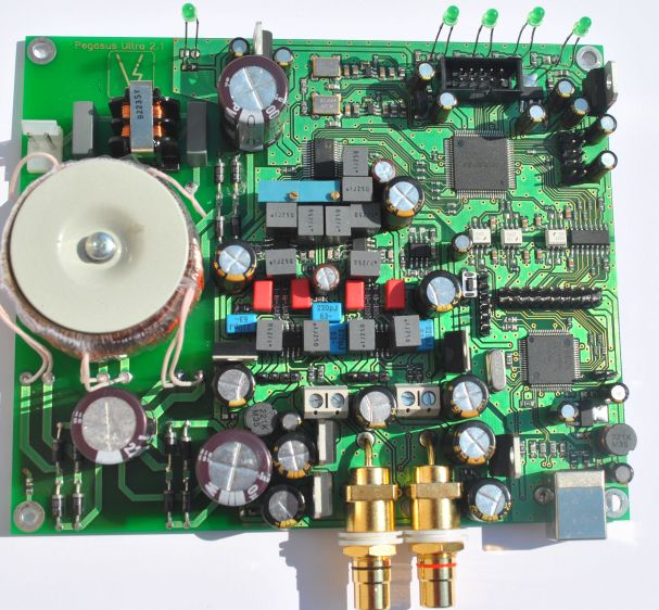

Pegasus II Ultra USB DAC
96kHz/24bit Async. USB on LPC1756 in slave mode
Optic decoupling from analog
MAX II CPLD as clock divider and I2S resync buffer
Two crystal oscillators for x44.1kHz and x48kHz frequencies
AD1853 as main DAC chip in RJ mode
AD8066 as I/U converter
LME49990 as LPF and output driver
With headphone amplifier

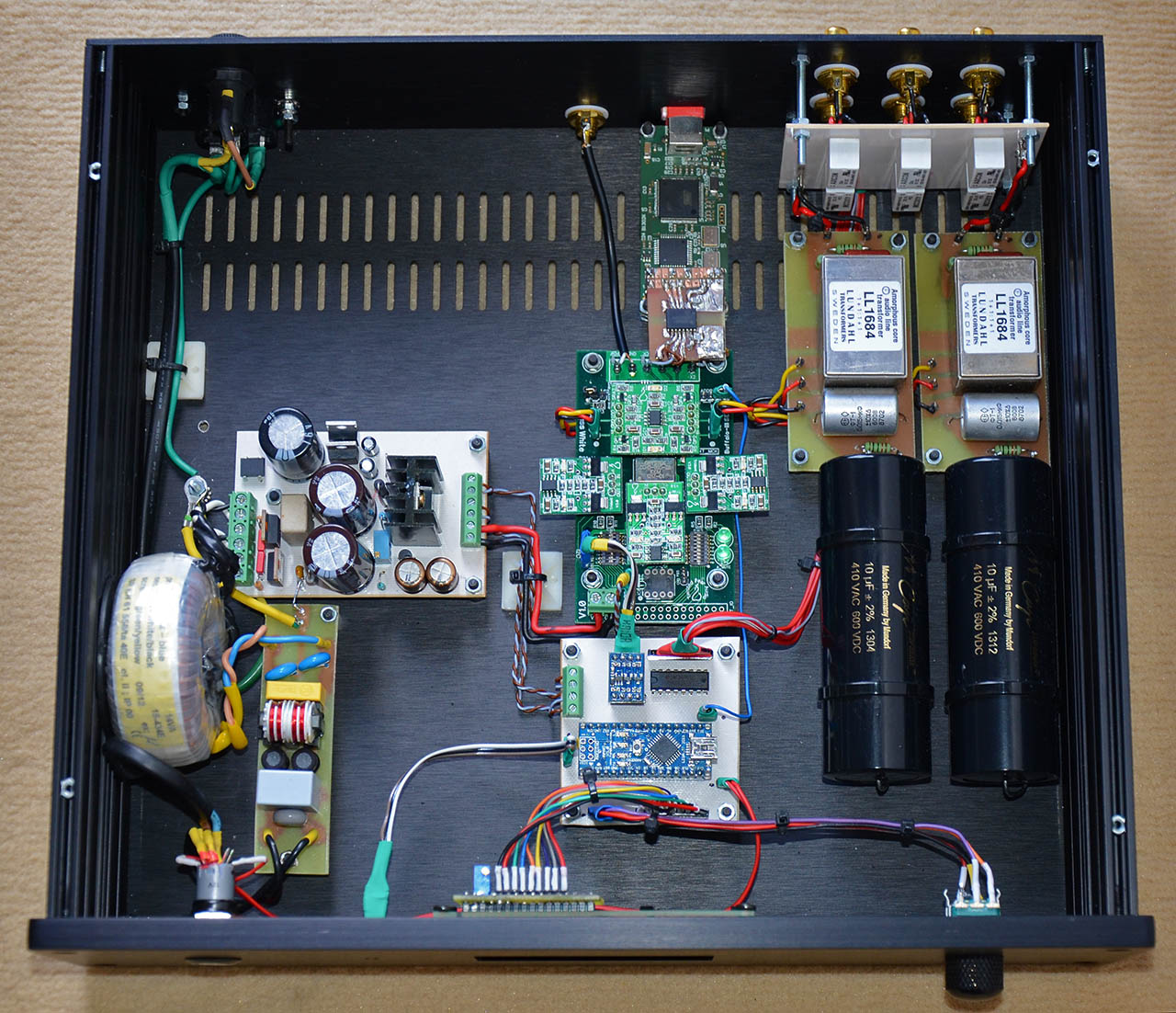

Hi, this is my Buffalo III DAC.
The output BAL->SE is done à la Ciuffoli, with amorphous Lundahl transformers and Mundorf Supreme + teflon caps.
It has 3 selectable output channels.
It has two input channels: one Amanero async I2S USB and one S/PDIF.
The Amanero board is isolated by a Texas Instruments ISO7640 digital isolator (done the SMD board and soldering myself, it wasn't easy...)
The raw PSU is a nice and clean TIP142 emitter follower with TL431 voltage reference. The AC line is filtered (common and differential mode chokes).
The controller is a small Arduino Nano - it has enough I/O ports to control the DAC registers, select the input and output channels, control the LCD display, the IR remote control and the rotary encoder.
The firmware is based on Hifiduino, but it was completely rewritten and optimized. It has two display modes - a "normal", clutter free one, with essential information, and the full setup mode. The LCD backlight fades out after some time to a lower level and it fades in on user action.
The enclosure is a HiFi2000 Galaxy, very good quality. Front pannel milled by Schaeffer AG.
This is the best DAC I have ever heard, especially with the async I2S input.

It looks avery well arranged bit of kit. Also it seems most use some sort of DAC output transformers especially Lundahls ammorphous cobalt or 80%nickel or other. Have you compared this with capacitor coupling for sound stage depth treble, mid, bass balance etc.
If you're using output transformers why on earth are you also using output capacitors? I have a similar DAC that I built using Lundahl transformers. I have no analog stage and no output caps. Just the output of the DAC feeding the Lundahl transformers.
Mark
Mark
Like you Mark I agree not traffos with caps. The post above isa 3 way switchable for tranformer or cap out put or predumably op amp. So Vincent could perhaps tell us which he likes best and why. I wouild expect the cap to be the most transparent, but the Traffo depending on which one will be warmer with smooth but less detailed output. I expect the opamps are what op amps are, synthetic.If you're using output transformers why on earth are you also using output capacitors? I have a similar DAC that I built using Lundahl transformers. I have no analog stage and no output caps. Just the output of the DAC feeding the Lundahl transformers.
Mark
Oh, ok. That makes scenes. Using both would not make any sense. These Lundahl transformers are so good that I can't believe people even waste time building analog stages any more. They cost a bit more to buy perhaps but the price is worth it.
