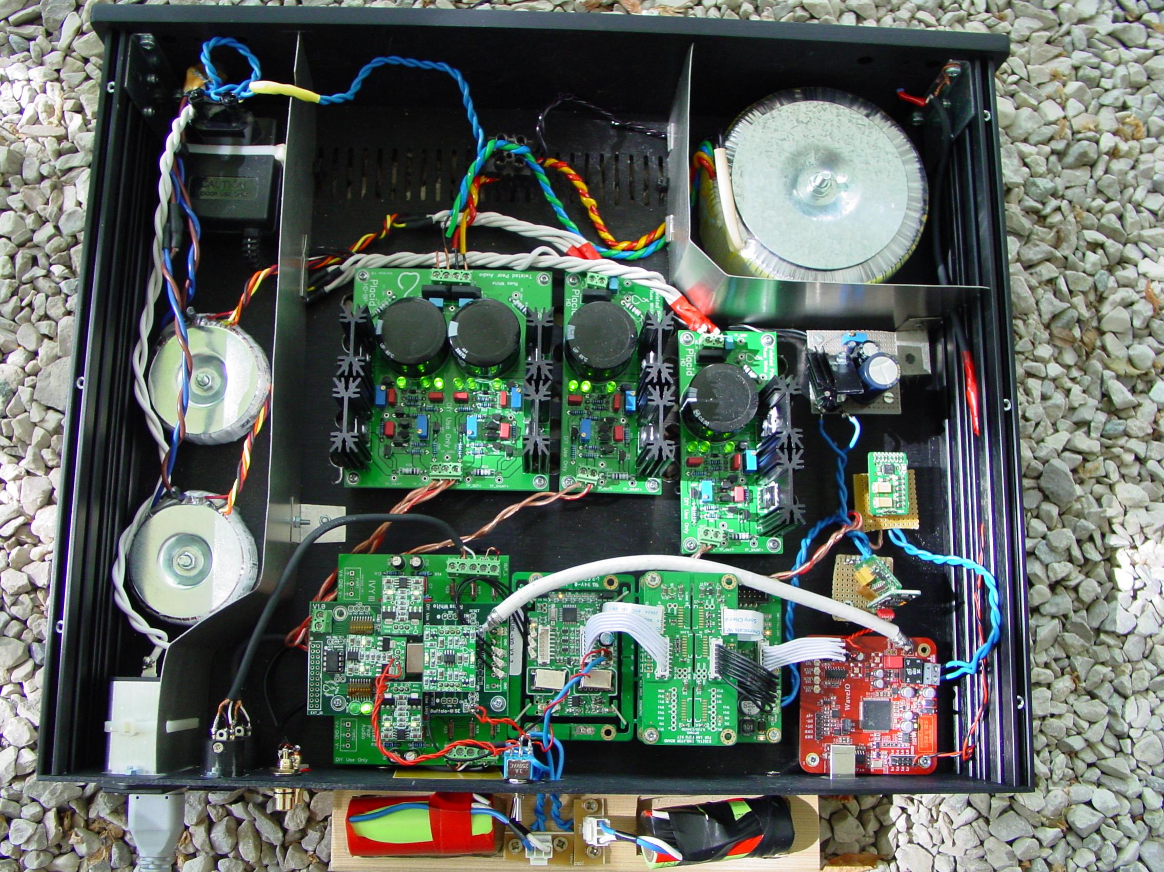

Just finished my DAC. As Luckit WaveIO supports two simultaneous outputs, SPDIF and I²S, and Buffalo DAC supports to switch between two inputs, also SPDIF and I²S, I managed to be able to switch between Buffalo onboard Clock (and SPDIF) - and Ian's FIFO Clock (and I²S). Interesting comparison! Furthermore I realized to switch onboard clock between mains/ shunt regulator supply - and battery LiFePO4 supply, indeed an improvement with the latter. FIFO dual XO board is always fed with battery LiFePO4.

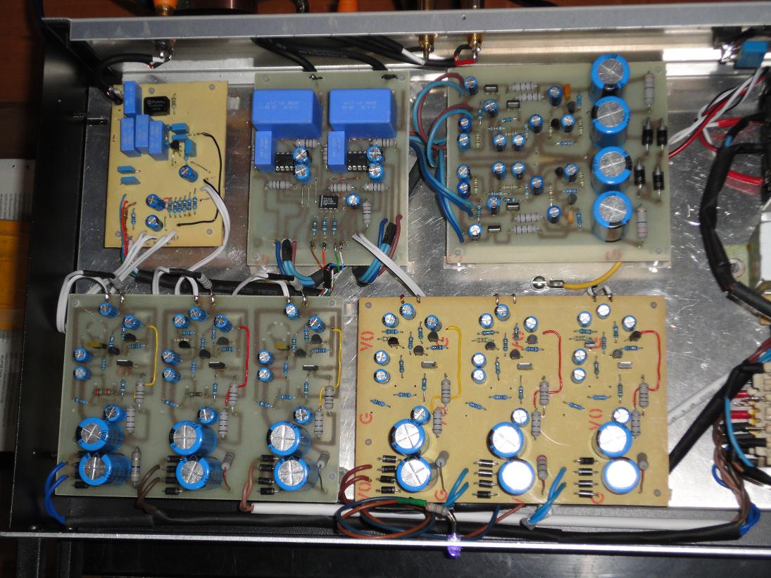

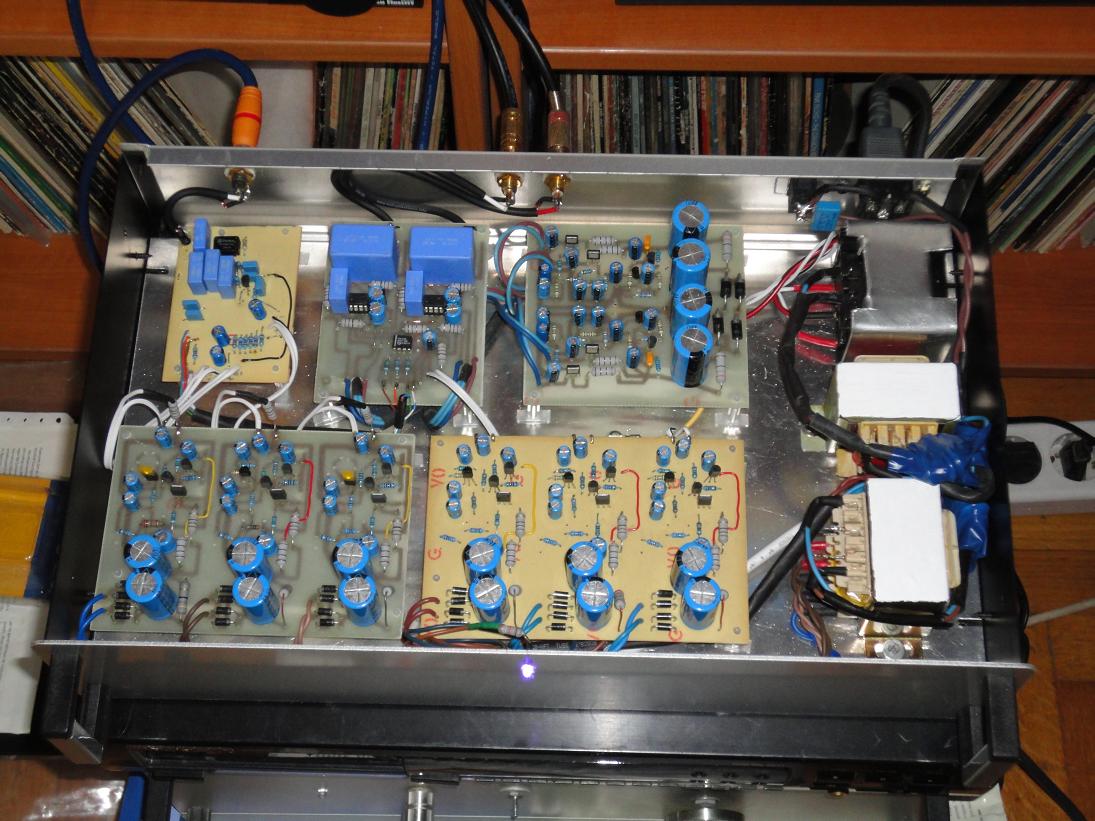

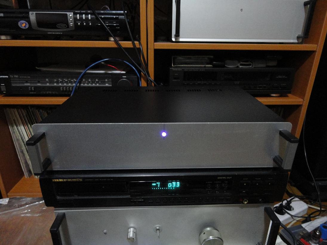

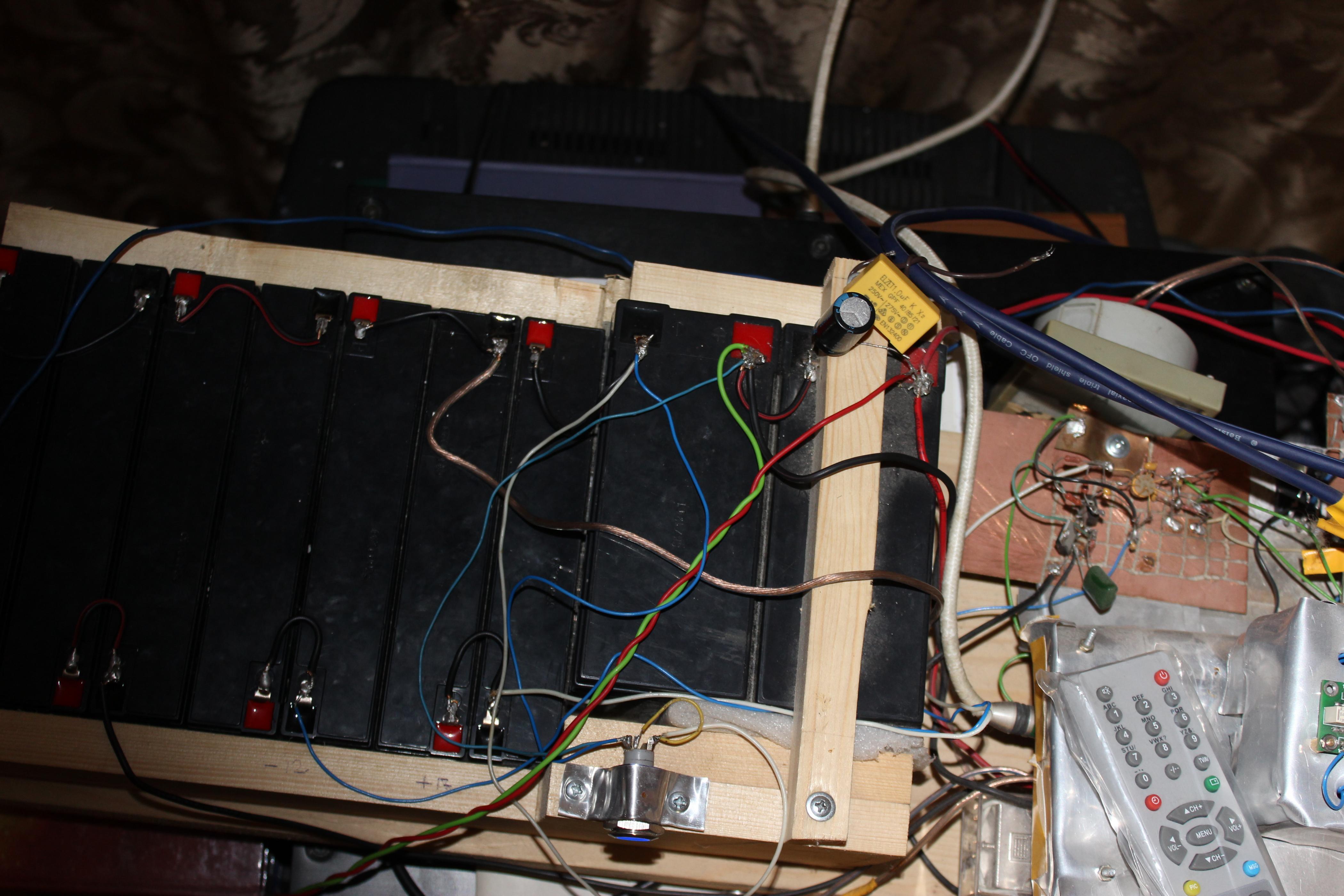

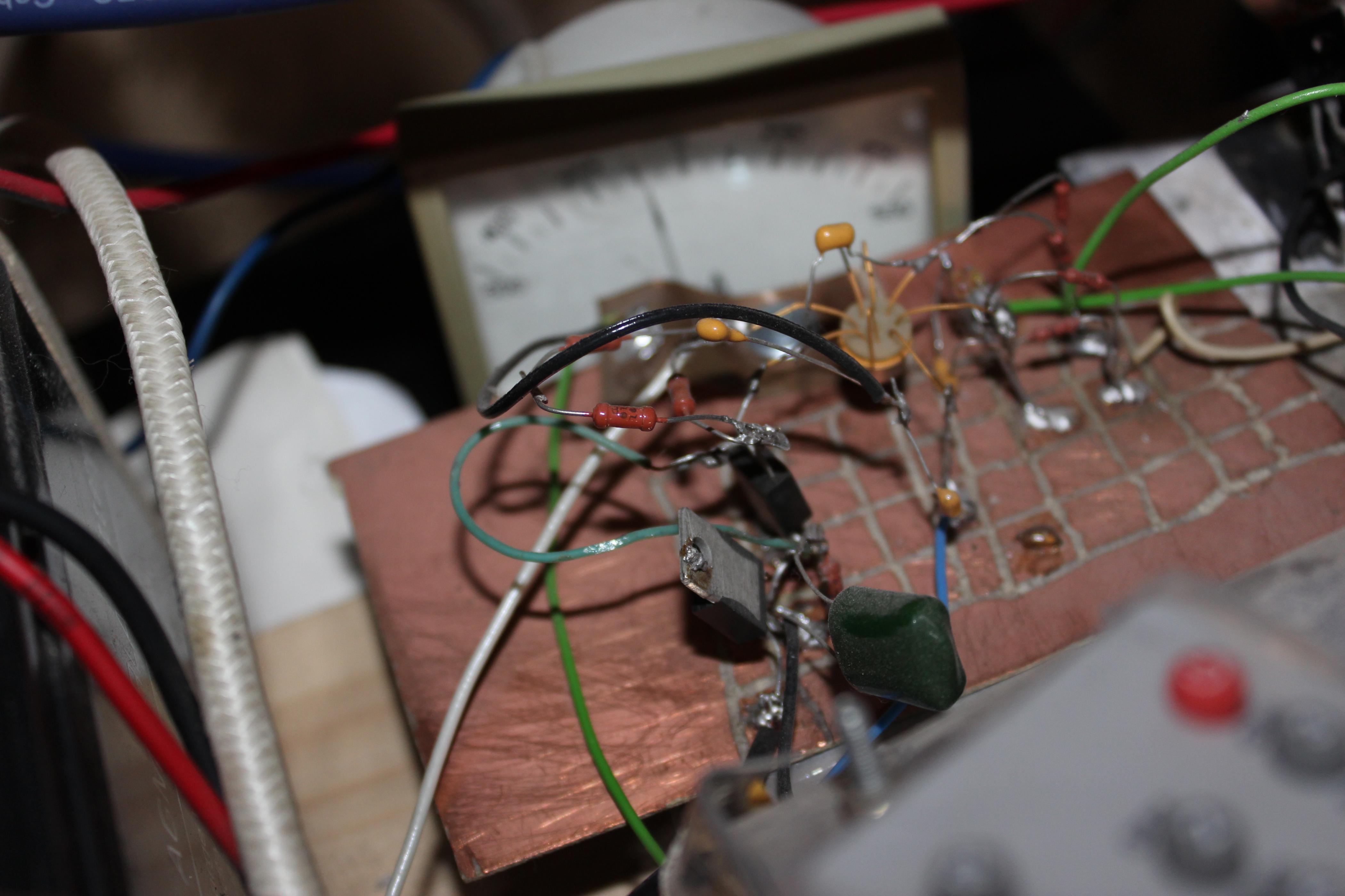

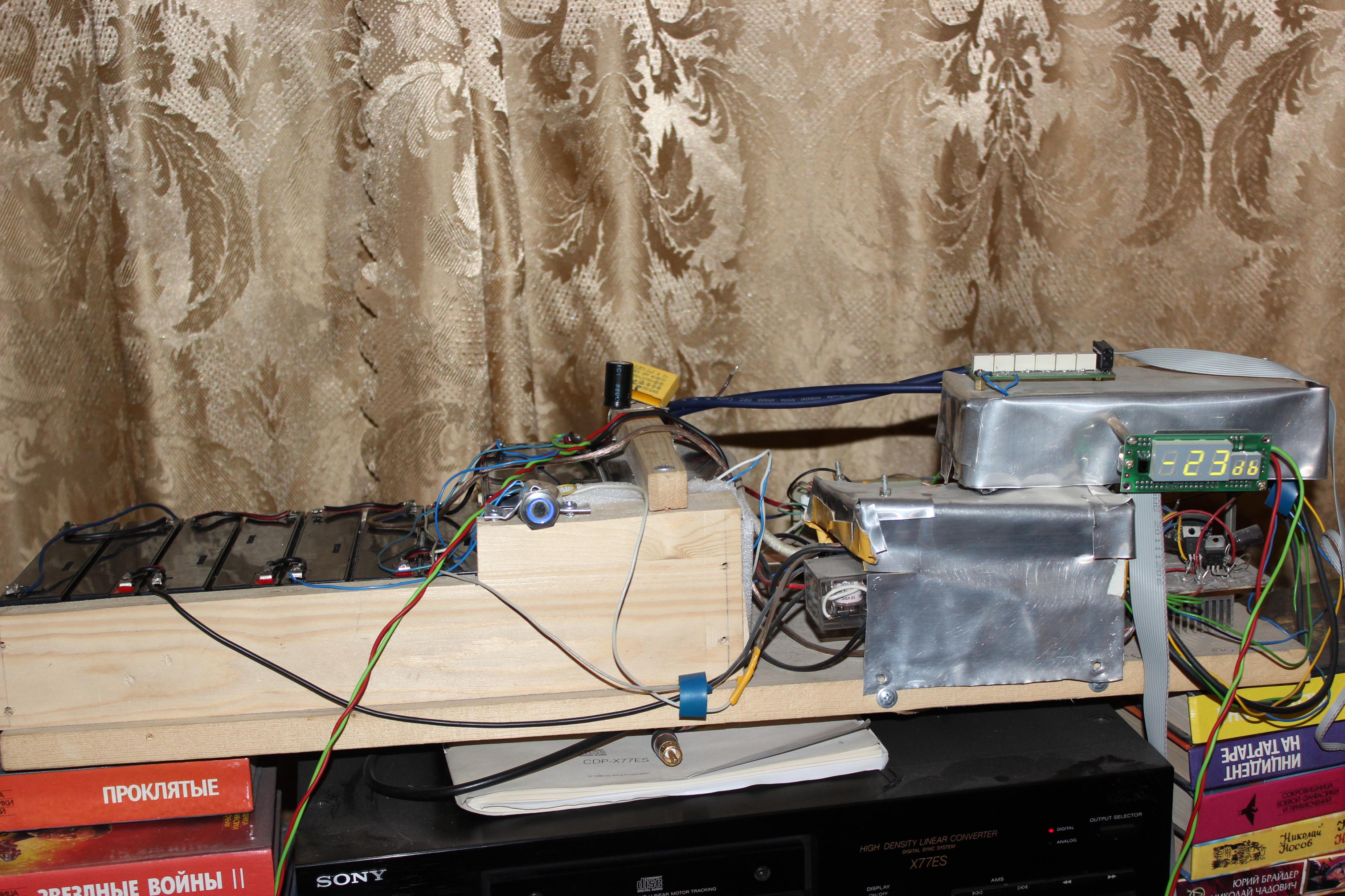

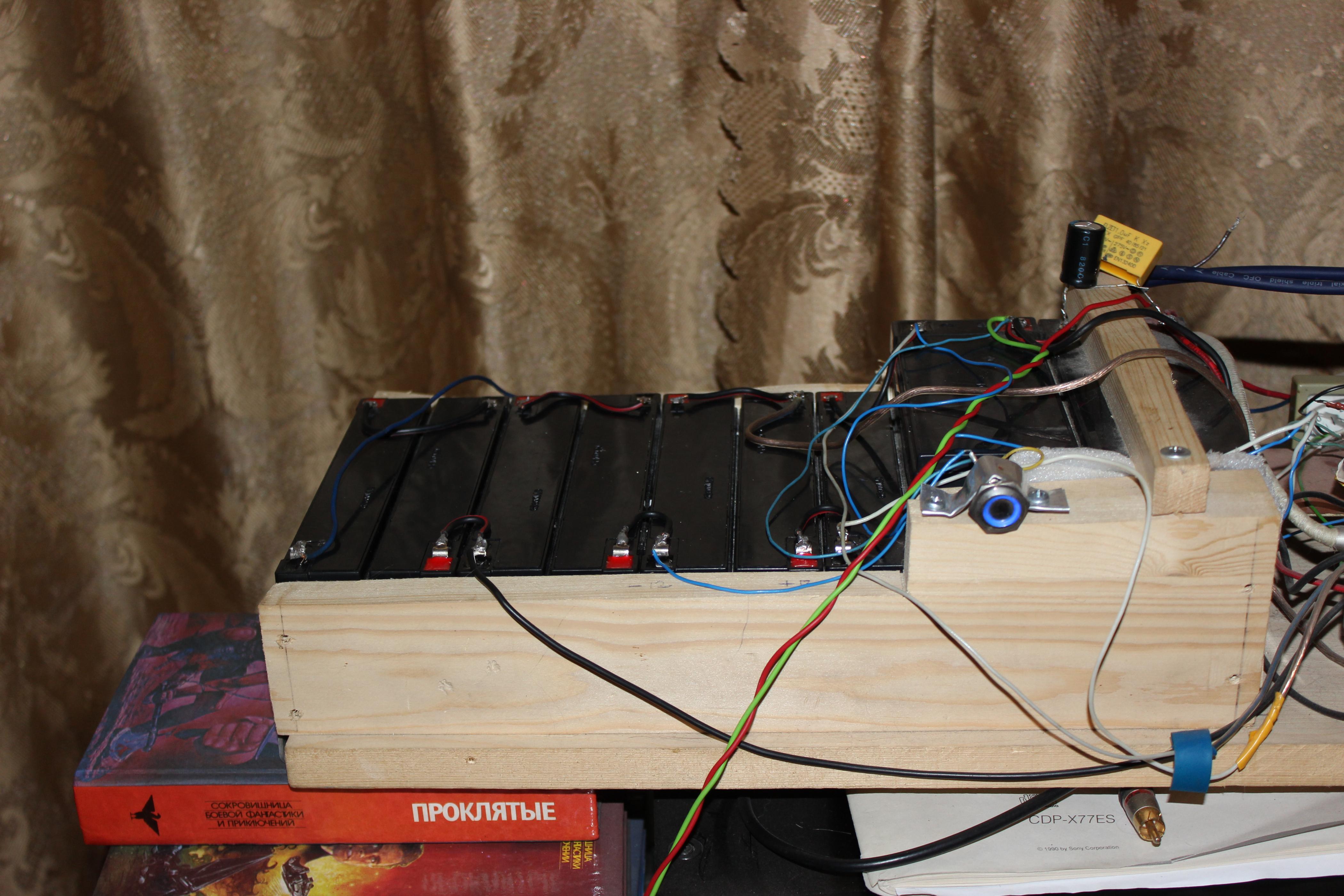

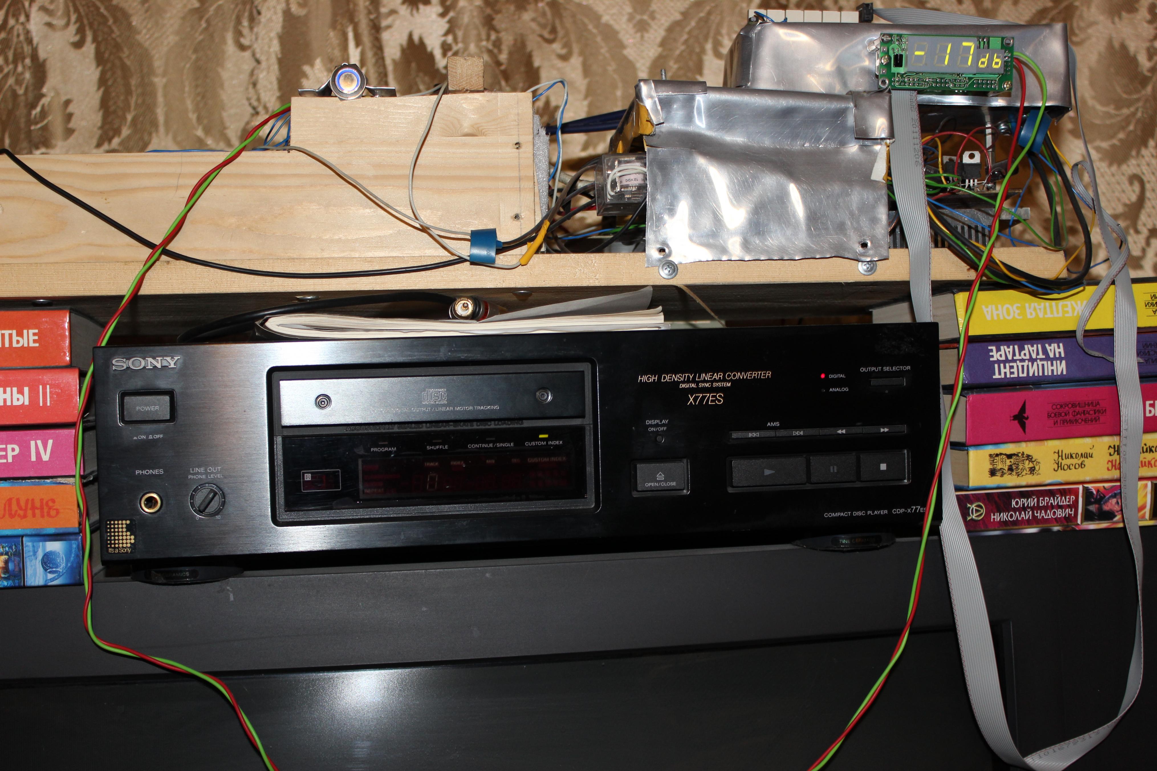

Hi guys, I'm on the forum a few days. I want to share hot news. Photo on my DAC. His appearance is not impressive. But, it applied a new technical solution. Allowing chip RSM1794A, double as a voltage amplifier. For example, 0 dB - 20 volts at the output. The connection galvanic. This solution has been sought by the Eurasian Patent Office. 201300368 priority number from 08 - 04 - 2013. Examination has already been passed. Analogues prejudicial solutions found. In the summer I'll introduce you with this technical solution. In the meantime, I would like to discuss with you the prospects for this DAC.

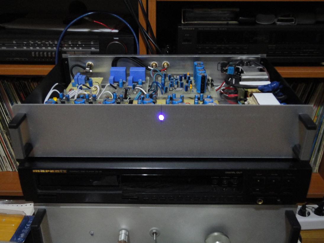

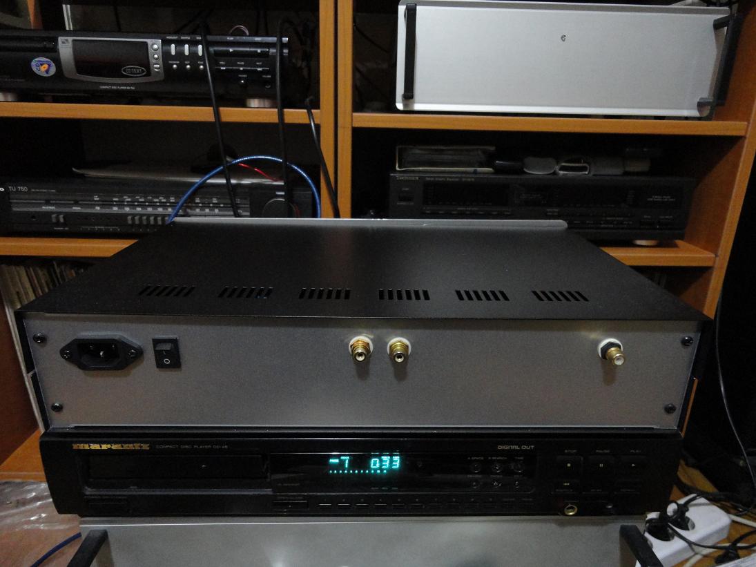

DDDAC under construction.
I am waiting for 1794S mainboard in order to finalize this design...

looks great!
why you covered the supply caps btw? 🙂
why you covered the supply caps btw? 🙂[/QUOTE]
vain attempt ( ? ) to do a kind of electrostatic screen in order to reduce
interference but gorgeous ( ! ) visual effect ( to my eyes )...

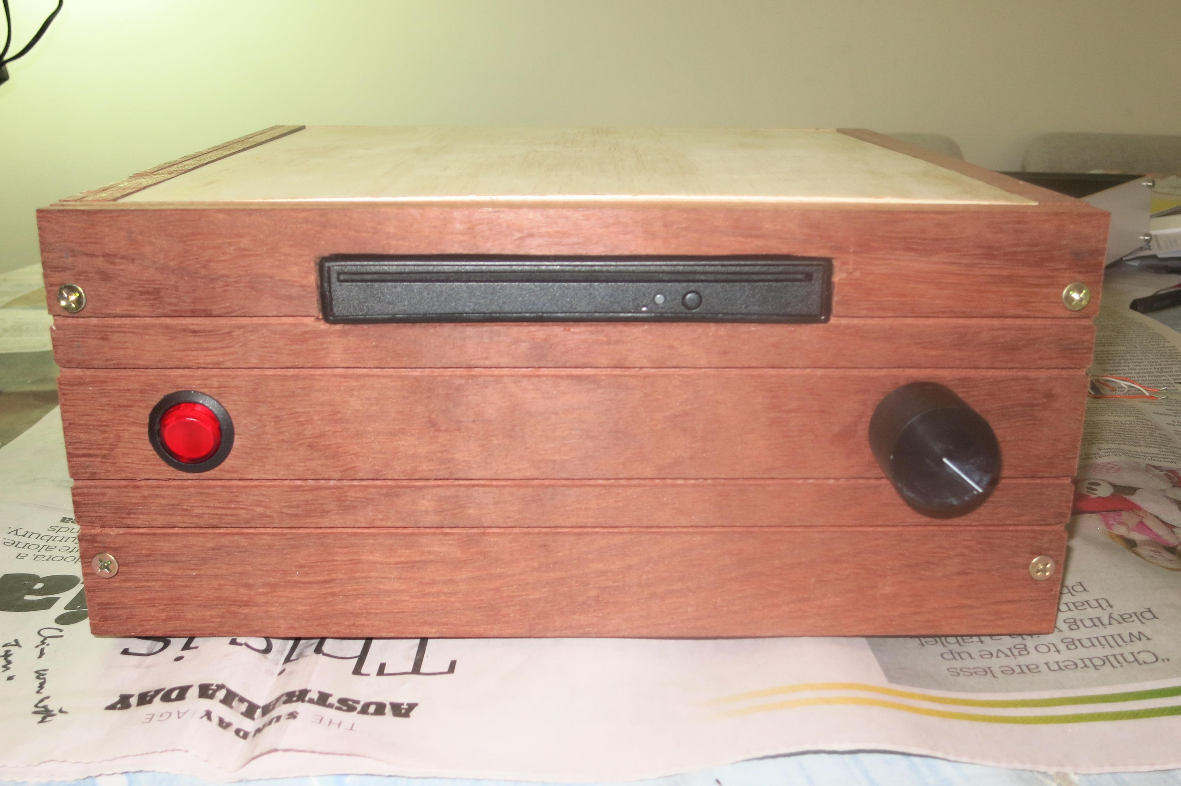

My version of DAC with Tube Buffer output which acts as a Pre-amp. The Dac uses AK4399 Dac chipset and XMOS built-in into the PCB. Viewing the images:
1. Top Left corner is the AK4399 and XMOS PCB
2. Top Right corner is Tube Buffer and pre-amp PCB
3. Bottom left and middle are transformers for DAC and Tube
4. Black casing is the Slot-in CDrom(DVD)
Cheers.

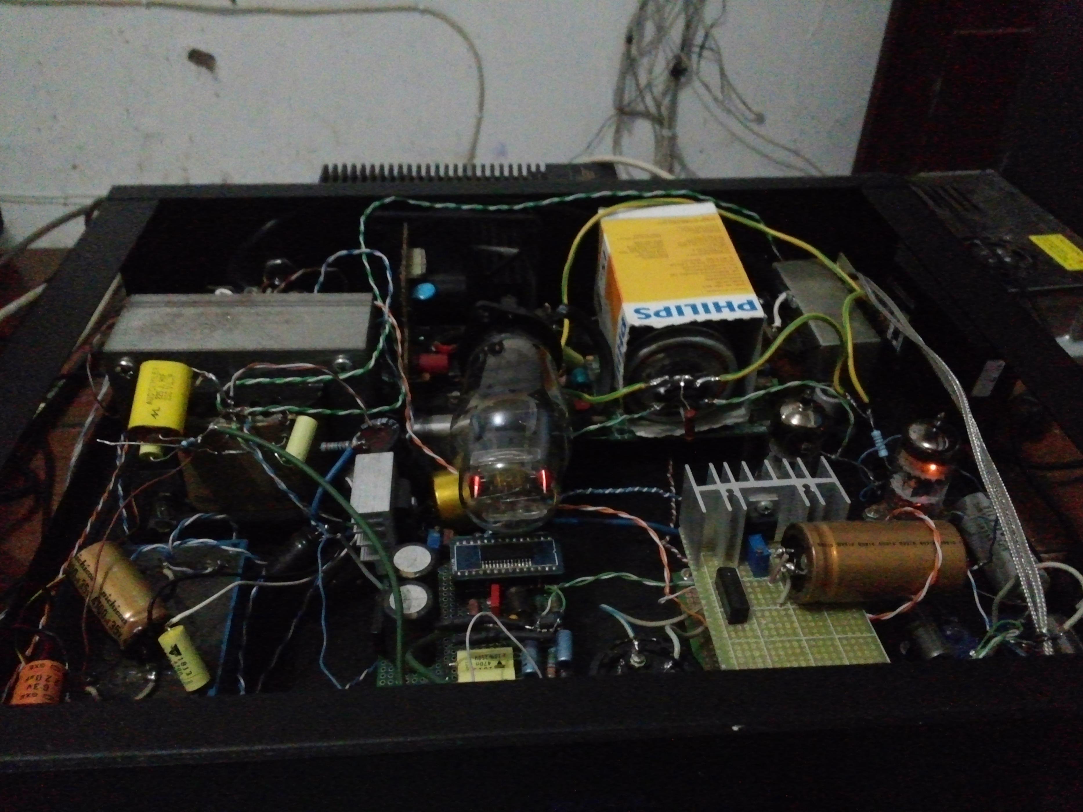

Somewhat messy prototype of tube output DAC based on TDA1541A-S1 teared out from a dead CD player:
Great Dude
This Dac is a little gem !
Thank you very much, Doede...
Great Dude questions
Rock,
What input do you use for this DDDAC? On their site they sell the complete kit with a XMOS USB card, which I see it's missing in your DAC.
I am also interested in the power supply you use. Again, it doesn't look like one from DDDAC. Can you please give a reference for it?
Thank you.
Rock,
Thank you.
Great Dude
ScarF,
this Dac is fitted with 1794S mainBoard...
Only one Spdif input ( the more musically satisfying to my ear ).
Psu board is from DDDAC but i have broken off all the surface dedicated to original power transformer ( encapsulated )in order to swap this one for a 250VA toroid.
My very last version is, now, fitted with a separated power supply ( 300VA / 300000 microFarads / 170 mH power choke ) dedicated to power only Dac modules ...
Custom output transformers replaced Pio capacitors.
Pfm Audio
Regards
ScarF,
Pfm Audio
Regards
Great Dude
ScarF,
Pfm Audio
Regards
ScarF,
Pfm Audio
Regards
