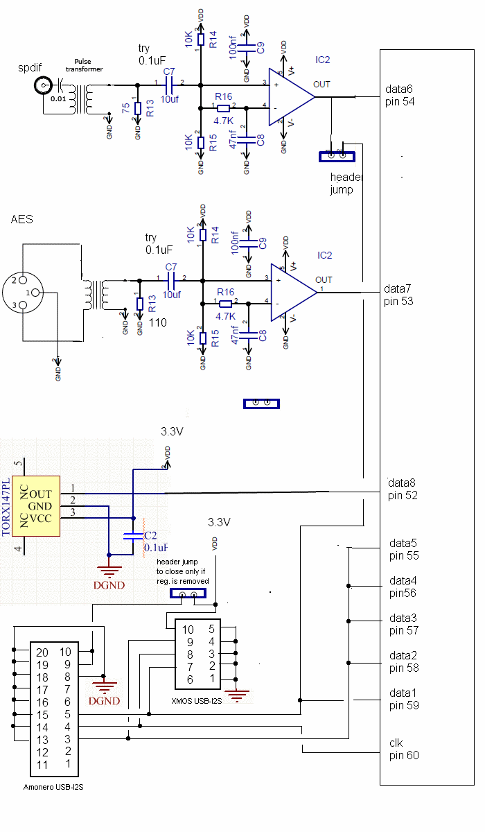

Here the last input circuit to use with both the USB-I2S module and 3 other sources.
It is necessary a micontroller connected to the ES9018 to select the different inputs.
Here the last firmware available for 16LF877.

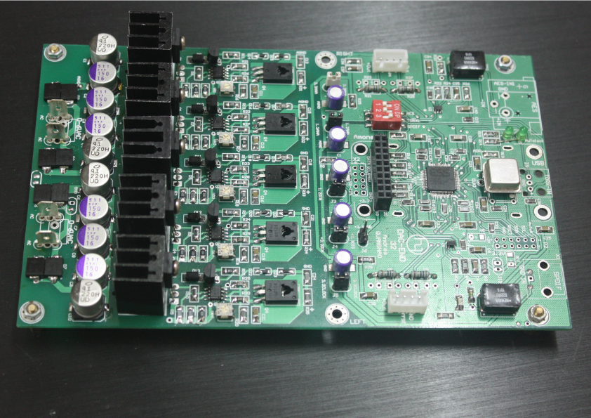

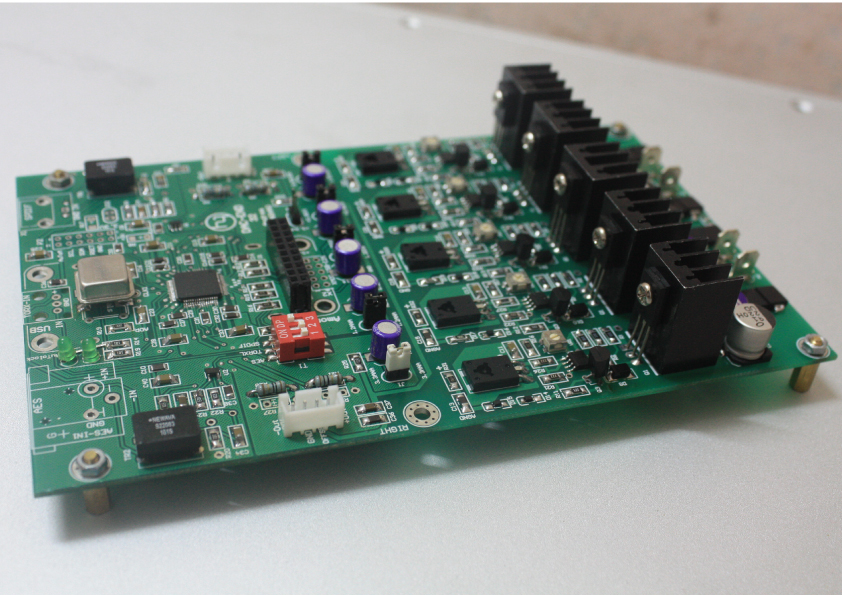

After many revisions Layout has been completed.
With the input
1. XMOS USB-I2S, USB Amonero
2. SPDF
3. Torx
4. AES

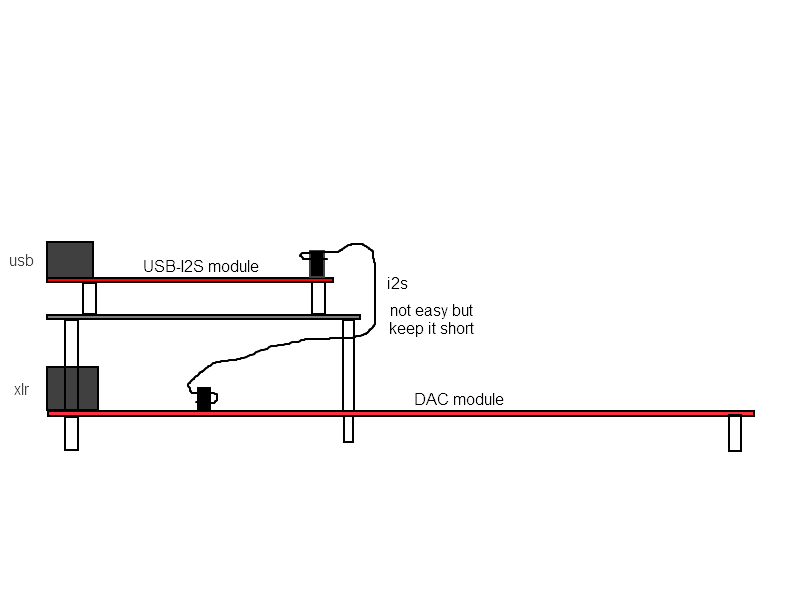

I arranged for the USB DAC is sent on the PCB, to ensure the shortest connection for I2S.
Please see it! Thanks

The test are finished, the new ES9018 DAC with the Amonero module is able to play 44,88,96,192,384KHz, DSD file and SACD iso images.
The firmware remap the DAC to share the same input pin for PCM and DSD without hardware changes.
We will integrate the Amonero module to get a very short I2S wire.

DAC board size: 11 cm X 20Cm.

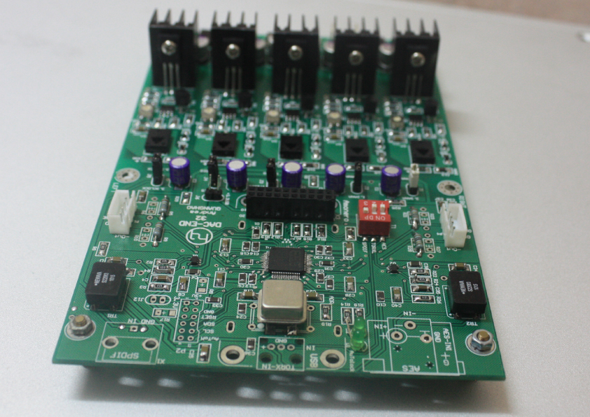

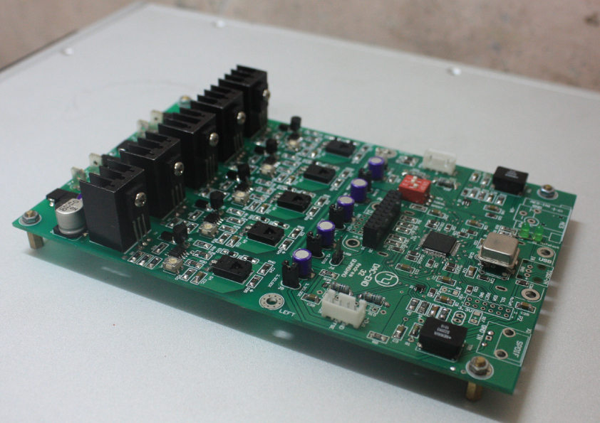

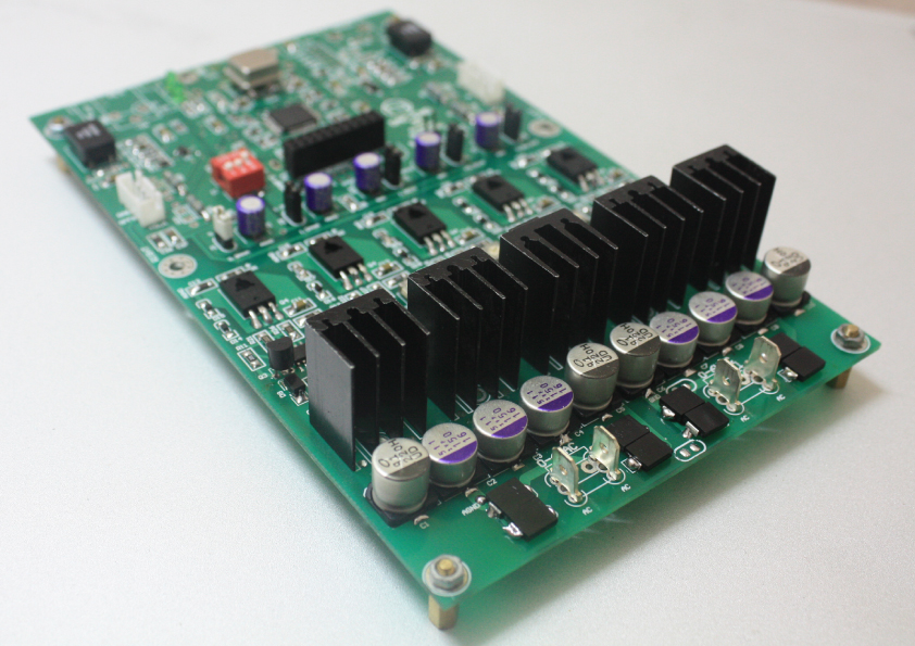

The DAC module develop with Quanghao use separated fast shunt for all the power supply of ES9018 and for the oscillator.
It have 4 input: spdif RCA, spdif toslink optical, AES/EBU XLR professional standard and USB to play PCM and DSD files.
Here some more info about:
