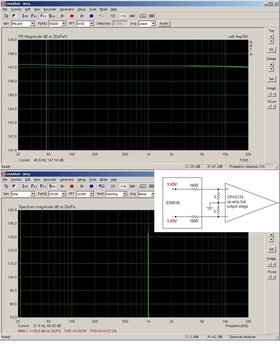

Here the new measurement with low I/V resistances, the LL1684 with a turn ratio 1:1 is not bad

Here the last opamp output stage and the relative measurements.
Some capacitors will be add in the future to create a low order filter for high frequency.

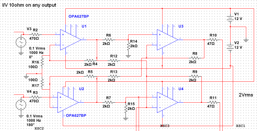

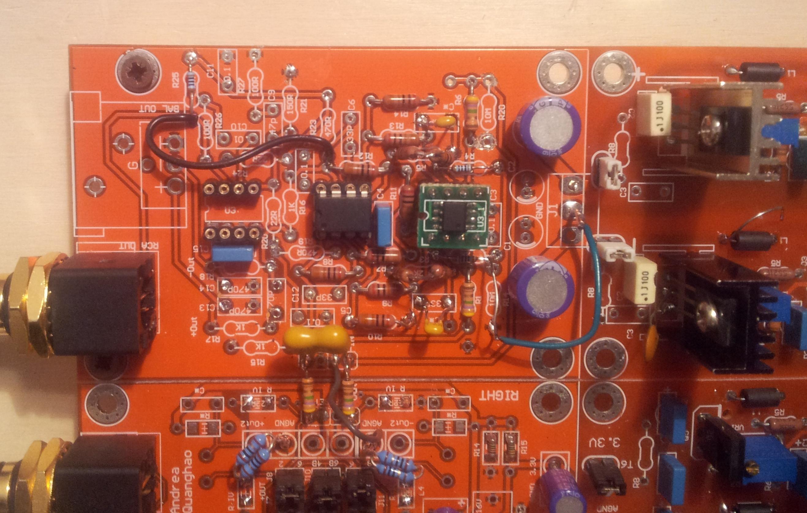

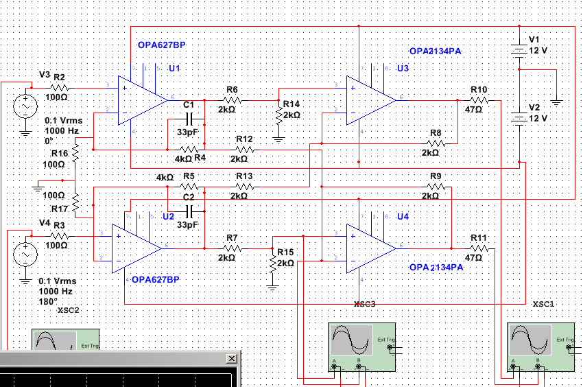

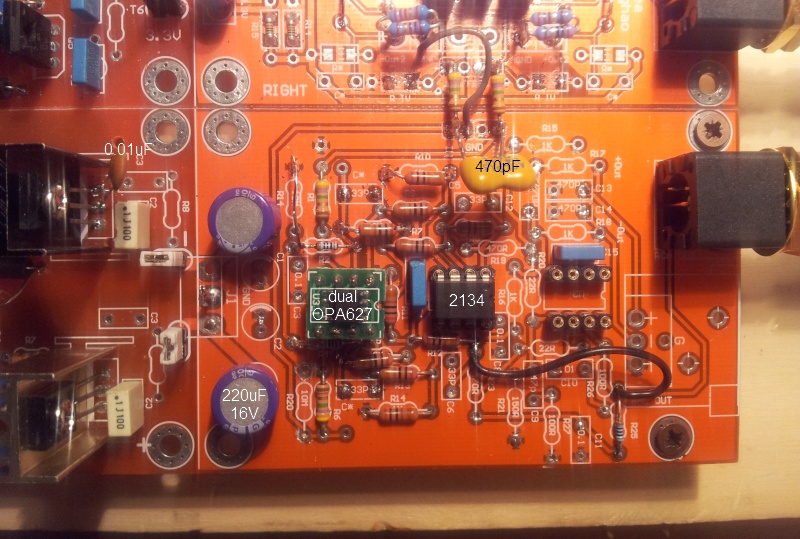

New op-amp output stage.
33pF compensation on first stage
103=0.01uF ceramic compensation on negative shunt
reduced voltage to 12V on outptu stage
OP627 on first stage (with dual chip dip adapter) and OPA2134 on second stage.
now there only a little noise on headphone probably it is possible to eliminate it reducing the voltage gain on first stage and setting I/V resistor to 10ohm instead of 5ohm, I will try soon.

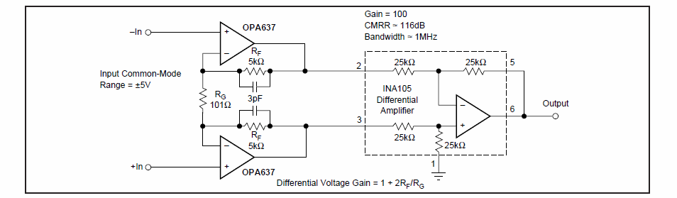

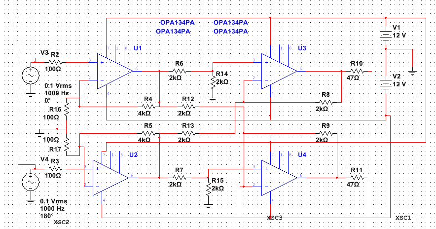

Here the new version of the op-amp configuration OPA627 + OPA2134.
On any ES9018 output I have used as I/V a set of 2 x 20ohm 1% resistance in parallel to have 10ohm.
Now also on headphone the noise is zero and no oscillation also without 33pF compensation.
This output stage is used in Mark Levinson no. 380 and it is published on OPA627 datasheet like a High Speed Instrumentation Amplifier.
The 100 ohm resistances can be connected to ground or not like the datasheet schematic, I prefer lock to ground (test the sound).
