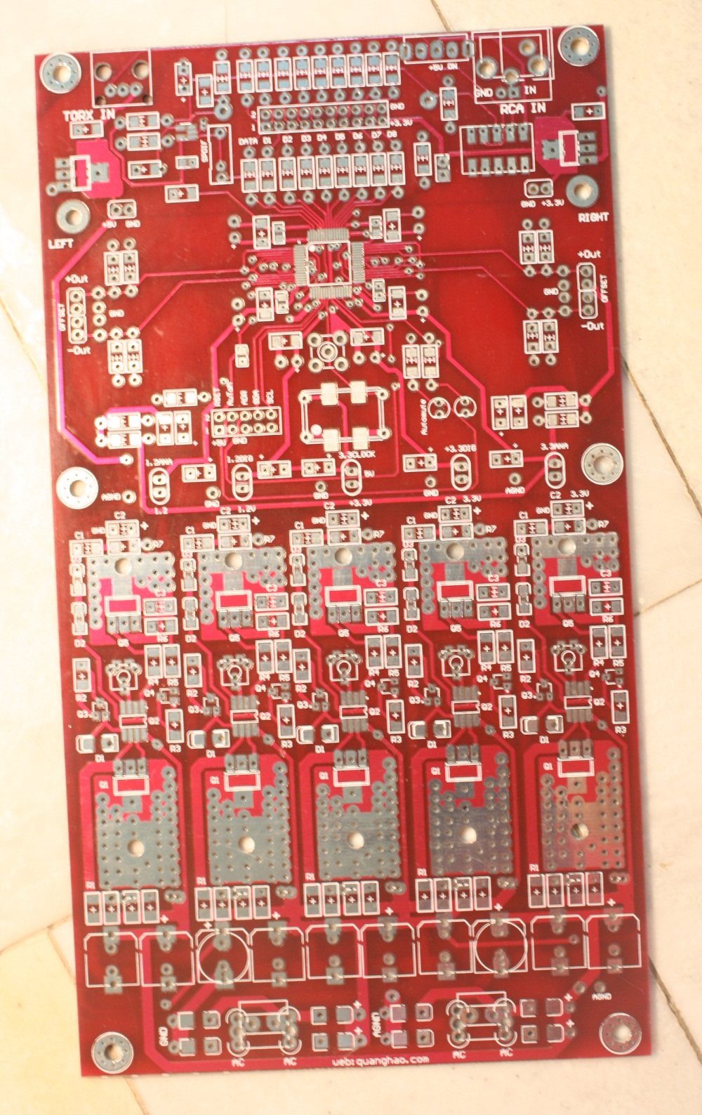

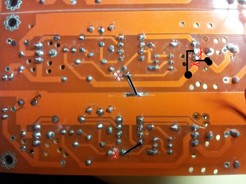

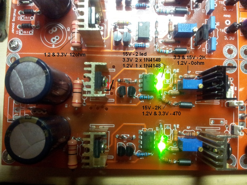

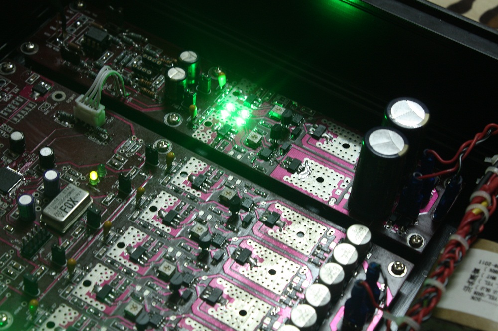

Here the last modification on shunt power supply.
I have found a little error on the pcb about the negative shunts on CCS.
The 3.3V (VANA) and the 1.2V (CORE) should have 12 ohm 2W on CCS instead of 22ohm to support higher current.
All the shunt are now stable without capacitor compensantion and work very good.
The reference of voltage has been connect on output to reduce the noise to zero and it is impossible measure it.
I am considering to add on output stage a BUF634 to drive an headphone.

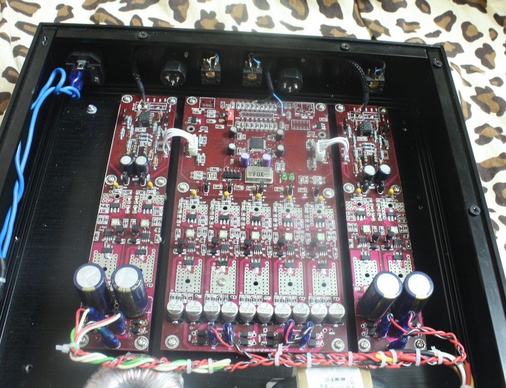

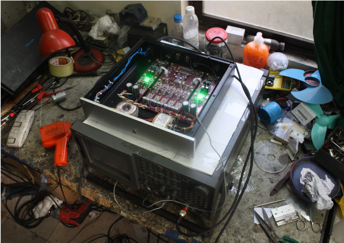

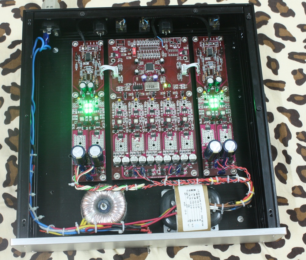

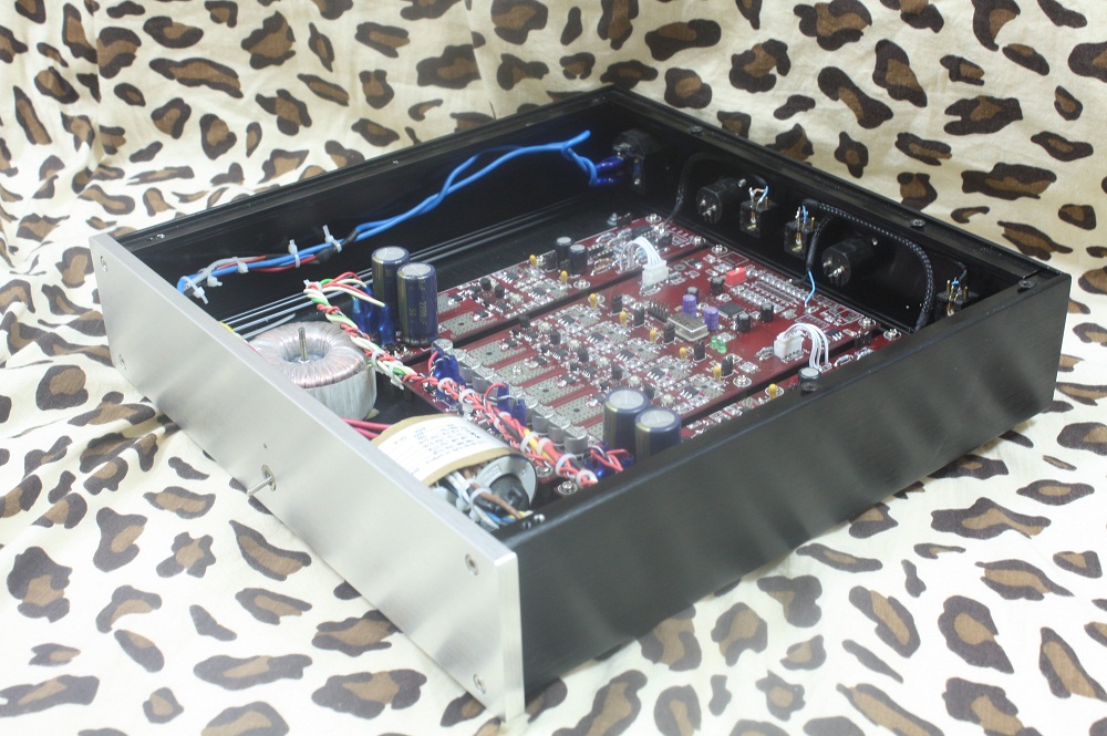

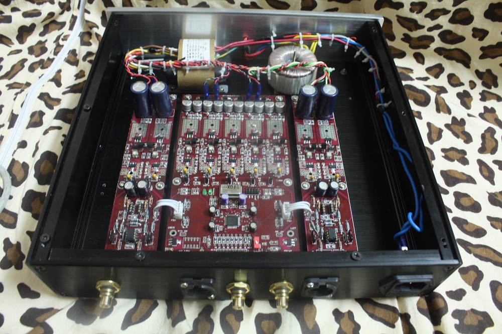

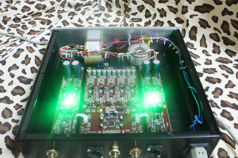

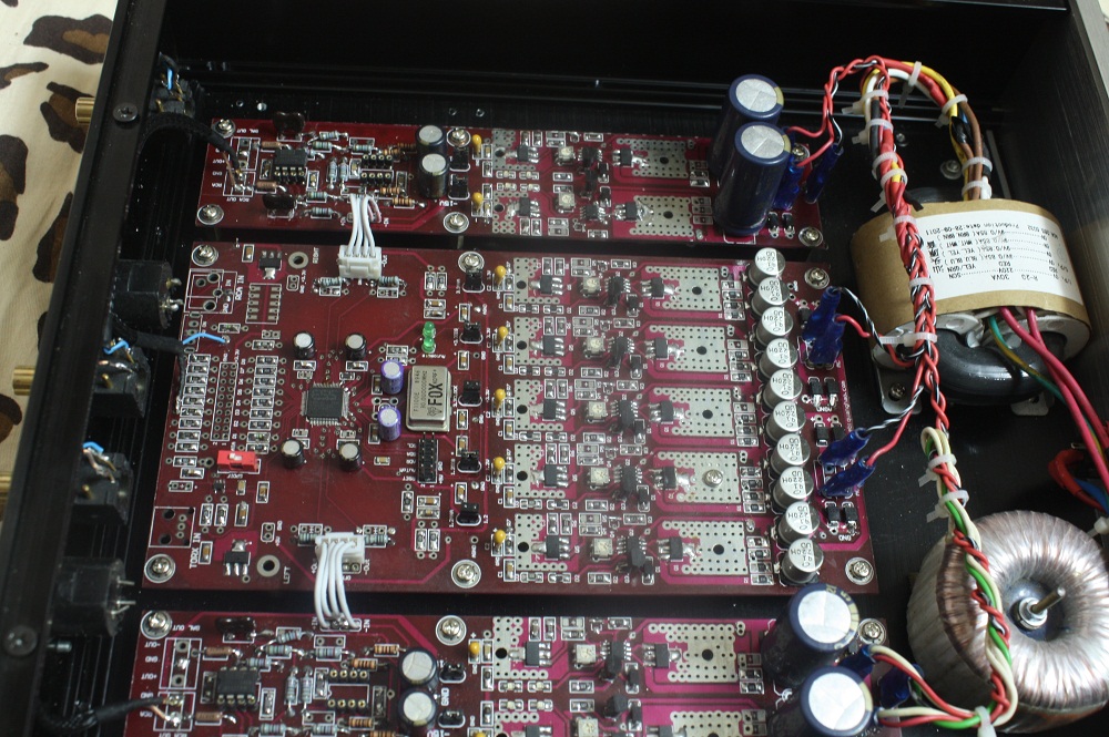

I have finished Test all PCB DAC-END R!
Today, I have finished DAC-END R, My work nearing completion.The test PCB is finished. I am very glad
Here are the pictures.
Please see.
Please see.

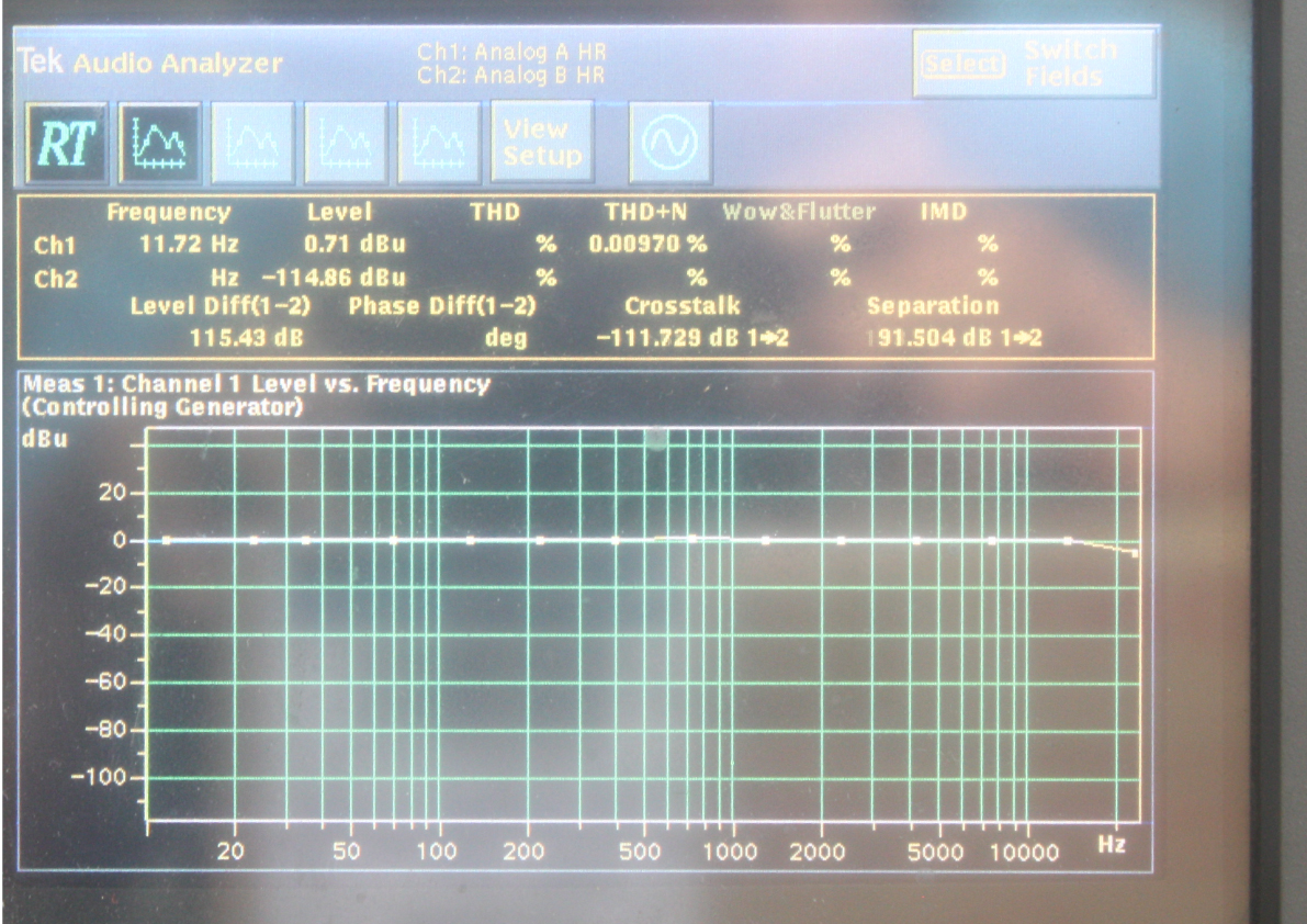

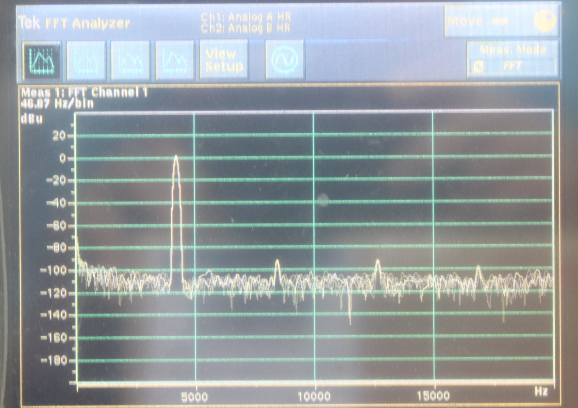

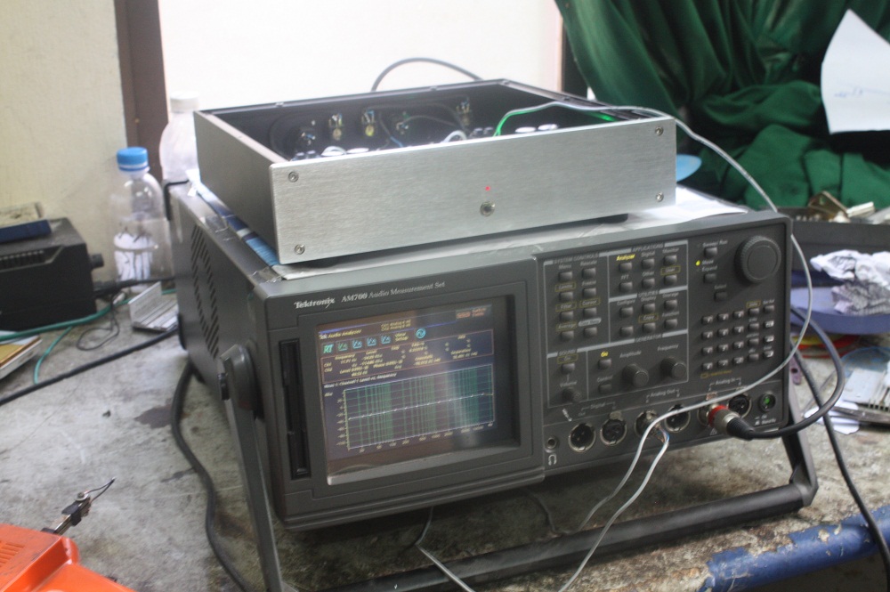

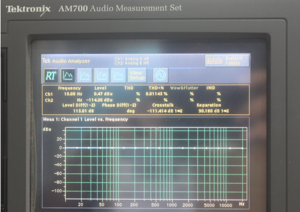

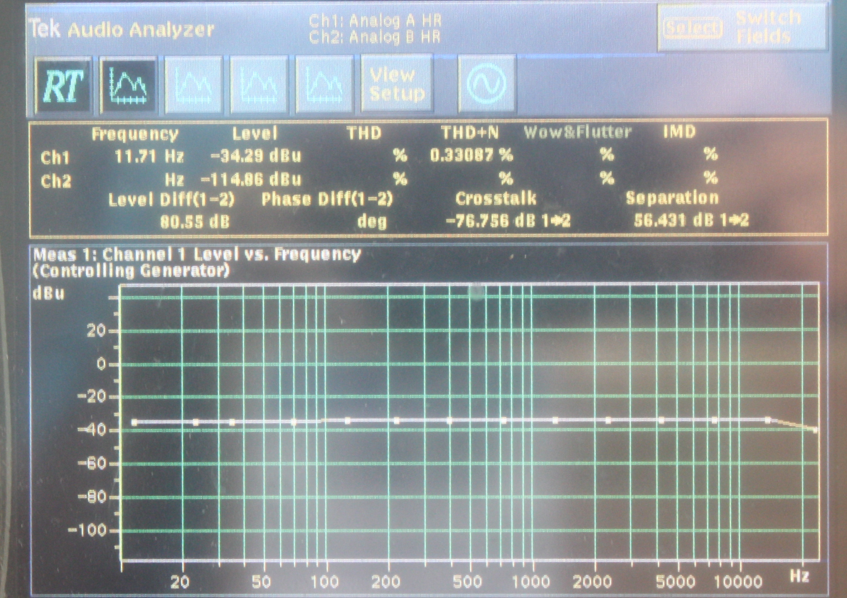

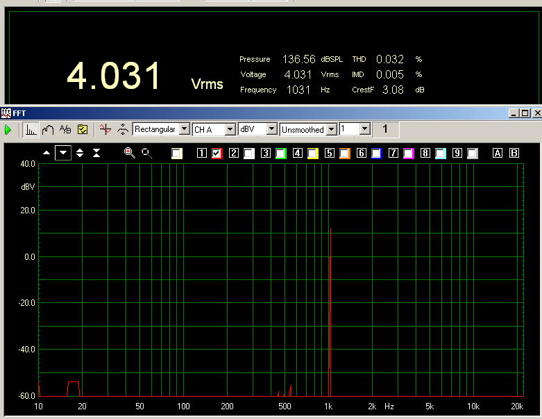

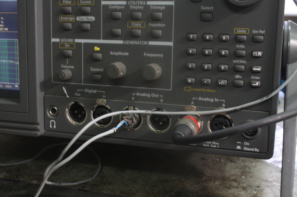

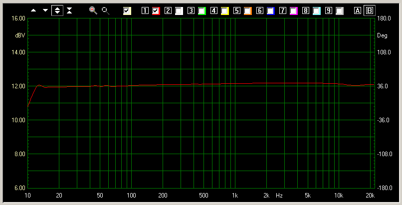

Hi all!
QuangHao really excited and happy with the sound quality, particularly measured parameters of the DAC-END R:
1. I used the tester Tektronix AM700
Signal to blance
Output balnce
2. Measurement parameters:
Frequency range of 0 - 80KHz, at 0 dB, very flat from 0 to 35kHz.
Frequency range from 0-10kHz, 0 dB, very flat
Harmonic distortion almost did not see the.
3. Conclusion:
With this measure, the sound of the DAC-END R will be very honest, this proper design criteria of Andre and me. I am very pleased and surprised at the actual measurement results, as well as listen to.
Invite you to view images
thanks a lot!
Quanghao
Signal to blance
Output balnce
3. Conclusion:
thanks a lot!
Quanghao

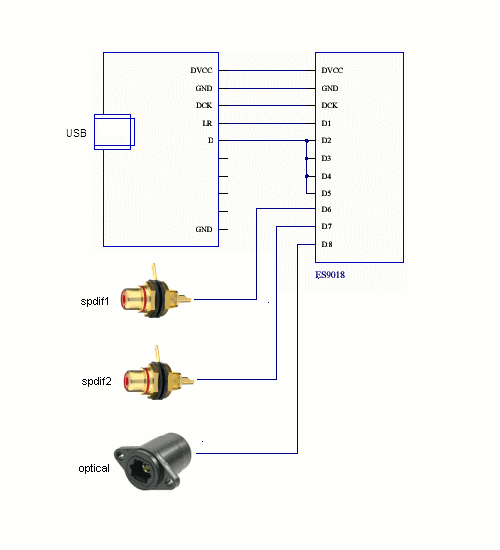

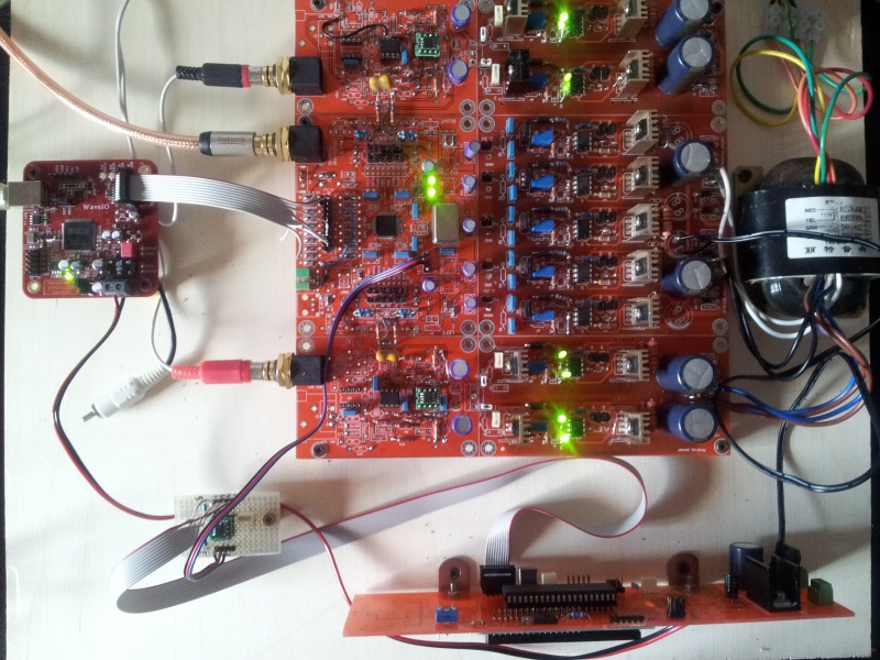

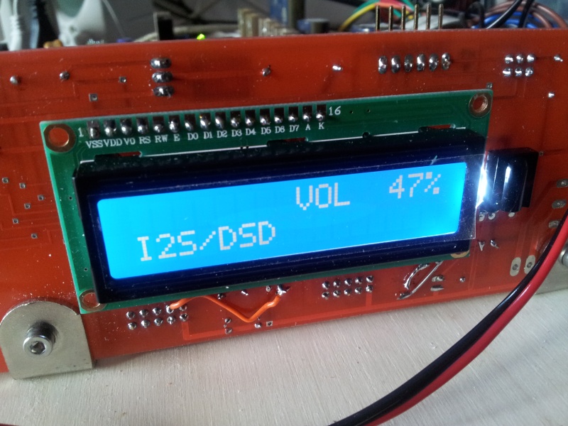

Here the first firmware to control the ES9018 with a 16F877 microcontroller.
1) Input selector I2S, Spdif1, 2 and 3 as image
2) Volume control
3) Mute function
4) Optional XMOS module check
5) All function set by remote control
For the test I have used the my AD1955 controller
http://www.audiodesignguide.com/HiResolution/usbdac2a.html
+ P86B96 chip to convert the I2C level get a bidirectional 5V to 3.3V.
2) Volume control
3) Mute function
Here the new firmware and some photos of my test environment.
At this time I am using the XMOS module by Lucian but I will try soon also the Amanero module (Amanero Technologies).
Using XMOS module the actual firmware can display USB status and sampler frequency.

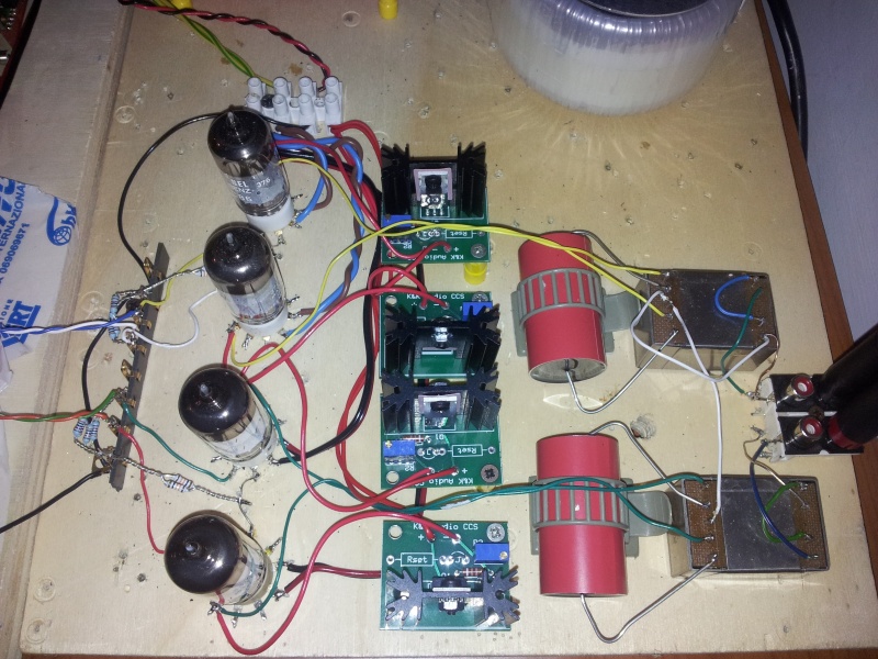

I think the problem on the ES9018 DAC is the high feedback of op-amp so I decided to test it with a vacuum tube output stage.
The my choice is the Raleigh Audio Line Stage clone, a Differential parafeed line stage push-pull with a pair of CCS (constant current source) to isolate the power supply from the signal.
http://www.audiodesignguide.com/HiResolution/Raleighaudio1.jpg
Chapter 4
USB DAC 2 - Hi-Resolution System
Using a pair of ECC86 for each channel is possible to get a good result.
Here the first measurements of the output stage only.
To get 3Vrms on output it is necessary use 20 ohm as I/V instead of 10ohm.
The detail and definition seemed more good with ES9018 but the sound was too dry and not very musical.
Chapter 4

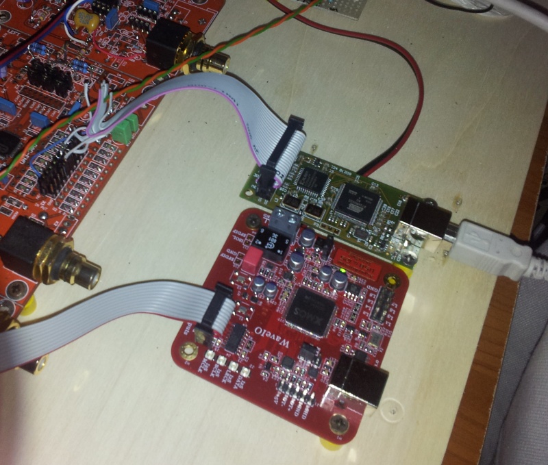

I am testing the Amanero USB-I2S module.

This evening I made a listening session with a my friend to evaluate the differences between the USB-I2S module with XMOS and the new Amanero.
Both the modules are superior to previous models I have tested: M2Tech and Open Source.
The Amanero module sounds more open but also less solid and less smooth of XMOS module. The XMOS module sometimes seems more confused but it also have a larger image of the acoustic scene.
Changing the interconnect cable between DAC and amplifier, from Silver Resolution Reference Analog Interconnects by SignalCable to SilverMIca Zero-One by Voodoo Cable, the sound of Amanero is very close to the XMOS.
I do not understand why Amanero provided for the module power from USB only, I will ask if they can make the change.
The Amanero can paly also 32bit 384KHz and DSD files (SACD format) but I still need to test it.
