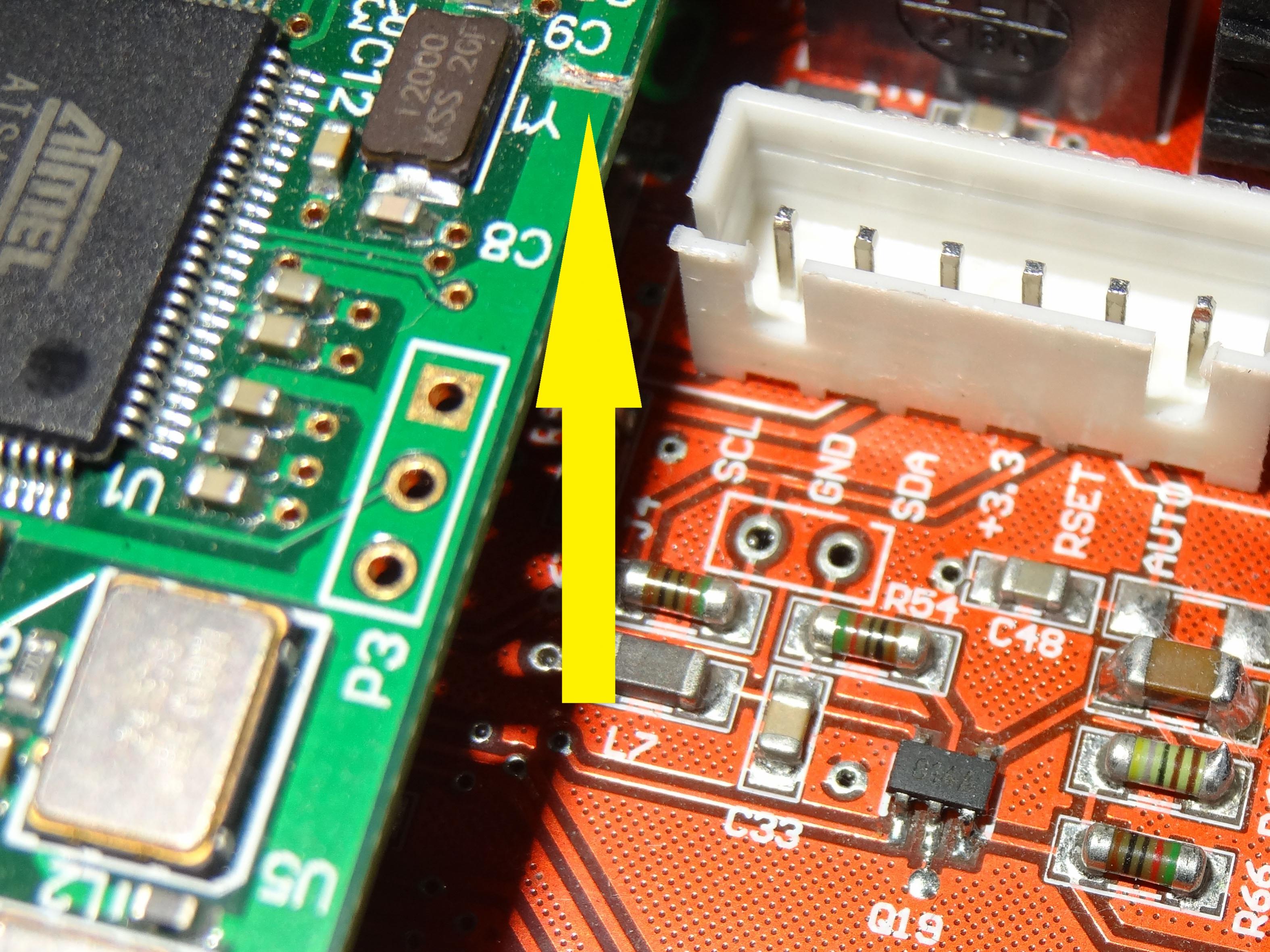

Thank you very much, I will stay with bus-powered. I will not try to de-solder anything, having already ruined coaxial and AES BU inputs in de-soldering bad lnv7219 (although I- and many others - paid for good ones...). I don't want to ruined the Amanero board too... As I bought Amanero module from Quanghao, I could have expected, if this modification improves sound quality, that it would be done before sending it to me. But I am probably dreaming...

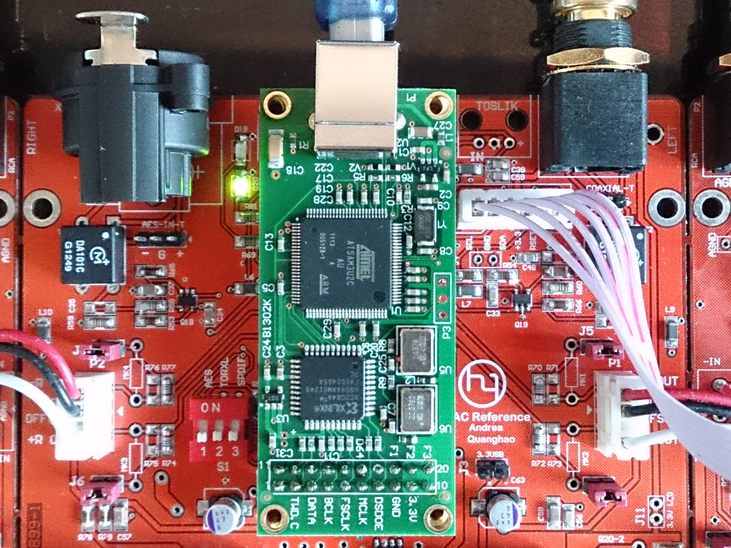

Another point, the 20 point connector is free, unsoldered despite it is necessary. Am I supposed to solder to the board on the reverse side?
I am sorry to hear that you've ruined the coaxial and AES inputs😱
The 20 pins connector has to be soldered so that the pins are facing the downward.
If you want to power the Amanero board from the DAC board instead of bus powered, just scratch a break on the Amanero board as in the picture and pull the J3 jumper off .🙂
i cut it, for not use suuply from computer fir Usb.
better use 3.3 v from DAC.
thanks

If the dac lock to the spdif input( please verify the at display ). Then try ti set the dac to "bal" balanced mode again.
The balanced mode refers to the dac chip only, not the assamled dac.
This unbal/bal function can be used in unbalanced mode only if an unbalanced analog curcuit is connected to the digital board(the big board inside the dac.
Br
Caad
Okay.... Just tried to connect with a source with 48khz, was not possible....
So I have to order these LMV7219 and solder them there ?
To verify if it is a lmv7219 issue then try following.
The lmv7219 are placed at the coax and aes inputs only. Try to connect via optical input. This optical input can handle up to 96khz.
Does your dac have the usb Amanero board attached? In this case you should try to connect a pc via this input.
If your dac not include the usb amanero board, then you can order one at amanero.com if needed. I believe your rasp pi have an I2S output also?
Info: The amanero board vonverts usb to i2s (and dsd).
In this case you can connect your rasp pi board direct to the dac via the pins for the i2s input? You can see how these are connected at amanero.com
