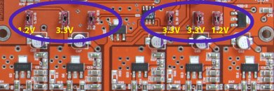

Hi
The Jumpers between the shunt Regulators and the ES9018.
I have seen bad connections in the these Jumpers.
You can unmount the jumpers and solder the 2 pins of the Headers instead of using the Jumpers.
Please see the dedicated Jumpers in the pic.
Please note: I have only seen this topic on the Version 1 DAC (The DAC with 16*2 Display).
Br
CAAD
