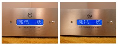

The HiRes DSD on display just looks so cool!🙂

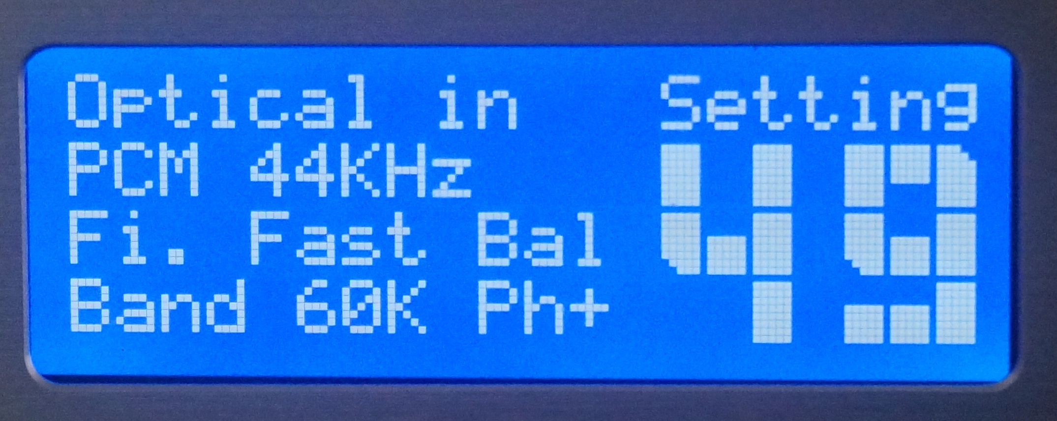

On the remote, press lower left (or right) button to go into advance settings, you will see "UnBal" there.
Then on the front panel, press S-/S+ at the same to change UnBal to Bal.

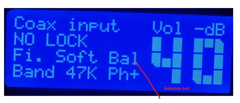

your DAC run at Balance out, see image
I see only not have in put!
Ok, I have run at Balance out and Unbalance out - several times.
I have tried Coax, Optical and now Usb. No sound.
I just don't understand what i am doing wrong. This should be easy - i thought ;-)
Could you please show me some pictures of how the display looks like when you have an input.
PeterKD

Which output stage are you using ? (LL1684 or discrete solid state output)
Solid state, 70 W, Burson (australian).
If I understood you right.
your dac run good with image
