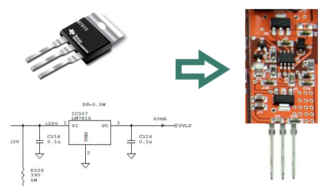

With the high sound resolution of this DAC, I have a feeling that my amp can't keep up with it. I‘m thinking of upgrading the LM7815 and LM7915 power regulators that are powering the preamp to extract more details. Do you think it is possible for Quanghao to produce some 3-terminal shunt regulators (based on the IV Stage HAK-shunt design) for us to upgrade our LM7815/7915? Thanks 🙂

We can think about

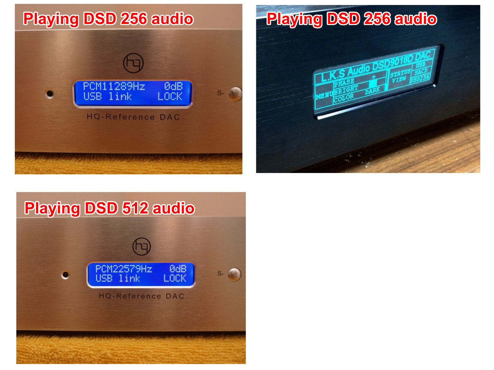

This ES9018+Amanero combination is phenomenal, I managed to play DSD 256 and DSD 512 audio on it!
However, when I play DSD 256 audio, the LCD only shows PCM11289Hz,
and when I play DSD 512 audio, it shows PCM22579Hz.
Nothing wrong but it would be much more elegant to show it as "DSD 256" and "DSD 512".
Is it possible to update the firmware to display "DSD 256" and "DSD 512" properly? I noticed that the ESS-Amanero-base LKS DAC can display it. Thanks.
(For info, the official DSD Spec is: DSD 256 - 11.2896MHz, DSD 512 - 22.5792MHz)

Hi Andrea,
Loaded the firmware.
Now the LCD shows DSD 256 and DSD 512 properly!
But it has these bugs:
1) The volume is very very soft (for PCM and DSD). At 0dB, I need to turn my amp knob to 2pm (instead of of 8am) to hear some soft sound . Your last firmware (v64a @ your post #2154) also has this problem. The latest firmware that the volume works properly is v58a @ post #2019.
2) The start-up default source should not be "Optical", it should be "USB link".

1) I have compared now the code 58a and 64a but there is no difference in volume setting so both will work in the same mode
2) to set the default source after the switch-on enter in setting mode and press power/lcd botton to save this configuration
