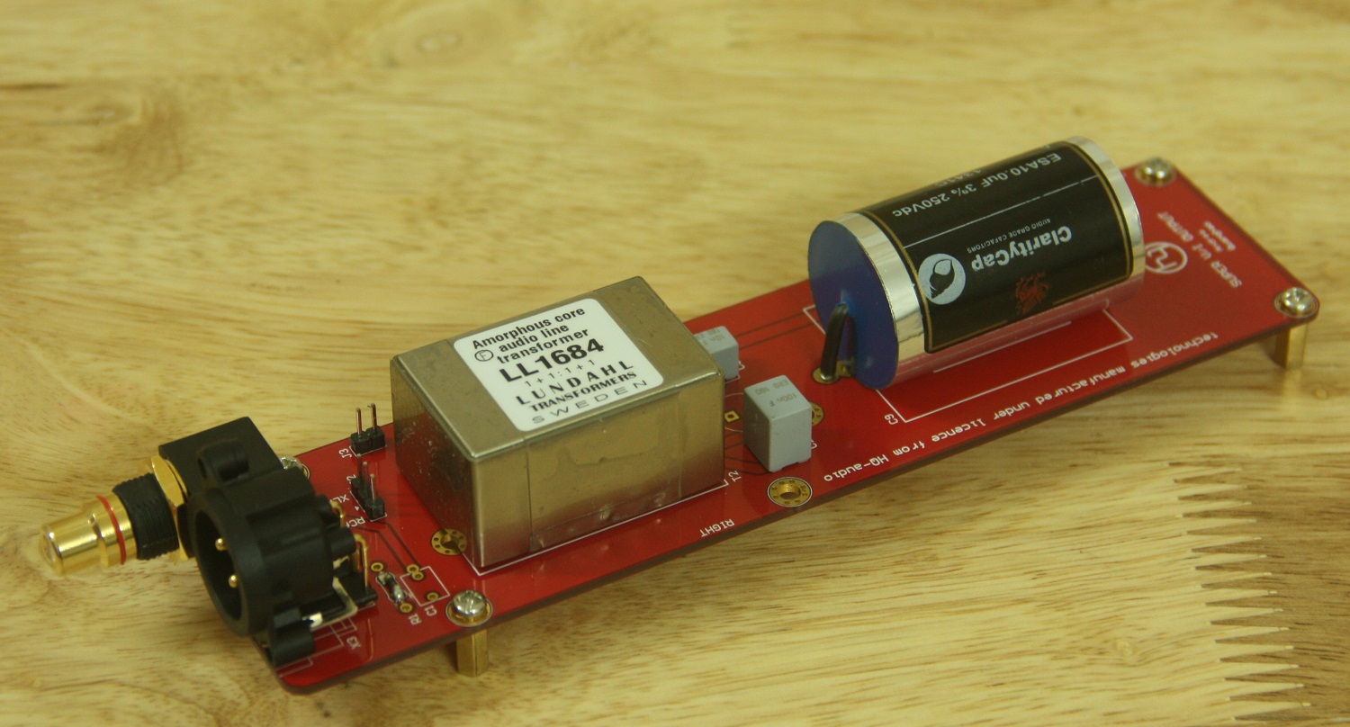

I open GR for PCB LL1684 in this :
Interest list for LL1684 PCB SET (2 channels):
1. NicMac, 1 set (possibly also the transformers)
2. palmito, 1 set
3. Misterwolf, 1 set
4. rredline, 1 set
5. audiodesign, 1 set
In about 15 days to complete PCB!
Thanks for your interest!

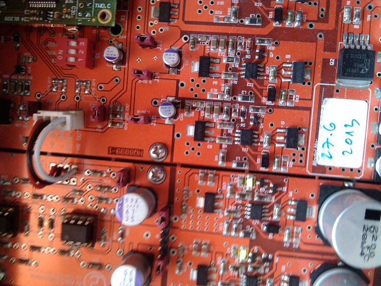

After receiving the final version of DAC modules we have detected a very little oscillations on shunt regulators in high frequency range (about 150KHz).
Measurements and simulations made with the collaboration of CAAD allowed to find a simple solution to this problem.
To make this modifications are not necessarily required SMD components but if you want to use SMD and you have problems to find these components you can ask to Quang Hào.
1) Remove R9 on op-amp modules (as suggested before)
2) Remove R10 on op-amp modules (as suggested before)
The following modification must only be made only on +1.2V , +3,3V and +15V shunt regulators.
3) Add 100n X7R as described on attached pic -->All are X7R (better dialectric compared to U5r , Z5R etc)
4) Add 1uF X7R as described on attached pic -->All are X7R (better dialectric compared to U5r , Z5R etc)
These modifications also will reduce the temperature on the shunt of the op-amp module.
The modification as been applied on the last DAC modules sent.
See the image created by CAAD.

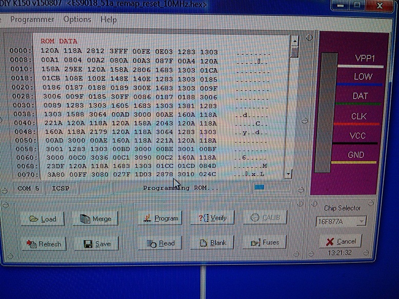

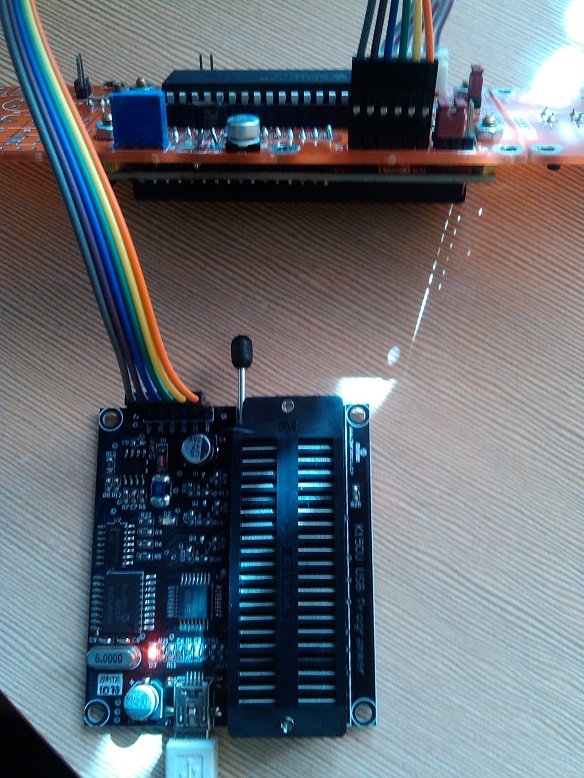

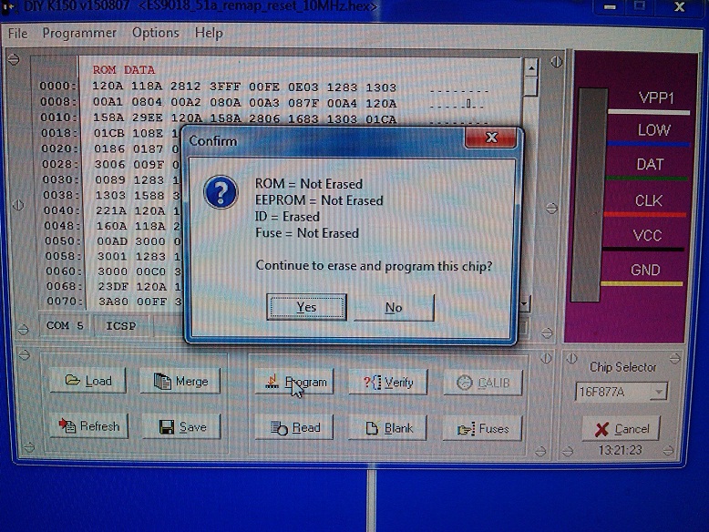

I use this PIC programmer to upgrade the firmware, cheaper than Pick-It.
Search in eBay or Aliexpress for "K150 PICPRO", it costs about $12.67.
It is made by BAITE and uses FTDI USB-Serial chip.
A side note, on my system, after the programming status bar reach 100%, somehow it pauses for about 8 minutes before the "Successful" prompt appeared, it works though, so be patience if this occurred.
I have uploaded the driver, programming software and a simple tutorial here:
BAITE K150 PICPRO Programmer Drv & SW.zip

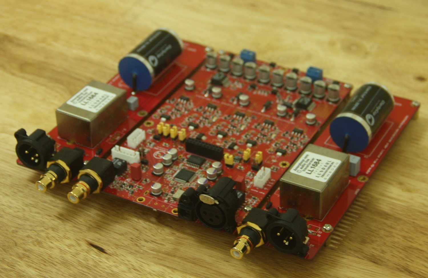

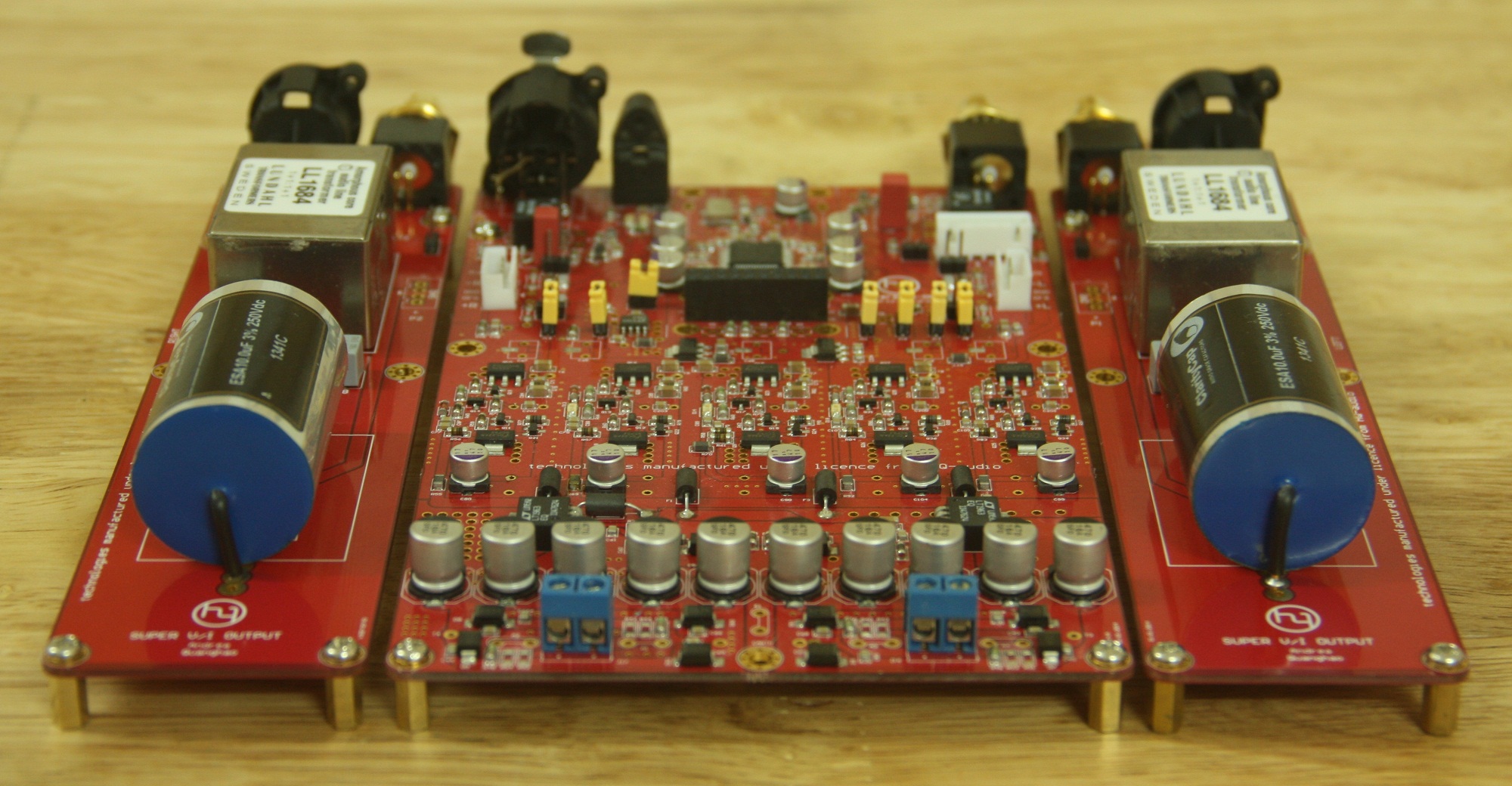

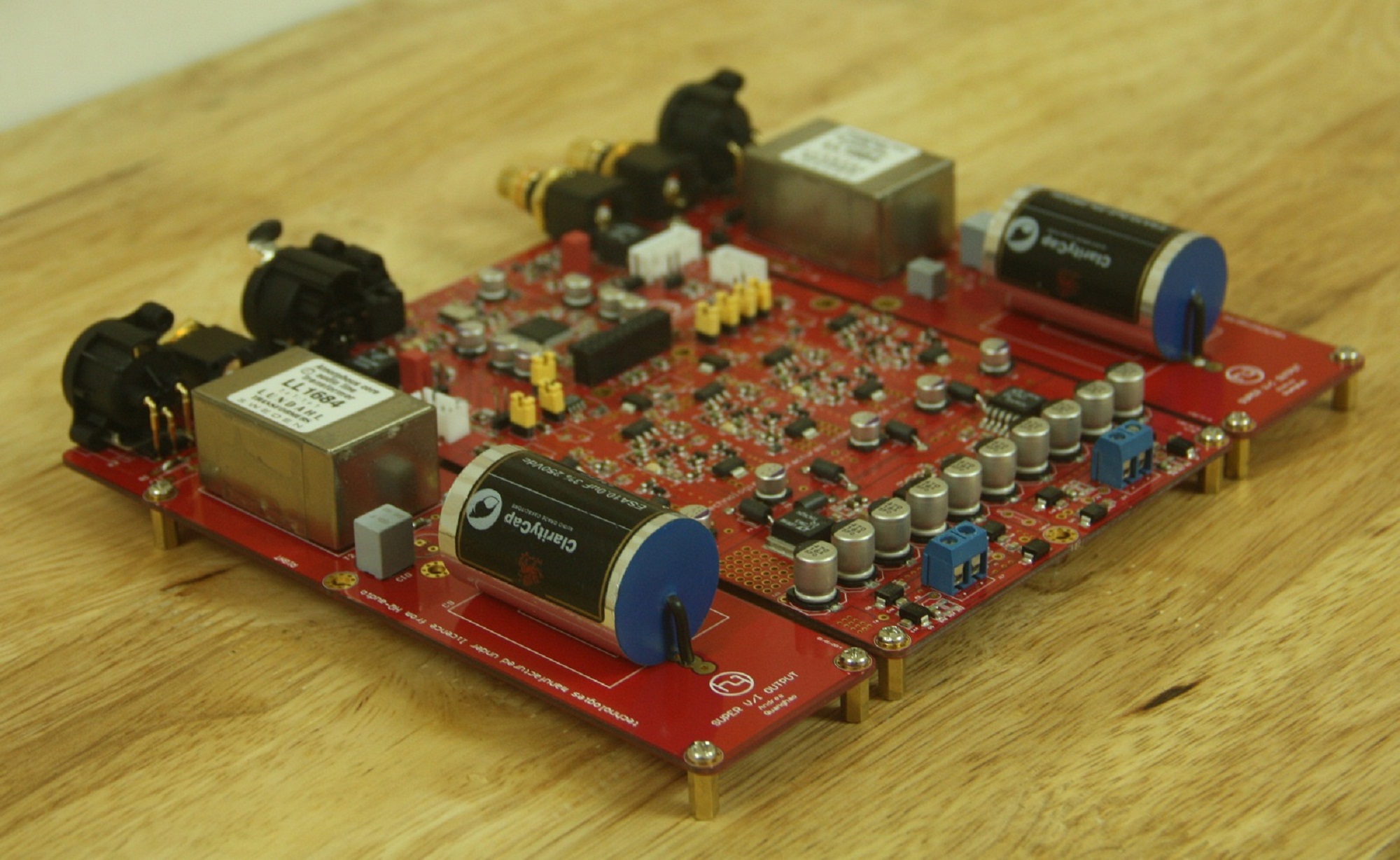

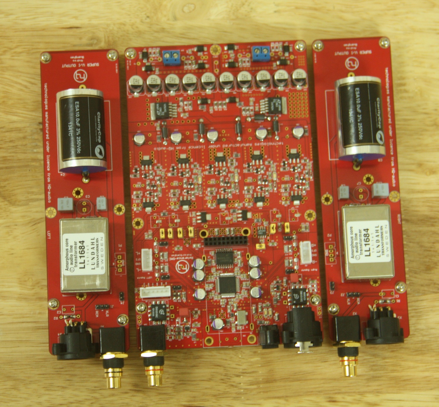

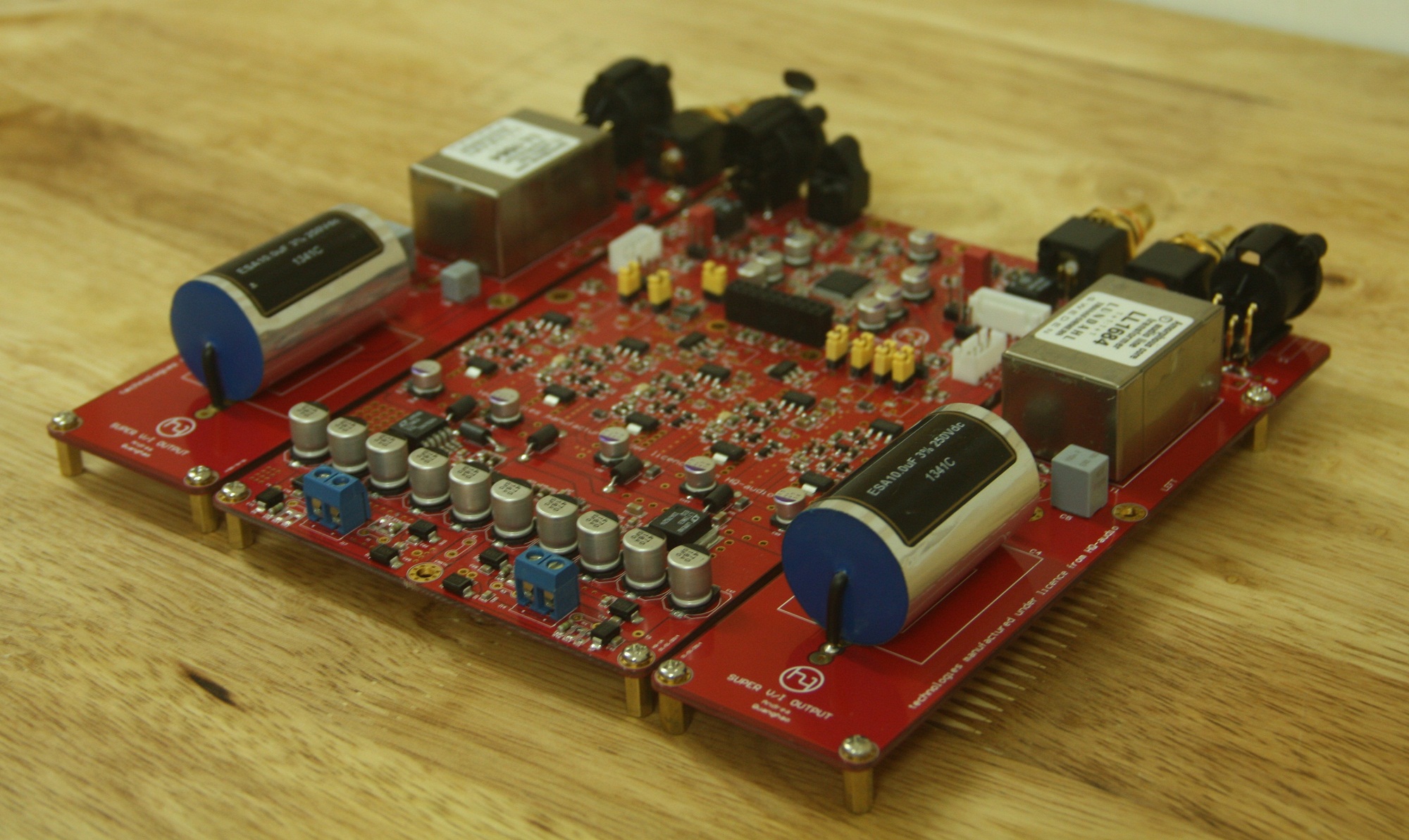

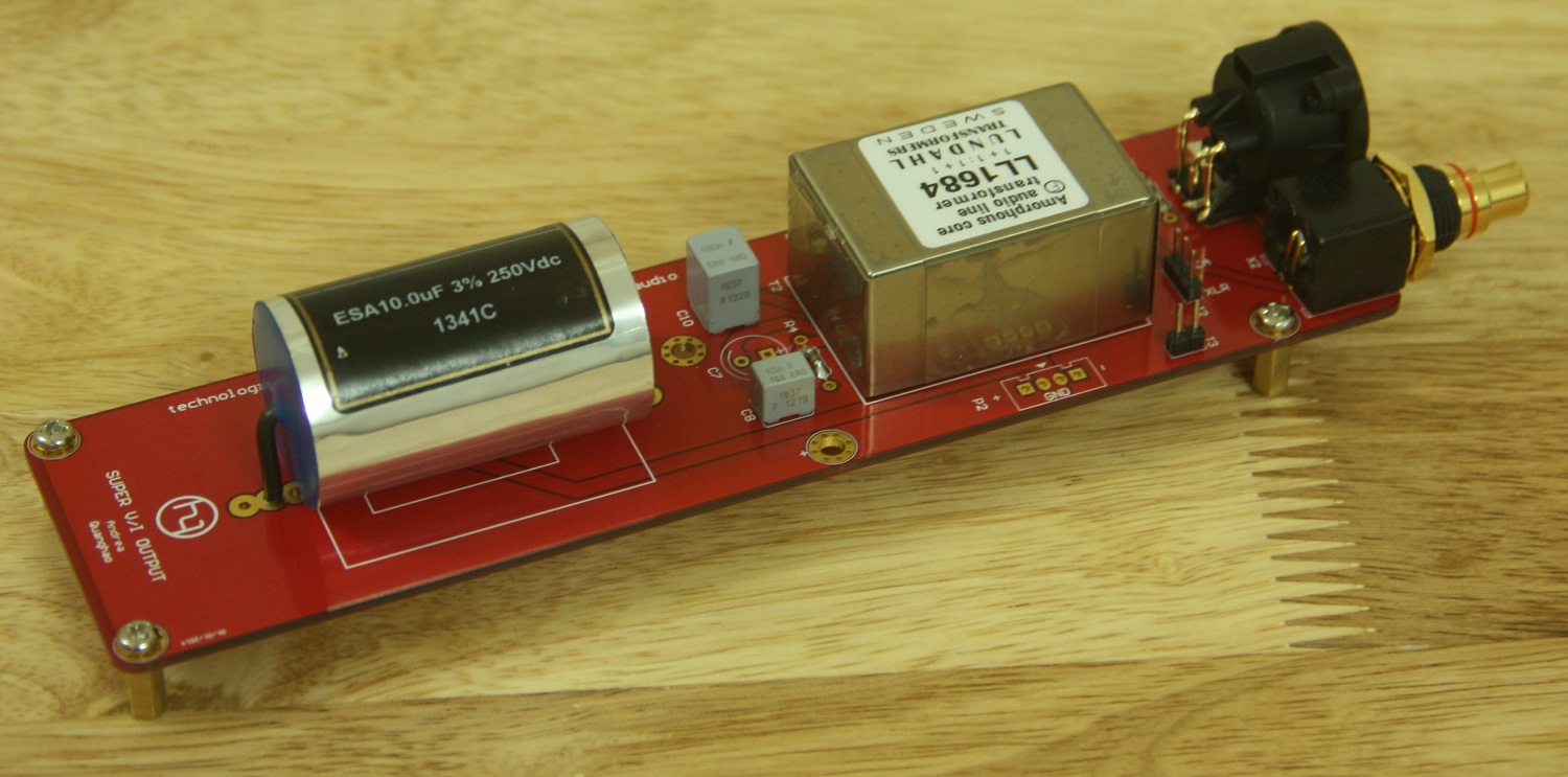

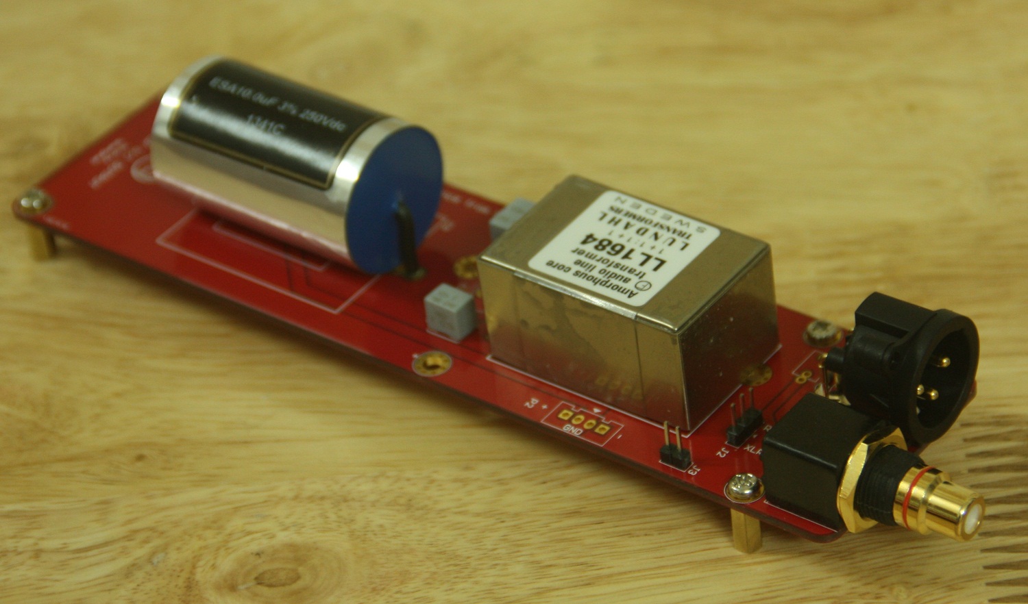

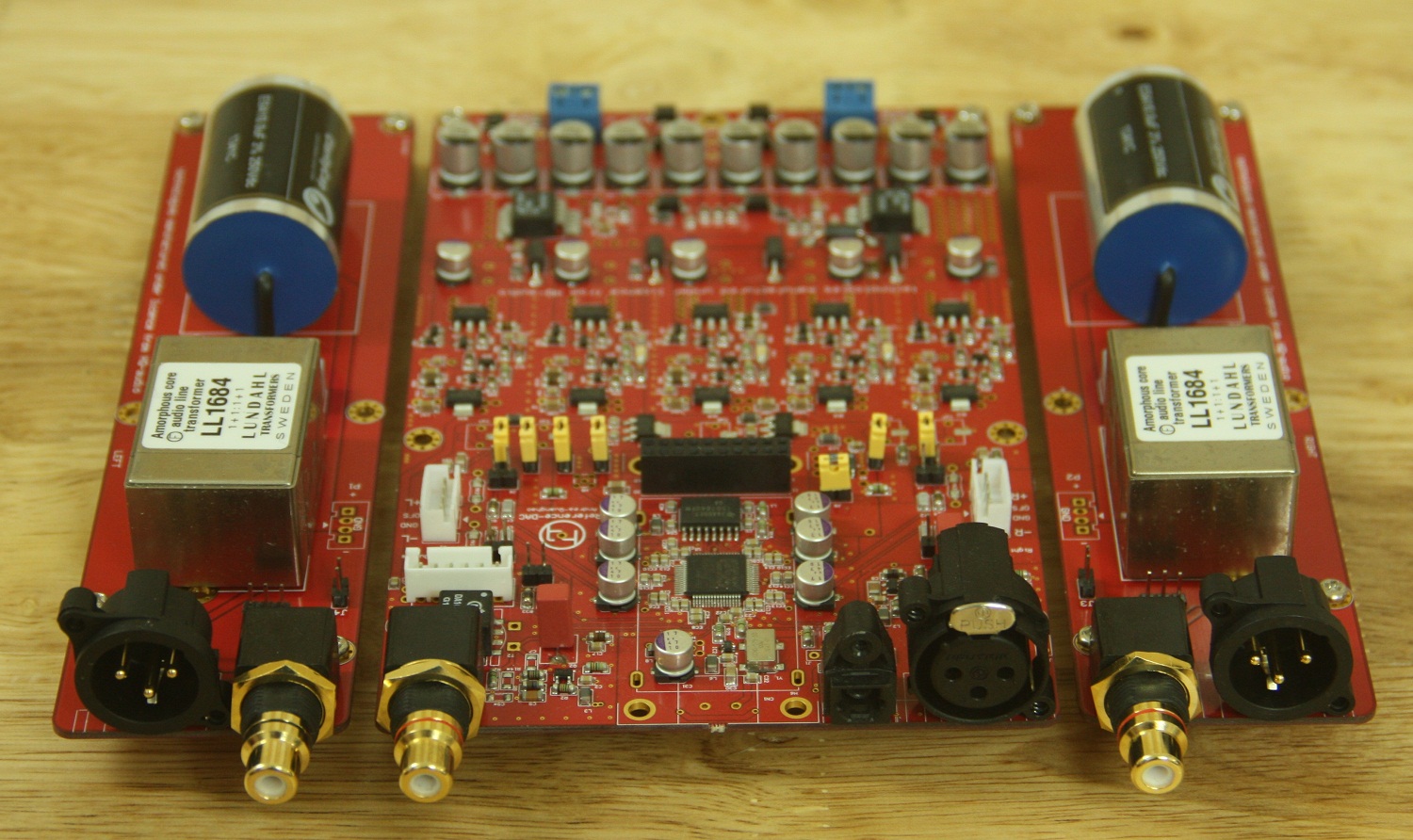

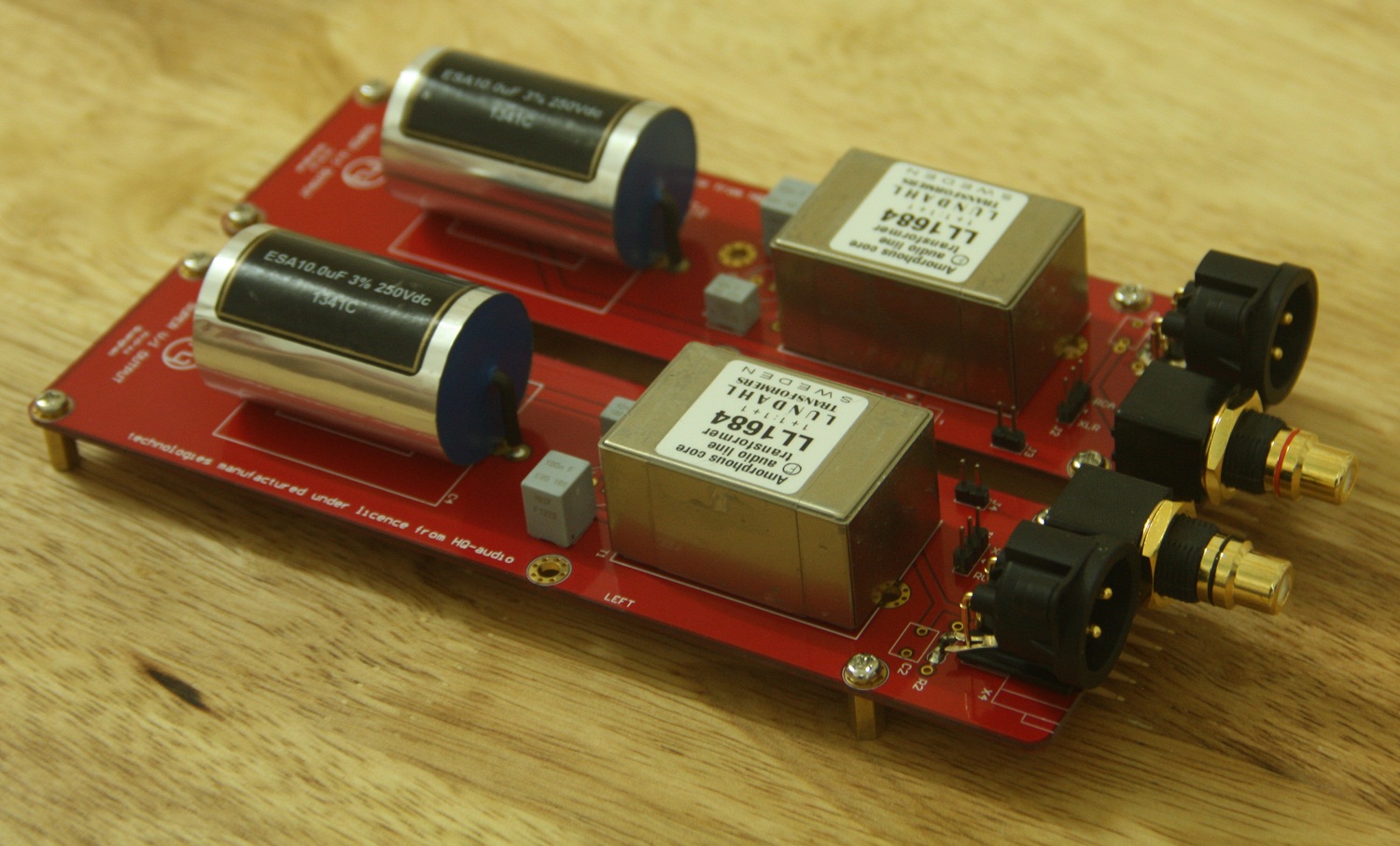

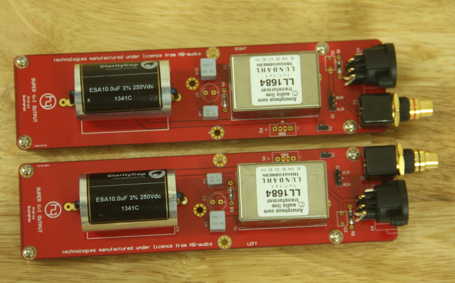

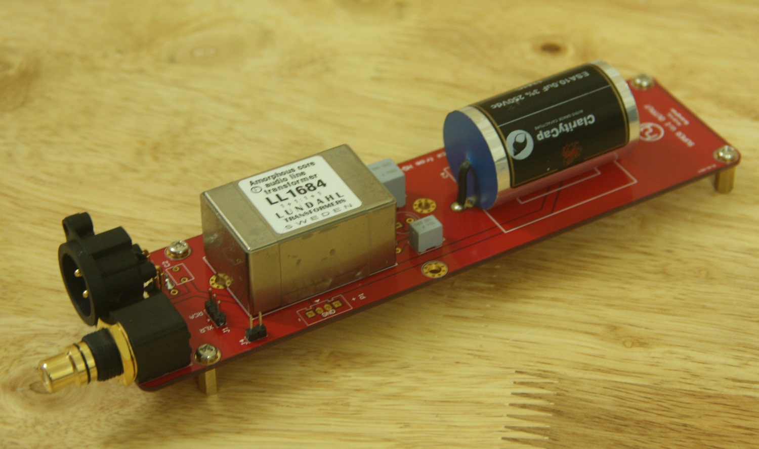

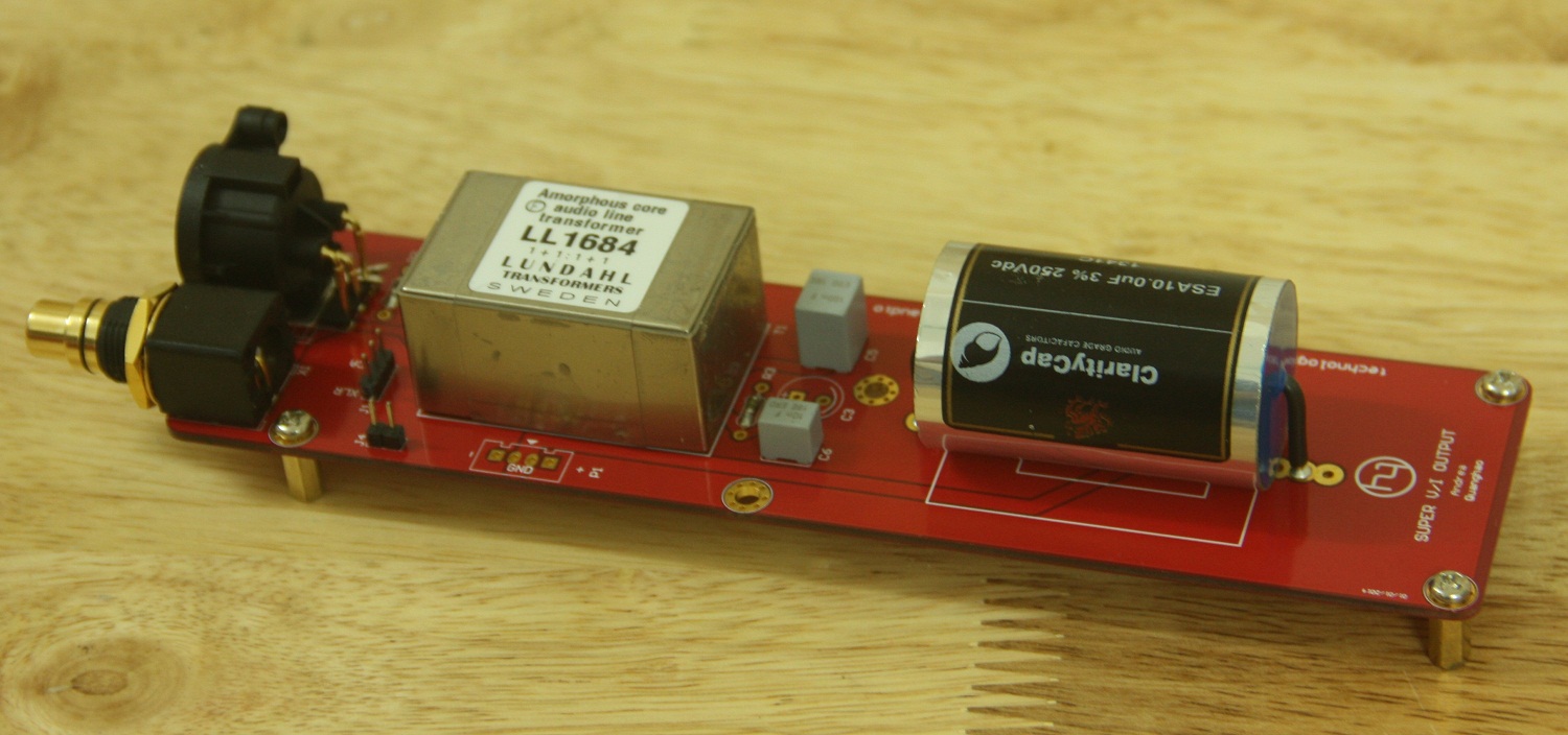

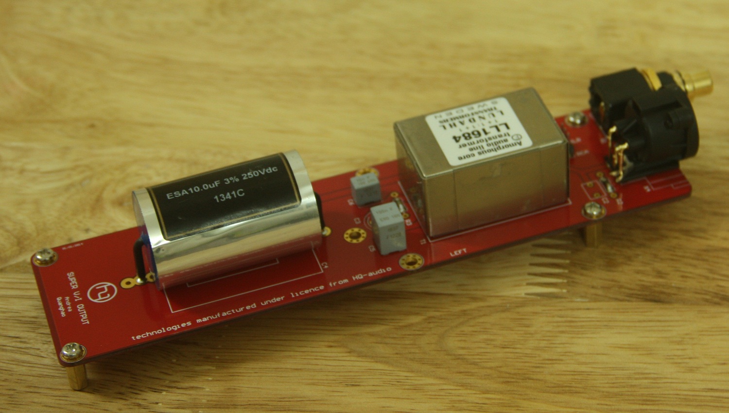

LL1684 PCB and DAC v2
I had the LL1684 and the PCB, the address you sent me, so I send them to you!
Please see image
Our warmest thanks
Please see image
Our warmest thanks
I had the LL11684 and the PCB, the address you sent me, so I send them to you!
Please see image
Our warmest thanks
Please see image
Our warmest thanks

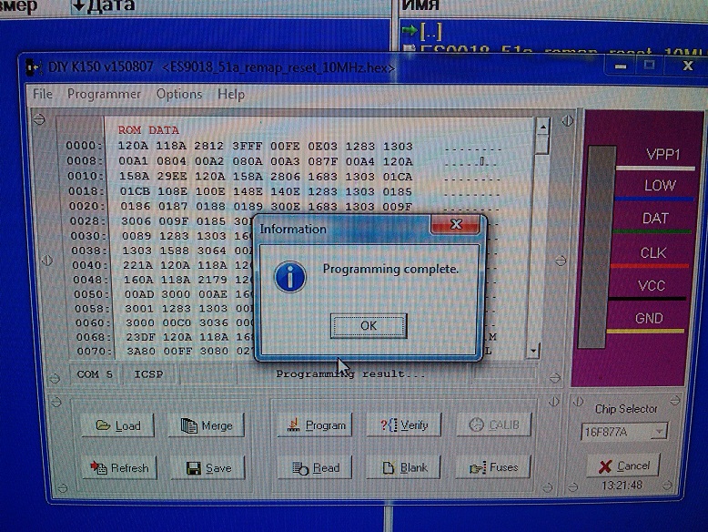

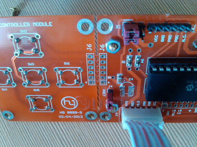

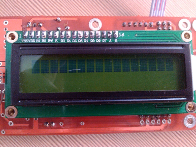

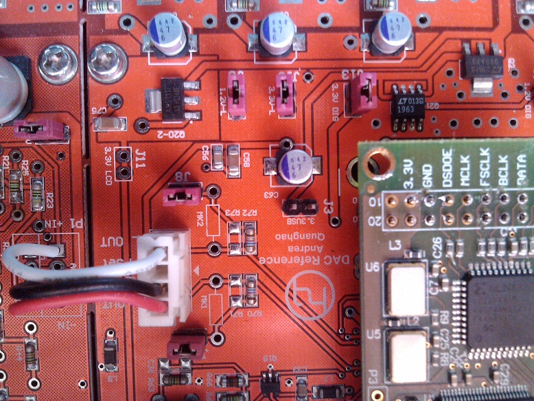

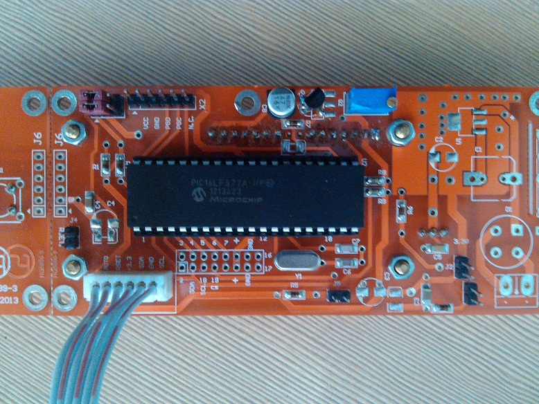

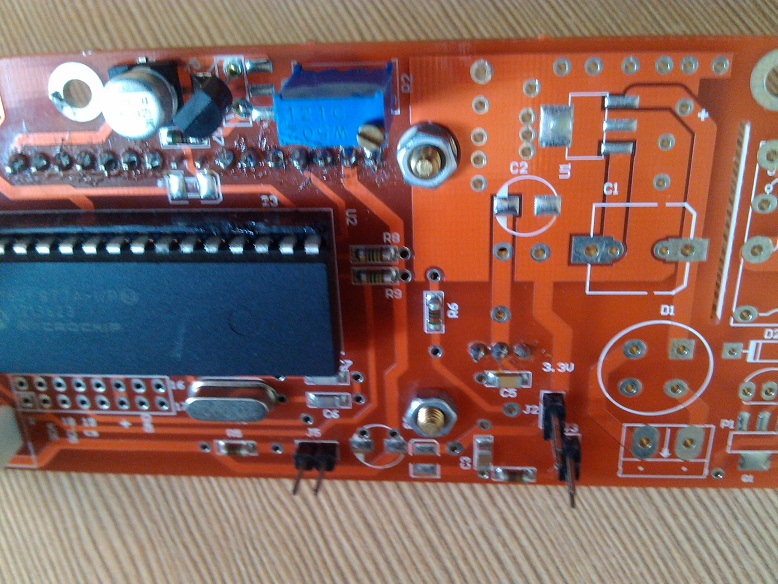

Hey. I need help. Can not start the DAC.
After turning on the screen nothing ((only the characters as in the photo), and on the remote and the buttons on the front panel does not react. Upgrade firmware (51,57,58,64) , but not 8 minutes , full time - 15-20 seconds. (written - "programming complete" ) .I do not know what to do now.
Sorry , google translate.

foto
please sent back to me the LCD module, i can hep you all!
or i sent to you new!
thanks
ok . All is excellent on the photo ?
If everything is correct , write address where should send by the module lcd with microchip .
Hello quanghao . This module fault with pic and lcd, or it
can be the fault of the DAC. How can I
check the serviceability of the DAC, wihout module
pic and LCD?
pic and LCD?
pic and LCD?
the lcd have problem!
thanks
