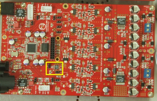

could you please tell me the exact jumpers you soldered. I cannot find jumper 7 or 9. In the manual there are J1 - J6, J+, J-, but no J7...
My DAC doesn't have jumpers on the downside. What are PS jumpers?
I want to check these jumpers too.
Thanks, jogi
Hi
Sorry about the confusion. These Jumpers (J7 and J9) are to be found on the DAC board.
PS: The unlock topic i did have are not quite the same issue as danielkol in post #960 have shown on the film clip. The issue i notice was sudden unlock. Then i had to turn the Dac off for minimum 5minutes. Fixing the J7 and J9 did fix this.
Br

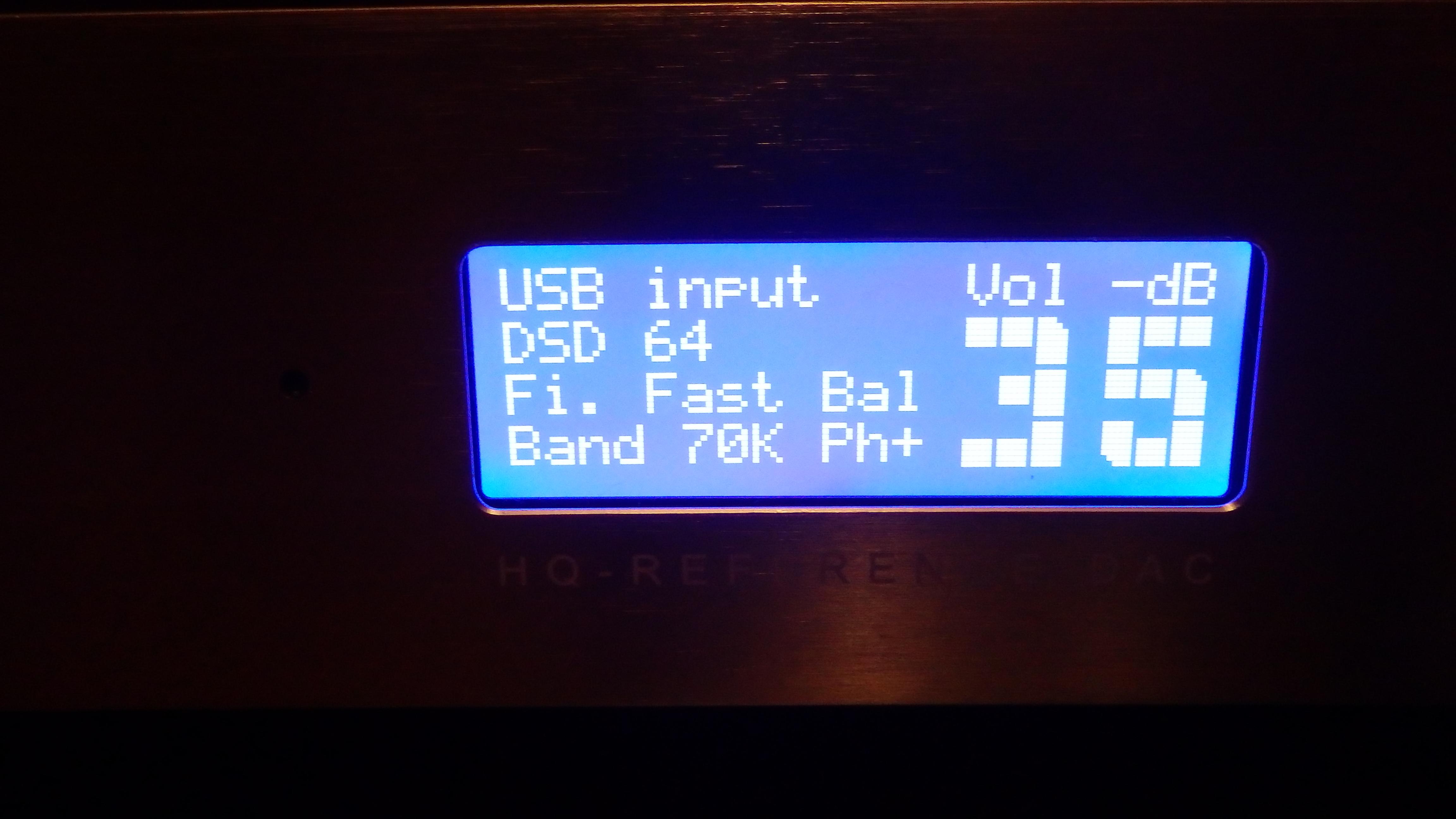

Andrea,
I prevoiusly had a problem with unlock and strange dac behaviour. Caad suggested to solder power supply jumpers and it seemed to work.
But today I connected my TV via optical cable and the issue came back. You can see the video in the attached file.
Could you suggest what to do?

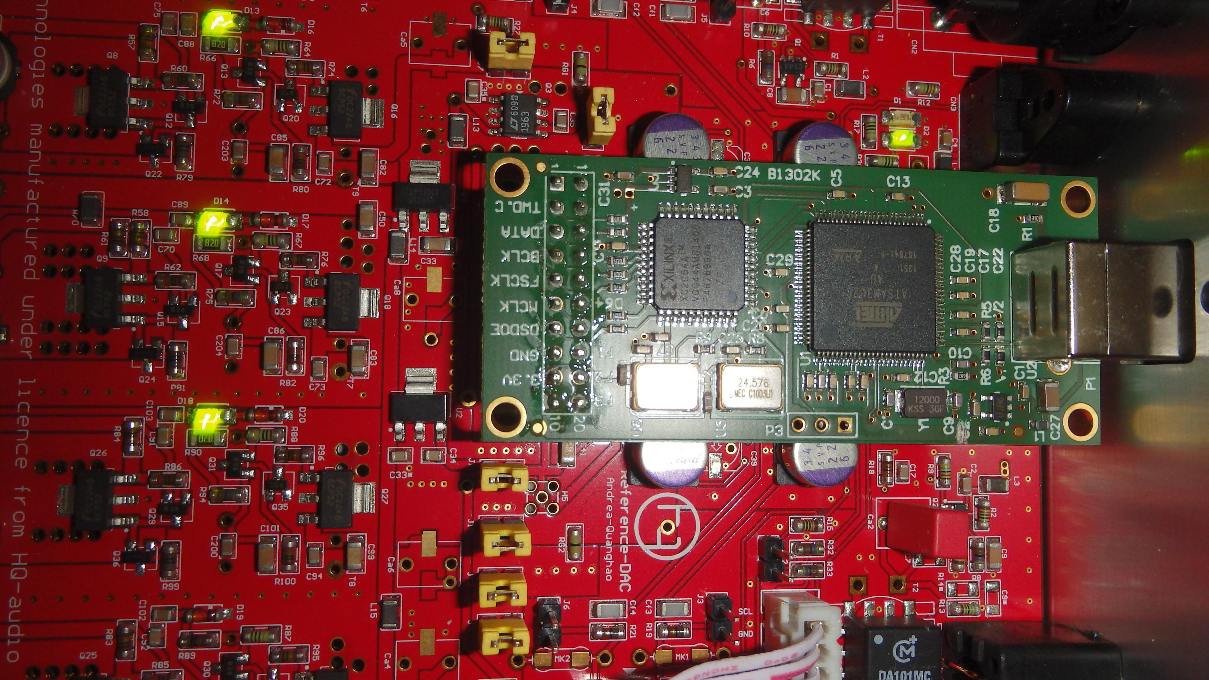

My DAC has the same problem with the USB input. The rapidly switching between PCM and DSD starts after about 15 minutes or so and it now also ends with the display showing "NO LOCK". When that happens the DAC needs to switched off and back on again to get it working again.
This is what I tried so far:
  • using WASAPI drivers instead of ASIO drivers, but this does not help.
  • I soldered all jumpers to ensure continuity, but this doesn't help.
  • Using an different USB cable (cables are 0.5 meter in lenght). Doesn't help either.
SPDIF input seems to work fine, so I still think that the problem is related to the Amanero, the digital isolator or something else at the USB input. Any ideas on how to pin down the problem?
