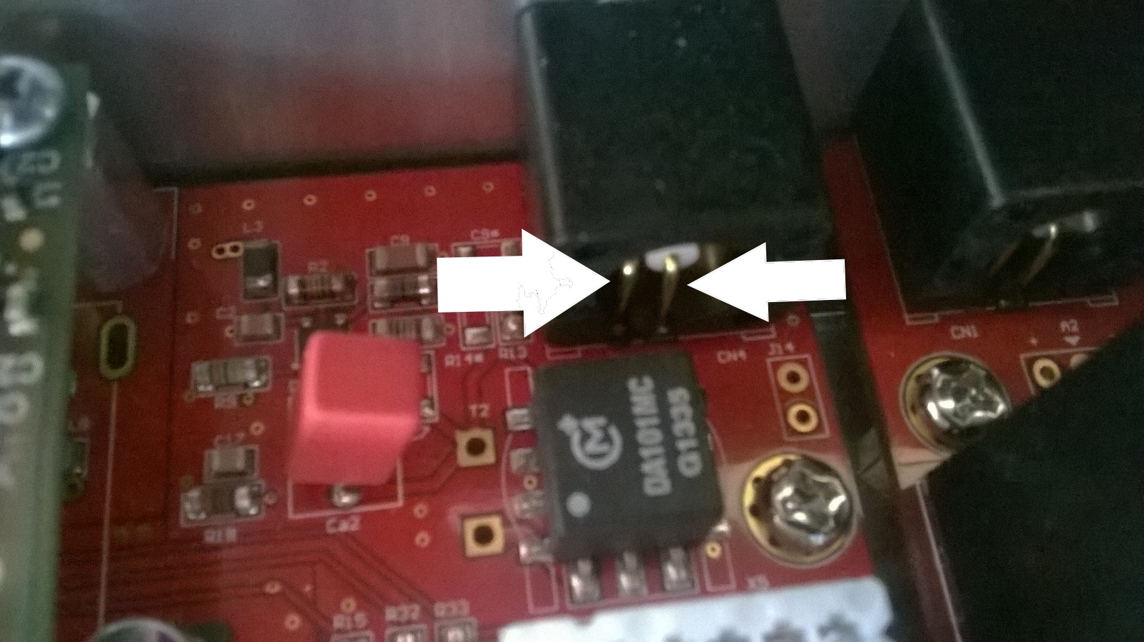

After Anjogi posted that he got problems after plugging in his CD-player at the SPDIF input I started to think about grounding problems. So I moved the DAC to another room, which has no earthed wall sockets. My DAC plays without error when the audio equipment is not earthed.
After that I started measuring for continuity at some places that need to be isolated from each other. I found that the gnd at the SPDIF connector makes direct contact to the gnd of the DAC, despite the digital transformer. Also the spdif signal at the connector makes direct contact to gnd!
I added a picture with white arrows that point to the leads of the spdif connector. These make contact with each other. My multimeter measure 0 ohm resistance. Nevertheless the DAC plays fine with only SPDIF.
Quanghao, Andrea: It looks like a design error or perhaps a mistake was made during soldering. Can you elaborate on this?
Perhaps somebody would like to measure these points for continuity? I'd like to know if this is the actual design or a mistake a my DAC.

problem solved
I was able to pin down the problem I was having with my DAC. I must have been plagued by ground loops. The problem always occurred when I connected the DAC to a earthed wall socket. There is no problem when the wall socket is not earthed. The computer I use for playing media is also earthed so that's probably how the ground loop could be completed.
I solved the problem by replacing the metal spacers by plastic spacers. That way the circuit ground becomes fully isolated from the chassis and the chassis can stay earthed. For safety reasons obviously.
I still need to take a look at why the ground at the spdif connector connects to the circuit ground... despite of the pulse transformer.

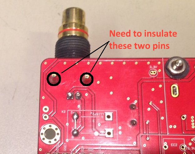

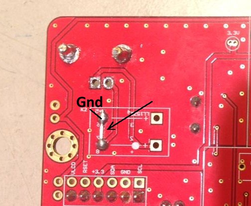

I found your problem, and it seems it would be the case for every kit. Good finding by the way! I measured my own DAC and I found the same problem as you, the coax input connector gnd is indeed connected to the Dac ground defeating the purpose of an insulation digital transformer at the input.
The cause is simple and it is an error in the PCB design. Look at the included picture. In this type of RCA connector, the two large connector mounting studs (circled in black on the image) are connected to the rca gnd. The correct PCB would have these two studs insulated from the PCB gnd.
To correct this is a little tricky for the some of you guys. The pcb been to faces, these two pins are grounded on both top and bottm sides, meaning that we cannot just cut the pcb around the stud on the bottom face to cure the problem. First you need to unsoldered the connector (that is the tricky part) without damaging the board, cut the pcb ground around each mounting stud, double check with an ohmeter the insulation, the re-solder the connector. That will correct the problem.
WARNING: If you're not sure of your soldering skills and/or don't have the proper tools, you can damage the PCB...

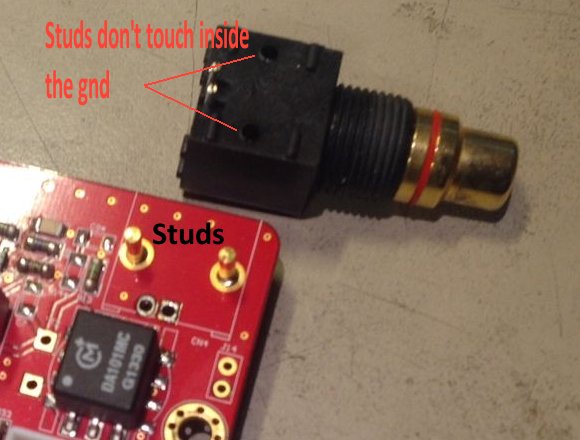

False alarm, I removed the connector, and the two studs came out of the connector casing. I can see that inside the plastic the studs are not touching, so they are insulated. Looking closely at the under of the PCB, there is the answer. A piece of wire was added between two pads, one being the PCB gnd. This jumper ground the coax ground. We need to remove this jumper. Confirming right now...
I can confirm that removing the jumper cure the problem. Simple as that. The input transformer is correctly installed on the PCB, and it doesn't seem to be any error of the pcb. I don't know why this jumper was installed 🙄

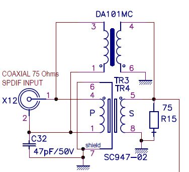

In some coax input implementation there is a small cap (47pf here) between the primary ground side of the connector, see schematic. This is something we may try as well. Just install the cap in place of the jumper.

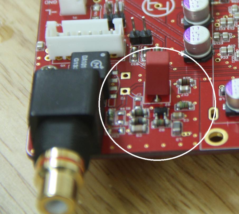

I also noticed the jumper wire underneath the PCB in this post from quanghao. My first impression was that it was needed to overcome some difficulty in PCB design, but perhaps it was there for testing purposes and quanghao forgot to remove the jumper before shipping the DACs. Who knows?

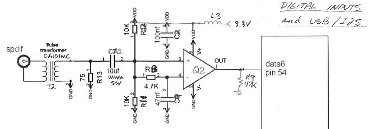

Now about the coax input implementation. There already seems to be some circuit in use at the connector ground side that implements a cap and some resistors. I not at home right now, so I can't check the exact circuit.
Can you confirm that the coax input still works with the jumper removed?
Yes it is working right now. Check the input schematic included, all the circuitry is on the secondary side, not the primary. This Wima red cap is the 10uF input cap on the schematic. I reversed engineer all the dac schematics by the way 😉
