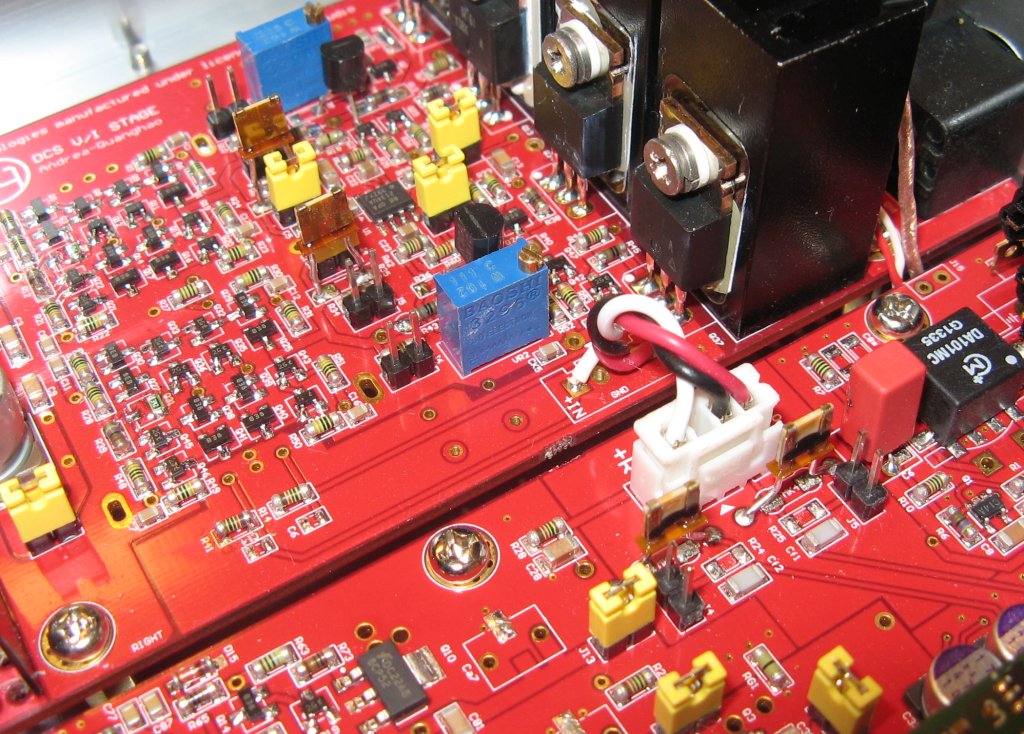

Hello, group buyers!
Just to share some findings:
1. Should anything go wrong with your shunt reg on the first version of the DAC, changing both NZT transistors helps.
2. Concerning Unlock issue and carousel of all the formats at startup, CAAD was right. Although multimeter shown good continuity something was wrong.
First soldered jumpers on the downside of the board, but it did not help.
Then I removed all the PS jumpers and soldered pieces of wire instead.
Now everything locks perfectly.
For me it seems that there is a room for improvement in quality control procedure, but again this is DIY and I had a lot of fun fixing these small issues.

Hi Caad, Daniil
could you please tell me the exact jumpers you soldered. I cannot find jumper 7 or 9. In the manual there are J1 - J6, J+, J-, but no J7...
My DAC doesn't have jumpers on the downside. What are PS jumpers?
I want to check these jumpers too.
Thanks, jogi

Andrea,
I prevoiusly had a problem with unlock and strange dac behaviour. Caad suggested to solder power supply jumpers and it seemed to work.
But today I connected my TV via optical cable and the issue came back. You can see the video in the attached file.
Could you suggest what to do?
