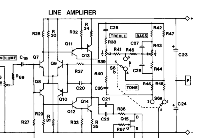

Strange, but thera re no reconstruction filters. just standard HF. It was PCM56 2x dac, 200ohm Riv initially,
and diskrete OP amp circuit, by E. Borberly from Hafler DH110 preamp line amplifier. Except BC550/560 wea swaped with BC327/337. I think tat slight more current was trough output darlingtons, because they are slightley warm... Configurated as non inverting gain OP amp with feedback... (Offcourse tone contol circuit was omitted)
BTW this diskrete circuit (OP amp) really rocks. It was before maybe 30 years but i remember well.
I can reccomend this OP as very good sounding one in smaller signal as DAC output ranges. 🙂
One IV, diskrete, SE, Non-complementary, good for use with tube DAC end and transformer.
This version is for +-12V and 2mAp-p Io without current injection.
And it is classic transimpedance circuit, but with IGBT concept based from @Lazy Cat member for power audio IGBTs
I adopted this for smaller currents and IV purposes.
IMHO very very good results.
