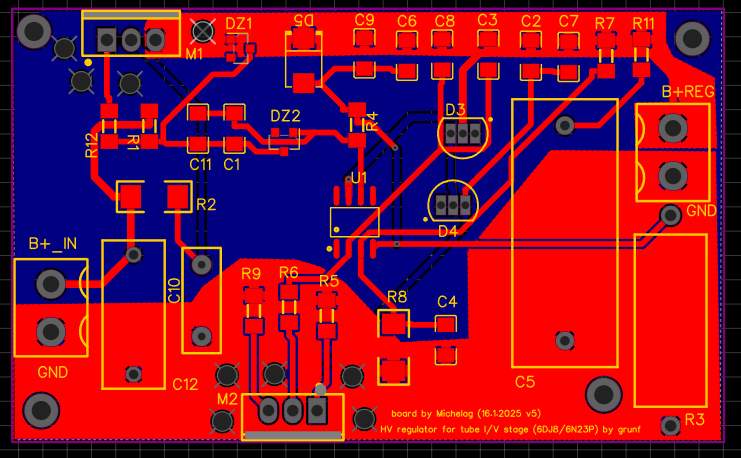

Yes, there are some other errors, pin 4 of the op amp is on + and pin 7 on -, that needs to be reversed. C5 can also be TH when you already have them on the PCB. Try to make your PCB to have three reference points, ground, + and floating ground that you get through resistor R3.Hey @grunf, did you look at my last iteration of the tube reg?
This is the regulator I have in my DAC, +/-5V but with a slightly higher max current of 500mA because it powers eight PCM1702s. It is necessary to replace the op amp to be bipolar in this case, ADA4897 is the best I have tried, also some resistor corrections need to be made and that's it, everything else remains the same. What would be the input voltage of the regulator and what is the load current?I saw the shunt regulator schematic shared by Vunce in post 7343, that gives an output of +/- 12V. Is it possible to tune that design to get the value +/- 5V output?
OK, what do you mean with reference points here? 3 copper areas for gnd, hv and virtual gnd?Yes, there are some other errors, pin 4 of the op amp is on + and pin 7 on -, that needs to be reversed. C5 can also be TH when you already have them on the PCB. Try to make your PCB to have three reference points, ground, + and floating ground that you get through resistor R3.

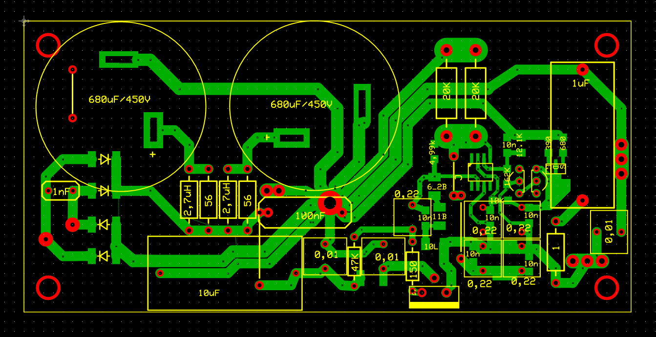

Well, one layer is enough for this regulator, I thought you should separate the decoupling to the ground and to the floating ground from + , and let + to have shorter traces. Unfortunately I can't find the sketches of my last PCB but I found one from another never finished project, it's the same schematic so maybe you'll get an idea. That was supposed to be the HV regulator for my DAC with PCM1794.OK, what do you mean with reference points here? 3 copper areas for gnd, hv and virtual gnd?
If you only need 50mA then the voltage drop with the correct selection of depletion mosfet can be only 4 to 5V. Then everything can be done in SMD without the need for additional heatsinks. The maximum I got with this design is 120mA precisely because of that small voltage drop and less dissipation. For larger voltage drops you need a heatsink but that larger voltage drop also increases the PSRR of the regulator itself. For 500mA both depletion mosfets must be in TO220 and then the voltage drop must be even greater than the 8V recommended by Walt Jung, in my case it is 14V and exactly divided in half for each mosfet.As Walt Jung's document states that the regulator must be feed 8V above output voltage I was thinking to use a symmetrical 15V supply to get 5V at regulator's output (I also have several 12V power supplys but I supose that will not be suitable). Current will be below 100ma, more in 50ma region, but if you are squeezing 500ma out of yours... we never know what toys in the future we may want to play with🙂

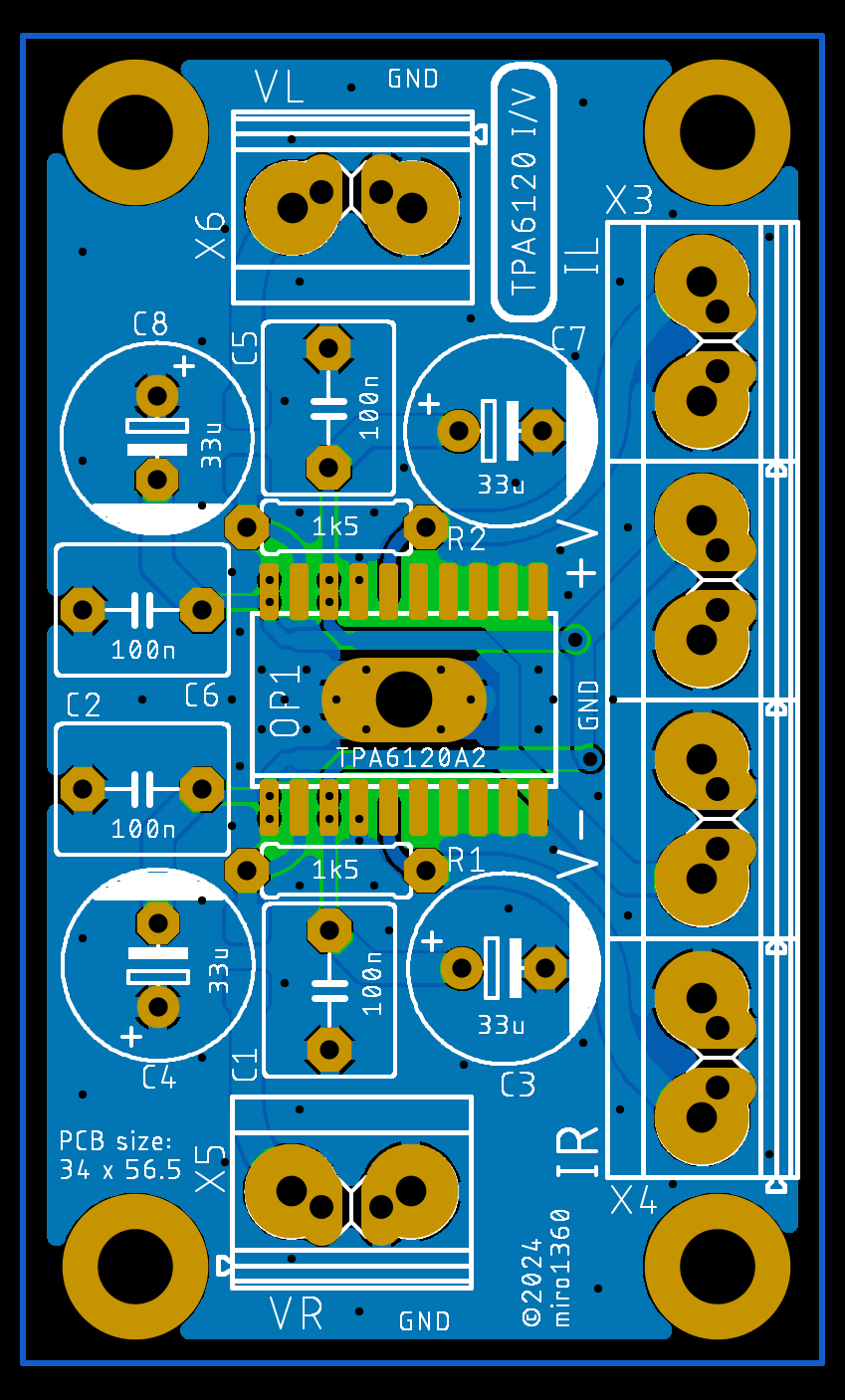

Does anybody in the US have a spare one of these boards? TPA6120 I/V
From this post - https://www.diyaudio.com/community/...st-tht-i2s-input-nos-r-2r.354078/post-7795053

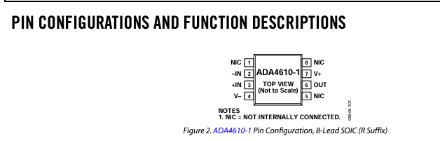

I had a look at the datasheet, here, and there are several pinouts according to the ada4610 version, but I do not get + on 4 and - on 7 anywhere, please correct me.Yes, there are some other errors, pin 4 of the op amp is on + and pin 7 on -, that needs to be reversed. C5 can also be TH when you already have them on the PCB. Try to make your PCB to have three reference points, ground, + and floating ground that you get through resistor R3.
here I don't get your message, ok, can do a star ground, give HV shorter traces, but what do you mean with "separate the decoupling from + to the floating ground, if the big resistor goes to main gnd ?
Grunf said that this need to be reversed, if i understand him correctly.I do not get + on 4 and - on 7
so ok, hope this worksWell, one layer is enough for this regulator, I thought you should separate the decoupling to the ground and to the floating ground from + , and let + to have shorter traces. Unfortunately I can't find the sketches of my last PCB but I found one from another never finished project, it's the same schematic so maybe you'll get an idea. That was supposed to be the HV regulator for my DAC with PCM1794.
isolated the main ground and B+ regions, keeping out the virtual ground.

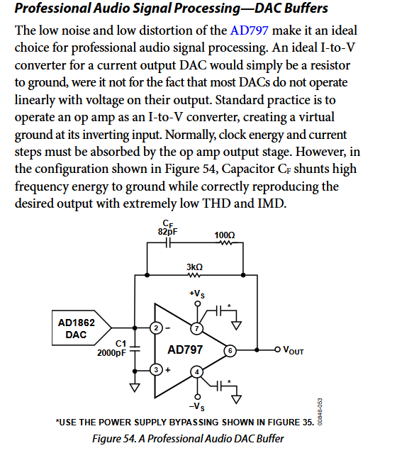

Did you setuped yours according the datasheet? :
For AD797 in any case, 47pF from pin 8 to Out is must. Also Decoupling as stated in datasheet is impotrtant. Off set null is option but if i remember well, it is not an issue, anyway it should be existing as option.
