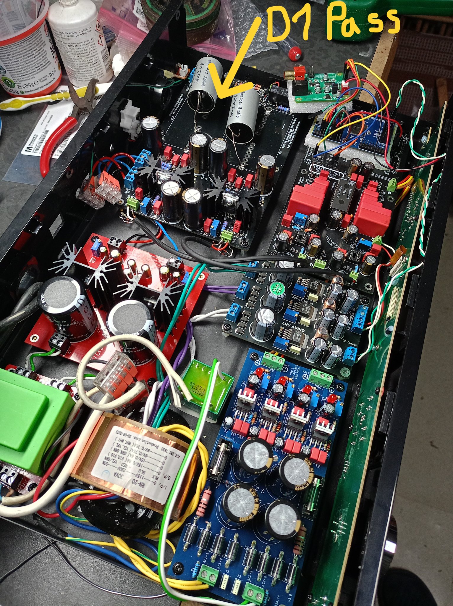

@zoom777, dear friend, I recommend D1Pass wholeheartedly 😉. I use IRF610.

Btw I talked about it iirc here and someone answered me it was for symetric output dac chip and I couldn't not use it with SE dac output, so I haven't pushed the investigations. On the paper it is brillant : near zero ohm input and 2 Mosfet only ! Papa smartness...

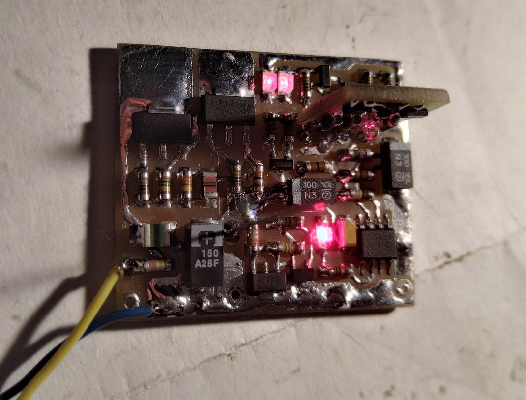

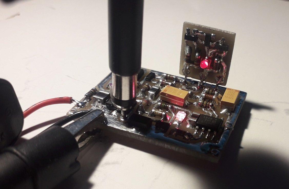

This is not just for Tesla Audio; as for the 1V reference itself and the associated shunt regulator, you can find everything on Walt Jung's website, and if you get stuck, I'm here.
I have worked with these regulators both with TH electrolytes and with SMD tantalums and I can't decide which is better. I prefer SMD only because in that case the PCB is much smaller and more compact which is better with digital devices that struggle with RF interference.
The pictures show these regulators, the first test versions that surprised me with their performance (op amps are ADA4897 for 3.3V and ADA4625 for 5V). 🙂
