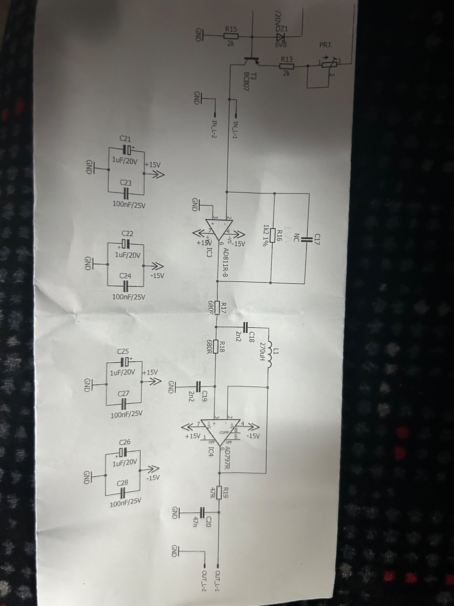

Yes single is better option.And AD8065,, its single channel iteration.
(I used double because of saving space and differential Io
And Superball for diff to SE output. So I used 2 X double version. 4 OPs...)
Standard values not so high Voltage output, with rc parallel to RfbDo you remember the resistance and capacitance values you used inthe feed back loop, please ?
it is alone because of the combine jfet input, out of the circuit... in transimpedance circuit it is lowIts input resistance is monstrously high but the AoL is high... did you model its impedance bandwith ?
on the contrary, very very good LFDid you noticed a subjective lack of bass or at least tigther/more damped ?
So 47p between 6 and 8 pin? Is it together from the diagram from the posted note by diyiggy?For AD797 in any case, 47pF from pin 8 to Out is must. Also Decoupling as stated in datasheet is impotrtant. Off set null is option but if i remember well, it is not an issue, anyway it should be existing as option.
Sound is very good and unique. Nor as usual OP amp sound.
I was maybe more satisfied with AD8066, but this amp is in class A and cant stand alone without heatsink noted PS values. So I decresed to +-8V. After that was more than good... Consider this AD8066 seriously.
Like in the datasheet. (once i was ommit to solder this C on the pcb, where i already put the part, and spend a lot of time until i measured right result - after soldering this little C...So 47p between 6 and 8 pin? Is it together from the diagram from the posted note by diyiggy?
Decoupling - also as in the datasheet.

I saw the shunt regulator schematic shared by Vunce in post 7343, that gives an output of +/- 12V. Is it possible to tune that design to get the value +/- 5V output?
Vout = (1+R411/R412) * Vref (2.5V)Is possible to adjust this board for 5v?
Try changing R412 and R420 to 10K (value on Vunce's schematic for +/-12V approx. is 2.74K) to get +/-5V respectively.

I use such an IV for DAC Tda1541. It's not NOS. As you can see, there is no capacitor here. However, don't ask me about the details because I'm just playing with building modules invented by smarter than me 🙂Like in the datasheet. (once i was ommit to solder this C on the pcb, where i already put the part, and spend a lot of time until i measured right result - after soldering this little C...
