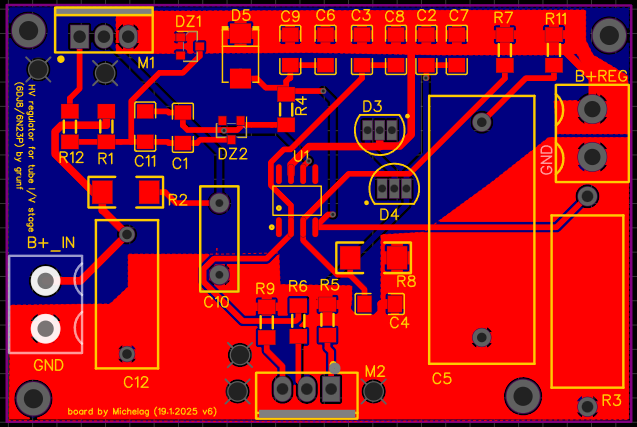

This is much better now, now a bit of optimization-shortening traces and editing 🙂 .
Ah, yes, in Pola, beautiful italian city 😀 for sure Croatians keep it much much better than italians, so happy that it is now HR...
So, this is my last iteration, ready to go?
board is 66x44mm
  • Gerber_Grunf_HV_reg_(180V)_PCB_Schematic_2025-01-19.zip

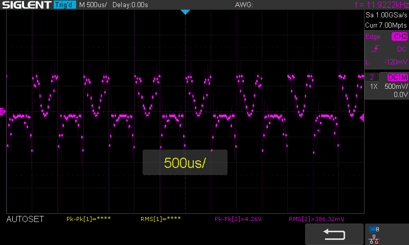

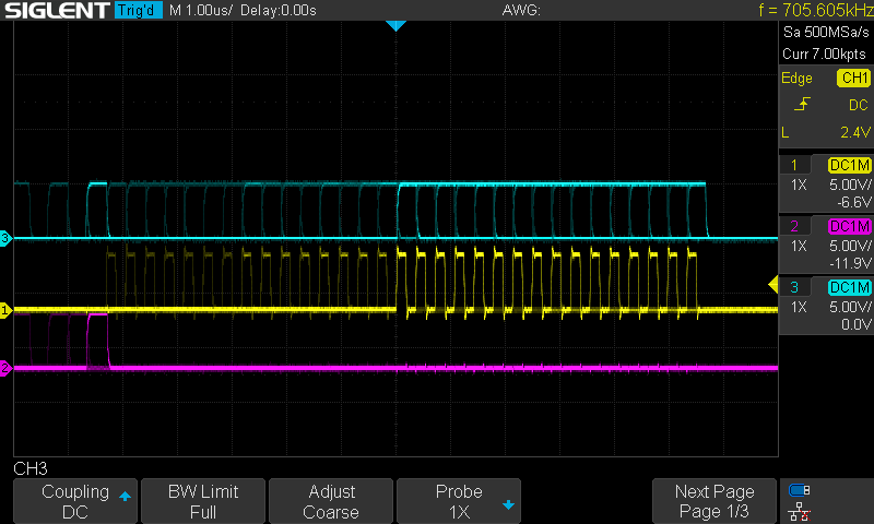

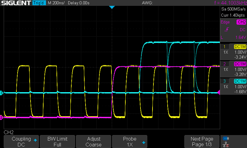

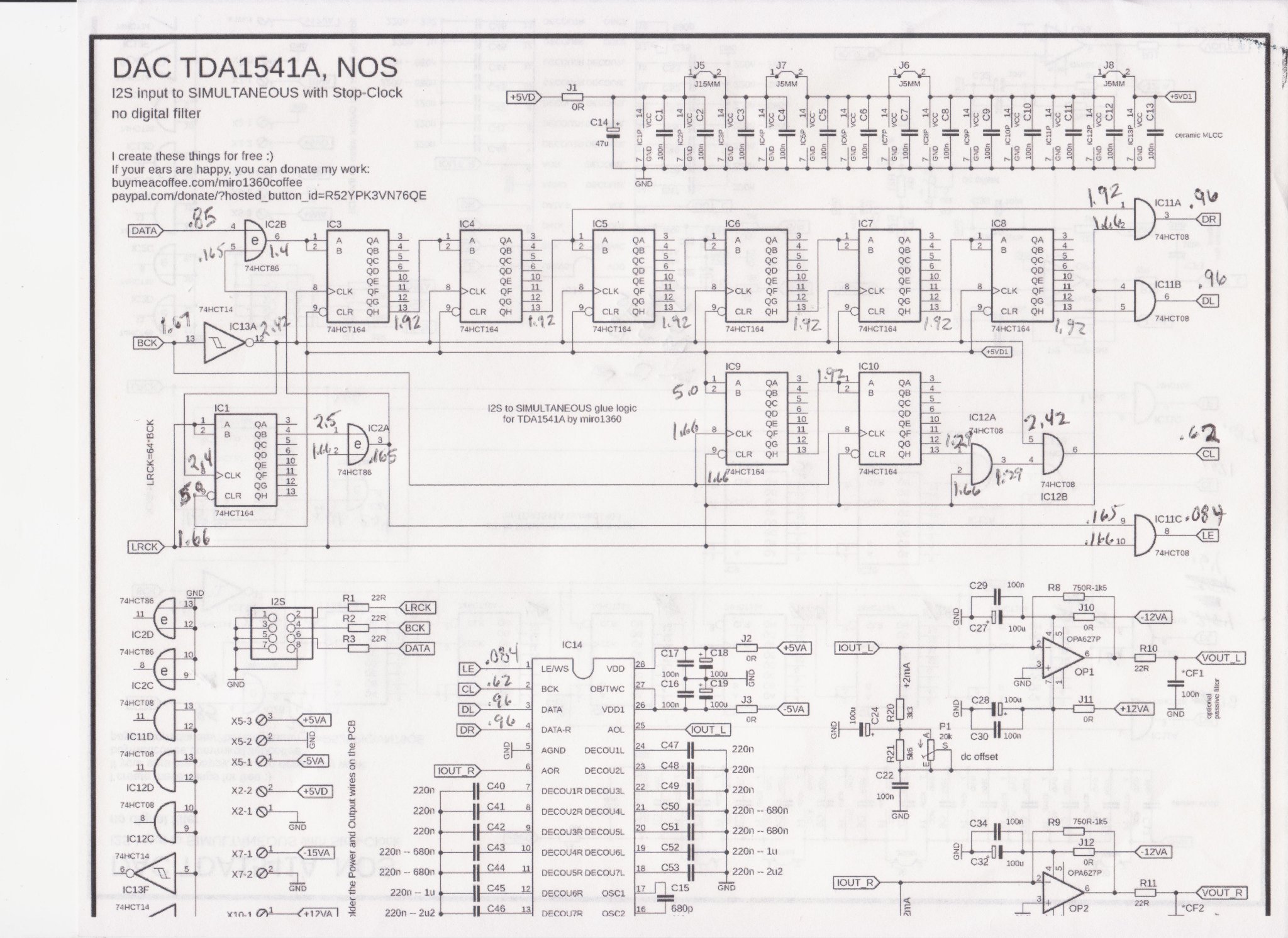

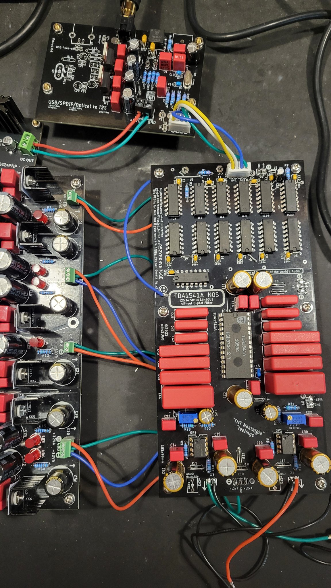

HELP!
I built the AD1862 version without issue but I can't seem to figure out this TDA1541A - faint sound, lots of static.
I have confirmed the chip is good in another DIY DAC as well as the COAX to I2S conversion. All input voltages are correct and tried another set of LM6171 opamps.
I'm not sure what the different shift registers should be showing.
Can you all point me in a direction to focus on. Thanks!
