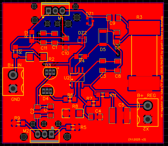

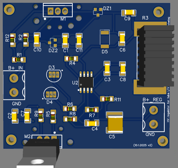

So fellows, as a new year's greeting, a board for @grunf 's HV regulator, as presented in one of his answers in the thread.
All SMD, measuring just 41x43mm (heatsinks excluded), is a nice add on between the PSU and the CCS, yes, goes between my two previous boards, in the b+ section of course.
  • IT IS NOT TESTED YET
  • in the BOM I compiled additional quantities of components for my purposes, so if you want to build only one or two, please amend the quantities.
  • do no forget heatsinks!
  • start soldering ADA4610 first, then the SMD zeners DZ1 and DZ2, resistors, capacitors, the few THT components, MOSFETs, the big SMD 5W resistor, terminal blocks.
  • for 2W zener D5, look for SMZ24 2W.
  • regulator LM329DZ is EoL, though quite easy to be found around (not China). There are some equivalent, but for DC stability and noise figure we prefer this one.
Plug 1 side of the B+ of my psu board to the input terminal, with 220VDC in you should get 180VDC ripple free at the output.
I would then connect the output to the 2 b+ tube board inlets, I know that grunf comes to correct me saying "use two reg boards, one for each triode of the 6n23p", but i guess that currentwise it should work 😀
You are of course free to test with 2 boards, one for each side.
This boards stems from my curiosity to test a b+ regulated supply in tubes, since I've never done this before, and since if get a wonder like in the AD811 board, well, i will revise all my ideas about super ultra mega iper refined supplies (ok, this is perhaps not super ultra mega iper, but a big step beyond my basic 5$ board).
Questions, doubts, opinions, corrections (especially from the author) are more than welcome!
Attached are original schematic, my schematic, BOM and Gerber.
Happy new year guys ! 😛

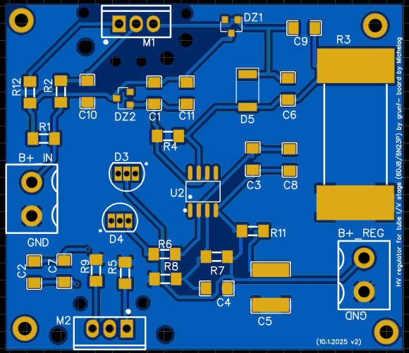

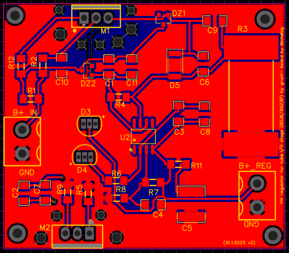

Here comes v2, HV traces are thicker, spacing is wider, added holes around the MOS, it is only 1cm per side wider.
Let's wait for @grunf 's approbation 😀
I have to warn about the voltages of some capacitors. Others can be 50V or 63V. Mouser has some SMD 1uF/250V in stock. Put the gate stoppers right next to the gates of the mosfet.

here you go, although couldn't find 400V SMD caps, and as 2W zener in SMD there is only this SMZ24. We give it a go ?
There are other types; 1SMB5934BT3G, 1SMB5934B-W, 1PGSMB5934,CZRB5359B-HF..... Calculate that this diode will have about 300mW of dissipation, so give it a little more copper surface area.
As for 10nF/400V, you have FCN1913G103J-E3 and SMDTG02100TA00MQ00.
It would be a good idea to put a decoupling capacitor at the regulator input, for example 0.1uF/400V (CB162I0104KBC). You can make the PCB so that the capacitors are TH as well as the power resistor and everything else is SMD.
