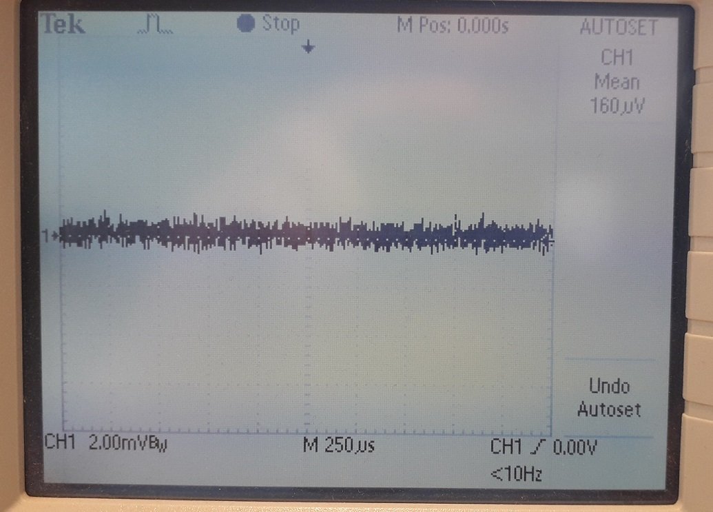

Regardless of the protected part of the scheme is not simple anymore and considering the presence of high voltage I would like to avoid possible problems with the construction at least for the beginning.
I also found a picture of the measurements in my DAC with an output voltage of 255V.

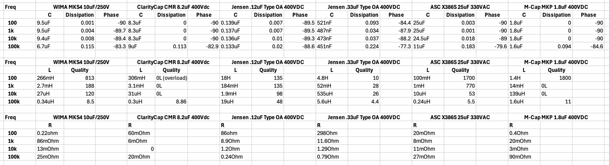

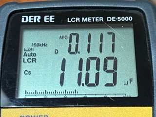

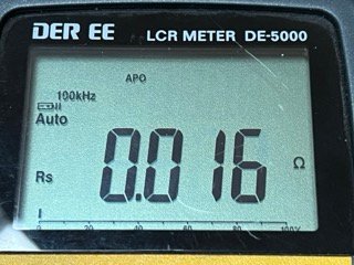

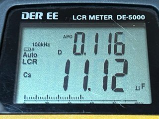

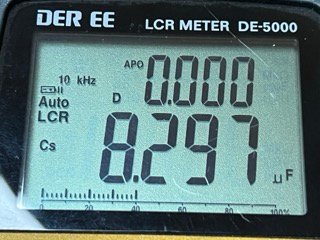

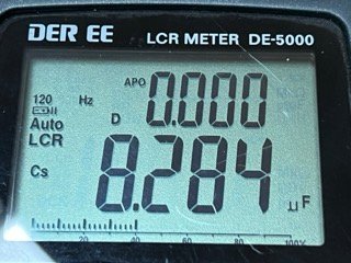

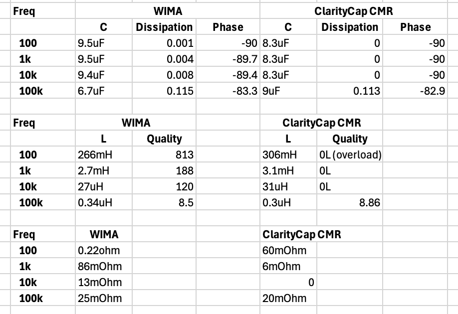

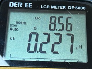

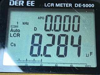

Here is measurements for ClarityCap CMR 8.2uF 400Vdc. It measures better than any other capacitor I have, especially 16mOhm at 100kHz. It's interesting that its capacitance goes up at 100kHz - maybe a glitch of the tool or a resonance inside the cap? The next best cap is https://www.mouser.com/ProductDetail/75-MKP1848S61050JP2C at 60mOhm. I am not sure if it correlates to sound, just found it interesting.

please measure Henries and Ohms also at 120/1k/10k 😱
of course, it is a DC link 😀
