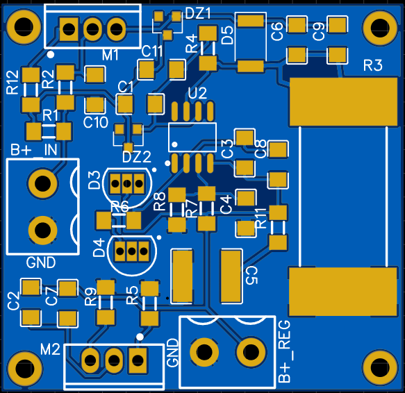

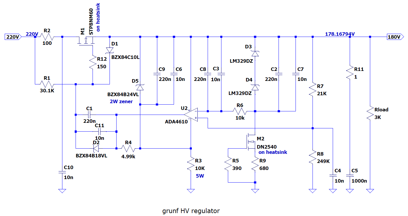

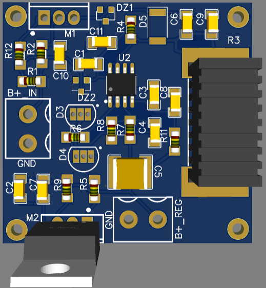

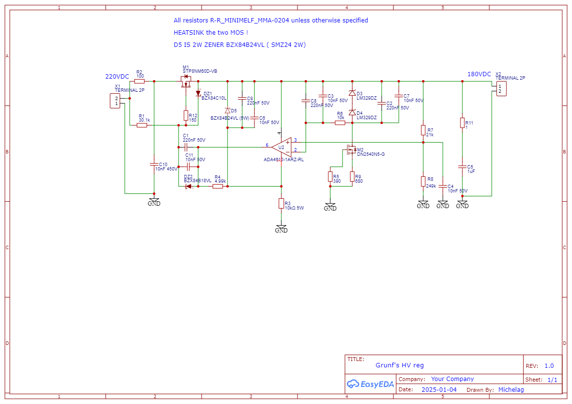

So fellows, as a new year's greeting, a board for @grunf 's HV regulator, as presented in one of his answers in the thread.
All SMD, measuring just 41x43mm (heatsinks excluded), is a nice add on between the PSU and the CCS, yes, goes between my two previous boards, in the b+ section of course.
  • IT IS NOT TESTED YET
  • in the BOM I compiled additional quantities of components for my purposes, so if you want to build only one or two, please amend the quantities.
  • do no forget heatsinks!
  • start soldering ADA4610 first, then the SMD zeners DZ1 and DZ2, resistors, capacitors, the few THT components, MOSFETs, the big SMD 5W resistor, terminal blocks.
  • for 2W zener D5, look for SMZ24 2W.
  • regulator LM329DZ is EoL, though quite easy to be found around (not China). There are some equivalent, but for DC stability and noise figure we prefer this one.
Plug 1 side of the B+ of my psu board to the input terminal, with 220VDC in you should get 180VDC ripple free at the output.
I would then connect the output to the 2 b+ tube board inlets, I know that grunf comes to correct me saying "use two reg boards, one for each triode of the 6n23p", but i guess that currentwise it should work 😀
You are of course free to test with 2 boards, one for each side.
This boards stems from my curiosity to test a b+ regulated supply in tubes, since I've never done this before, and since if get a wonder like in the AD811 board, well, i will revise all my ideas about super ultra mega iper refined supplies (ok, this is perhaps not super ultra mega iper, but a big step beyond my basic 5$ board).
Questions, doubts, opinions, corrections (especially from the author) are more than welcome!
Attached are original schematic, my schematic, BOM and Gerber.
Happy new year guys ! 😛

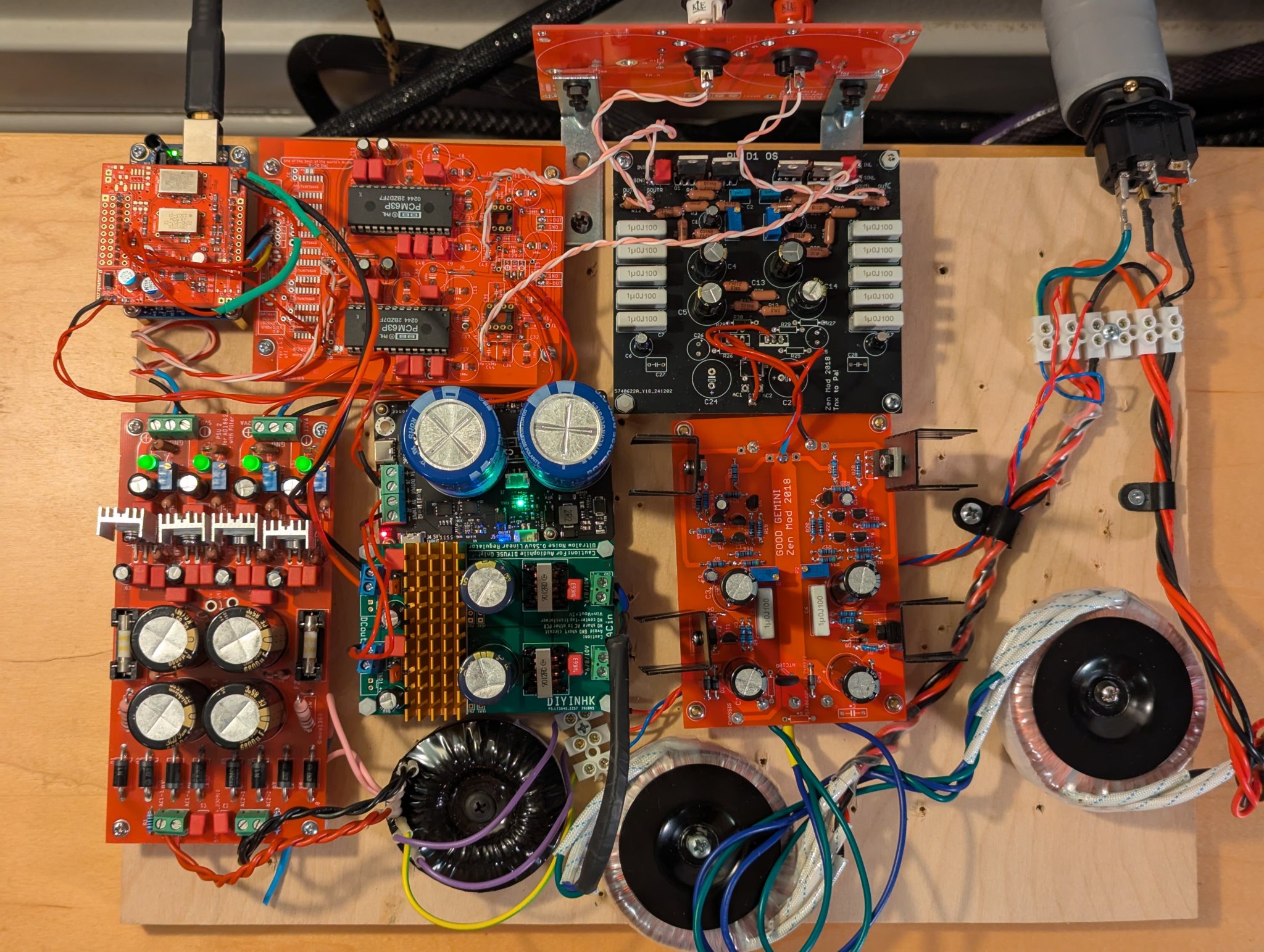

I sense tube IVs are in vogue, but wanted to share my latest Miro DAC setup - sans tubes. This one combines PCM63 with the vintage D1 I/V stage. This is a very nice combo and it seems the D1 adds some sweetness to soften the PCM63P. It might be ever so slightly less resolving than the Burson V7s, using the onboard opamp IV of Miro's board, but the toe-tapping factor of the D1 is up compared to these. Punchy and with a huge sound stage. Of course, this is in the context of my system and ears...and I can imagine some would find D1 too mellow in a different context, or be put off by specs that are surpassed by newer versions/options. I think this one may graduate from plank to chassis 😊
Credit goes to @Zen Mod for his help in getting the D1 and its 30v shunt singing.
Cheers
Well done.
If one want to remove too much percieved sweetness, according tastes, whole setup; I'd remove all the CMF55 for Yageo 0207CF 1 or 0.1%. Or even carbon at some areas.
You also can dlip the D1 board 90° to make the wires from the DAC board to D1 much shorter.
Of course you can play with the 4 caps.
What is the Gemini reg from "Ze Migthy", please ?

Well done. I would probably go with TH components for the first time, it's easier to start with. R3 gets quite hot and instead of it you can put another CCS so that the mosfet can be on the heatsink which reduces the thermal load of the entire PCB. Increase the PCB a little, increase the spacing especially around M1 and everywhere where HV is present. I would maybe remove the ground plane or increase the spacing between traces and pads.
The same regulator can be more complicated, I added another CCS and a low-noise reference instead of 2x LM329, so I should reconsider that version when this one is mastered.

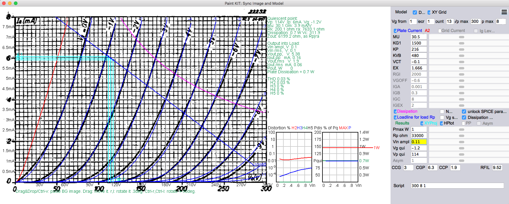

A little DHT tip for @andyjevans . In new DHT year... 🙂
Classic KC3 triode, beautiful boxed huge anode (for given A dissipation)
Higher mu, lower Ri (somehow about ECC82 section)
Not cheep, bud not so expensive and still available. Long life too... 🙂
Very small distortion.
With input of 220mVp-p (110 ohm Riv for 2mAp-p all range AD and BB DACs)
Output is 1.9Vrms, 5.37Vp-p - more than enough, THD from 0.03% to 0.08%
Ho huge Vb neded about +320V to +350V will do the job, Zout is 6.2K
good for tube preamplifier OR tube amplifer input...
For other inputs buffer is solution...
Off-course, i made two spice models, one for DHT one for classic
Cheers
