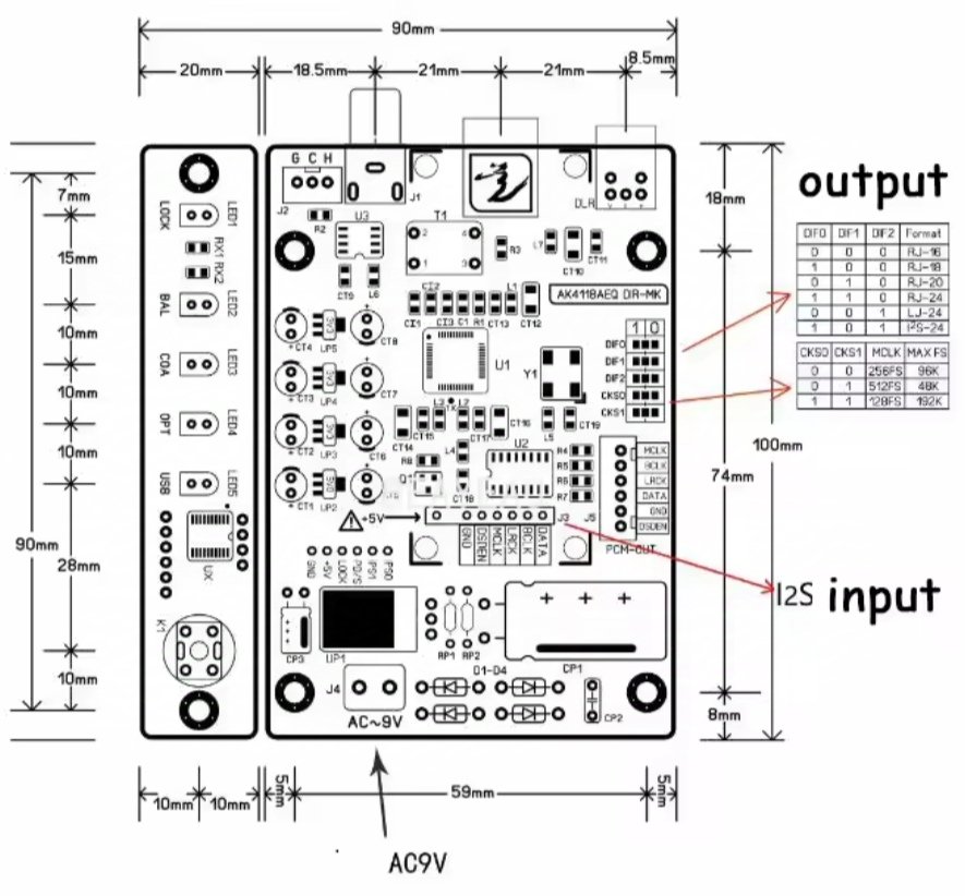

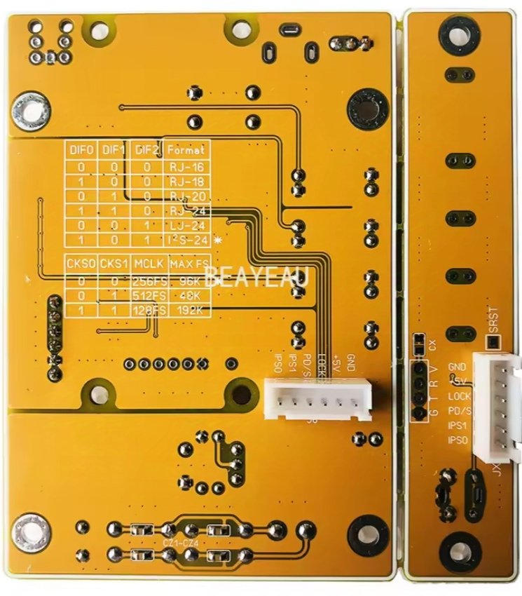

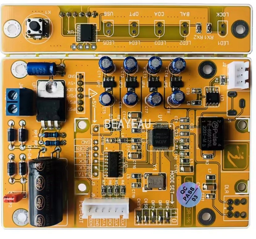

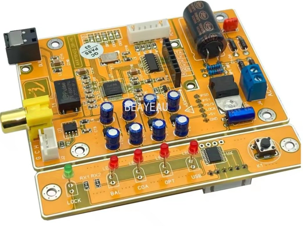

DAC AD1862: Almost THT, I2S input, NOS, R-2R

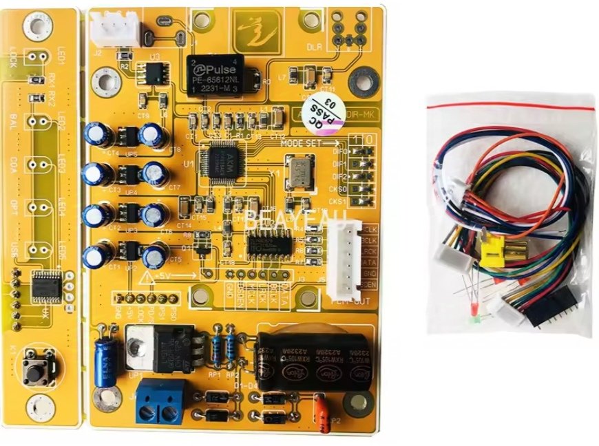

As I have not tried AKM digital recievers, I ordered this one to test with one of the DAC's I'm building. It has an I2S input, so I could use this and an Amanero and have USB, Coax, and toslink inputs to the DAC I end up using it in.
It's worth a try 🙂

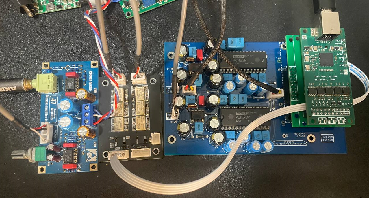

Some updates more related to York but I think it's worth to post it here 🙂
When I used some other USB audio interfaces there was an issue in MacOS that I could not control the volume by the standard OS means, it was basically disabled. And the reason is that these interfaces did not implement volume control, so they were always outputting 0dB digital signal. Except for Windows, where volume control was still possible but handled by Windows mixer. But some Interfaces did implement it in MacOS too.
So I've been thinking that, well, it is possible to implement volume control and handle it on the device side. And it does not have to be digital 🙂
About a year ago I designed a relay volume attenuator module.
Today finally implemented the volume control feature and put everything together:
The attenuator is connected by I2C bus and supplies from USB side. The signal ground of the attenuator is isolated from control side.
And it works 🙂 I recorded a short video as a demo, in the video I scroll the Windows volume control slider:

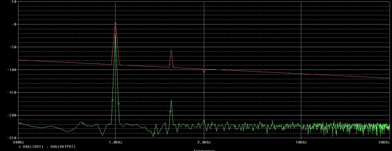

Different spice models (PSpice anD LT spice) for measured tube in triode mode.
Also with static settings for typical 350V Vb.
All in ZIP folder

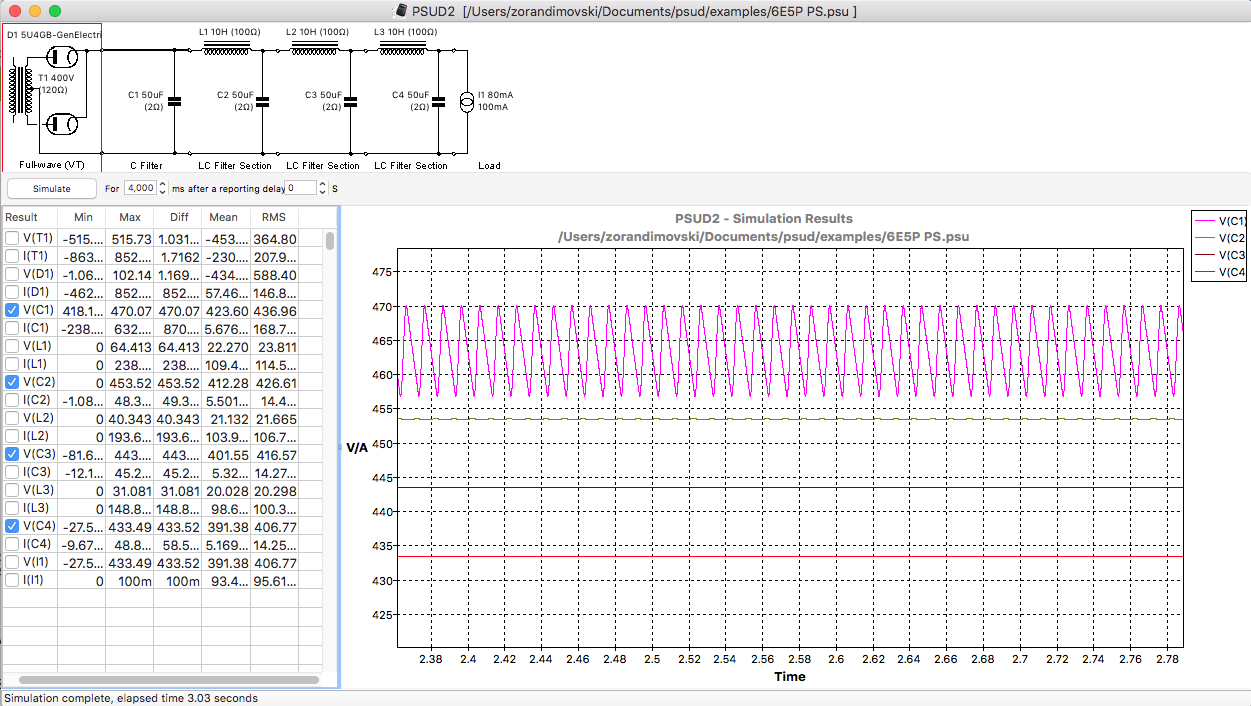

For the 6E5P and 500V DC capacitors limit, somewhat like this PS is welcome, of about Vb=435V, and 470Vmax to be under 500V of capacitor limiting vaue. Max C on 5U4GB is 47uF (50uF will be OK), calculate (depends on transformer Rdc windings) and add 2 x R to rectifier anodes of about 120 - 150 ohms. o have in mind available F&T dual 50uF+50uF / 500V standard caps... Chokes are prety much available and say standard for 100mA current. And Transformer is 2 x 400V AC C.T. minimum 70mA wire, (because in transformer current are each period SQRT(2)/2 then total Io, peaks device will suck from the capacitors... That is transformer of 800V x 0.07A = 56W total minimum and without the losses, so it is about 65W minimum, better 80-100W...

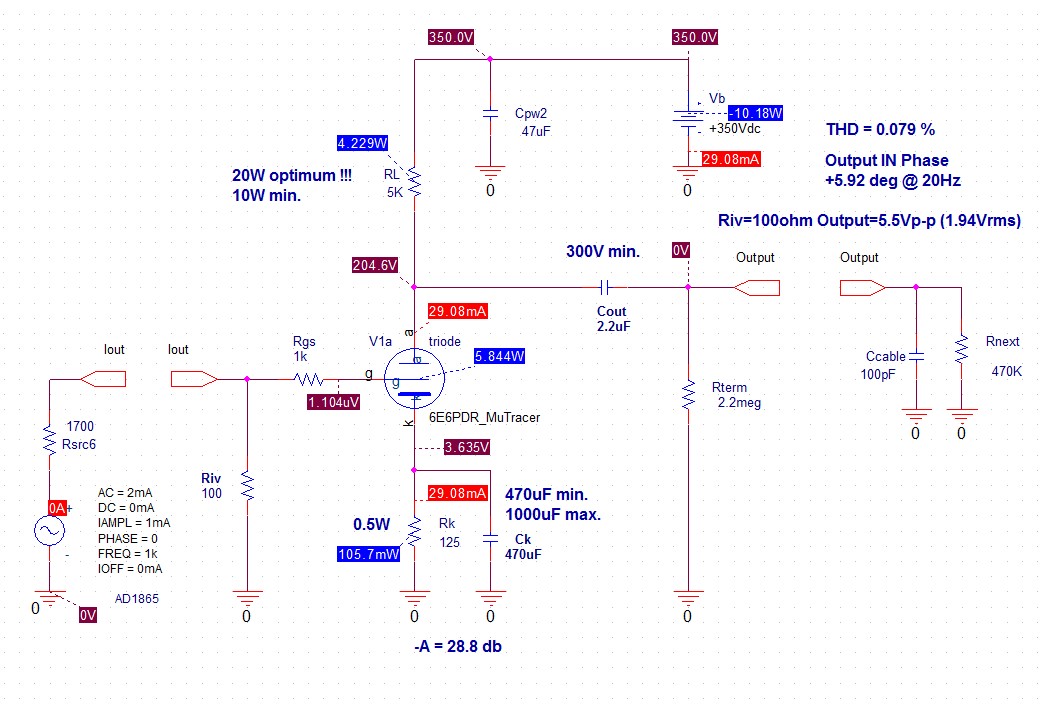

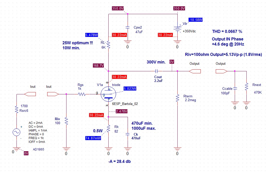

Here are some sircuits for 6E5 tube in triode mode. Settings optimizad for Vb of about 350V.
Very low distortion, sufficent gain, low output impedance less than 1K about 900 ohms, no buffer need for higher next Rin, very good BW, verry low phase shift.
BUT with this component values. Don't decrease Co, don't change Ck, don't change RL value...
Biasing is chosen for -2.4V cca. to be possible to make it with 2 x 1.2V serial connected batteries in cathode.
Value of power for R load is critical and has to be as stated for this element to be just warm. Otherwise it would be huge thermal dissipation causing overhating R and overhating all other elements...
Anode voltage Va=166V cca,
Cathode current Io=30mA cca.
Grid bias -Ug=2.4V cca.
Anode dissipation Pa=5W (less than 50%)
