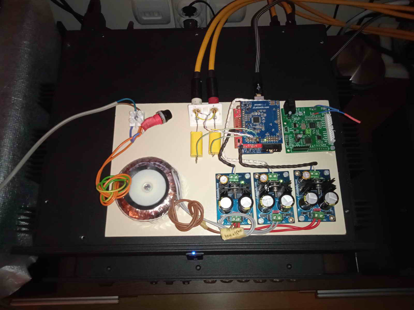

I have another occupation with JLS. I got a JLS stacked combo from a friend: I2S over USB, Oscillator board and AK4493 DAC board. It works fine, but it only has a USB input. Now I have to put the AK4118 SPDIF receiver board in it. The idea is to cut the I2S connection between the USB and the oscillator board, to go to the I2S input of the SPDIF board with MCLK, Data, BCK and LRCK, and then from the I2S output of the SPDIF board to return all those signals to the oscillator board, which forwards it to the DAC. Then there is a choice of input for USB or SPDIF/TOSLINK on the AK4118 board. And then it all goes back into the box with the tube gain stage (it was taken from there). 😁

I have to make it to work with what I have, otherwise I'd ditch the AK4493 and put in some Miro DAC. Unfortunately, there is no room or power supply for that. AK4493 has always been bass shy for me, I don't know why. I imagine the tubes will add some meat and fat, so that they are not just bones on the menu. 😁
