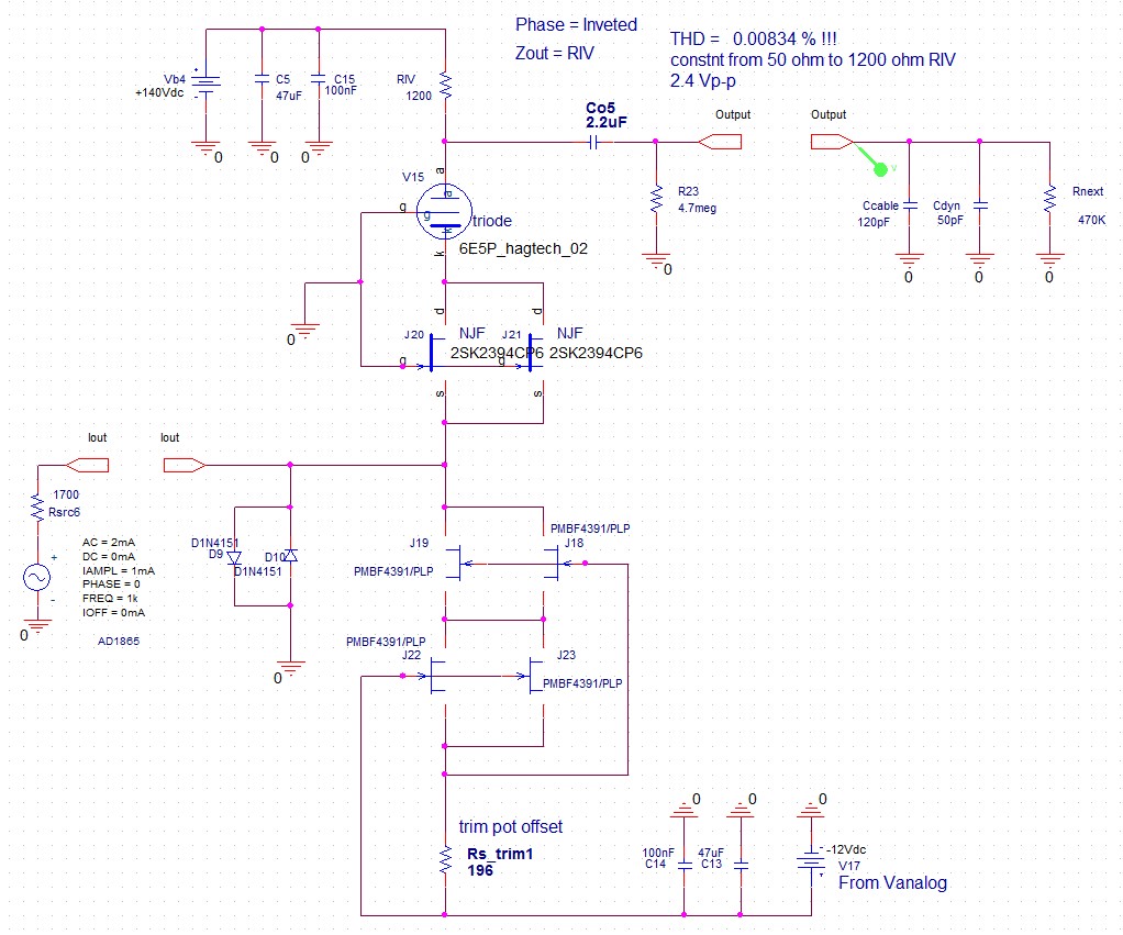

there is a use of 6E5P in very small signal environment. Opposite than in driver arrangement.
There is present small signals, and no capacitive load at the output as present with driver?
Based on this major diff. expected sound outcome can be diff. too?
I will post another topology, also simple with grounded grid. For this aplication high transconductance is a must. And at laeast we can compare simulated results...
The best way s to try?
Advantages of these high transconductance tubes are:
good amplification capabilities - lower Riv value
low internal resistance and ouput impedance as parallel Ri II Rload, under 1K = avoiding additional buffer
(but still cant drive solid state amps with 10K at the input...)
correct phase after phase shift @ Riv
Simplicity (if we lokk at the other side of Power Supply 😎)

as I wrote 6E5P in iV is in total different position then as the driver. BUT maybe is better to use 6E6P.I am tempted to try 6E5P in IV. But also 6AC7 which sound I really like. Need more time!

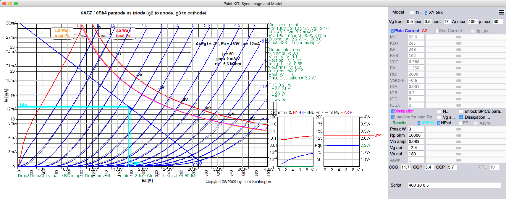

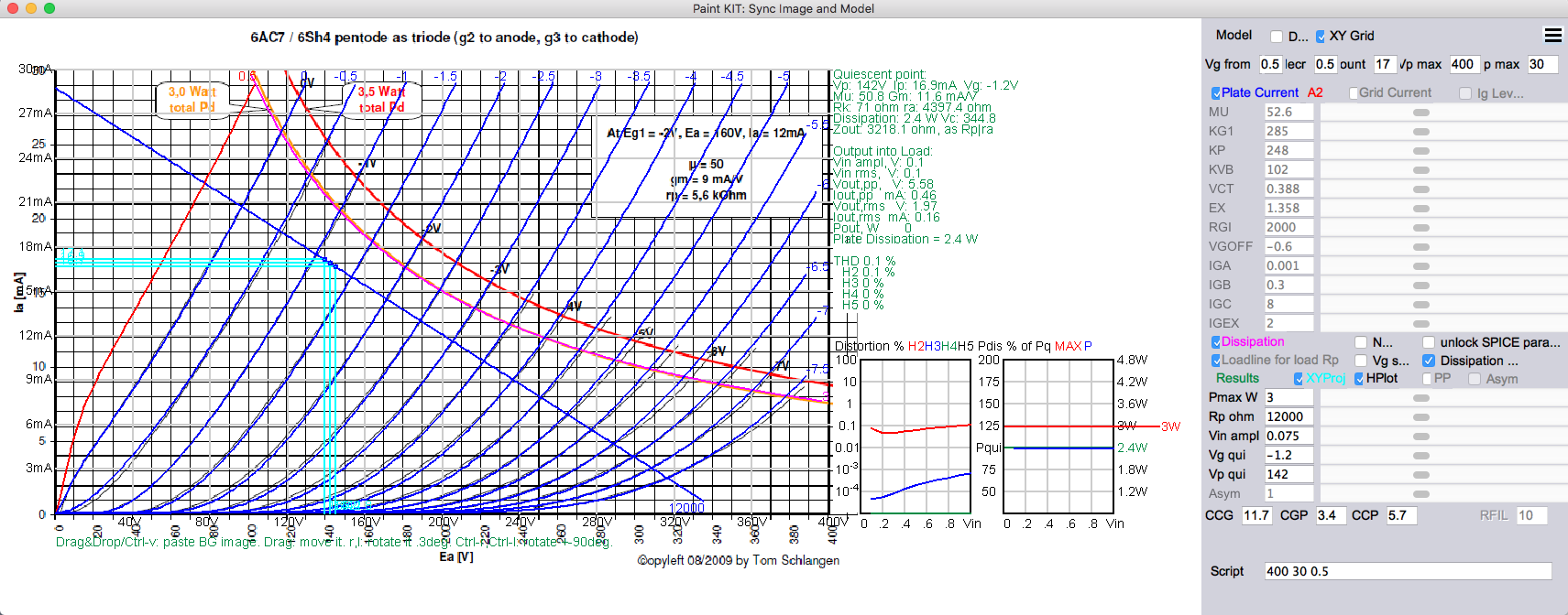

I made some model for 6AC7 in triode mode. Based on Tom Schlangen measurements.
It could be used as amplification segment after Riv. I will try to simulate in spice elements in the circuit.
The tube in triode mode is linear, just a little less than 6E6P, higher internal resistance stil enough for driving high Rin of the next stage. For universal use nedds a buffer...
Can be set on lower voltages or a bit higher with most common present power suplies under 350V.

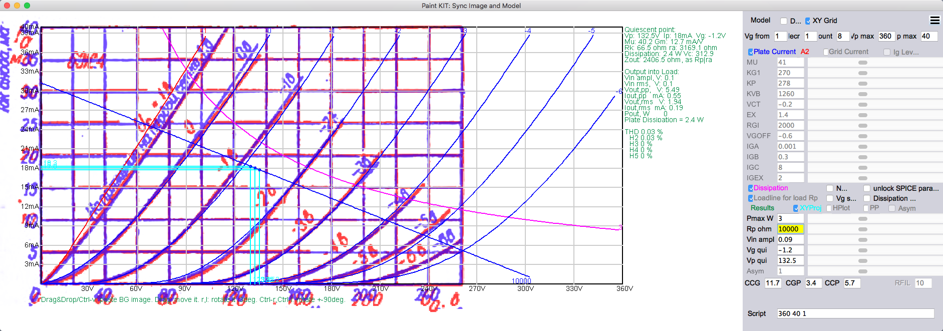

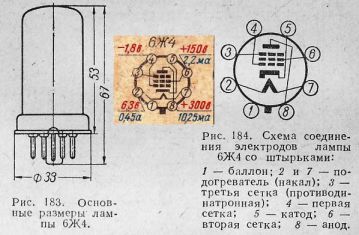

6Ж4
Russian tube equivalent to 6AC7. Very good tube, excellent build, afordable, I suggest this tube as 6AC7.
On this link we can see the internal structure.

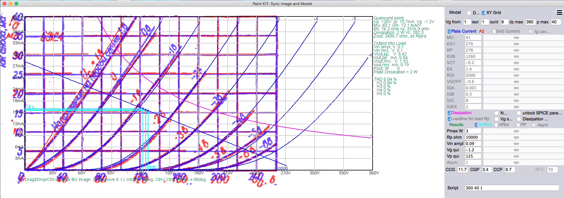

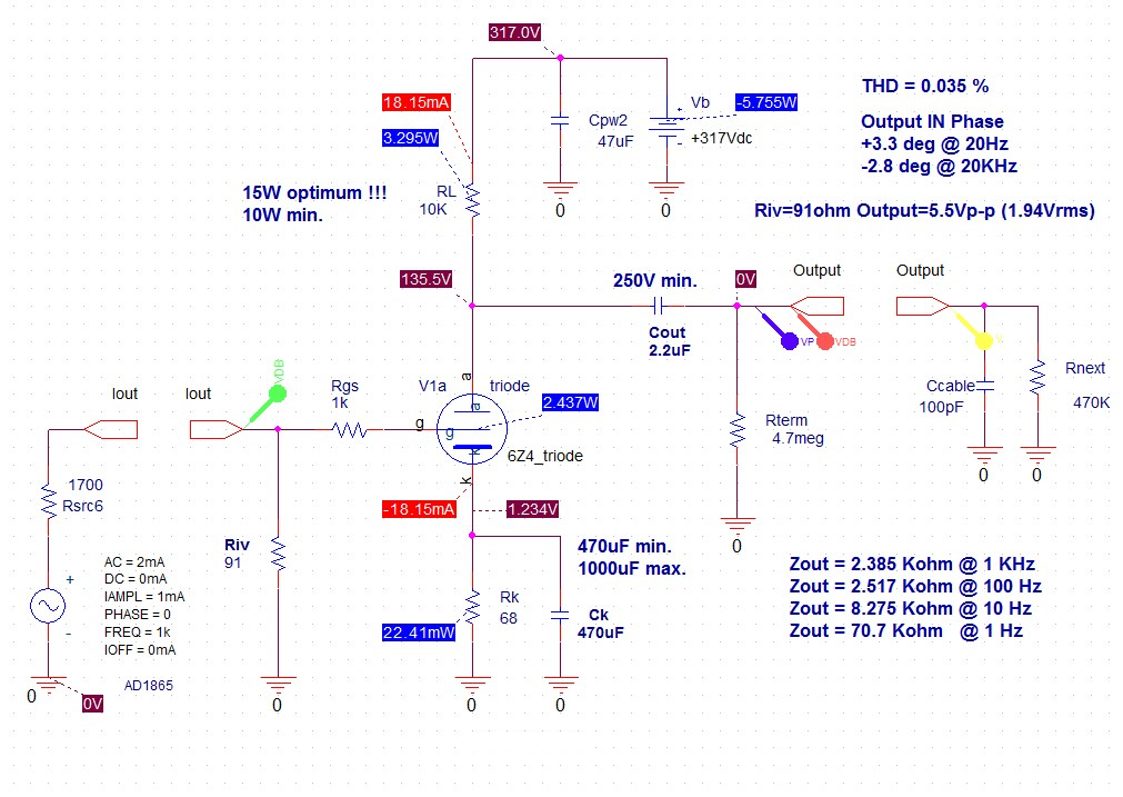

I made sice model based on tube datasheets. Two original measurements in triode mode are virtualy is tha same.
Again, tube is very linear, low distortion in this Riv aplication, moderate ower supply, no expensive elements. Etc...
this tube has separate pins for each electrode and can be configured on 2 ways in triode mode.
I presume that in factory measurements G3-K, G2-A.

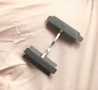

This is shape of the anode surface i captured from the video. This is open 2 plates anode.
For now, static graphs and spice model only. Latter I will try to put model in spice...

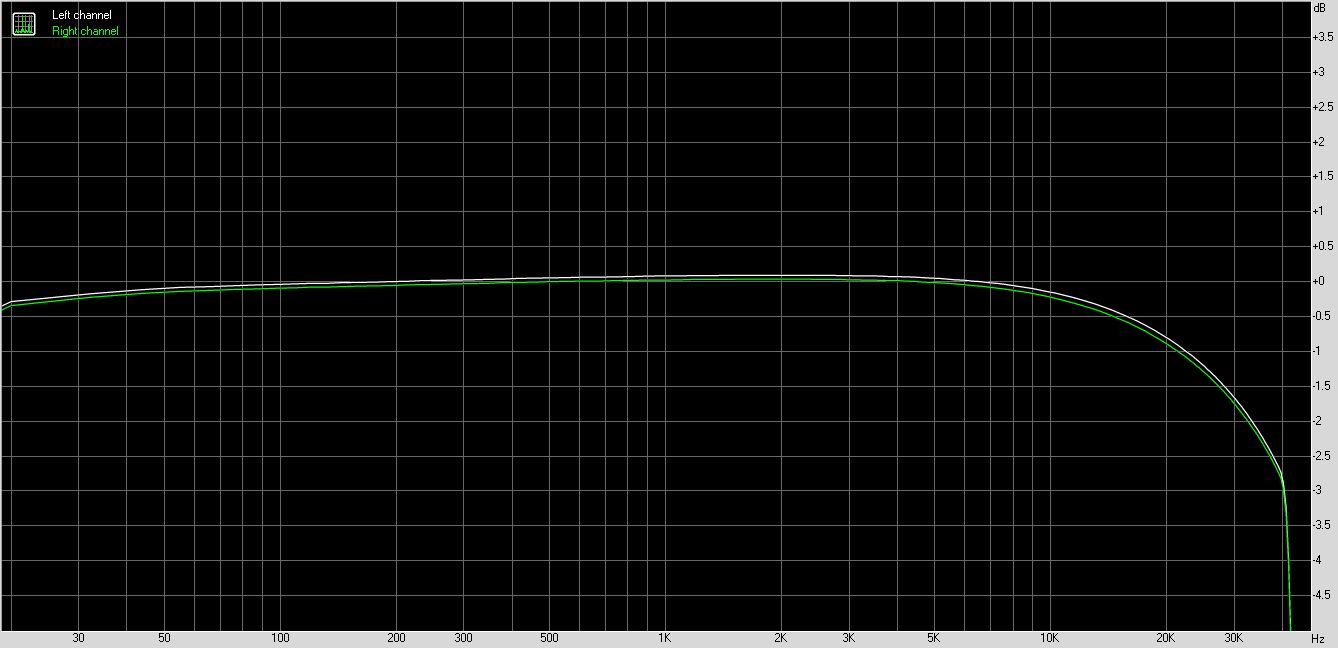

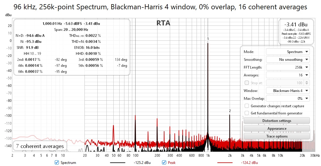

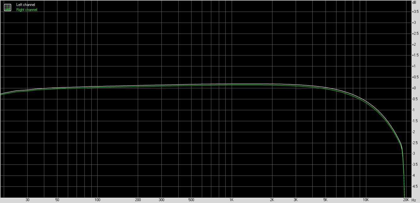

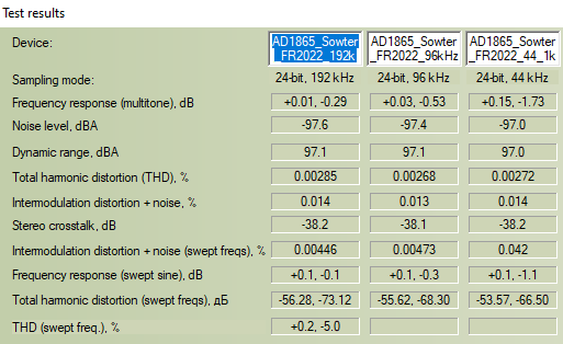

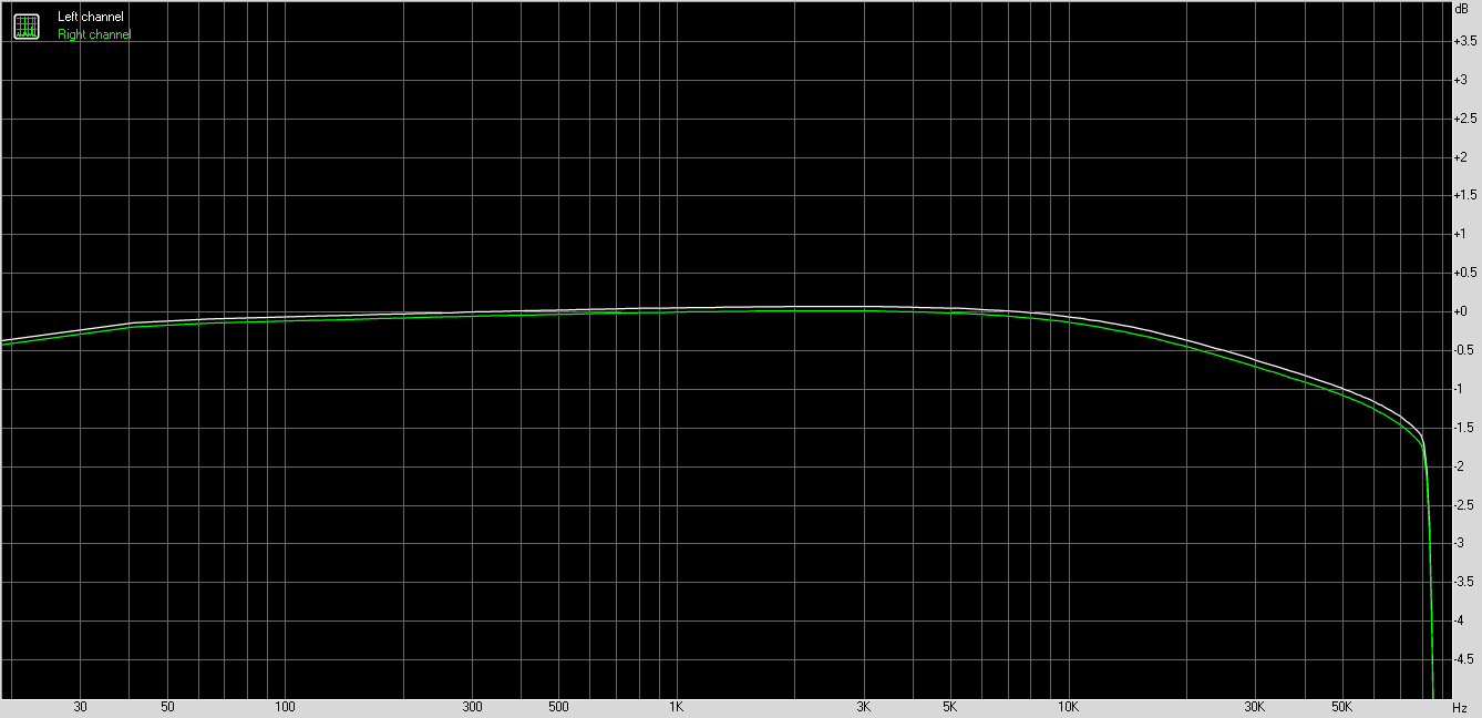

As I mentioned I did some measurement:
Raspberry Pi 4 (i2s out) - IanCanada FiFoPi v2 - my AD 1865 DAC HAT (link) - 39R I/V resistor - Sowter 1495 (1:9) - DIY Forn End 2022
Measurement has been done by Cosmos E1DA + Cosmos Scaler
Disregard the crosstalk, sometimes it gives bad values. Cosmos E1DA switching to mono if no signal at channel 0. That's the reason why L-R and R-L are different. In the reallity it should better than -78dB
Basically THD is according to AD 1865 datasheet.
As I promised, one grounded grid IV circuit with 6E5P tube. But can be 6E6P used too. Key word is transconductance.
These JFETS on the schematics are best performeres at least in spice... Circuit is iesy to set to 0mv to the DAC Ioutput.
Distortion is very very low, and for almpst any value of this time, external Riv. Minimum of elements required. No complementary, no push-pull no globala FB. All SE...
BUT the Output is out of phase. -180deg.
That is for OK for use with tube preamps, one stage, which are also inverting phase, so the right phase will be on amplifier...
Output impedance at 1 K to about 100ohm is equal to RIV value. And it can be used without buffer.
For RIV = 1200 ohms Zout = 1200 Ohms, Vout p-p=2.4Vp-p with 2mAp-p DAC Iout current.
Best version of this topology was with classic ECC/PCC88 parallel sections, one tube per channel.
One standard topology with russian 6Ж4 pentode in triode mode.
Very good behaviour, low Zout, Linear, small disttortion, in-phase, very good amplification Riv can be lower,
Moderate Vb (power suply voltage), very low phase drift at the end of BW but with given values only,
with other values of C the phase will be hardly degraded and sound too.
So 6Ж4 is very useful tube.
For all AD, and PCM old DACs with 2mAp-p RIV is 68-to 91 ohm
For PCM63 with double Io 4mAp-p, RIV value is 1/2 for same Output Vp-p, for instance 33-47 ohms.
@Zoran Rp for 6AC7 is 1M (as per datasheet), I cannot find a datasheet with Rp for 6Ж4. From your model I see it's 10k. It's interesting, since 6AC7 and 6Ж4 should be very similar. @andyjevans mentioned 5x rule - I wonder, how does the model look like for RL at 50k?
Very good for ccs, this one.One standard topology with russian 6Ж4 pentode in triode mode.
The other one with grounded grid, those jfets serve as ccs (sink) ?
Just for clarify:@Zoran Rp for 6AC7 is 1M (as per datasheet), I cannot find a datasheet with Rp for 6Ж4. From your model I see it's 10k. It's interesting, since 6AC7 and 6Ж4 should be very similar. @andyjevans mentioned 5x rule - I wonder, how does the model look like for RL at 50k?
Rp is derived from R plate that actually mean Internal resistance of the tube and real name is Ri
R on P (as plate), is R load at Anode. And that is actual Anode load resistance. Mark is RL because it is more clear.
Ri = internal resitance of tube
RL = external load resistance at anode
Ri of pentode is very high, but the very same pentode connected in triode mode, has significantly lower Ri,
Also significantly lower amplification factor...
But as I wrote this is not Load resitance.
So
It is not true that rule 1 : 5 = Ri : RL exists. Rather some mathematical deprivation for maximum efficiency in literature is 1 : 2 = Ri : RL
But
that is not for minimum THD, Optimum static load line, considering Input signal value, considering output signal, etc.
In short words we have an context where we need to put and set the tube, and we have some pre-designed parameters for tube to fit with own characteristics...
And it is not guessing at all if we want success in sound outcome.
Take a look at the staic chrs of tools software graphs where RL is present and You can see very narrow region of real opperation of the tube regarding of input signal...
If You think about Gyrator (sort of CCS in Anode, as the Load) then yes.Very good for ccs, this one.
But it is an active circuit with dozen active elements of JFETs MOSFETS and BJTs and dozen of also additional pasive elements. On the othe side we have one tube... Considering this fact that is more solid state circuit than tube?
And all that for repalcing, with a good reason, complicated and non faceable L as the load...
With specific outcome of sound signature of very high level load almost parallel with voltage axes.
As for more tube design we have SRPP or Mu Follower circuits, that actively load the anode, and circuit has in the same time low output resistance.
For instace we can choose higher RL than 10K to match higher already present power supply of say 350V
Without changin a lot sound of the circuit.
That will be 350V - 317V = 33V and with 18,17mA resulting in 1816 ohms additional to 10K
about 11.8 to 12K R load for 350V PS
Bare in mind additional dissipation too 🙂
Yes, these 4391 are Constant current sources in negative supply branch for stability and better PSRR. Cascoded and paralleled for match the total current flow and minimize dissipation. With changing the bias trough we can set the off-set to 0mV @ Iout pin of the dac. Protection diodes are added at the DAC Ioutput.The other one with grounded grid, those jfets serve as ccs (sink) ?
(In sims they are giving even slight better results than witout... No reasoun not to believe that in real world will be the same)
Other JFET in cathode is for biasing the tube.
Transconductance of the tube is keyword with that circuit and 6Z4 has satisfied.
Note that total Vb is moderately low and achievable.
This circuit is interesting because for very low values of Rload as RIV we can obtain external RIV that is not directly loading Ioutput of DAC. In this type DAC has going to very low impedance input of the circuit.
Thank you for clarifying, I missed the part that plate resistance is specified in the pentode mode http://www.r-type.org/pdfs/6ac7.pdf. I think the 1:5 rule is based on listening tests - I am definitely going to try it with different tubes.Just for clarify:
So
But
