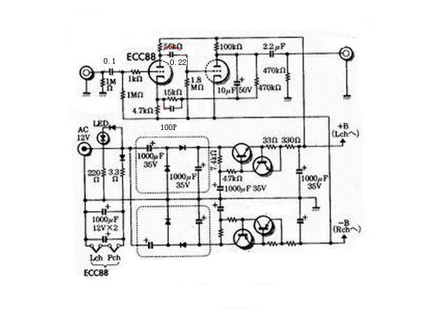

That looks like a Musical Fidelity X-10D Buffer clone board.
If it is, no voltage gain in that circuit.
The power supply is a clone of the X-10D, but the schematic is not, it is different. Neither is worth it for this DAC.
