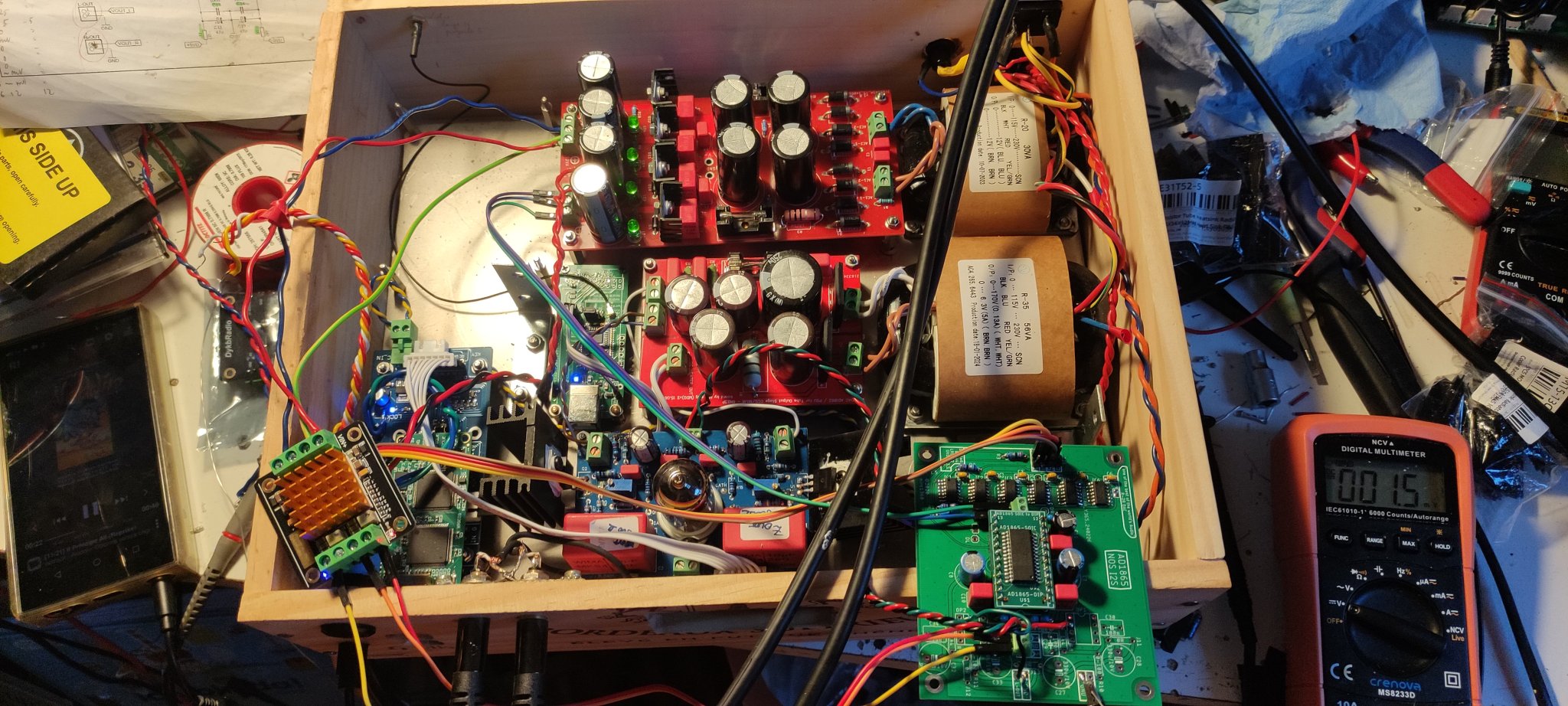

@mehdism IC1 must be 74HCT164, you have only HC version ... it would be good if also other shift registers are HCT version 🙂
But the problem can be also in TDA1541, not all are good, some can have defects because all were used previously 🙂
Regarding DC offset, please note that the USB cable from USB-I2S device must be connected in computer during all testing and set-up. When the computer is off there can be always some dc offset on the output 😊
Thanks dear miro
I had not paid attention to the shift registers.
In the next step , i test cpld
I put the 47NF polyester cap(Because I had less capacity ) on c15 and pink noise remove 🤷🏼 and dac work fine 😁
I never tried it, so it is impossible to say something about it 🙂

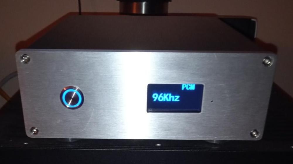

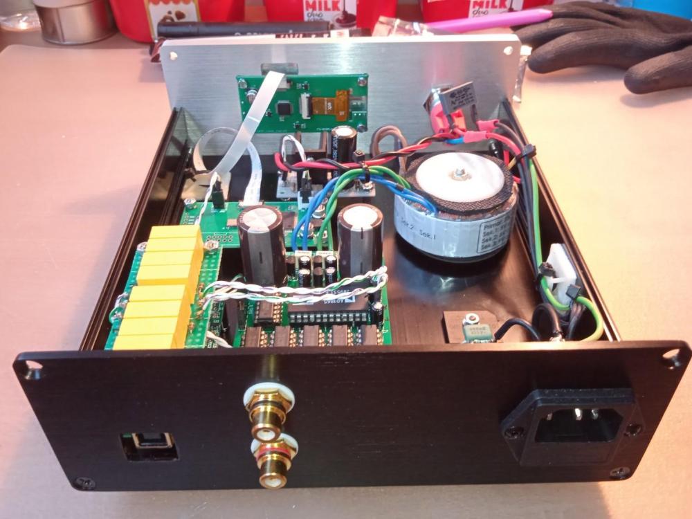

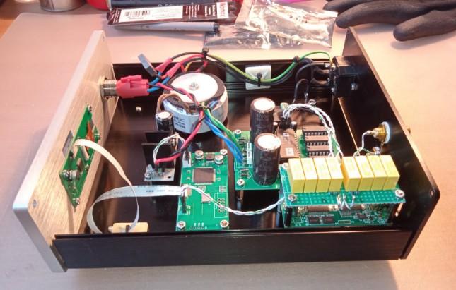

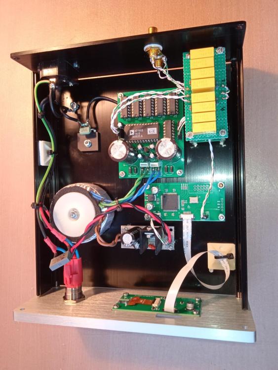

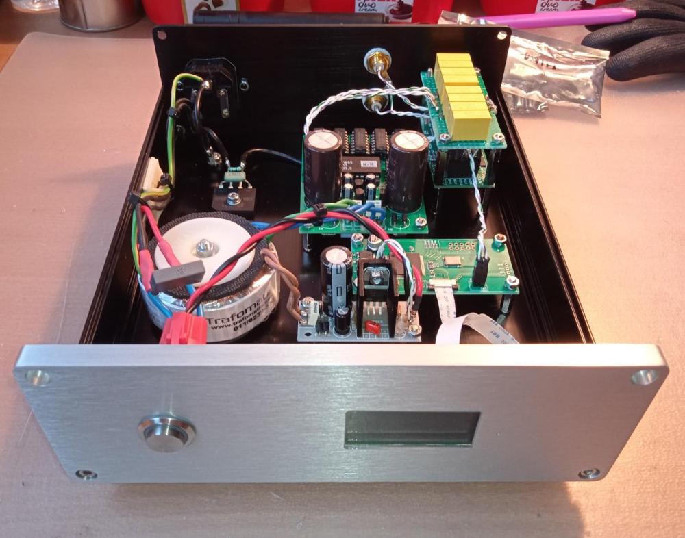

While I was watching the Australian Open with one eye, I built a small DAC with AD1865 N-K with another one. It's not exactly a Miro DAC, it's a Pavouk DAC, but the schematic is similar.
It has only a USB input, I took a Chinese Amanero USB/I2S card with SITIME oscillators, upgraded version. Works flawlessly with original Amanero WIN10 drivers.
The transformer is custom made 10VA. It has a grounded static shield between the primary and secondary windings and magnetic shielding. Transformer secondaries have snubbers determined by the Quasimodo tester. There is not a trace of hum even if the transformer is very close to PCBs.
It also has a small Chinese display for sampling rate. It says Welcome when it turns on. 🤣
The same thing, just packed in a metal box from Aliexpress. I put a slightly bigger and more beautiful display. I am very pleased with the sound and appearance.

Yes, it's a little nicer. But it sounds the same as the plastic one. 🤣
What look like transistors are LP2950ACZ-5.0 voltage regulators. The circuit is the same as the Miro AD1865 with shift registers, only the internal opamps in the AD1865 are used for I/V active conversion.
There are many fans of this kind of sound, moderately soft with plenty of bass. I prefer the Miro version, tighter sound, more open (depends on the opamp).

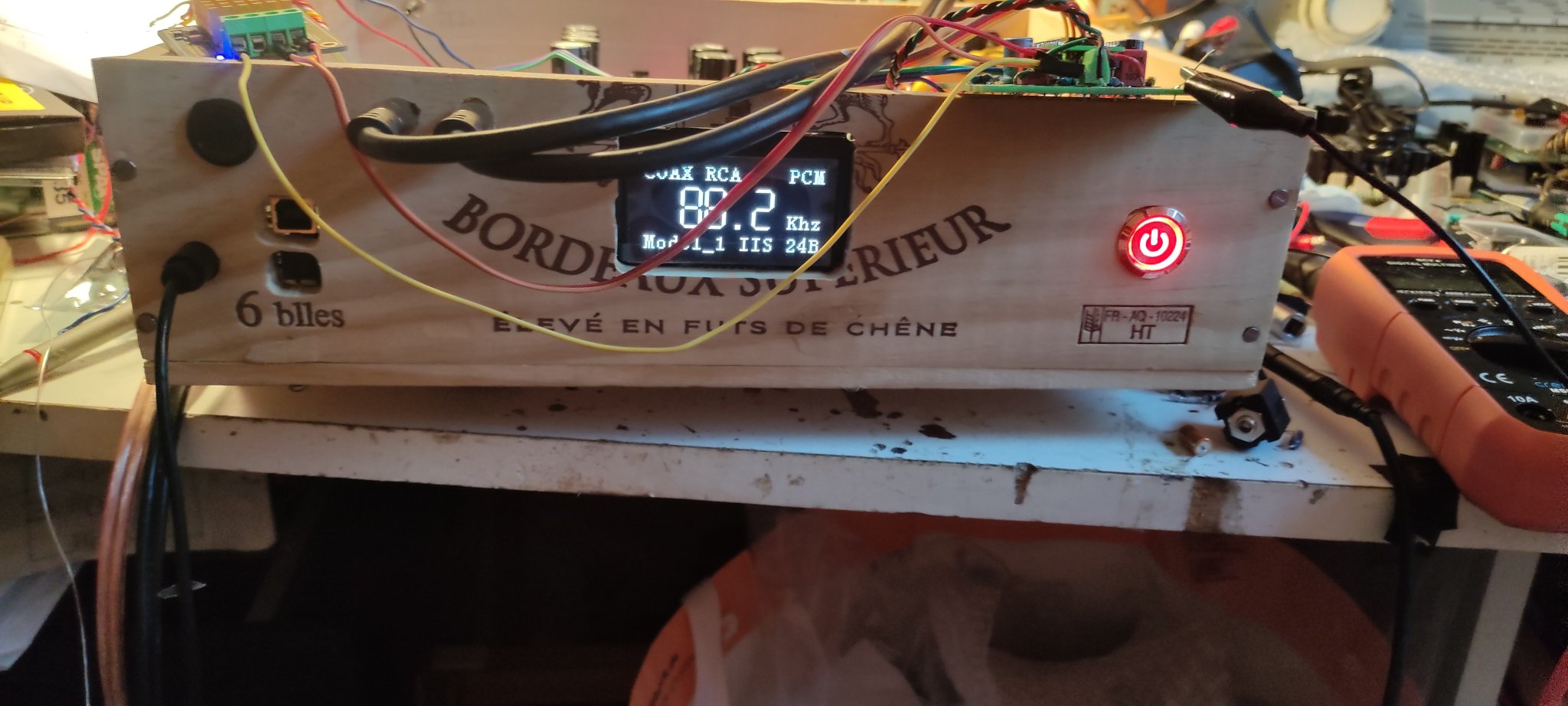

Nice setup
Two observations I presume you are using the LRCLK sample rate display (chinese one) its greatest drawback I think is its frequent "hanging" and not refreshing the sample rate frequently.
This was my Vout AD1865 DAC, since I had over 20 chips to play around I experimented a lot, in the end gave up on Vout, the internal OPAMP albeit good is not reliable and as mentioned earlier once its fired the DAC is gone.
In my experience Bursons are best combo with AD1865, followed by OPA627.
Reactions: zoom777
Reactions: rehanabid
Yes, the display is Chinese, as is the Amanero USB/I2S board, but I didn't notice any problems when changing the sampling rate. When I disconnect the LRCLK to the display, the sound does not change. I tried that right away, already with the previous display. If it showed some bad influence, I wouldn't put it. In principle, the display is $30 for a nicer device. And it is useful occasionally.

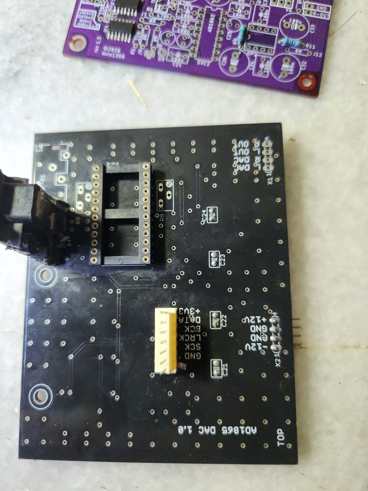

However, while waiting for ad1862 replacements, was does one?
An AD1865!!!!
Not bad, really not bad sound, quite natural and flat, I would say more "neutral" than his brother 1862, according to my ears... Nice bass... Same setup, tube output.
