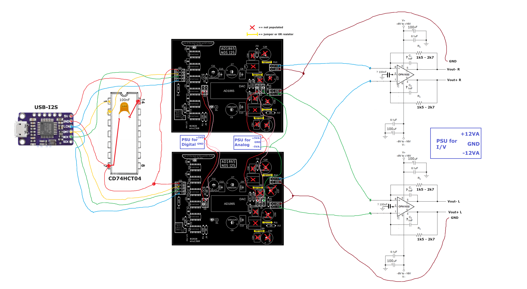

@Cooper60hz Miro once detailed a circuit with two of his DACs using differential op amps -
abraxalito also does a phase inverter module to split I2S between DAC boards.

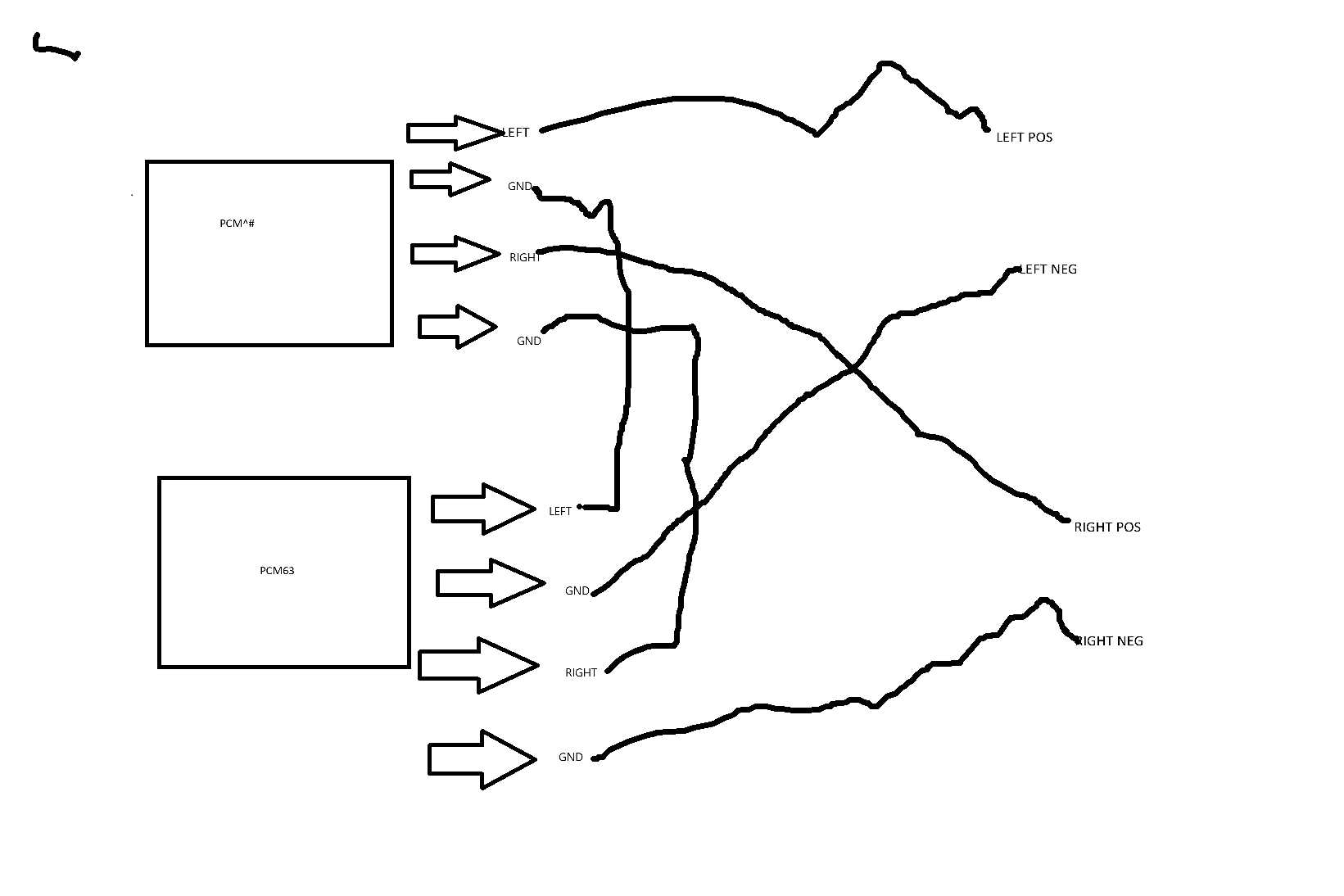

You need to use flip flop/inverter to invert the signal for the second dac. You cannot do it as is. Especially nit like you drew it passive has attached a drawing up above your post.So just to confirm this wont work?

Lads, what's the rationale behind a full balanced diy dac? (passive, you already gave me an exhaustive answer, so you do not need to ) Are you getting a little caught up with this dac ?@Cooper60hz Miro once detailed a circuit with two of his DACs using differential op amps -

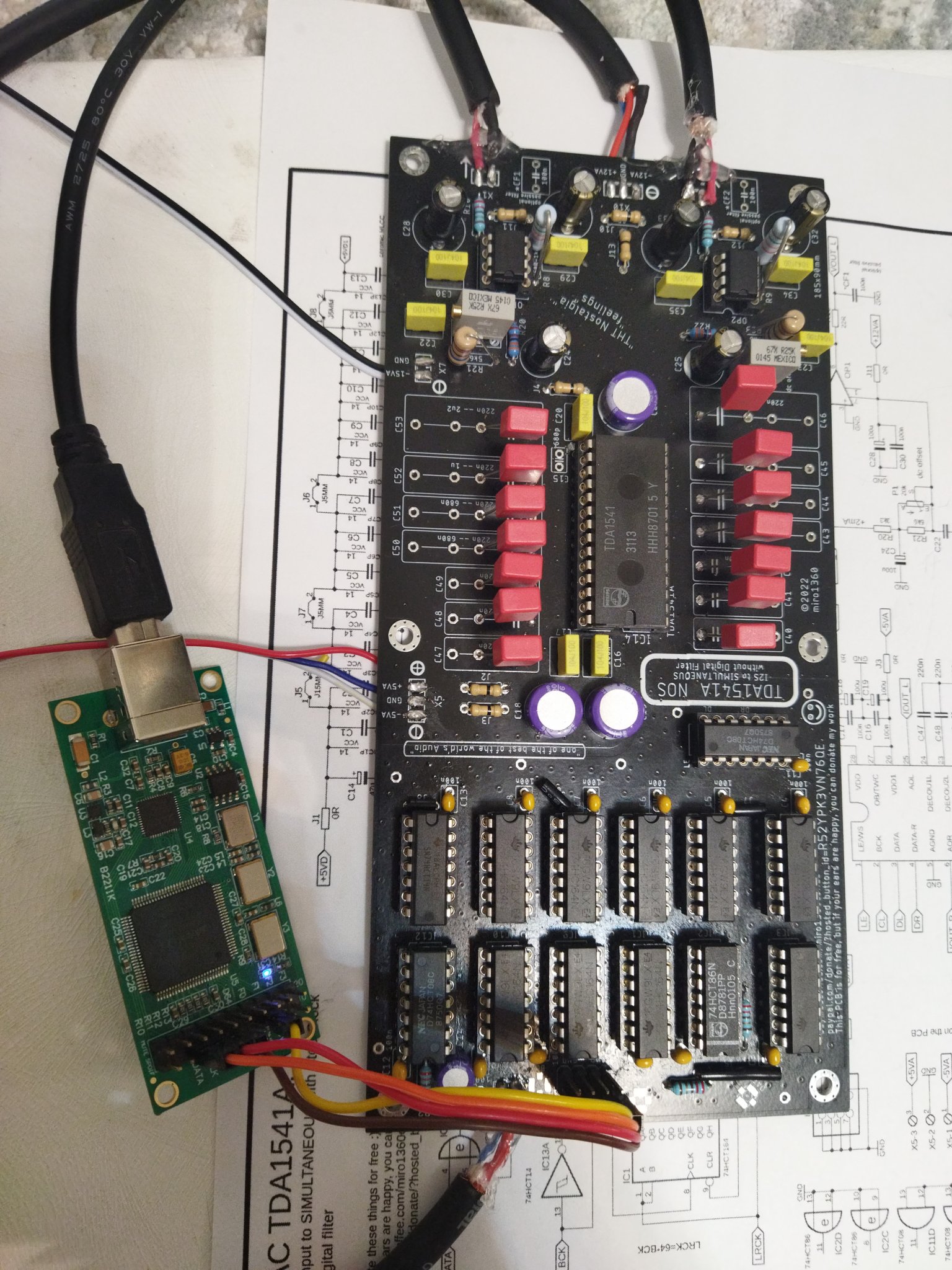

Hello
I have built miro dac TDA1541 and put TDA1541 NON A version on device without C15 cap.
I used wima 470np for decoupling cap.
i played music after set trimmer to 0v , midrange and low frequency is fine and clean on speakers but high frequency have jitter and a bit pink noise.

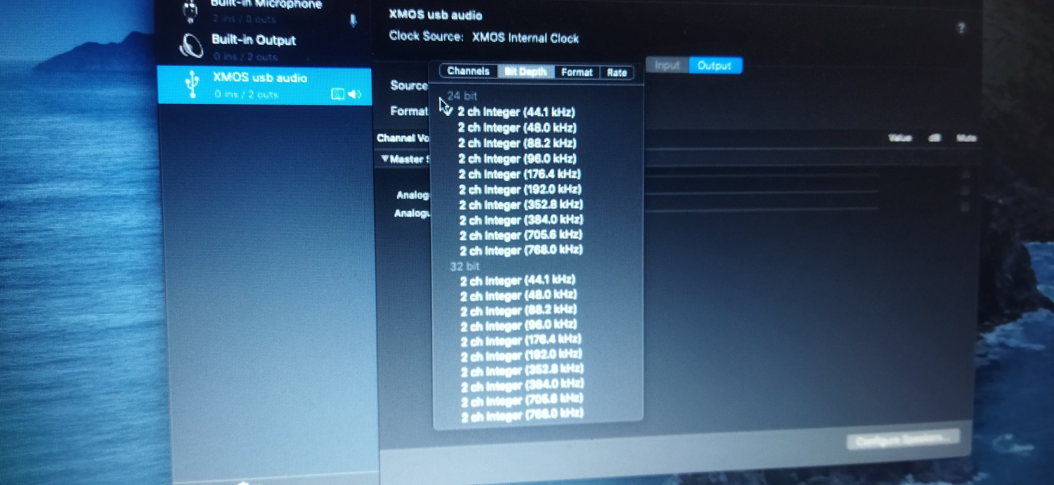

after check the usb module for set bit depth on 16 bit i seen that 24 and 32 bit supported.
I used this usb module:
Link
USB GND - DAC GND
USB DATA - DAC DATA
USB BCLK - DAC BCK
USB LRCK - DAC LRCK
PLEASE HELP ME ?😁

connections are fine. If you use materials with more than 16 bits, it works, the DAC will just read the first 16 bits w/o consequences.
Problrm is certainly eslwhere. For instance a noisy smps source before the USB (pc ?). But it can be anything. Proceed with try and errors. Has the chip being tested elswhere before ? Another chip to try.
Picture can help to debug the hardwares layout .

try 4 qty TDA1541 chip and problem is there.
now dc offset on left output not changing and is 0.8v.

@mehdism IC1 must be 74HCT164, you have only HC version ... it would be good if also other shift registers are HCT version
But the problem can be also in TDA1541, not all are good, some can have defects because all were used previously
Regarding DC offset, please note that the USB cable from USB-I2S device must be connected in computer during all testing and set-up. When the computer is off there can be always some dc offset on the output

I do not believe this as he tested several ships. While it is easy to try : find a tda1541A, add 560 to 680 pF between pin 16 & 17 and ears what happens !@mehdism IC1 must be 74HCT164, you have only HC version ... it would be good if also other shift registers are HCT version
