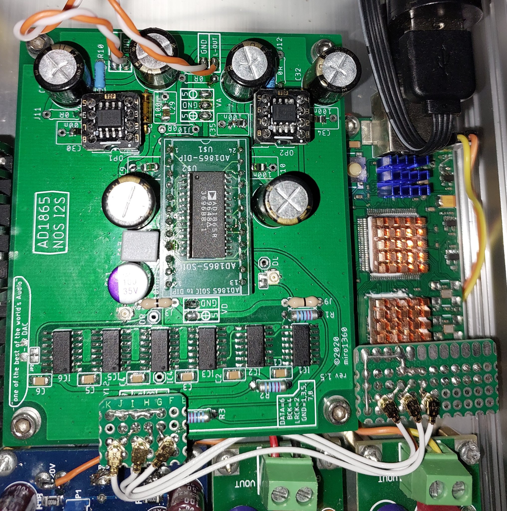

@passive420
Thanks for your adapter board and AD1865. Works perfectly. Letting the chip warm up for next couple of days.

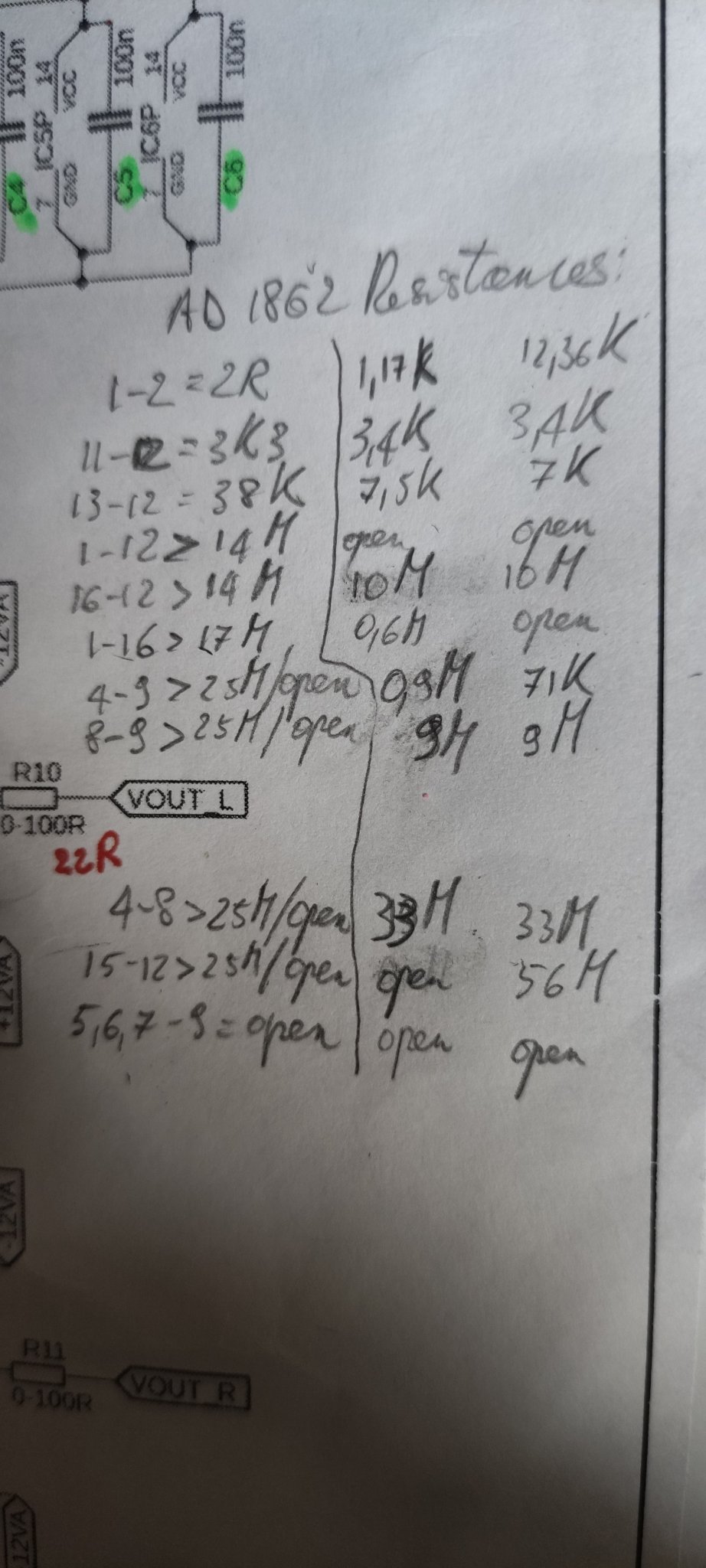

Back trying to make my DAC work.
Though there is signal on pins 5,6,7 (bck, lock, data), and voltages are ok, I see on the scope a flat line out of pin 11. For both. Also after the I/v resistor. Flat line.
Tube CCS is working though, applying a signal I get music.
How to test ad1862 stand alone?
Reactions: rehanabid
How about ground connections?
