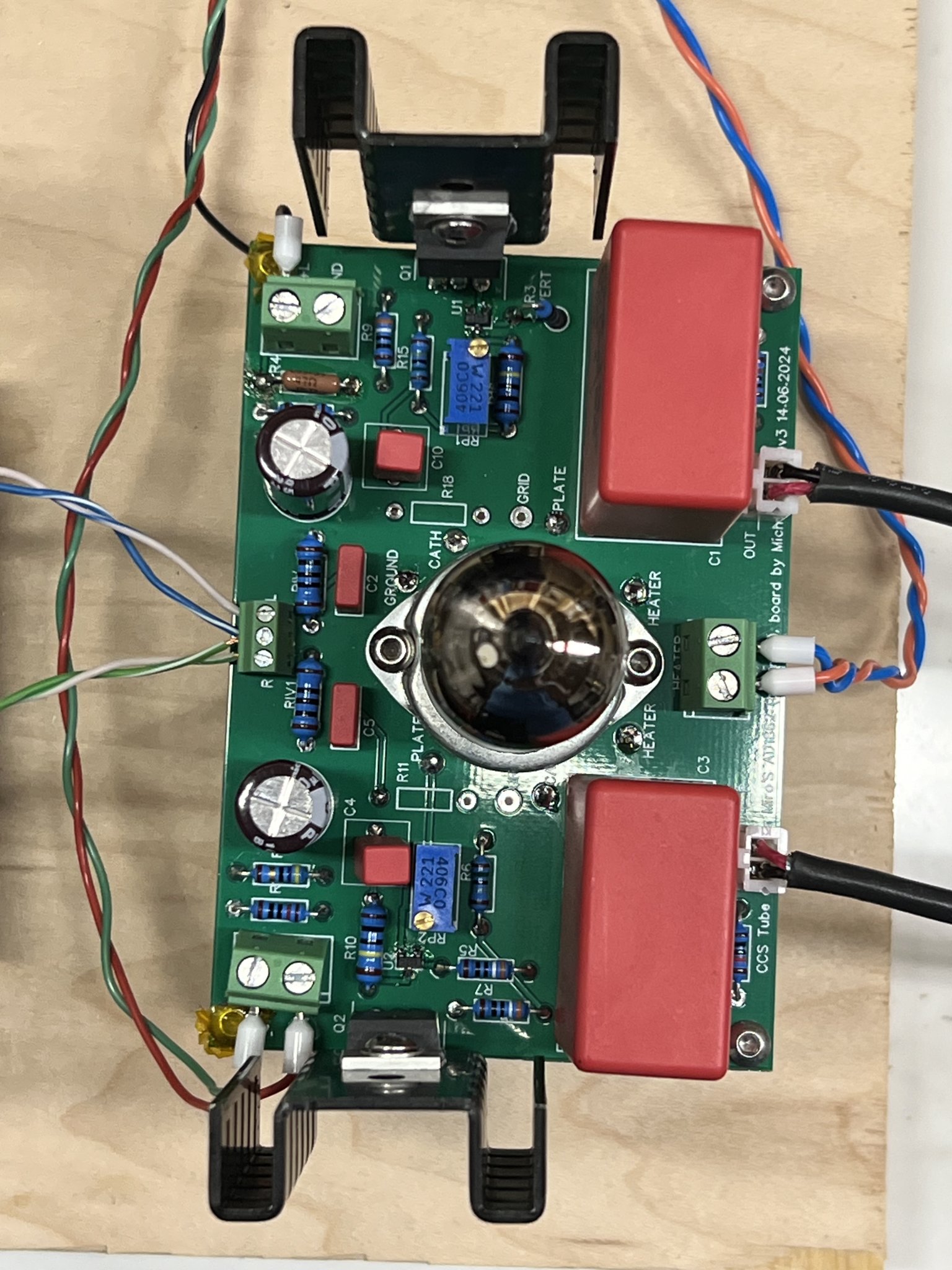

I finally finished the Tube I/V after some trouble shooting. The build went well and I was able to dial the plate voltages in with no problem. Connected to the DAC and there was music from the right channel, but a few popping sounds in the left. After checking the voltages again I was getting power supply but the voltage on the one plate was very low. It turns out the R4 went bad. There were no telltale signs of failure, but the resistance was way off. I replaced the resistor and dialed the voltages in. Now I’m getting sound from both channels and it sounds nice. I may replace the other so they are matching, but since it is not in the signal path I’m in no rush.
Also, I installed the grid stoppers underneath very close to the pins.
Thanks for the great sounding I/V.
