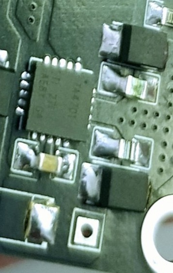

The VQFN smt package TPS7Axxxx regulator chip is tricky to solder, no exposed legs and a belly pad. But like Passive420 mentioned, it can be done with a hotplate and hot air method. If you haven’t had the pleasure to solder these successfully, you better get extra’s for practice 😂.So at the end of the day what is tps7? A component? A board?

Quite small, but can be soldered by hand if you have solid experience in smd soldering. In my designs belly is always TH pad, so it can be soldered from below. I did one to test, but i have directly heated tip soldering station, and a choice of tips. But yeah, i use hotplate station, much easier and less chance to destroy the chip.
Here you can see, gnd plane is between input and output part of the regulation circuit, which is important. Also impedance of the circuit, LC filter can be formed with resonant frequency that can cause oscillation. Depending on the layout and caps used, care must be taken.
flux is really your best friend, I am now going to the pub with it ! It makes really your life simplier and easy and way cooler ! Yup it is really feasible to solder this package with a 0.5 tip. One thing though : all those flux that spreads below the parts as well as a bigger soic is hard to remove even with isopropyl ! And that is a problem for stray capacitance...

Soldering wise, no, never use hot air gun to solder components, that is a very very bad practice. It is a tool to DESOLDER and rework components, why it ended up being a choice for soldering beats me.
As for dac chips yes, they are more succeptible than ops, but one can argue that lower zout tends to have have better impact than little bit more psrr (i tried both lt3045 and lt3092, comparing them to tps7 on the same dac chips, and i audibly liked tps better, hence why it stays in my dac designs). And many have had this experience as well, but lets call it subjective and not take it into consideration here. But i do like to both have technical aspects and audible as my final judgment.
What you use to solder just one chip like 47, not all board?never use hot air gun to solder components, that is a very very bad practice.
(I have smt oven, but for one chip I many years use hot air gun)
I use soldering iron for single chip (when is that the case anyway?), much much better (not easier, just better), way less of a chance to destroy the chip and surrounding components. Do note i already wrote, for diy purposes i use TH pad below for gnd/thermal, so belly is also solderable.
A Tefal can be nice but you need to check the temp and use a low temp solder paste. It's 101 diy though.
Don't know, why it is better.I use soldering iron for single chip (when is that the case anyway?), much much better (not easier, just better),
I've soldered (at home and at work) hundreds of QFN chips using a hot air gun (not just TPS7A47/33) and never had a problem.
W/o stensil and w/o soldering paste, just put a solder on pads and don't skimp on flux.
(Including bigger QFN like XMOS and other CPU, soic8/msop8 OP, etc.).
