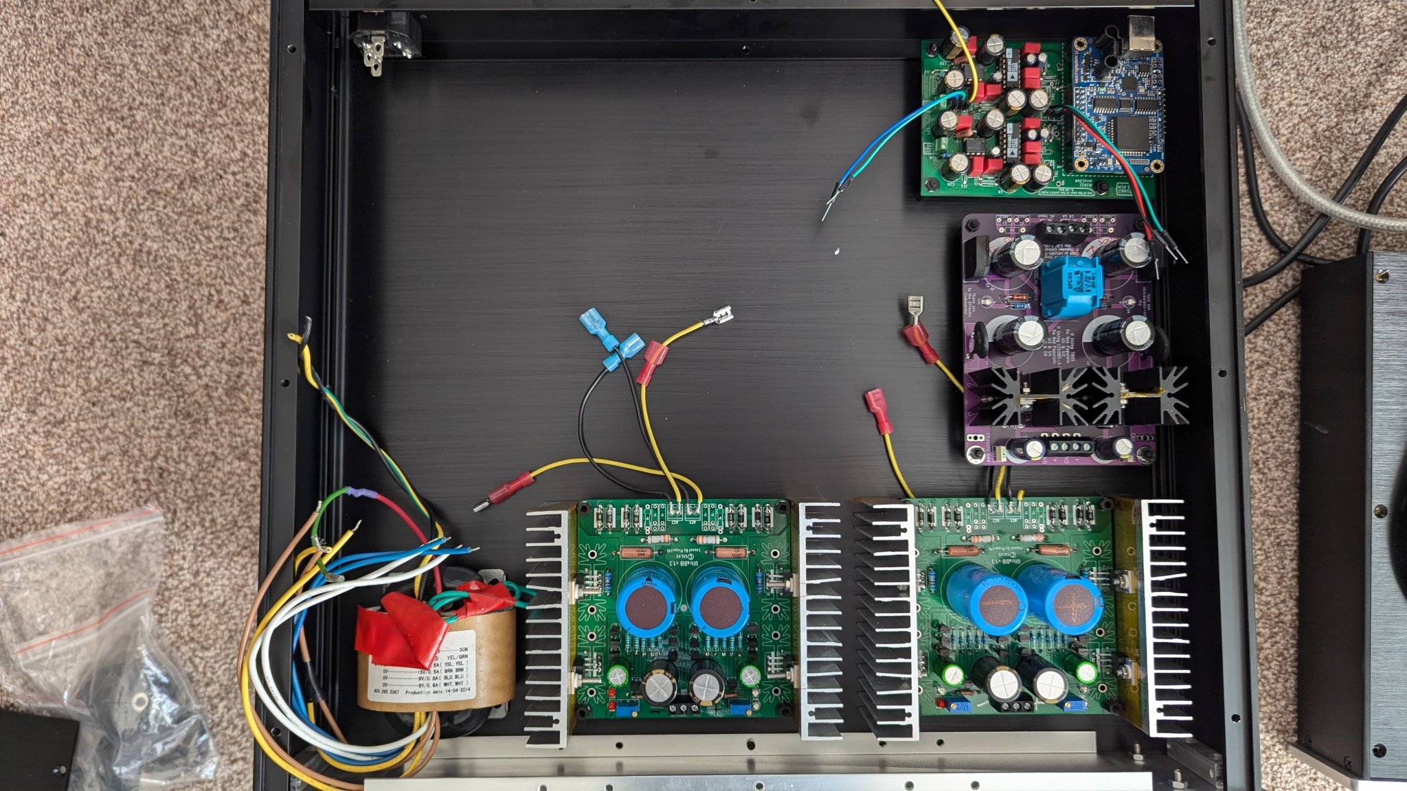

Component arrangement, commons sense check:
1. Transformers away from DAC, usually in line with iec inlet and on off switch. One more R core not shown but will be above the bottom one.
2. Twisted wires throughout
3. I will add CEN IV later and plan to hang it on the back panel beside the output ports.
4. That will add 1 more power supply board.
That layout makes sense, it's how I did my two builds of Miro AD1862 dacs and have zero issues with them.
Turn your shunts around 180deg so that the AC wiring can be tucked along the front bottom edge of the case?

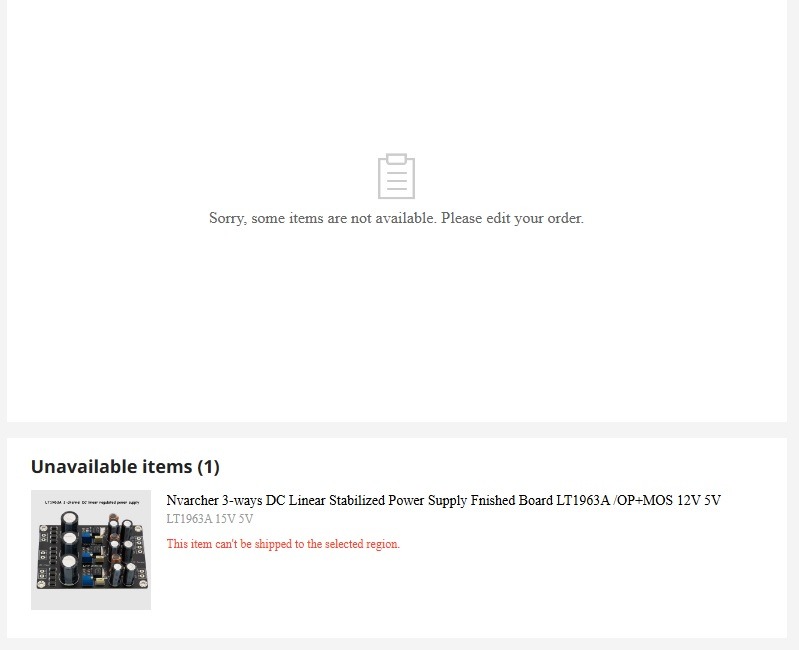

I still need to choose a regulator for the output stage.
I am intentionally using different regulators just to practice how to assemble them. Shunt and 78xx LDOs are completed.
Would any of TPS7A4701 and a negative equivalent suit the discreet stage in this case?
There are even ready-to-run versions on ali:
https://vi.aliexpress.com/item/4001138509950.html
I think the dual version would be a good one to go with.
I also like these.
https://a.aliexpress.com/_EzC81wd
The ones with the pass transistor and opamp buffer stage. And it will give you a spare single rail for something else maybe..Robust little things. I either shorted or reversed one a while ago. The pass transistor got so hot it floated away on its molten solder. Re aligned and it worked again!
