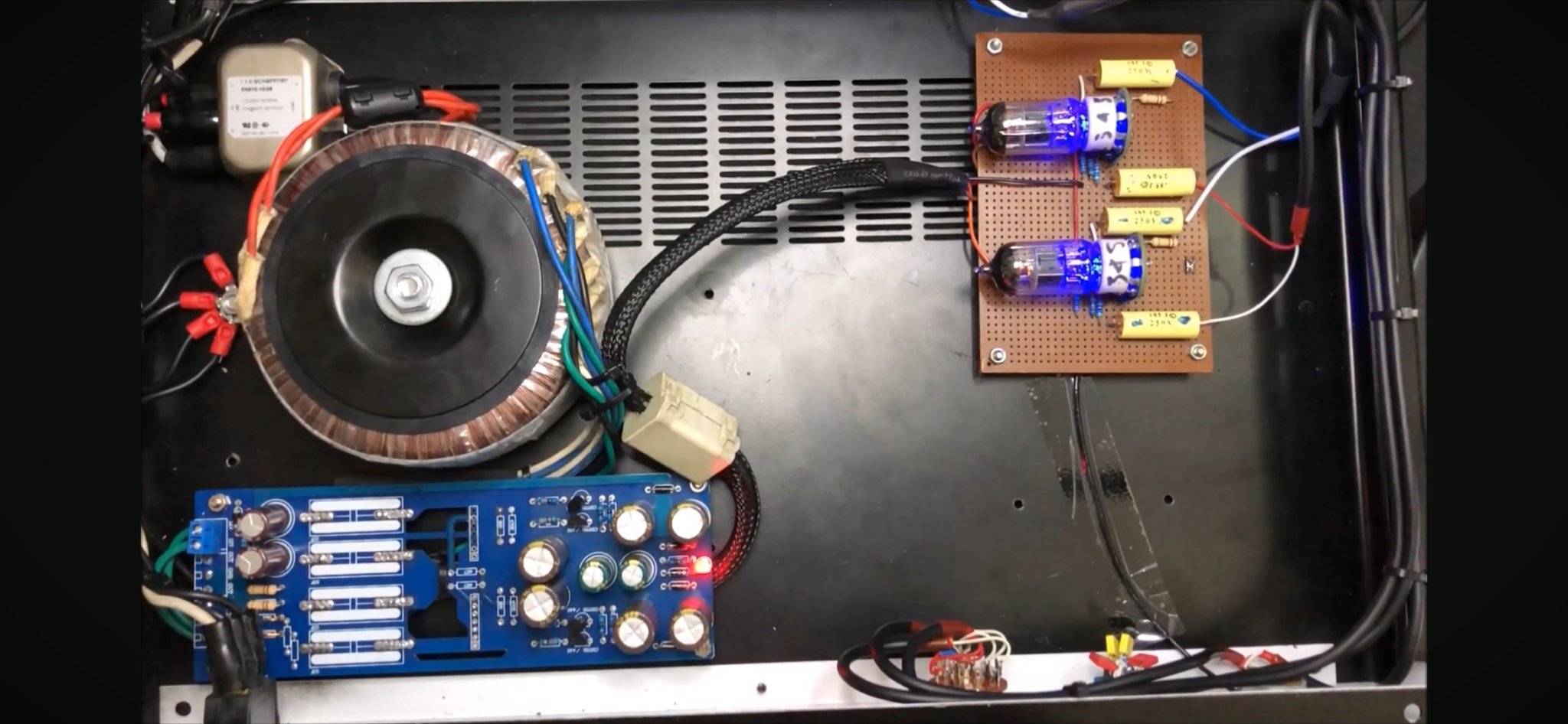

https://www.ebay.com/itm/272202079852Like very much the tidy build of @NIXIE62 , perhaps would ask him a link to the enclosure?
Just be careful, that box is small for any Miro DAC. There are some deeper boxes like that one. AD1862 can fit there, for example.
What's Nutube?Designing a AD1865 with Nutube I/V, it will be a very interesting little dac 🙂 That chip really is worth the effort to explore.

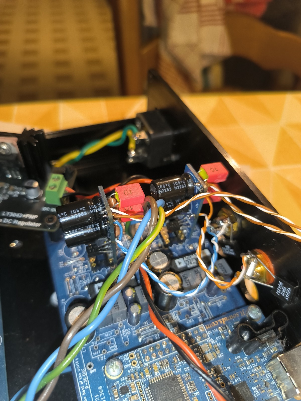

@NIXIE62 what I need is a small box for stacked PS+ MIRO Ad1866, amanero USB and Power transformer, something that I can use at the office without bringing wine boxes and tube stages in it 🙏😁

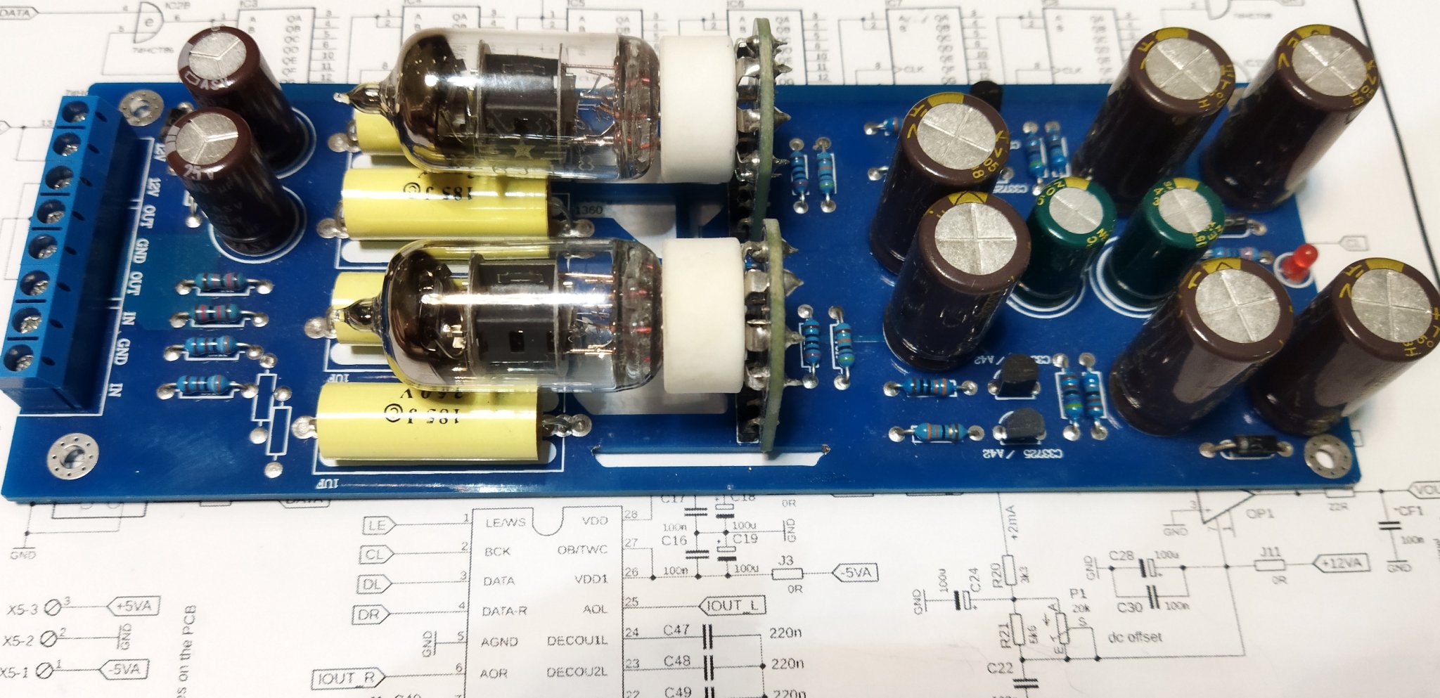

Try the tube IV stage. The AD1865R very good with it.
Thanks, I know my last attempt didnt go successful because the tubes arrived in pieces of glass, and the customs, the courier company and the insurer shifted blame to each other and never paid up after that deiced not to venture into this territory.
However, next time I am in states or canada or UK will ensure ordering a few beforehand which I could bring back myself.
Yes that one 🙂 Very compact, low voltage, no heat. Microphonics are easy to handle, i made an adapter.NuTube by KORG

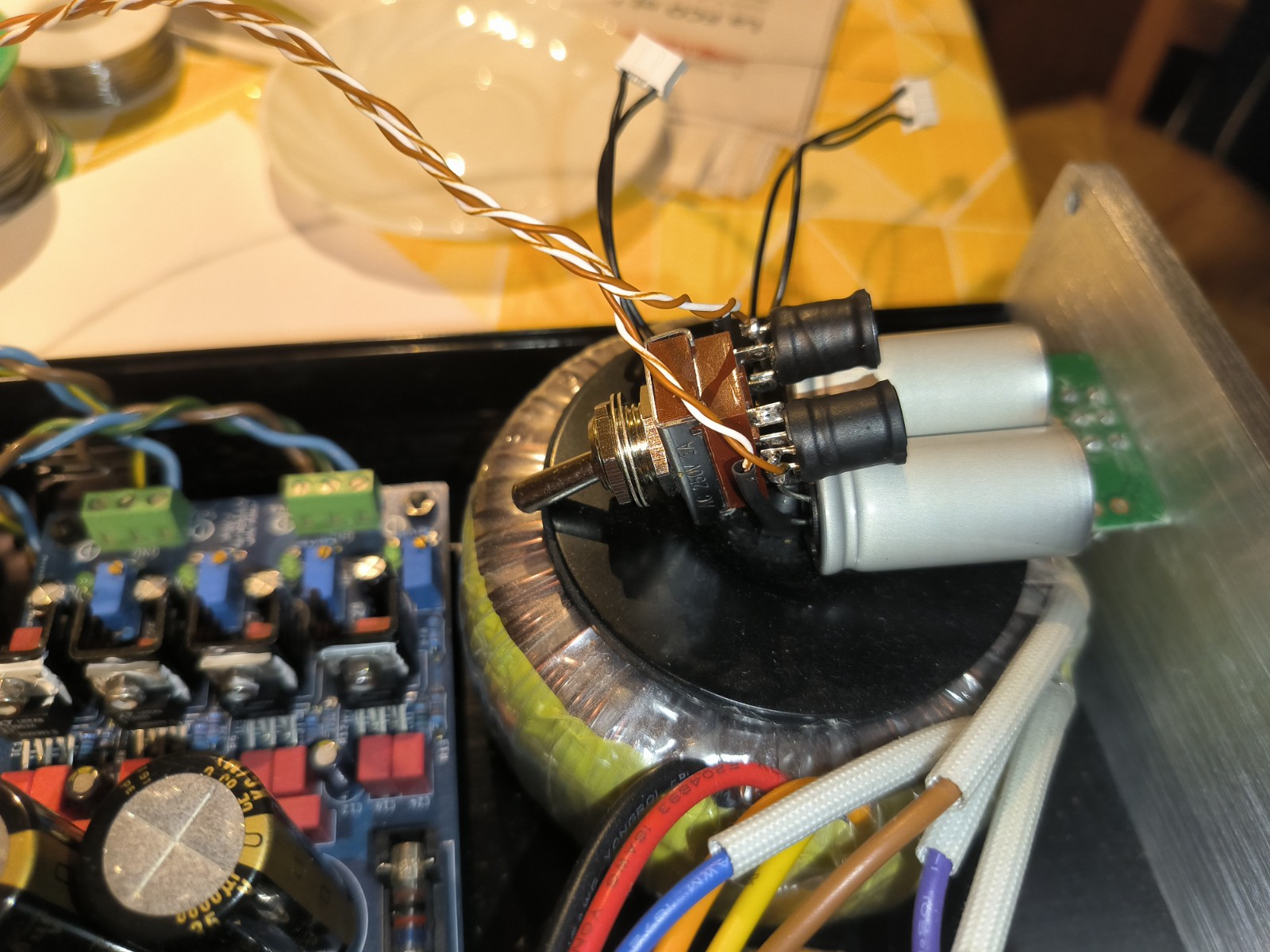

If someone wants to try the cen iv, I'm selling mines - ready to plug in the dip8 socket with batteries (2x 5x 18650) + switch + 2 wondom modules + transformer to charge the batteries. You can use them at least 300h before charging. Sj74 ans sk170 coming from ebay seller punkydawgs, riv are y-foil resistors.

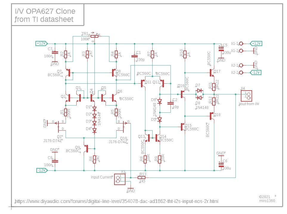

Today I finally managed to build the discrete OPA627 clone op-amps published here by @miro1360 ages ago. He was very kind in revising the layout for me to make them smaller.
So despite the most painstakingly careful assembly and matching of transistors, both boards have issues. One has DC offset of -3V and gets hot, pulling lots of current and heating the transformer., the other no measurable output at all.
Miro if you can remember, what does the trimmer set, is is current across 0.22Rs? And how critical is C2 10pF? I have 47pF in the boards, forgot to get 10pF.
Gerber files and schematic below, there is a second pair here if a clever person wants to try and figure these out as they could be worth developing into small SMD format mounted to DIP holders. R13 1K5 is IV resistor and should be omitted to use as normal op-amp.
That looks like a Musical Fidelity X-10D Buffer clone board.
If it is, no voltage gain in that circuit.
The regulator is a current source, and there isn't a follower (quite high output impedance)... 🤔
This will certainly NOT be a neutral sounding thing
