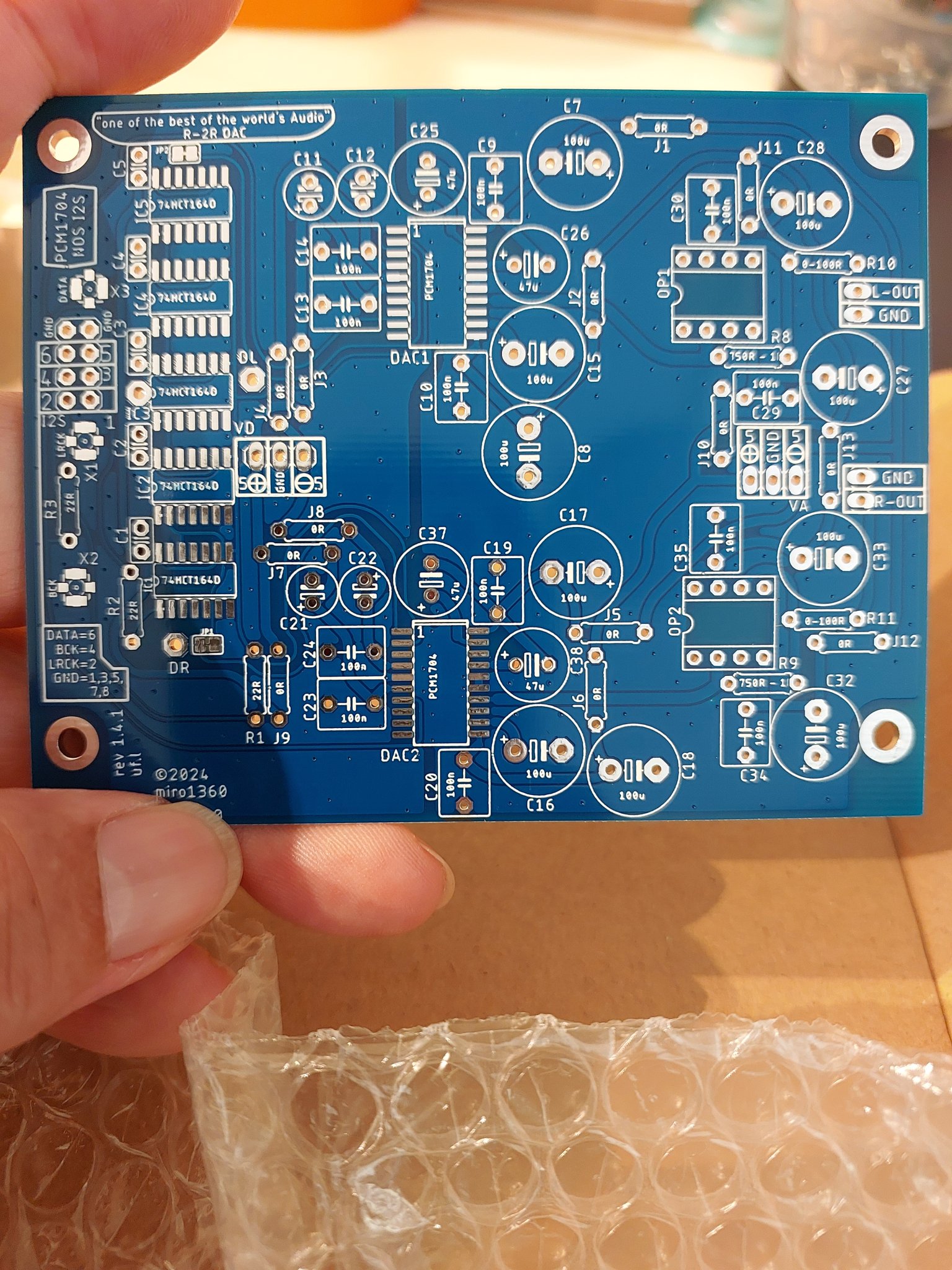

DAC AD1862: Almost THT, I2S input, NOS, R-2R
@NIXIE62 I think we have the same chassis, except that mine is full silver in colour. Very small and sleek chassis. Everything need to be small and compact.

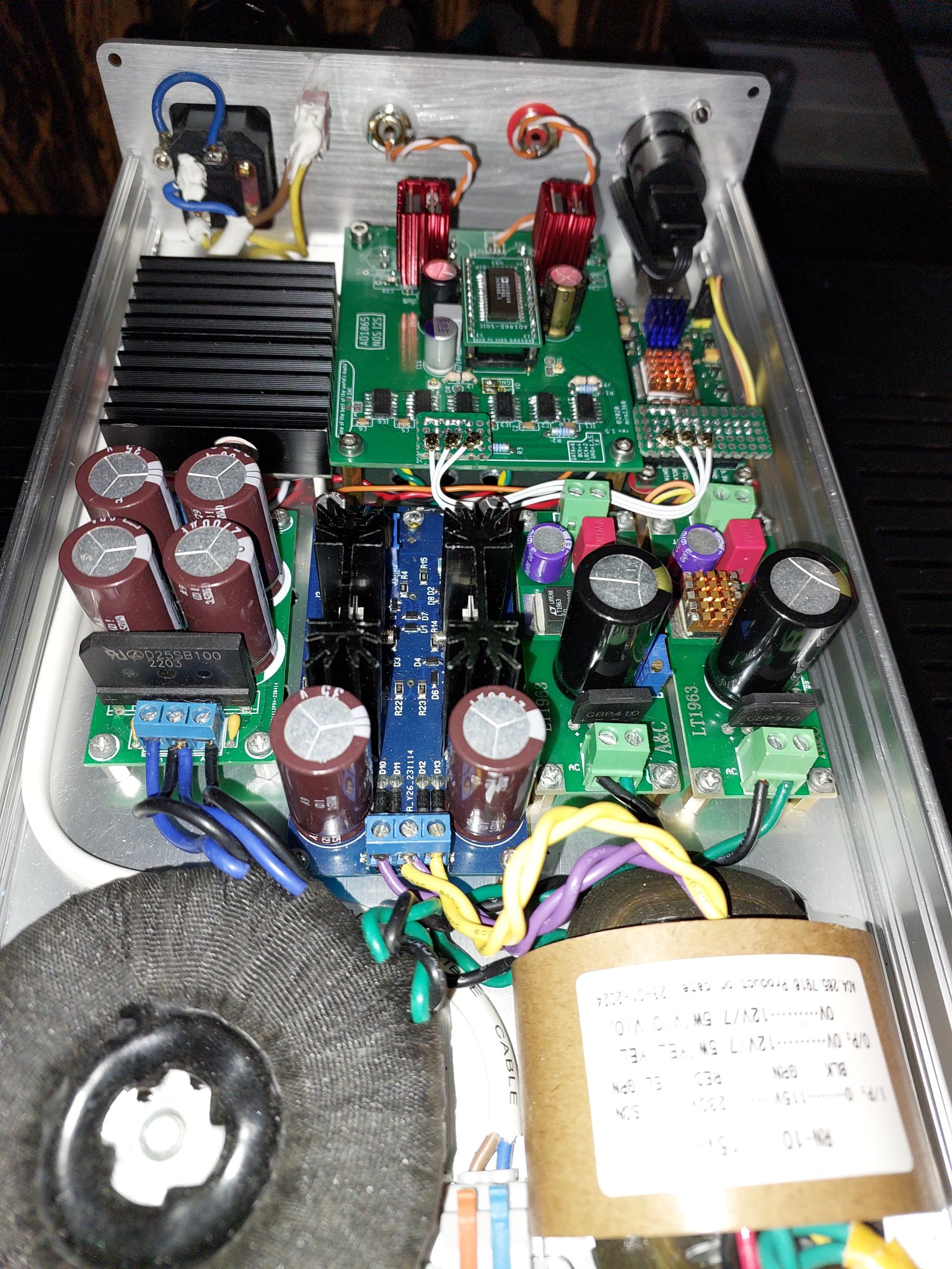

My Miro AD1865 Dac.
*Note: thanks to a kind friend who gave me a chance to try the Burson V7 op amp.

Also, looking back at the thread, I never posted the manufacturing files for the OPA861 I/V output stage boards (inspired by P. Rogic’s Aya II DAC). These boards are 100% SMT with a few parts being tricky to solder for a first time smd project. Here they are with the supporting documentation:

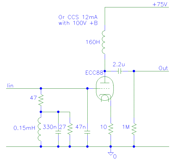

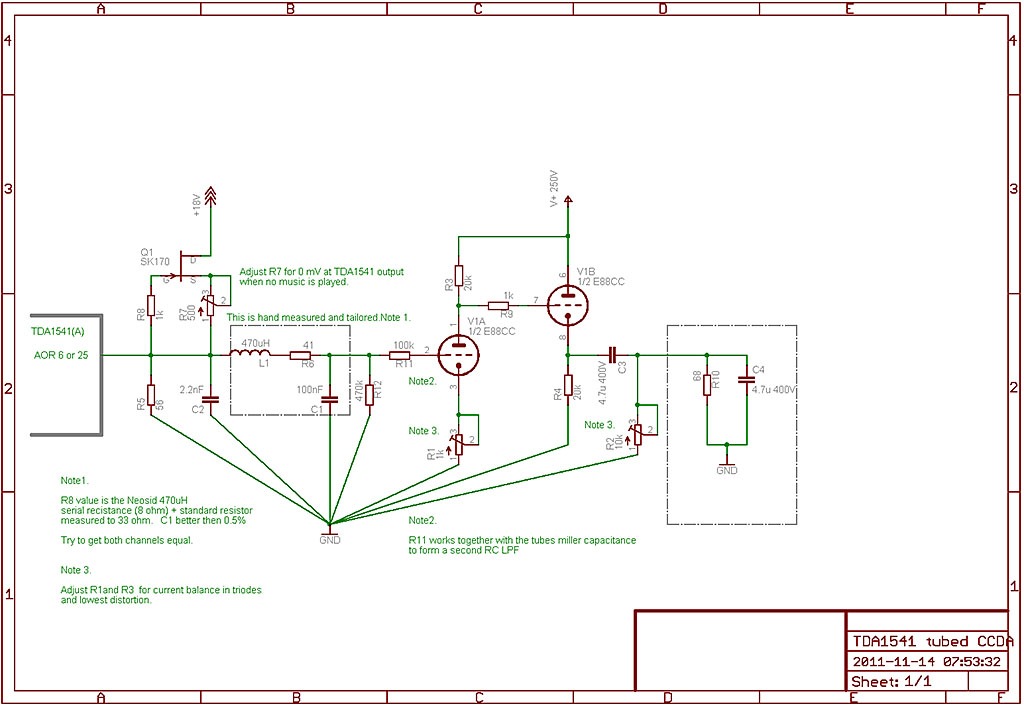

Did anyone test this i/v for miro tda1541 ?
I need the best i/v stage for tda1541 , can you help me ?
I find this tube stage , is it good for tda1541 ?
the second one is better and went after. Just swap out the anti aliasing circuitry bellow the 47 uF resistor. There is a paper also you can find on the miro1360 blog linked on the first page that was written by Thorsten Loesch and may helps you too according your level knowledge.
Thorsten and Zoran and Alexandre members are rediscussing I/V modern circuitries and more in the few last pages here (rest is almost noise, concentrate your reads on those 3 guys):
Could be the ultimate TD1541A DIY circuitry due to Thorsten newest ideas : https://www.diyaudio.com/community/...ate-nos-dac-using-tda1541a.79452/post-7539946
Begunn few pages ago, tubes circuitries and silicon ones are discussed. Thorsten Loesch is advising to go silicon finally but stays open to tubes as Zoran.
