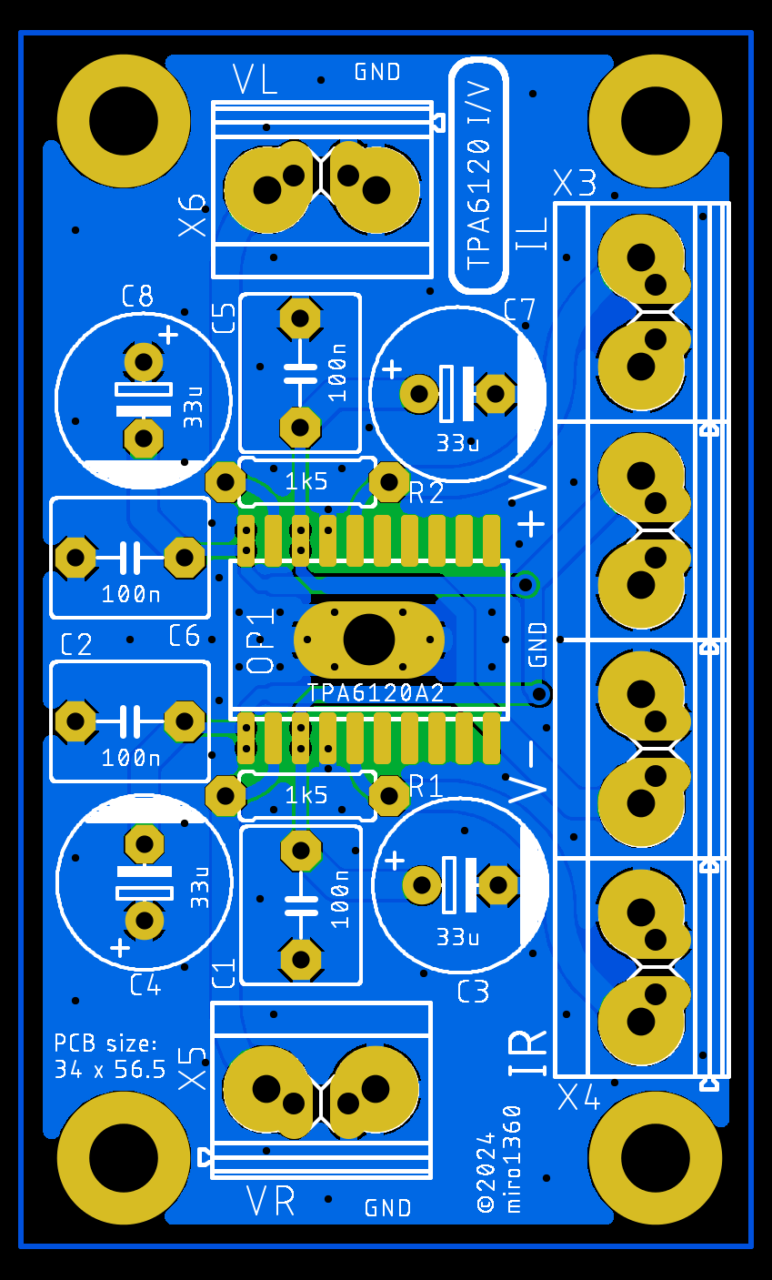

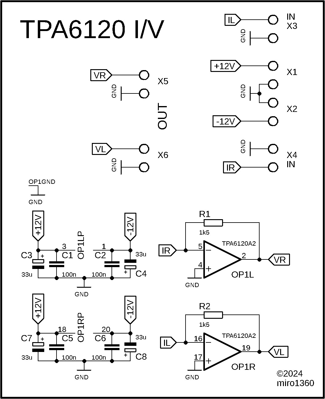

I thought about sharing the I/V based on TPA6120 for a longer time and today I decided to do it 😎
TPA6120 internal structure is pure CFA, it provides an ultra low impedance load for the DAC.
The internal concept is similar to the AD844, but not the same and TPA6120 is 20x cheaper :sly:
Is it good I/V? Well, TPA6120 is very fast CFA, sound is super natural and it has a lot of power to drive things :hphones:
Power supply range is from +-5V up to +-15V. It can be powered directly from DAC PSU.
R1 and R2 value determines the output voltage. For a higher output voltage use higher value of this resistor (1k5 == 1.5Vp, 2k7 == 2.7Vp, ...).
Capacitors are polypropylene and a high quality electrolytics (UKW from Nichicon is still available).
There is hole in thermal pad under the IC, where you solder the IC with PCB from the bottom.
IL, IR is current input from DAC.
VL, VR is voltage output.
If you are worried about damage to the chip due to a short circuit of the outputs, or signal reflection, you can mount 22R series resistors directly on the signal cable.
Note, that a small (not harmful) DC offset may be present in the voltage output.
This is redesigned PCB and so far not tested, I hope it does work.

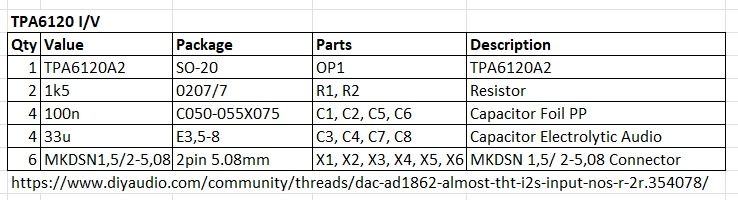

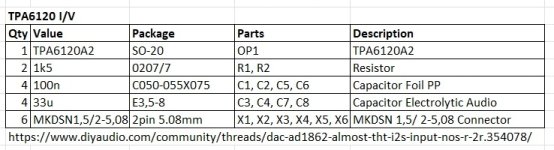

BOM example: https://mouser.com/ProjectManager/ProjectDetail.aspx?AccessID=5ca5f6fb0b

I see some violations of the "CFA OP usage" rules.
Everything connected to 5 and 16 legs should have a minimum capacity to the ground. Otherwise, there is a high chance to get oscillation - this is CFA..
It is better to make these lines not so thick, shorter and with a higher gap between them and the ground polygons. Usually such lines are on the top, and ground polygon at the bottom have cuts under these legs and connected lines.
Alex.

I know about this capacitance and have done more devices in the past with the TPA6120 where I omitted the GND under the entire feedback path, another device where it was omitted only under the feedback leg, and devices where the GND plane is present .... but I didn't observe any oscillations and TPA seems to be stable ... the parasitic capacitance is around 25 femto in this case. This is more valid to GHz devices. I gradually dropped from that seriousness in audio devices as there are working amplifiers completely without GND plane 🤣
As this mostly the inductance that matters, I repeat what I already inputed for miro's phobia : There are excellent MKT from Wima with 2.5 m pitch leg, this is what I'd choose in my shoes if I'd stay with tht 0.1 uF decoupling and THT. It doest need to be mkp and at weigthing the poor and con : inductance is more important here than the dielectric ! MKT suffices... imho half illiterate humble opinion and of course YMMV , blah ! 😉

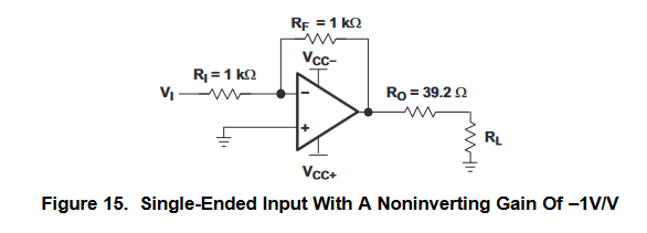

I see that I woke up the ghosts with the AD811, I'm glad about that 🙂.
But this scheme lacks two important things, Ri and Ro, which are necessarily recommended by DS. Those two resistors are mandatory with the CFA op amp and you can't get away from them. It would also be good to avoid TH components, except perhaps for large electrolytes, while everything else should be SMD. I agree with Vunce about that.
Youu eventually can swap the 1k Ri by a ferrite bead of a near value if you know at what frequency the resistance is needed as @abraxalito inputed.
Added serie resistance is not nice for I/V, but most of VFA op amps have more Zi (but the good ones as opa861 for illustration which is near 17R circa at input... which is one of the first thing of the item list if a good I/V, but you do know choose the good caps to makesit sing and a good enough PS but not sota as the AD811, relative to the dac chip PSRR and noise floor). In fact VFB op amp for that task have their own drawbacks as already talked elswhere.
Of course here it is needed to avoid osci ! Notice the more complex scheme from Walter Young where Ri is inside the feedbackloop iirc (which seemed to me odd before re reading the paper)...
