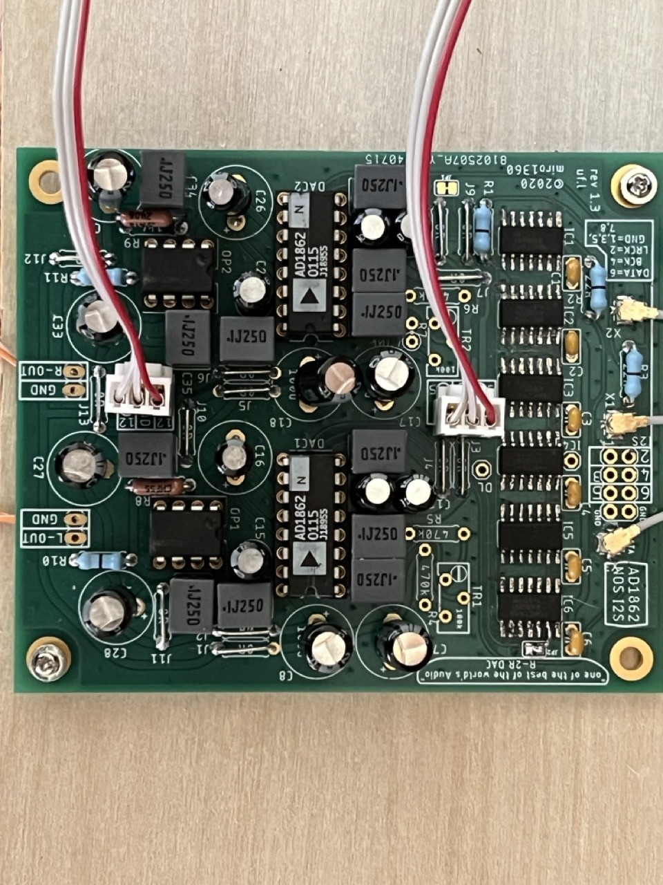

Try to drop a nearer picture of the ad1862 board too in order some can see more details about the parts, maybe some will be inspirered (everyone has his own sauce)

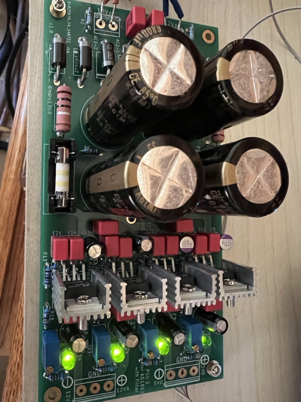

Thank you @diyiggy. Most if not all components are from Vunce BOM. All electrolytics (except to 6800uF in PSU) are Panasonic FR. The grey 0.1uF caps are Kemet R79IC3100Z340J. Shift registers bypass Kemet C320C104K1R5TA7301.
In my experience passive elements can make improvement but it's more like fine tuning. I am happy to try though 🙂

Do You find the sound lacking a little of high for instance or clarity (ligth I mean). It is hard to know w/o listening to. What is missing and what is too much (briefly, please) ? Also ask Vunce, hes has heard many different setups and can at least helps on the active I/V by helping you relative by your descriptions, but very hard to know w/o listening oneself. We have all different devices around the DAC. I would say if it is too much below your expectation, stop before waisting monney for nothing. You could try to listen to the Holo Cyan 2 in someonelse hifi to have a different benchmark for ears than your on self DAC and the AD1862, and see what is liked. The Cyan is around a grand andhalf if I am not wrong and diy can fastly cost too much (and have almost not second hand value)
Pan FR also around the op amp ?

@diyiggy I know its hard to understand without listening. It's hard to explain as well 🙂 I do not like too much highs and many times solid state gear sounds too harsh to me.
I started writing my sound impression by memory and decided to listen again. I have to say it sounds significantly better after 24 hours breaking in, actually unbelievably better 🙂 The difference with PWD is not as striking anymore and I actually might prefer this DAC now. I have to withold my opinion for couple more days to allow for more break-in.
Definitely want to try other IV options. I expect that my diy dac journey is going to end up costing significantly more than getting an off-the-shelf dac. It's a cost of the journey and a big part of fun for me 🙂 and I think for most of us here.

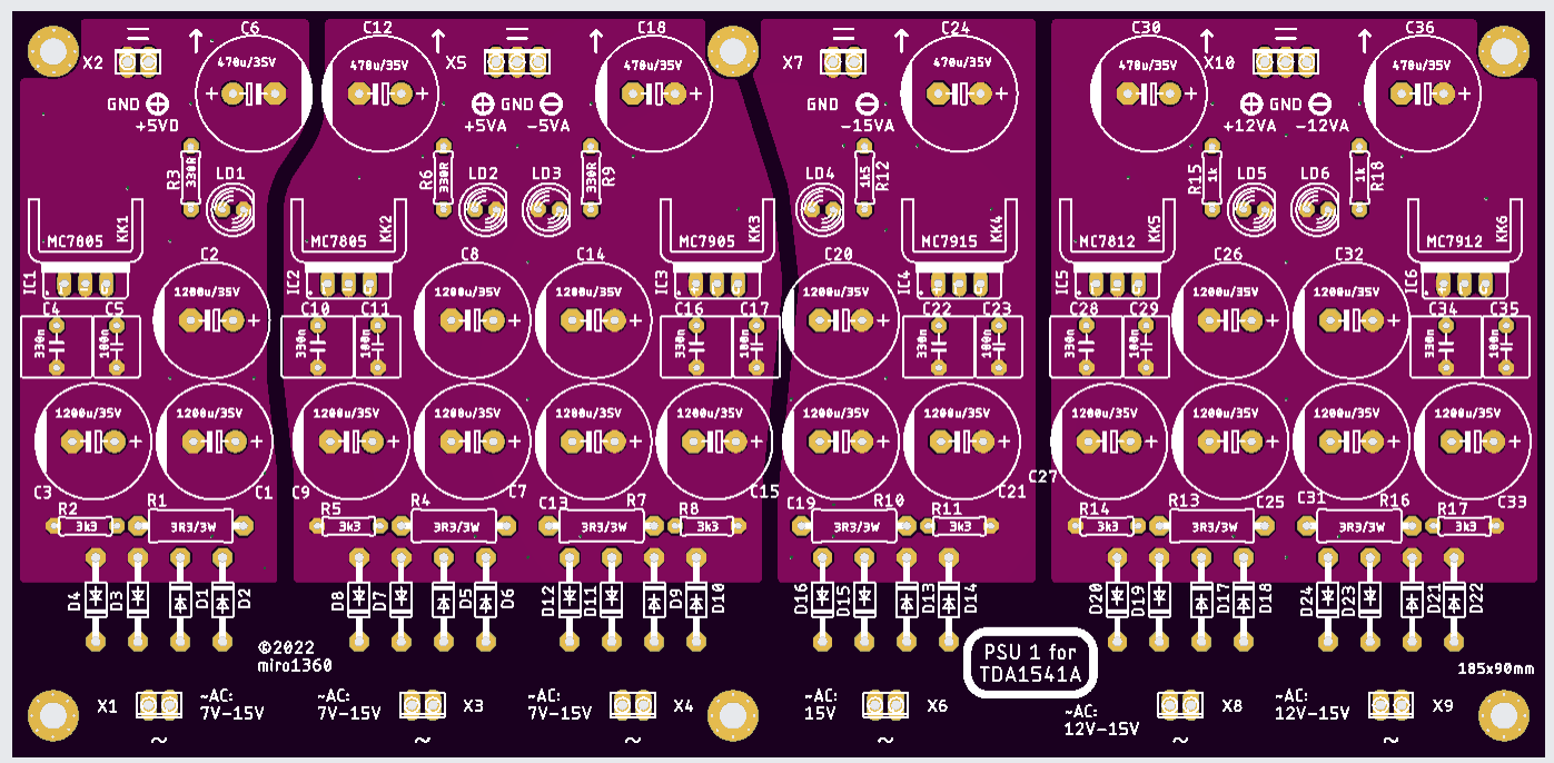

Dear @miro1360 I could not seem to find the gerber and schematics of the following PSU, it was working fine with my DAC but one of the +12 side fried and its rectifiers are heating up so I want to fix it but cant seem to find the schemativs and the gerber, appreciate if you could help, thanks.
diyAudio_PSU1_TDA1541A_2022
Schematic is in this post 🙂
https://www.diyaudio.com/community/...s-input-nos-r-2r.354078/page-268#post-7159234
