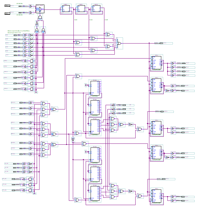

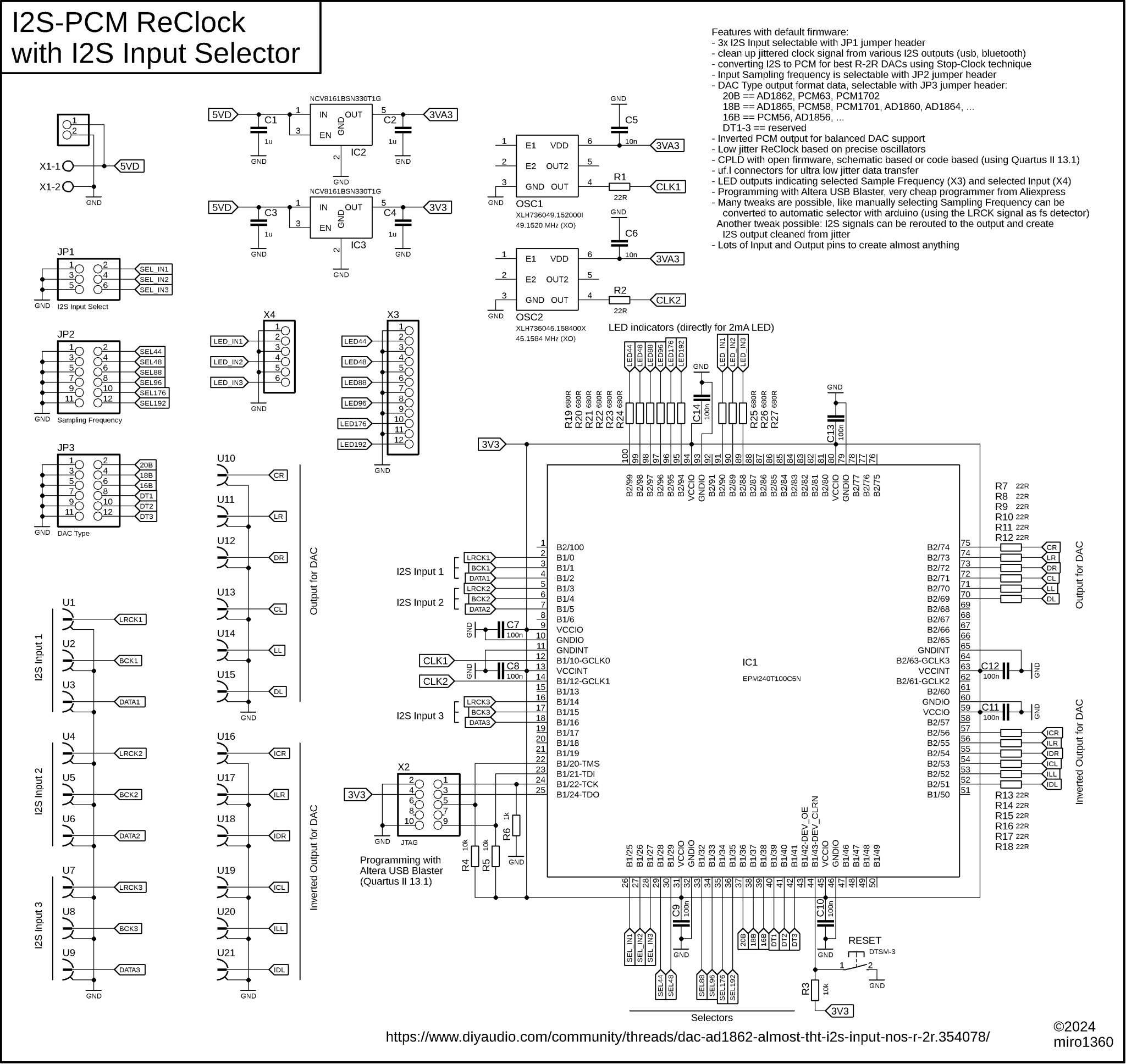

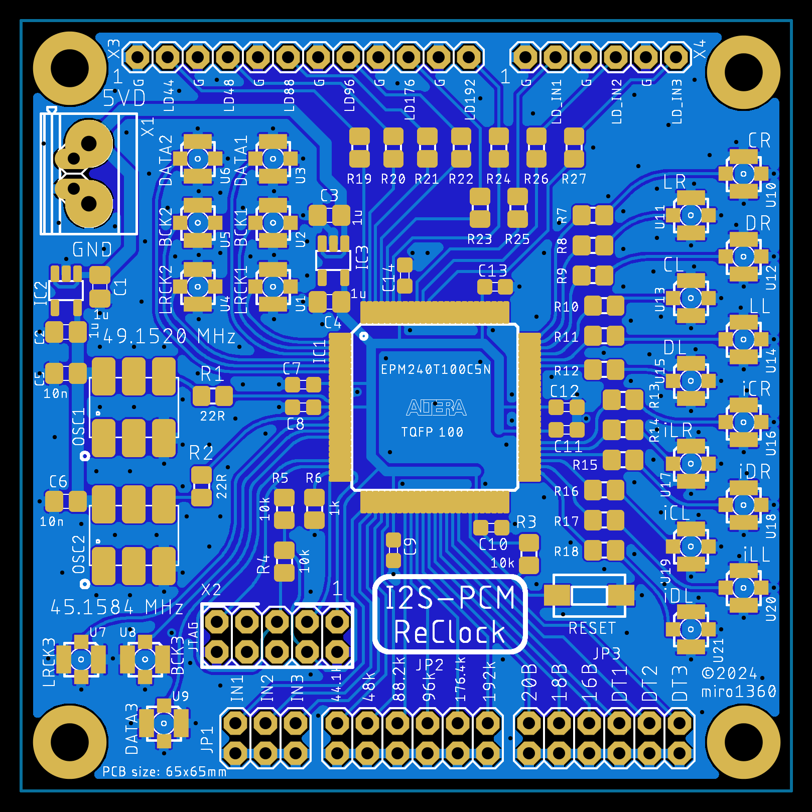

CPLD for very low jitter with I2S inputs selector and selectable PCM output with Stop-Clock and ReClock function in progress 😎
Schematic based approach for CPLD. It will take some time to complete and test.
The schematic quartus project with modified pins will also be possible to upload into that standard 10€ CPLD board from aliexpress, there are inputs for oscillators 🙂

What is this? What is its function?
