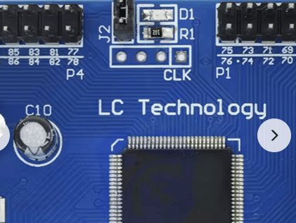

DAC AD1862: Almost THT, I2S input, NOS, R-2R
Here is CLK 2, 3, 4 and GND ... External oscillators can be connected here and configured in Quartus - Pin Configuration for relevant pins from schematic ... and reconfigure all pins ... easy - regulator and capacitor can be THT == almost THT solution 🤣
