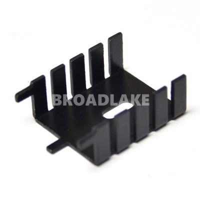

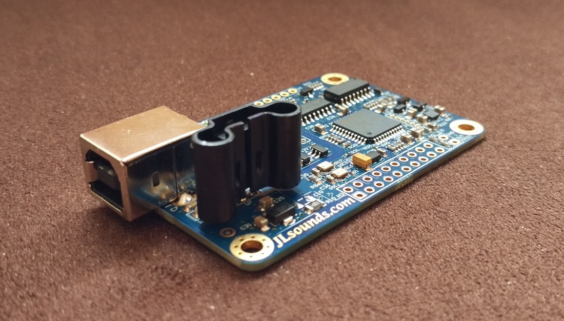

People have spoken about upgrading the heatsink on the JLSounds board.
I am guessing that a small stamped type such as this one, is going to be not much of an upgrade if any?
Can anybody offer any recommendations or advice?
How bad does it overheat? I would have thought Lorien has done the thinking on this.
Don't overthink it, Just add more metal to the existing heatsink using thermal tape.

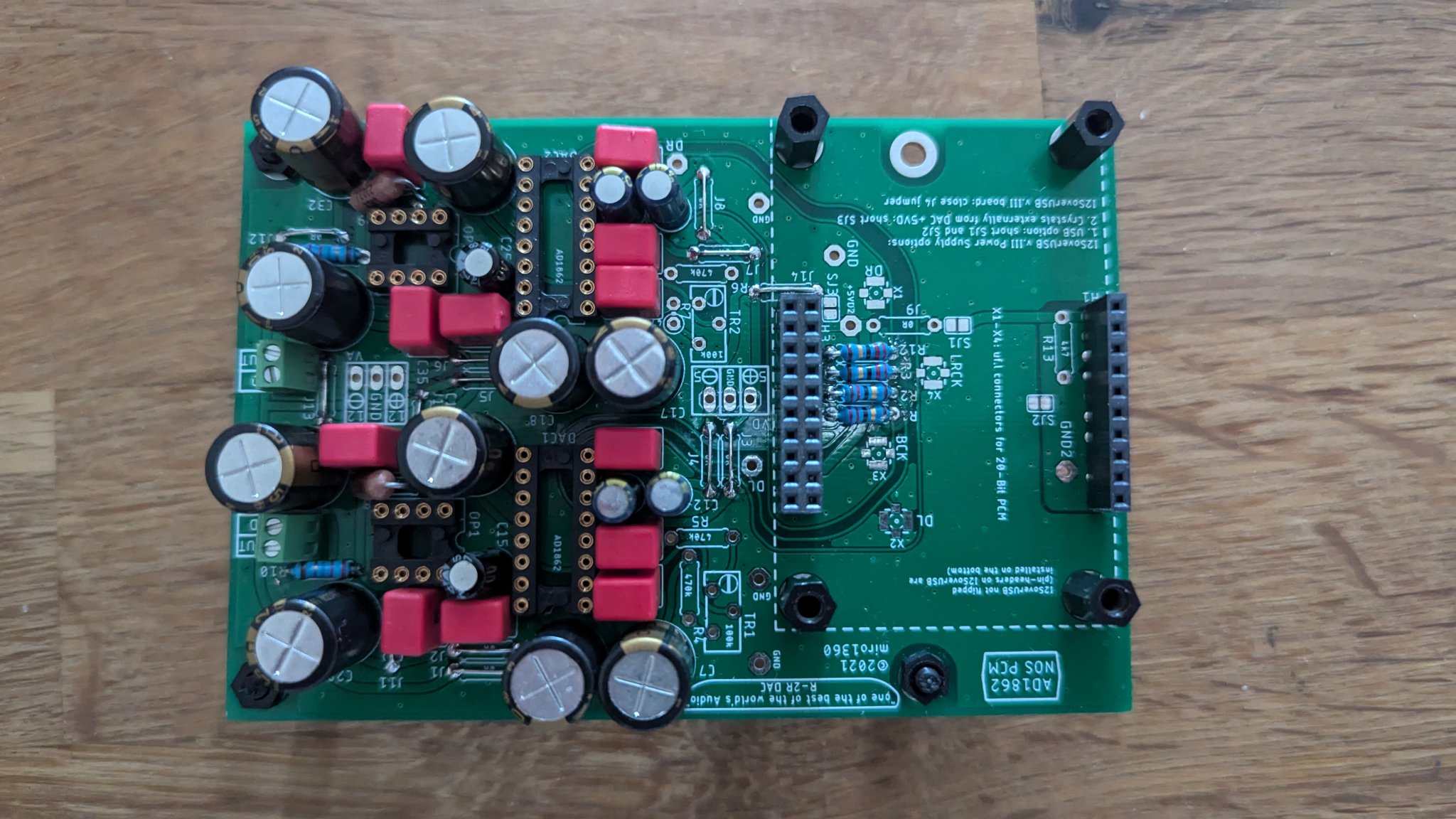

What is the best way to test dac with bench psu just to make sure everything is ok before I plug opamps and dac chip?
Reactions: audiosteve
Also : The upper Riv seems not in the hole towards the dac chip side, but perhaps this is the photograph, hard to see !
Always check twice the capacitors position to avoid shorts before switching on....
Check the output of your reg before connecting them to the dac board, then as already inputed : check on the power vias relative to Vref the voltage numbers (without the ICs) when connected to the dac board.
