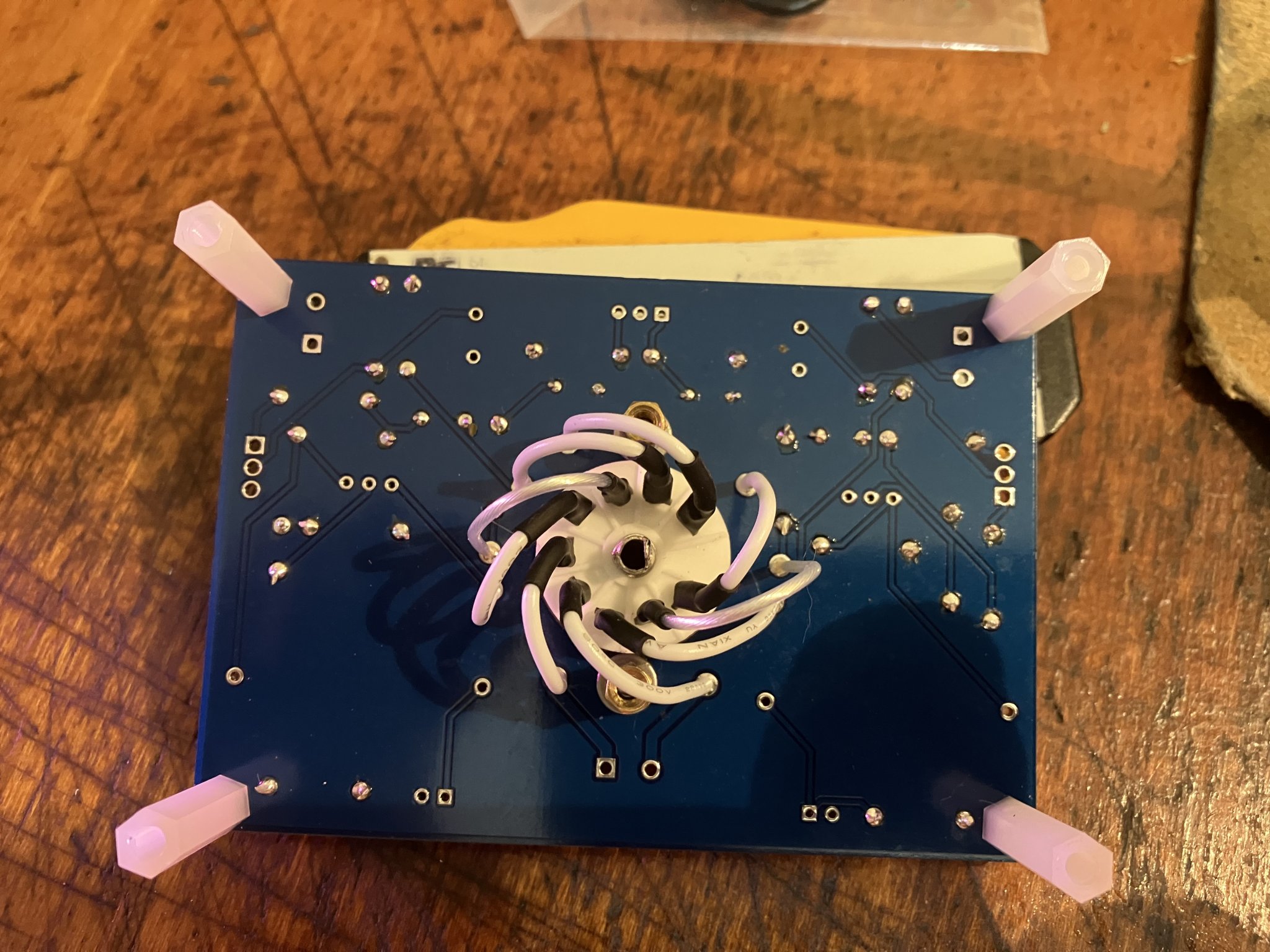

For TDA1541A, I just will go with the CD-77 tube stage @ThorstenL (aka M. T Loesh) had the kindness to publish in the log TDA1541A thread. Of course that certainly means more effort to source good tubes and also in the layout (@Michelag : resistors nearer of the tubes pins as already inputed 😉 ; change those wiresat the bottom by the resistors the way I said in a post above to avoid osci).

A good aussie friend of mine which is tubes expert said to me you better put the resistors close to the tubes pins with very few 2 mm lead length max on the tube side (to be sure) to avoid osci.
I told you already in a post above. You have not to change the pcb, just swapp that wires of your pic with the resistors the way I describe to avoid osci risks.

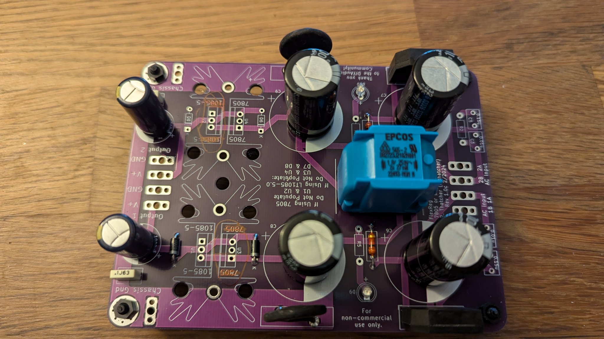

Morning.
For those who built flex reg, what r6 and r5 are for?
There is nothing in the bom or the build guide.
One side will be 7805, another 1085.
