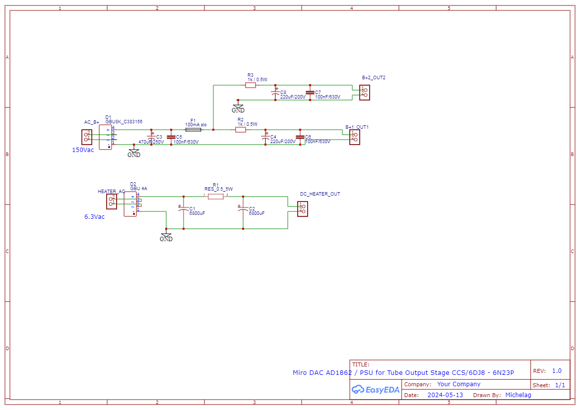

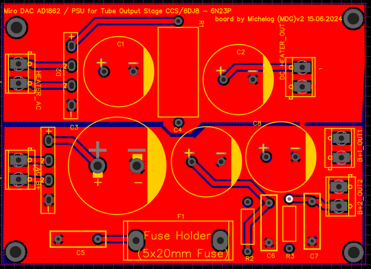

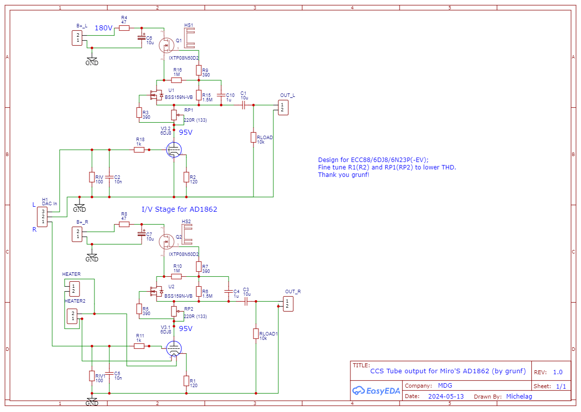

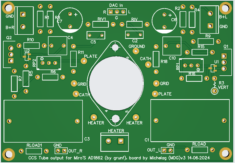

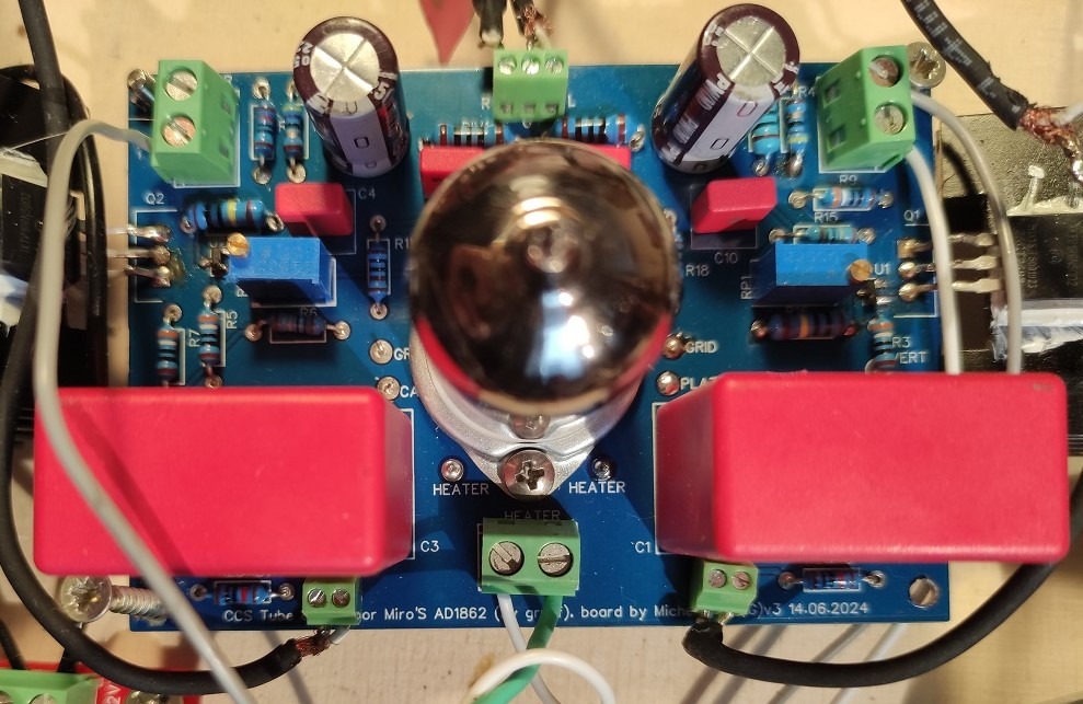

Last (in the sense i think it should be the last) upload of grunf's tube ccs stage, with pictures, schematic and a guide to run that thing.
Actually received many question so i thought it should be good to have a companion to let it work.
In case of other FA questions, i'll updated the guide.
Have fun and enjoy!

For C3(C1) put two UES1E102MHM in parallel with a good polypropylene cap.
I'm not sure that D3A is a good idea for a grounded grid, it's easier to do it with EC86,6S4P,6HM5... or even ECC88.
Would you share also your PSU?
That 6HM5 though... (ecc900 if i'm right)... something easier to find here in EU?
Wait, this stage is still inverting, what could we do with the cathodic buffer there?
4 tubes, wow, it begins to look like a real amplifier...
However, why do we need so much gain?
around 200V, may be 160V, may be 240V. Better around 200. At the plates, around 100V@Michelag Thank you mike, that's perfect.
Is there an optimum B+ voltage? If aiming for 180V DC I should spec 130V AC before rectification.
200V caps are shown in the schematic as an example.
talking about mu=72, is it just to have a lower R I/V?The ecc88 at the second stage is a follower, no gain I think.
Yes, the big 'mu' serves that purpose in this case, but the tube itself and its operating point which enables a sufficiently low Rk are also important.talking about mu=72, is it just to have a lower R I/V?
The output stage with ECC88 is a white cathode follower and is better than the classic cathode follower. The output impedance is low enough to reduce the influence of the following stages so there is no need for an active preamp, a passive preamp is sufficient.

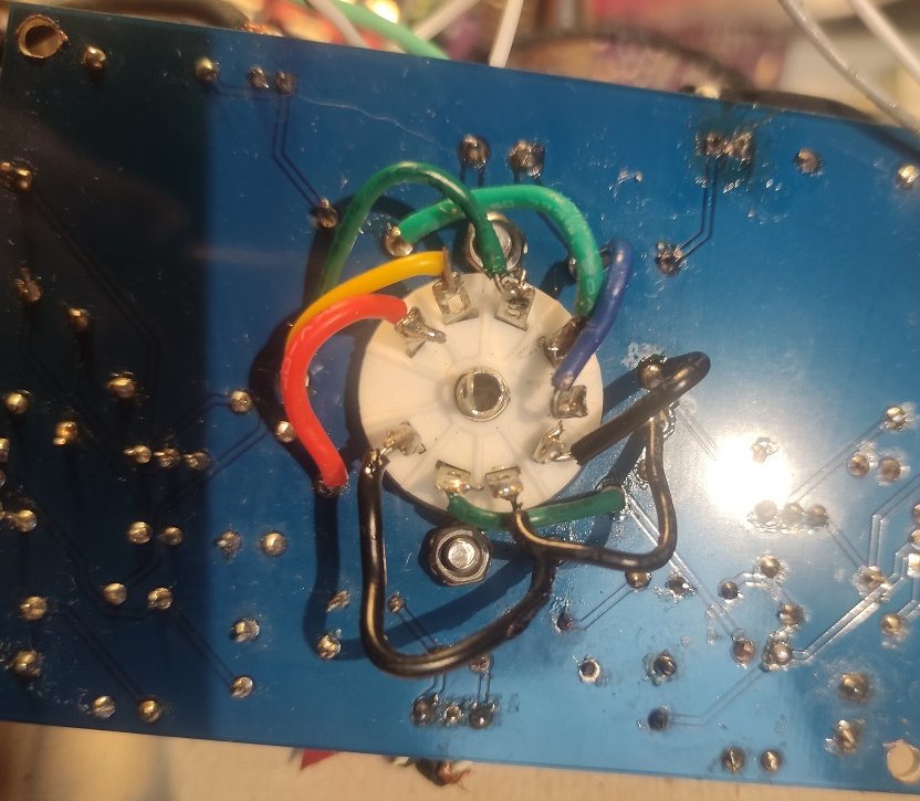

For TDA1541A, I just will go with the CD-77 tube stage @ThorstenL (aka M. T Loesh) had the kindness to publish in the log TDA1541A thread. Of course that certainly means more effort to source good tubes and also in the layout (@Michelag : resistors nearer of the tubes pins as already inputed 😉 ; change those wiresat the bottom by the resistors the way I said in a post above to avoid osci).I'll check those out. Grunf has a good reputation in my mind. The name lampizr rings a bell but I can't say I specifically remember anything about it or him. I do know that I consider myself an audiophile but a rational audio file. $10,000 for a DAC? That just borders on insane. Talk about ridiculous cost of diminishing returns. I'll bet it's a good DAC, but is it worth that kind of money? I seriously seriously doubt it. That kind of stuff is for people that have more money than brains.
Of course CCS (Grunf) or Mu follower has interest as well. But first source the good tube (NOS) and match the ones that have too much difference between the two triodes... (russian ones have a lot of difference between the two internal triodes for illustration, but not only D3A(single triode) that are osci beast have a lot of difference between two tubes, you need matching effort which can become expenssive for the ones not havinng great stock... and don't let talk about chineese tubes (save your monney please with that alixpresse kits and bad layouts pcbs)
