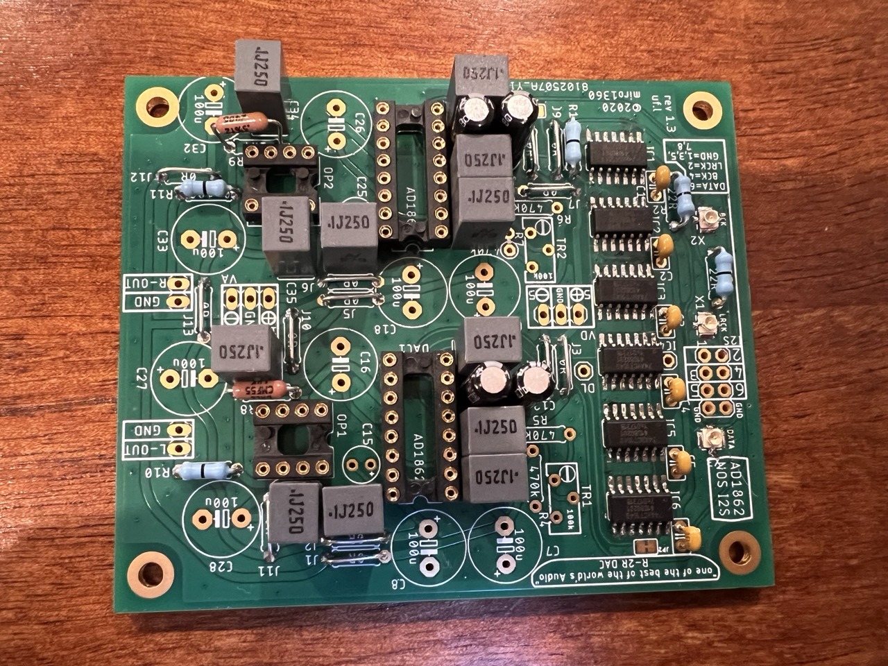

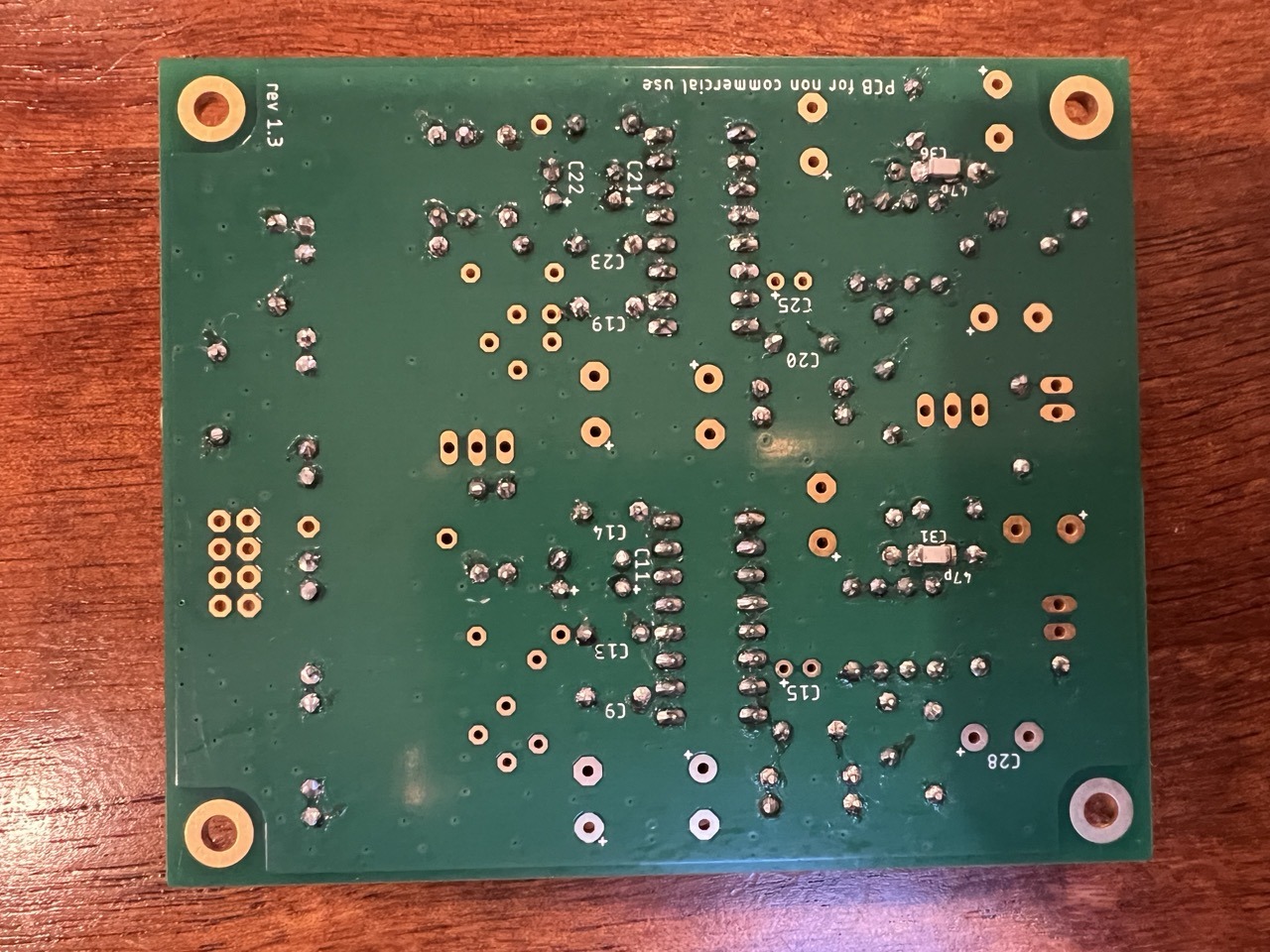

Received the parts and since I am impatient, started putting it together. My first pcb in years and my very first SMD soldering - had to watch a video on youtube - it was easier than I thought but lets see if it works. 🙂
Measured 0R resistors and they are 6mOhm - unexpected TBH. So I just used plain jumpers on power circuits.
I am a bit confused with the electrolytic caps. The positions on the board are significantly larger than any of the caps that I got. I followed couple different BOMs and somehow ended up with multiple options. Can you please help me choose:

Also, any recommendation for power connectors that would not let me mix polarity?
Usually you can find the dimensions of the part used in the DAC in the BOM, e.g:
12​
C203, C206, C303, C306, C401, C402, C405, C406, C407, C408, C409, C410100uFNichiconUKZ1E101MPDaluminum elect25VCP_Radial_D10.0mm_P5.00mm
This 100uf Cap has a dimension of 10mmx5mm you should order one which has the same dimensions as the ones in the BOM.

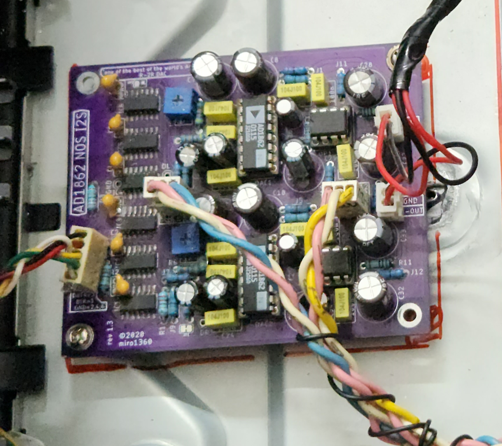

Everyone has their own opinion and practice as per their own preferences, I prefer the connector type as you could see in the picture no chance of reverse polarity on the connector, with 18SWG wire crimped by myself and color coding which I could remember, also writing the polarity on each side of the connector with a permanent market so that accidentally I don't fry the chips (again)
