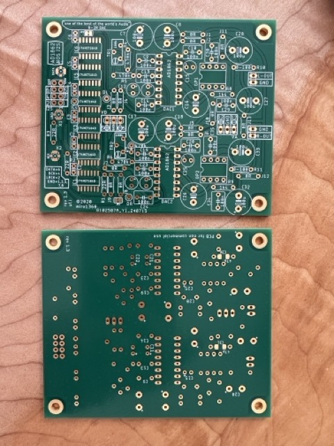

After a week of reading this thread, I bought AD1862 from Rochester and V 1.3 pcbs from JLCPCB. I should have 4 extra DAC chips next week and a few extra PCBs (2mm, ENIG). If you need a pair of DAC chips or a PCB- send me a PM. Pair of DACs is $50 - Rochester cost - plus shipping.

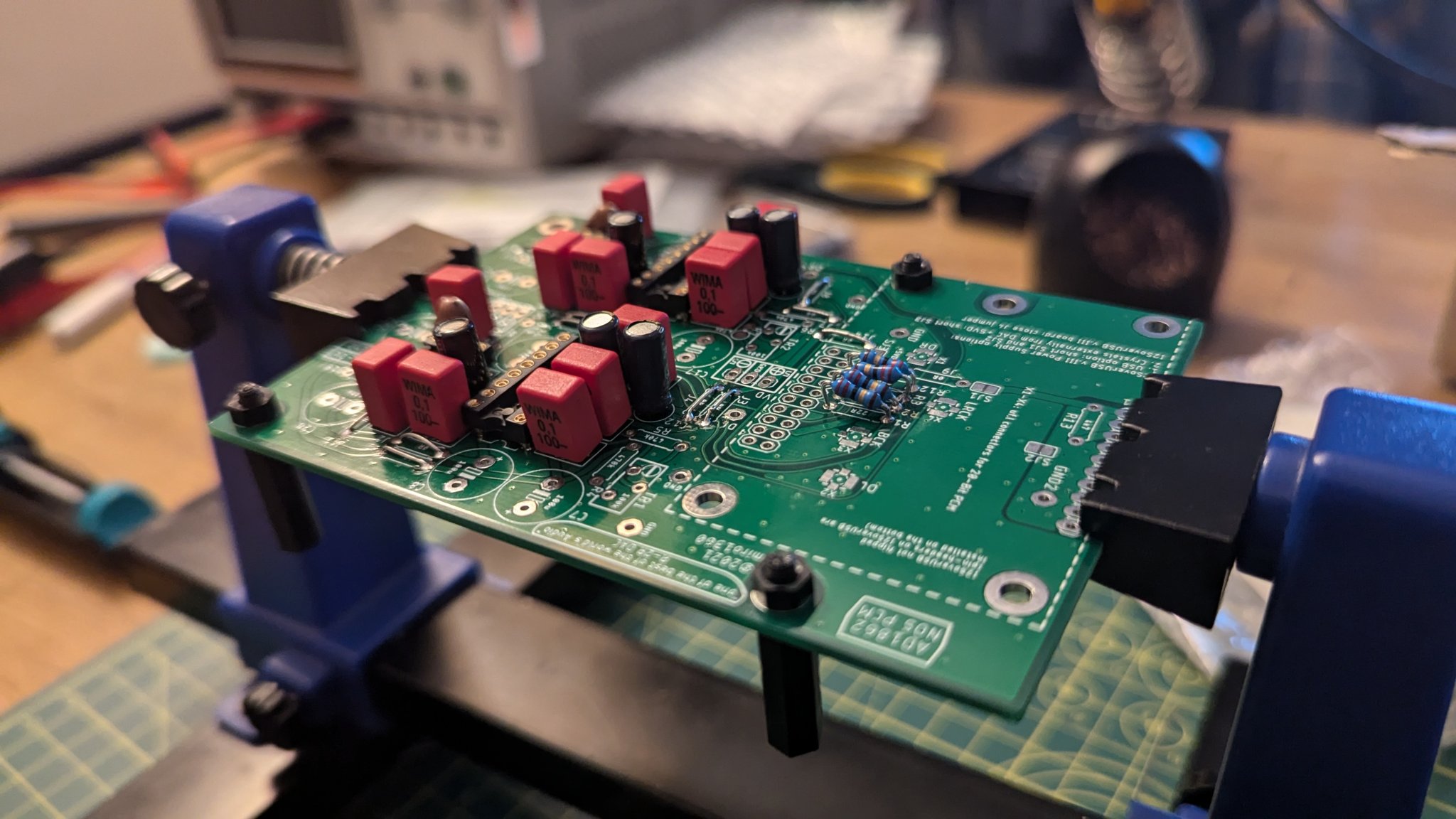

6N23P-EV=ECC88=6922=6DJ8 is the description from the ebay listing. I have continuity between pin 4 and 5. Should I not be able to set plate voltage with out the tube in the socket?
Hello, lost your message in the jungle...
No, you can't set current draw (and so voltage) from ccs to the tube if there isn't a tube that's drawing current...
For safety and to be sure, just measure that B+ is in the ballpark you expect (around 200V, could be 230, could be 170), then you're set to go

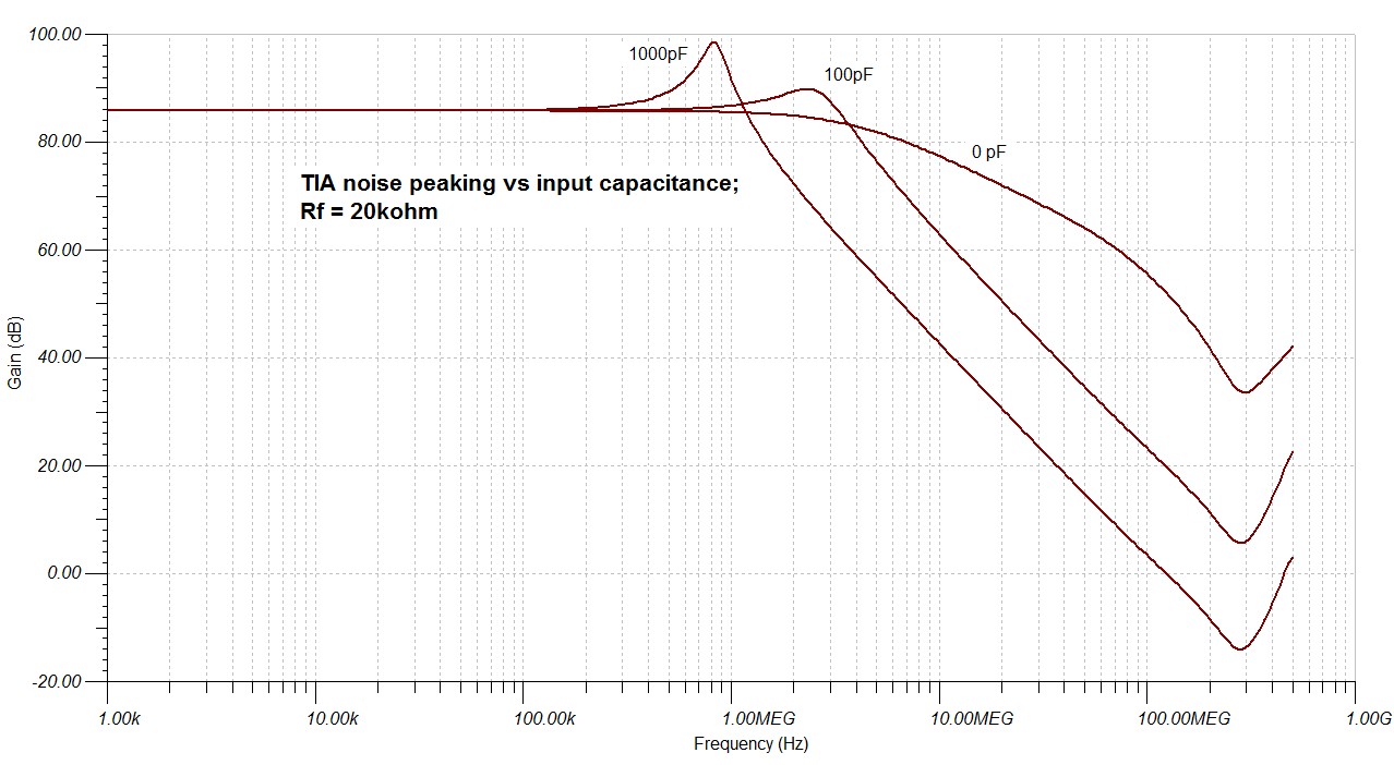

hm.. in theory (and practice) : connecting a most common opamp I/V circuit with known parameters on the Iout pin of the dac, one would obtain a known TIA configuration with an unknown 'Cinput-load' value.
From the obtained / observed noise peaking effect (freq. & amplitude of the peak) -- the input capacity could be calculated.
Like I would do that with a high Rf value, so as to obtain better visible noise floor changes and peaking at lower frequency.
This peaking effect, and the consequent stability criteria are the main reasons for which that Dac output C value could be interesting.
All this becomes less of an importance, if the adviseable Cfeedback parallel capacitance i the I/V circuit gets applied (integrating I/V converter) with a better defined pole

How on Earth do you measure this? And what good could it do if you know it?
dunno this is why I ask, I read something here (I can't not find again the link sorry) that said output capacitance of a dac chip is important in the final capacitance the inverted input see with the addition of the layout (stray capacitrance + trace).
But maybe I mistake about the word ! Possibly...
Was curious after having read the Texas Instrument SLOA013A paper.
One way to minimise its importance is to lowish rF Z value, rigth ?
Thanks!
What measurement setup is used for noise peaking in practice? The peak is likely in the MHz region, right? Are unity gain stable opamps also affected?
Interestingly, the same opamp topology is used in current input MC phono stages, yet never heard the issue discussed in that context. Easily 100p of wire capacitance but perhaps the very low source resistance negates the effect of capacitance.
yes, unity gain stable opamps are showing the same. For measuring, I shamefully use our scopes in spectrum analysis mode. (Tek, R&S , Lecroy)
Just for illustration, here it is a simulated response: opamp AD828, Rf=20k, load capacity at -In is 0pF, 100pF, 1000pF
