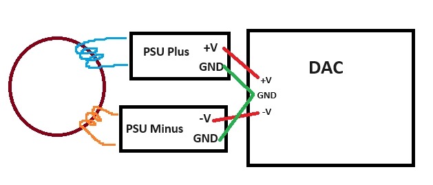

@miro1360 & @Michelag - when using the separate rail PSUs above with one of Miro's DACs, will each rail have a seperate Gnd? For a three pin connector on the DAC board, which GND would you use?
Connecting the GND terminals together would cause a loop?
I only ask as I tried to build a dual polarity supply with separate boards and connecting the 0V caused a hum. Same transformer with dual secondaries.

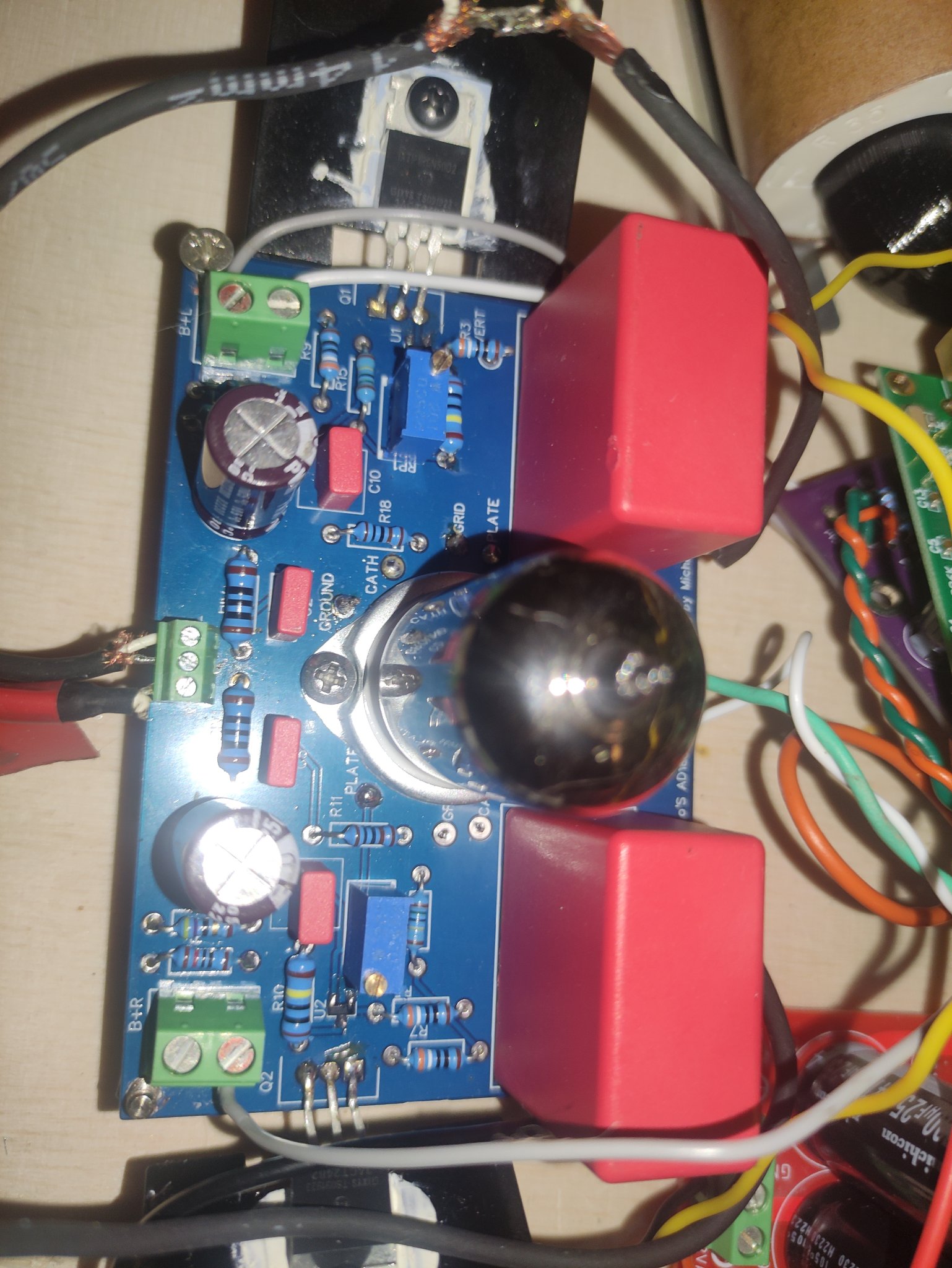

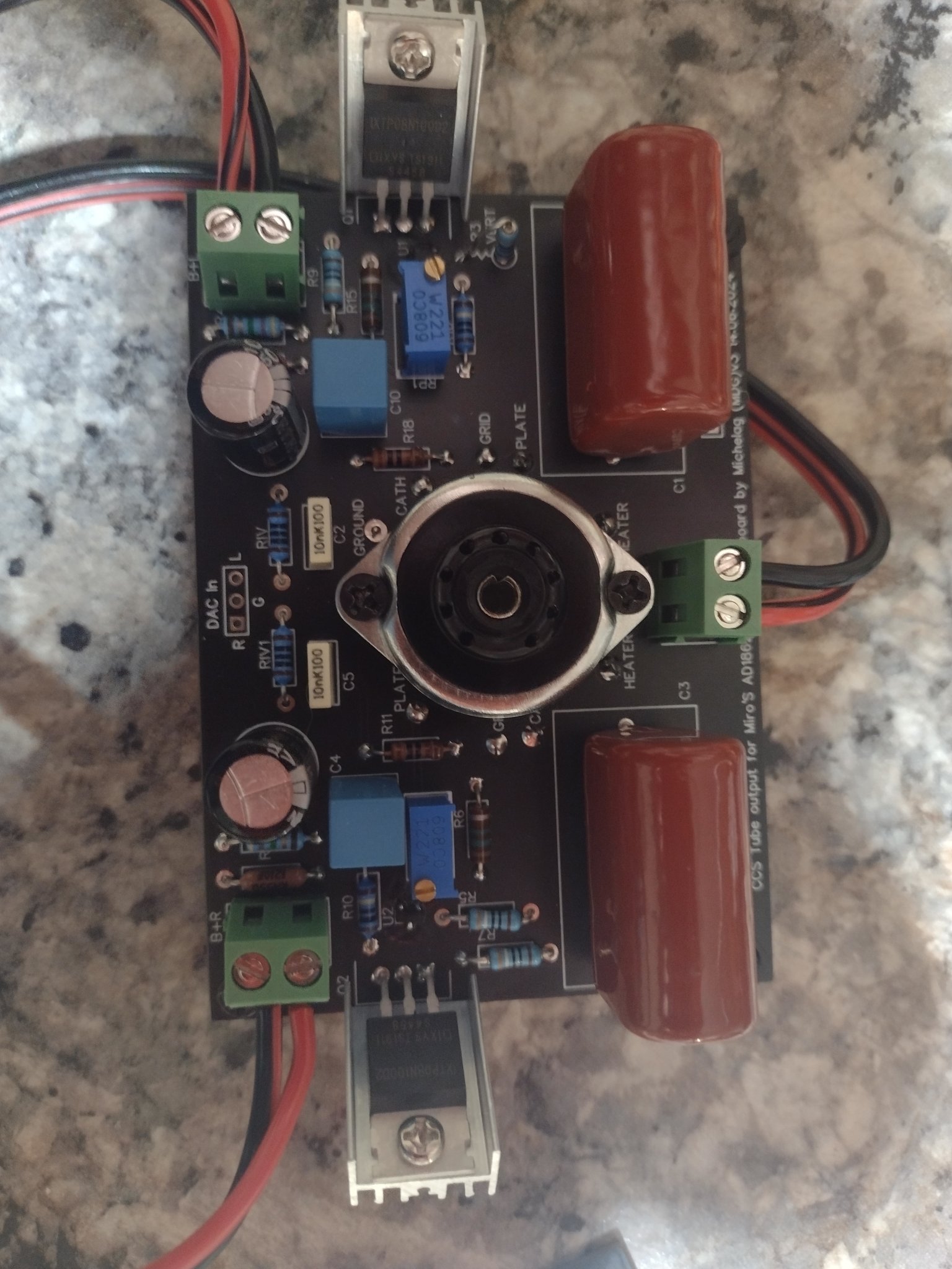

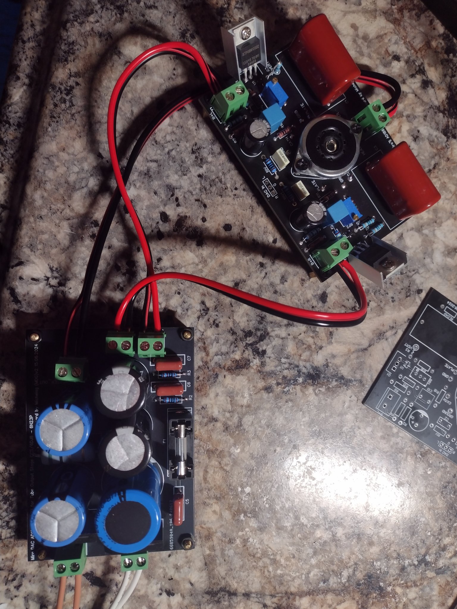

I need some help figuring out this tube setup Michelag. I have 237v dc going into the tube pcb, I have 237v at the center pin on the 2 transistors but then at the plate pin I have the voltage slowly creeping down from 237 and now it has dropped to 40v at the plate pin and still dropping. I havent installed the tube, but what voltage should I be getting at the plate pin or the outside legs of the two transistors? I attached some pics of my current setup

@passive420 Exactly like Michelag said, both power supplies are connected together on DAC PCB. ... Maybe your question was about whether they can be connected together to form a symmetric power supply? They can be connected together with GND terminals 😉

Install the tube before than immediately 😁(triple check the contacts on the socket), and regulate potentiometer to get 100V on the plates on both sides.
To avoid loops, connect the ground of B+ only on one side, they're connected on the psu board.
Measure in the B+ what pin is positive, I didn't write that explicitly on board, if I recall right

pretty sure my polarity is correct, I beep tested to ground to determine negative side. The pots are having no effect on voltage, I get full voltage and then it just starts decreasing - guessing the transistor turns on then turns off. I am going to double check I have the right components in each spot and then get back to here.

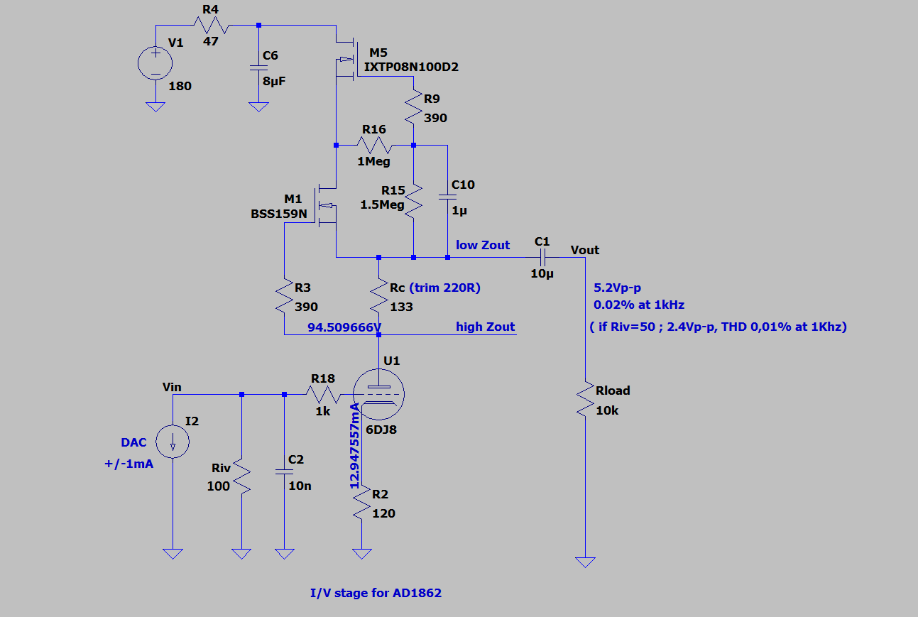

Still working at it. I changed out the IXTP08D100(possible fakes) to real IXTP08d50 and I have 230 volts consistent at the plates, I just cant get the voltage to drop. Wish I had other tubes to try in this socket, I will keep going, gonna triple check those socket pin outs again. Thanks for the pics and schematics again. I dont need a signal from the dac or anything to be able to set the voltage down to 100 right?

If the IXTP08D100 was fake it must have burned the BSS159N so I would definitely replace it as well. The tube must be in the socket to adjust the current through the CCS, otherwise the output from the CCS is always almost the same as the input voltage.
