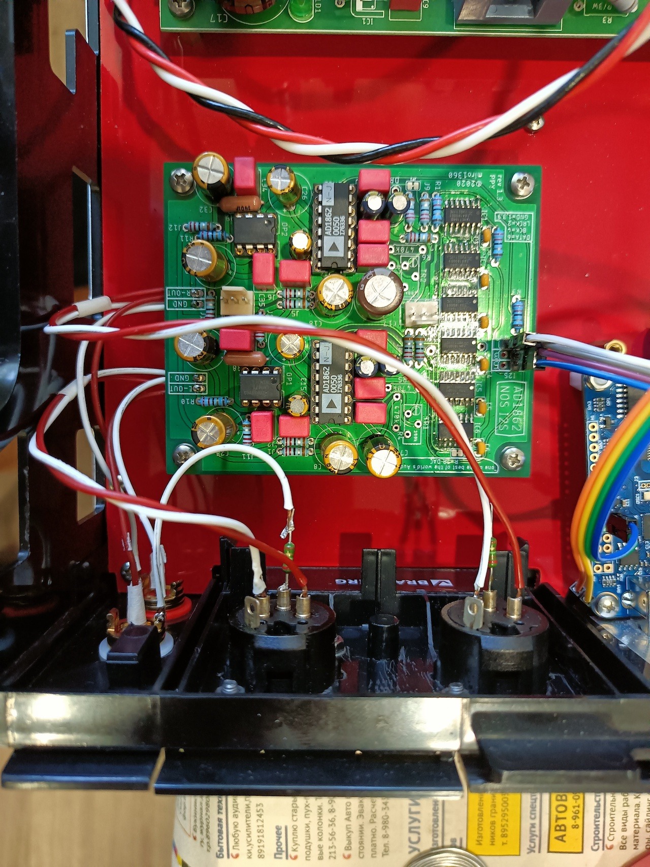

Check soldering for i2s/gnd connections. If i recall right, your soldering wasn't very good.
On board? - it's OK. There is another thing - Dac board have three points for GND connections right? And I use only one (1). Maybe we should use all of them? This Dac has been playing for a few years.
I have another Dac board - I want to use her with DF - FPGA. I'm gonna get help putting together.
Here, on photo - 5,3 not connected.

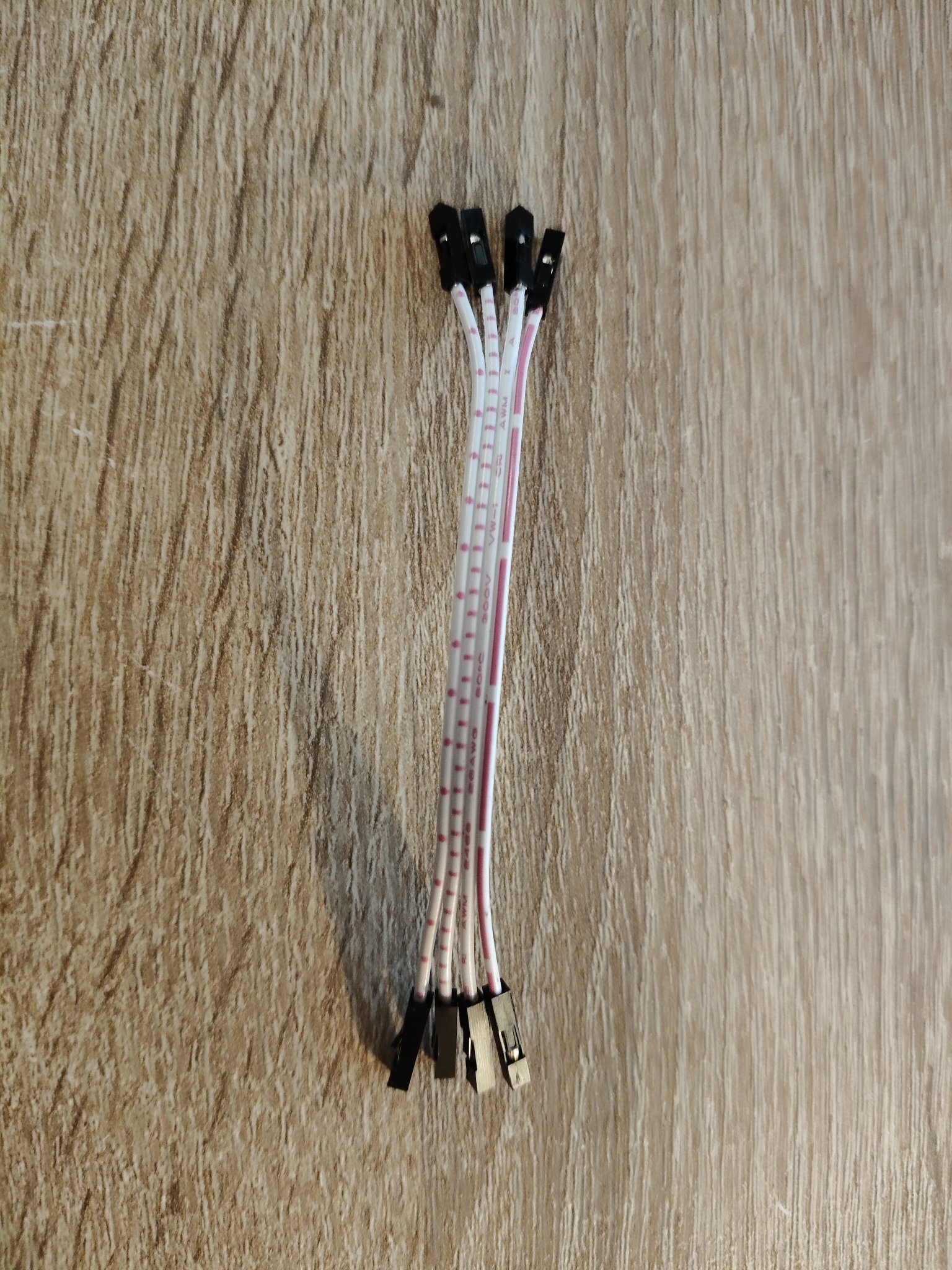

Definitely don't use those connectors unless you're just testing/prototyping, they are bad, very bad, especially when used as single wire. Little fork in the female connector gets loose very quickly. Remove connectors and solder wires directly, or use full pin number connector there (3x2).
Also connect gnd pads, there was an issue with gnd not being connected on one pad. Doesn't explain why it worked but now doesn't, as the info i gave you above, but can't hurt.
Reactions: analog_sa
Don't use them? It's a standart arduino connectors with cooper wire. Ok I got these - 1 метр UL2468 плоский кабель 26AWG, светодиодный экран 2,54 мм, красный и белый лента ПВХ кабель 4P 5P 6P 7P 8P 9P 10P 12P | AliExpress and dupont for them. Unfortunately I don't have crimper tool and use pliers. So I got these:
