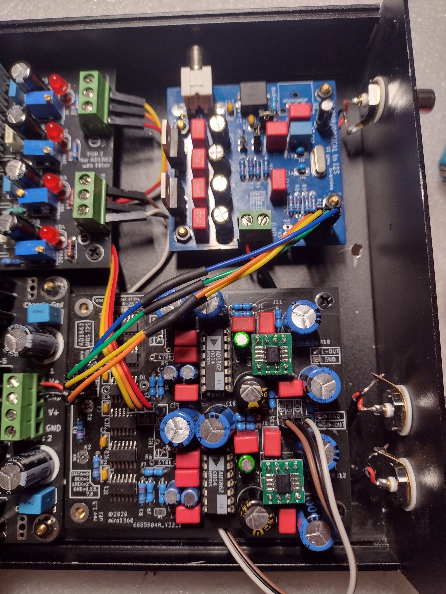

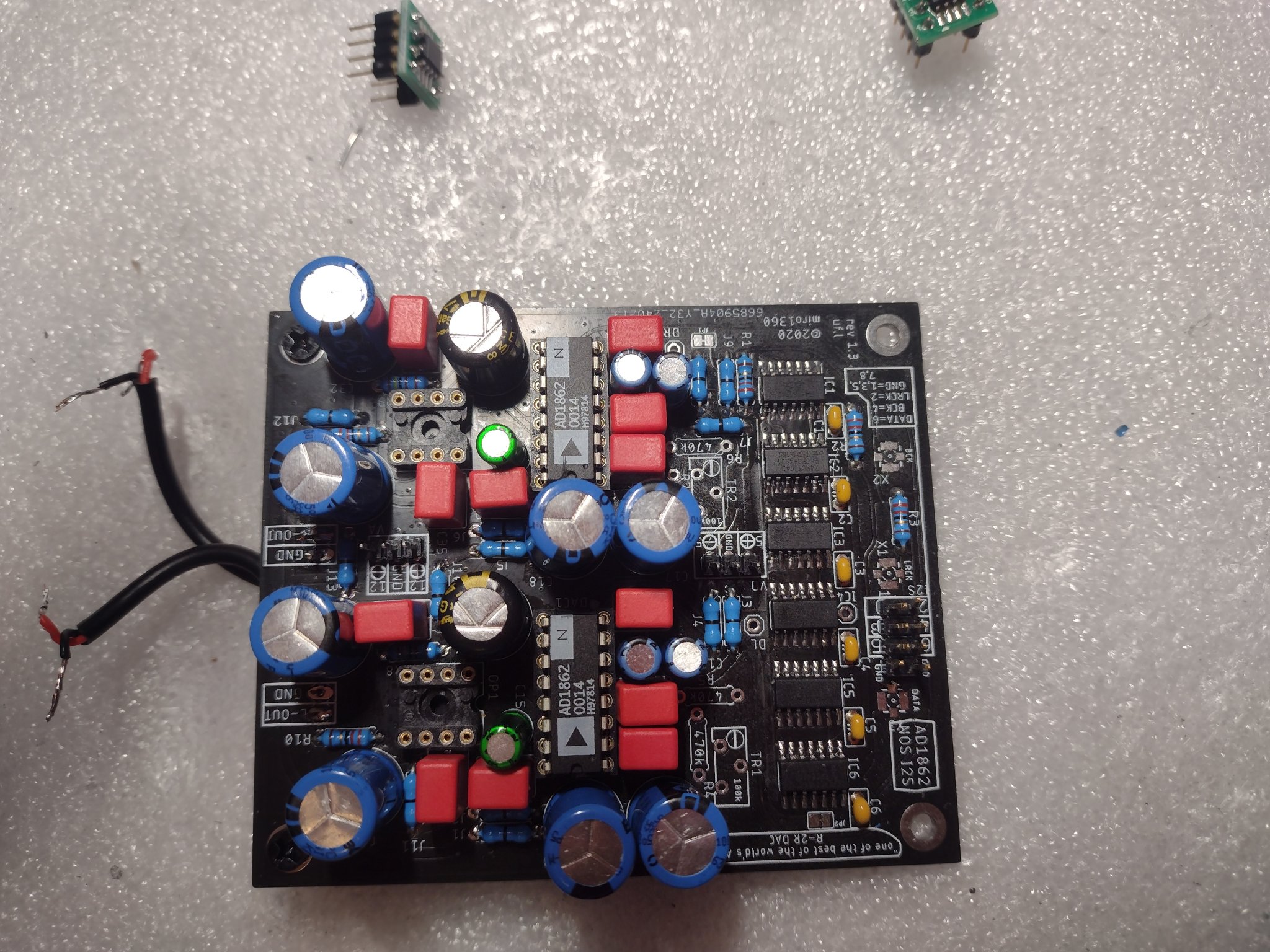

I could use some help. Cant seem to get any sound from Dac 1 side. I have switched the dac chips and it made no difference. I switched the opamps from the working side to the non working side and no difference. I appear to get the same voltages at the same pins on the dac chip and the op amp chip for the working side and non working side. I am using Miros SPDIF to IS2 convertor. I am feeding it from a coaxial source if that matters. Can someone also explain the jumpers on the convertor? What is 24 bit LJ and 16 bit RJ. I get the IS2 settings I think.

@gsrchrisu use a good contact cleaner and a brush to clean the spaces between pins of logic gates particularly the following:
IC1 pin 13,14.
IC2 Pin 13-14
IC3 pin 8-14
IC6 Pin 1-2.
If I remember right miro1360 did reply a post of the same nature earlier in the thread and check voltages across certain pins, but just to be on the safe side please do clean the spaces between pins of logic gates the ones mentioned above.

Update: I found 3 pins on 2 different shift registers not making contact, I love the challenge of smd parts but what a bugger when they dont work. I went over both sides with a toothbrush and cleaner. Now both channels are singing. Thanks for looking. Off to try to get my PCM63 version that has no sound output from either channel. But now that I have known working parts will make debugging much easier.

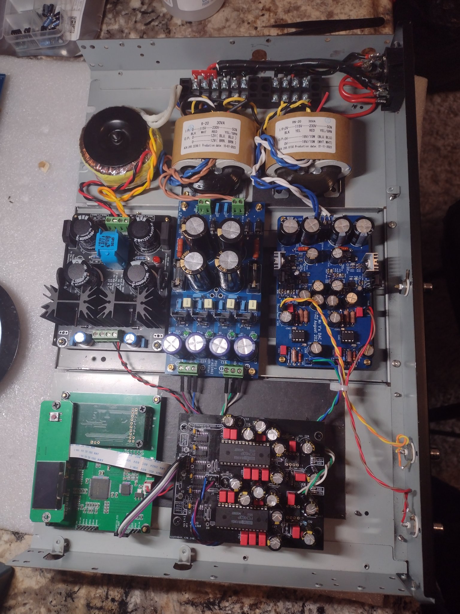

So pumped finally got my PCM63 dac to make music. Thank you to Vunce for the 811 I/V and thank you again to Miro1360 for the Dac gerbers, was really fun to build and sounds amazing. Alot of learning happened with all the challenges these projects presented. My best tip is to use your DMM and beep out the pins on the SMD logic and opamp parts.

some advice about AD811 (after all, I am the author of Vunce's I/V ); remove that PCB as far as possible from the transformer and reduce the length of the cable between the miro PCB and Vunce PCB ( PCM63 to AD811).So pumped finally got my PCM63 dac to make music. Thank you to Vunce for the 811 I/V and thank you again to Miro1360 for the Dac gerbers, was really fun to build and sounds amazing. Alot of learning happened with all the challenges these projects presented. My best tip is to use your DMM and beep out the pins on the SMD logic and opamp parts.
