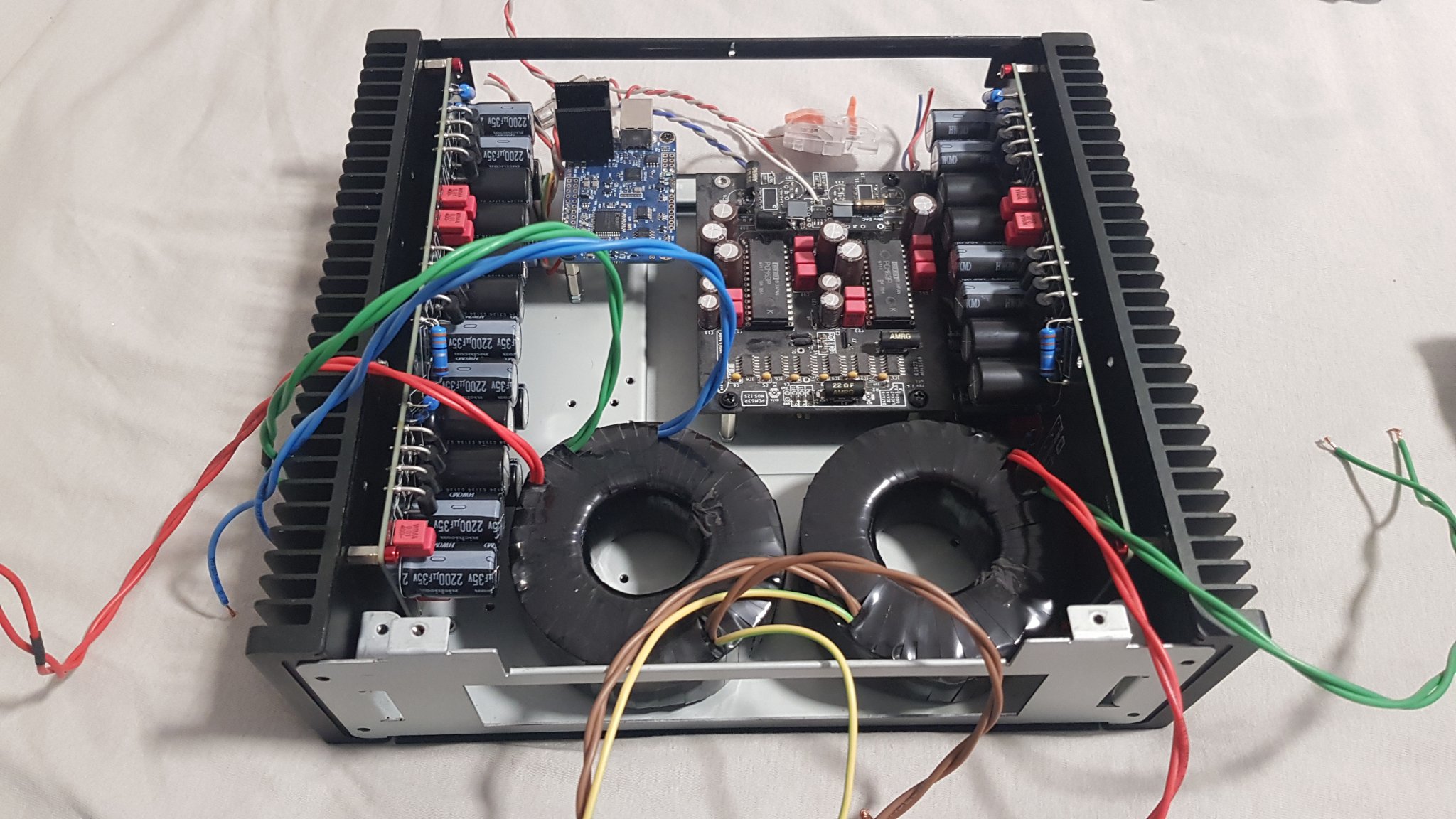

But isn't it better to connect I2S to USB directly to the DAC, bypassing the shift-register?
Nice build !
My prejudices are similar: JLsound should be better than shift registers because of the reclocking done at output. And shift registers should be better than fpga because...uhm, not sure, but perhaps jitter.
Yet, there have been opinions in this thread from people who have actually compared the three and it seems not to be quite so simple.
I have tried both shift registers and JLS direct in two identical builds, no question JLS direct sounds better.
I have tried both during many testing periods and did not hear difference and also compared it with another xmos and also the cheap aliexpress PCM2706 with no difference
The major difference I heard mostly on the I/V stage. ... and also filters are creating very much difference in sound, significant (that is why each delta-sigma sounds different - filters) ...
I would also add regulators and power supplies, especially for the DAC itself and the IV stage 😉 .
Hence why i need mini power plant to power my pcm63 😅 Made fully custom psu boards for this case. Finally getting time to pack the dac into it's own case.
Which makes sense, since the clocking does not go through the shift registers, only the data.I have tried both during many testing periods and did not hear difference and also compared it with another xmos and also the cheap aliexpress PCM2706 with no difference

The only thing missing here is the soft start and vu meter 🤣Hence why i need mini power plant to power my pcm63 😅 Made fully custom psu boards for this case. Finally getting time to pack the dac into it's own case.
