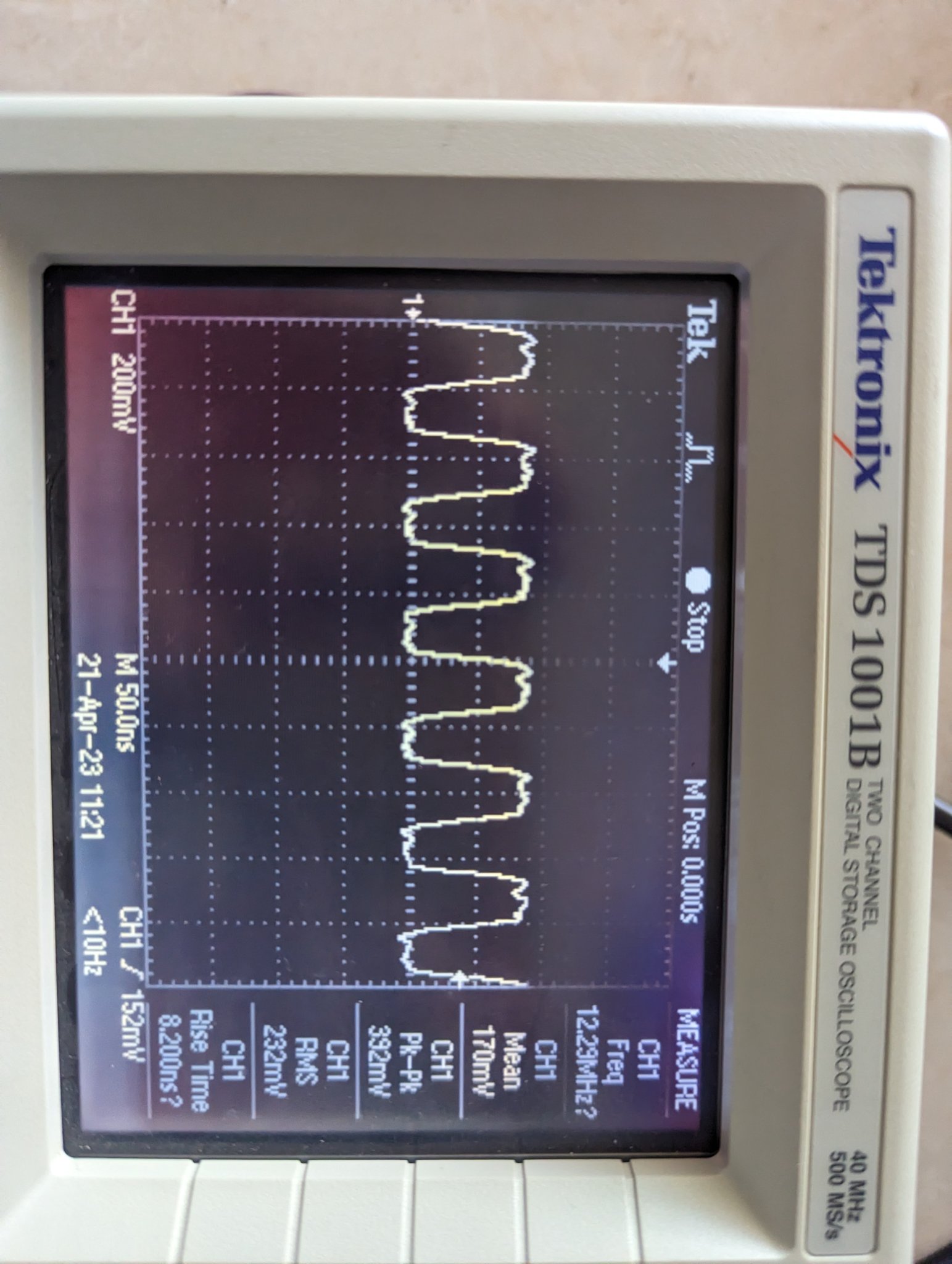

Here are the LRCK and CLK at 384K directly on AD1862 pins, no input from computer but USB connected. The data line pin is null as should be. You can confirm the frequency

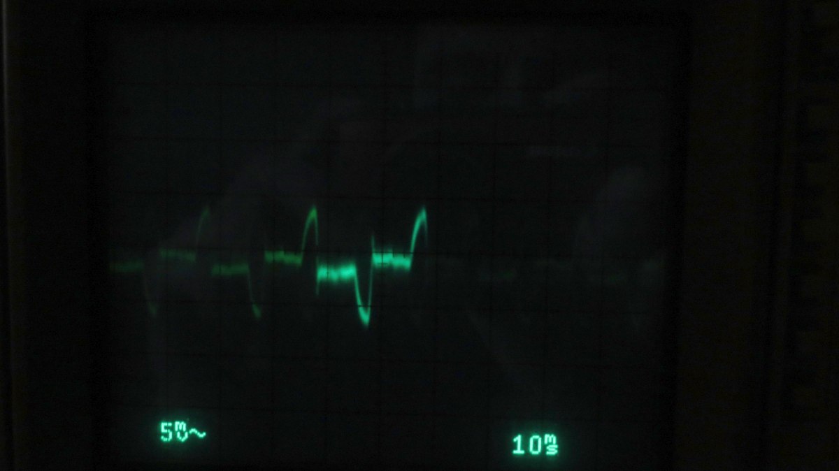

@gaycoh I measured this LRCK residuals also on the PCM1704 (without filter) with galvanically isolated digital inputs. It is few years old measurement, just found it in my PC 😆 From the PCM1704 it is much worse than from the AD1862. It can be filtered with the LP filter, or let it be if it is not audible 🙂
5mV digital noise from 1.2mA current (1k5 I\V resistor) = it is 3.3uA "glitch".

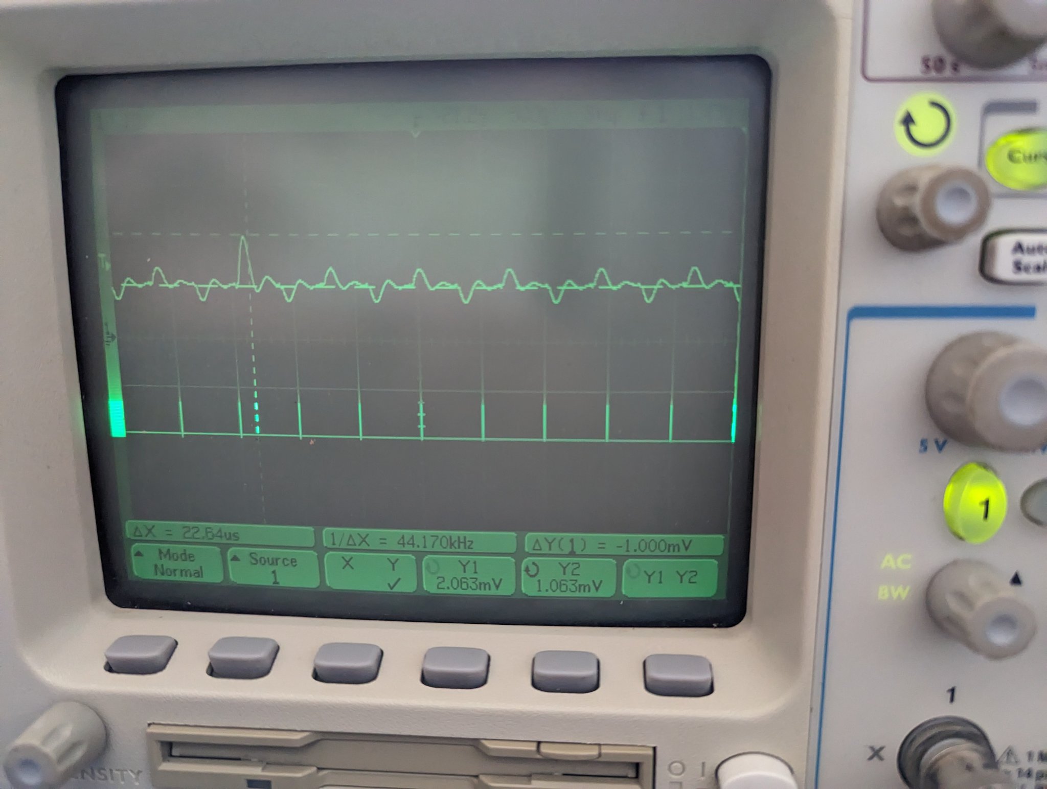

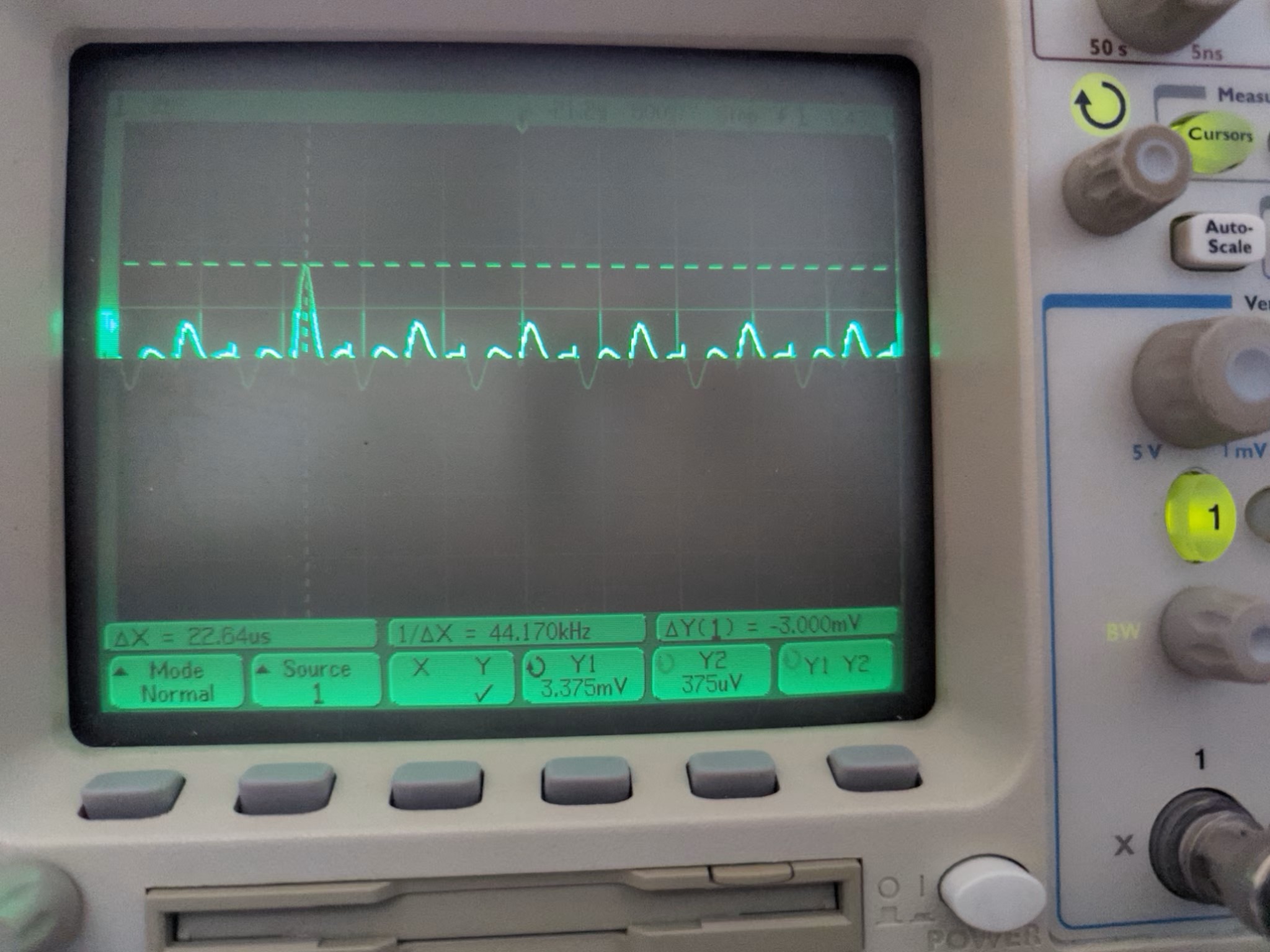

I took my other Agilent scope to capture (it has this MegaZoom so can dig better). The problem, is a
CRT so hard to catch by a digital camera (scanning issues).
Anyway, I have 3 parallel floors of AD1862 with 1kohm conversion resistor. I could remove two floors and see if the glitch is reduced by a factor of 3. More or less this is the situation. In the following pictures you can see two shots (44.1k Fs). One with 3 floors (of AD1862) and one with 1 floor. Resistor is of course fixed 1kohm. I put the cursors and you can look at the delta Y (delta for offset nulling). With 1 floor it is 1mV, so basically 1uV at Iout which is 60db less from its full scale. More or less the proportion is preserved with 3 floors.
In terms of bits, 1uA (before I wrote by mistake 1uV) is 10 bits. Is it really what is called glitch ? Major carry transition or we (me and you) just called it like that? I think it is a kind of problem coming from the AD1862 architecture of switching. The data is null in all my measurements (checked) so theoretically the internal DAC buffer should transfer 0 at LRCKs.
However, it doesn't. Maybe it is related to how the AD1862 is making it's switching where there is some energy in its capacitors. Maybe it is also related to the fact that the I/V doesn't really present 0 potential (virtual ground) to Iout.

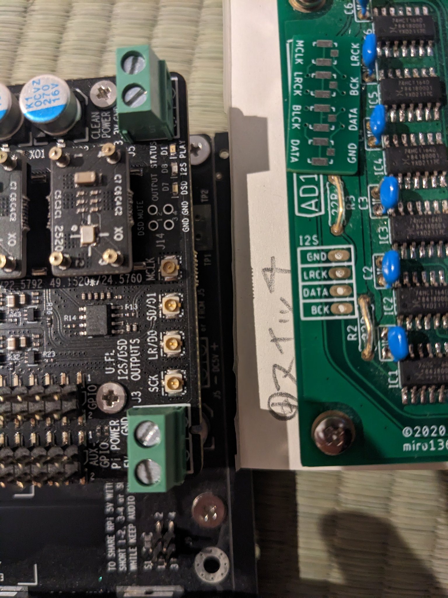

jimk04 sent me u.fl pcb.
Thank you so much.
Now I am trying to connect Ian's fifopi ma and ad1862 pcb with u.fl.
Fifo pi have SCK,LR/D0,SD/01,MCLK
and ad1862 have BCK,DATA,LRCK,GND
I need help which to connect.

In this case it should be like this:
SCK=BCK
LR/DO = LRCK
SD/01= DATA
GND=GND
MCLK is not used
Reactions: tamra
Coaxial connectors for I2S and shielded cables are provided. I don't think it's necessary for short cables. Connect only one GND wire between the two PCBs, and put the I2S cables either without the shield or with the shield hanging freely on the DAC side.
